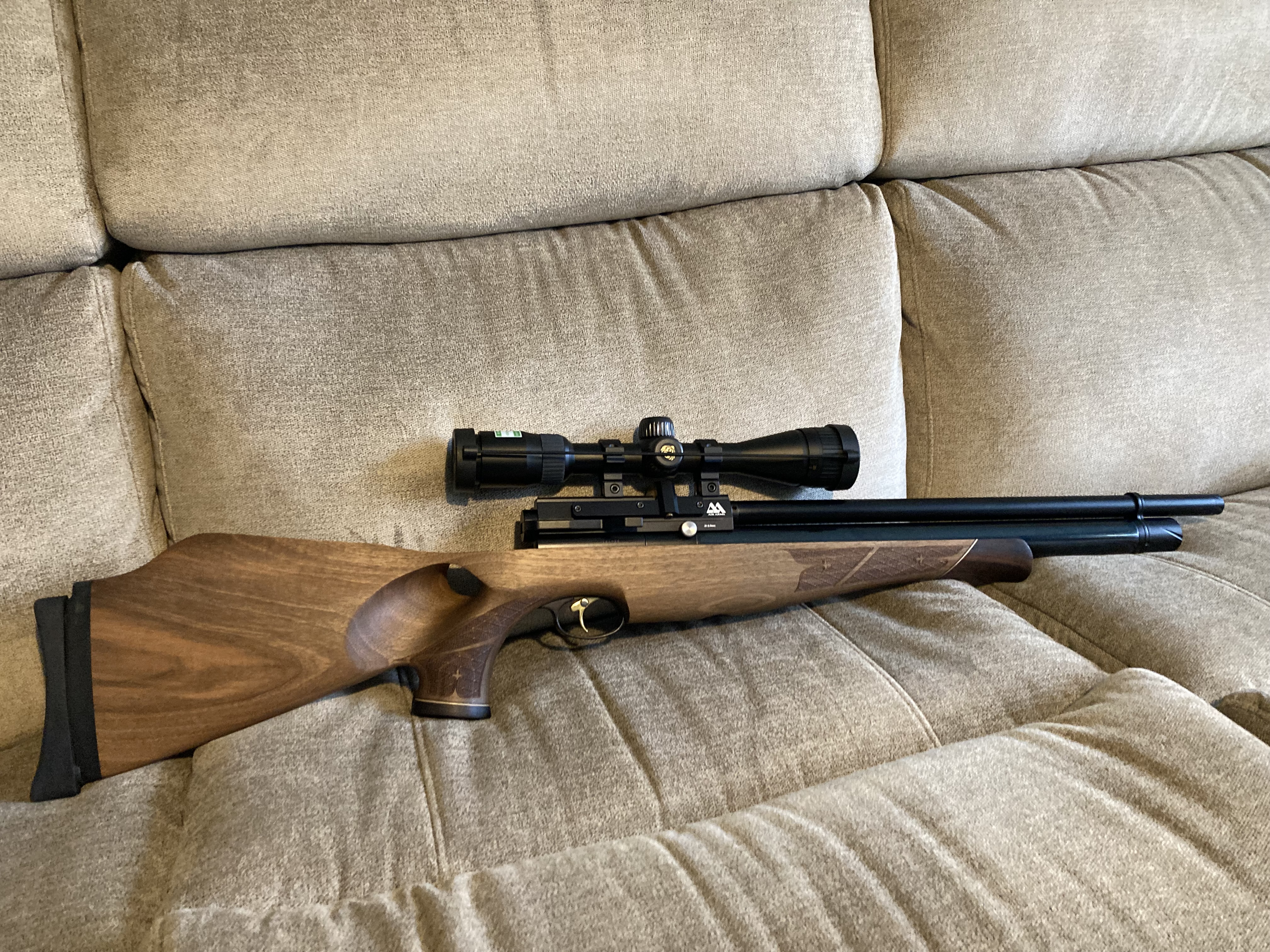

My s410 was in .22 and it was a tack driver!
I should have kept my S410, but the new (at the time) FX Royale 400 caught my attention, and off it went.

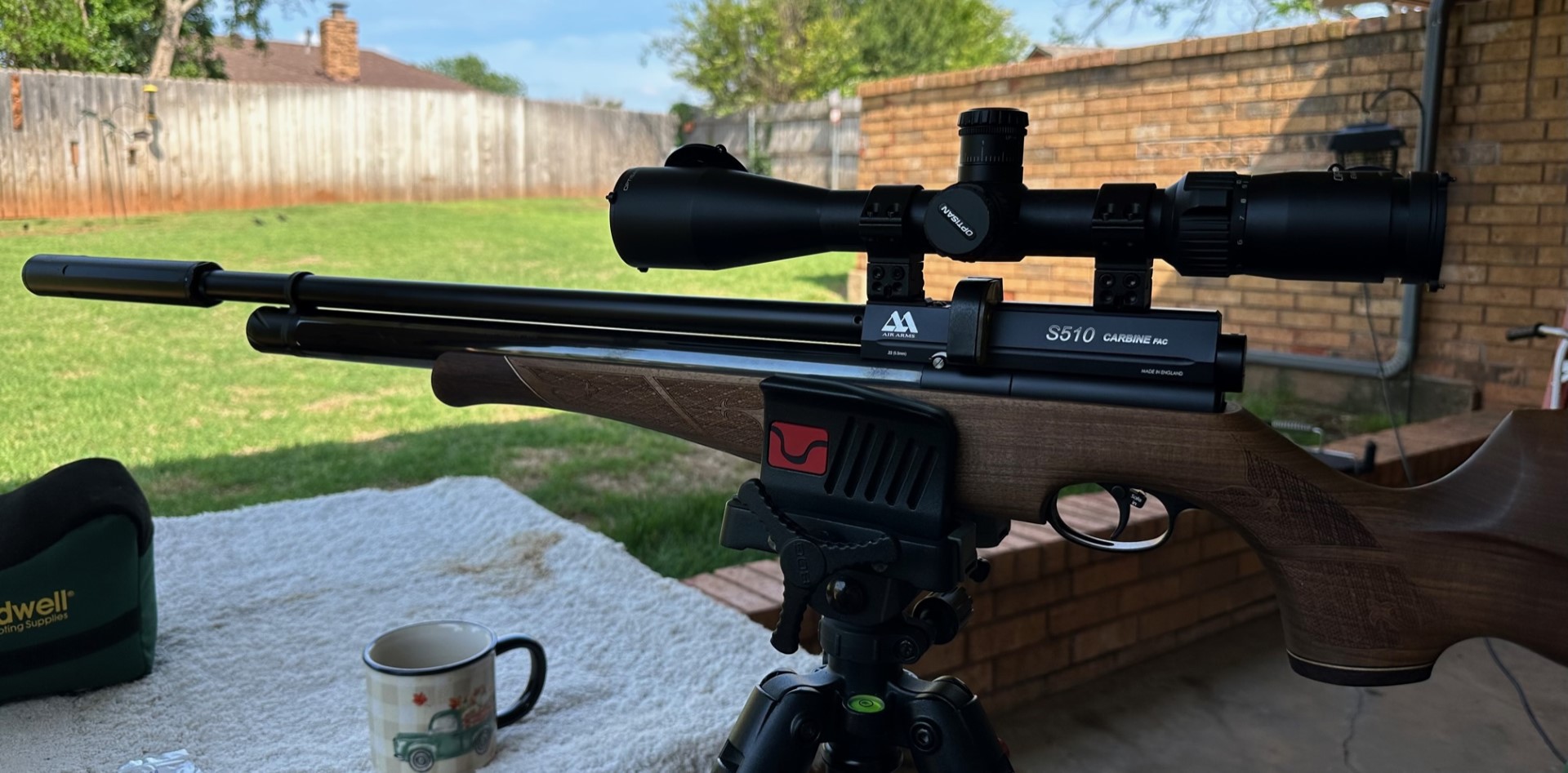

My S510 .22 carbine is my favorite air rifle. No leaks Or problems ever. Most Important to me is Air Arms doesn’t bend over backwards to make my investment look outdated to sell me a new gun.
Just old-fashioned walnut and steel!
