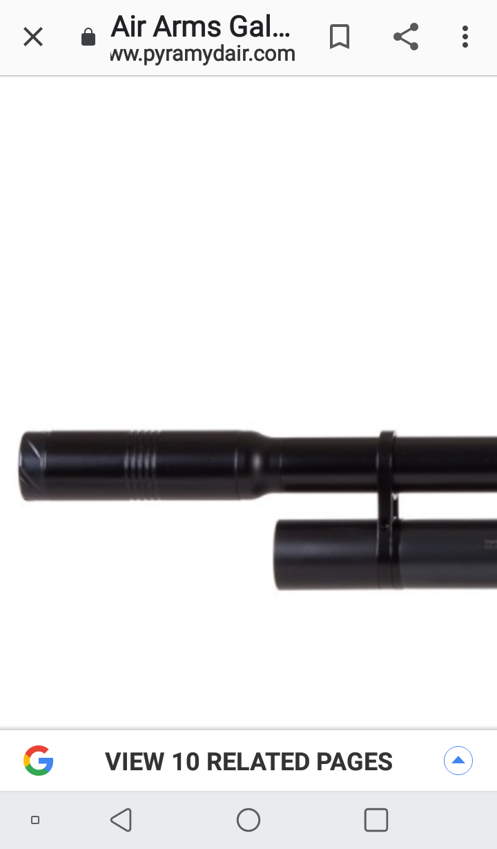

My Galahad is kinda long. I'd like to see how well the barrel shrouding baffles work without the silencer.
BUT, I can't seem to get the silencer off of the shroud. I let it sit in the hot (95°) sun most of the day, still no luck.
I don't want to damage either the shroud tube or the silencer, but separating the two would be a good thing.
Any good ideas out there ?

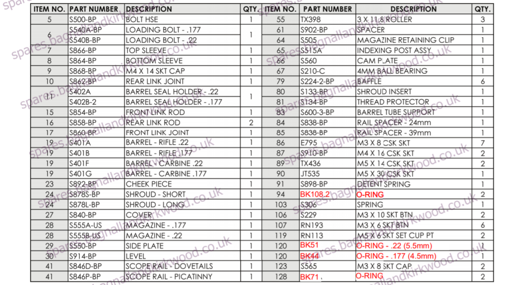

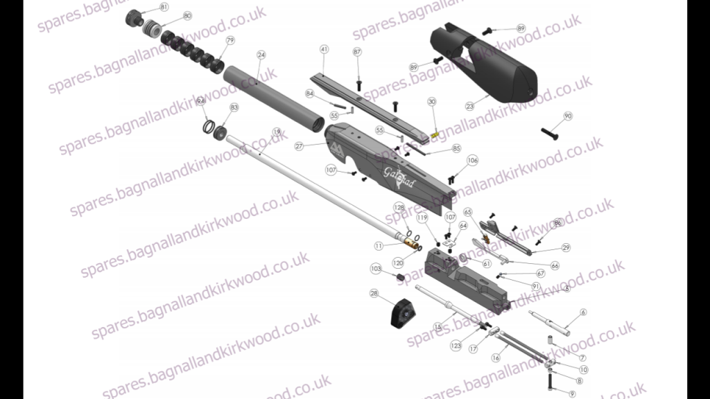

https://spares.bagnallandkirkwood.co.uk/air-arms/air-arms-galahad-air-rifle-spare-parts/

E-mail from Bagnall (EU) says that they cannot send shroud / silencer parts out of the country separately. If that's true, that means that Air Arms cannot either, but I still have not heard from them.

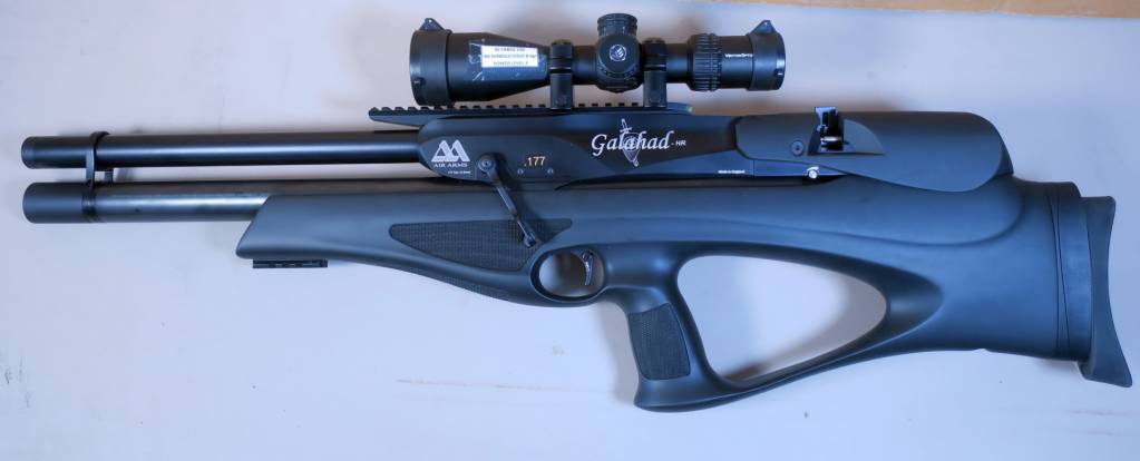

Mine is the rifle not the carbine, with an overall length (without moderator) of about 31.5"
So... it is really only about a 4" difference between moderated shroud and plain shroud.

Like my Lelya, BP 17. Even my Uragan Compact is really nice lengthwise. Then they start to get long. I shortened the shroud on my Daystate Renegade. Just cut and weld. Still has all of the baffles, just slightly shortened to fit the new interior length..!
May look into the cut and weld idea on the Galahad. Leave the silencer in place. Should be plenty of room, diameter wise. Just the interior parts, can I do that right ?
