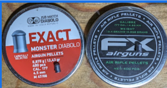

Currently shooting the jsb 13.43's in one of my .177 cal guns and was wondering if there are other options in this weight class?
This sent me down a rabbit hole seems like, the only thing i have found at this point are the Rangemaster Kings, which are Not available anywhere in the USA as far as i can find anyway..
Anything I might be missing?
I know about the slugs, not impressed at all with them in Any of my .177's
thanks in advance

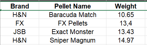

FX has a 13.4 gn which, technically, is the same pellet.
In my stash of 177's they are the only 13's
NSA has a 12.5gn but then that's another slug :(
Hi Guys,
I shoot the FX 13.4's in my FX Crown MkII with the 500 mm Superior STX liner. I shoot these at 820 fps to stay under 20 fpe for HFT. I find these to be slightly more accurate than the JSB Monster Redesigned. I shot 300 of each after measuring head size and weight, and recorded the muzzle velocity and POI (each shot at a different bullseye). Over 85% of the FX pellets had a head size of 4.54 mm heads with the rest at 4.53 mm. The JSB pellet had mean head sizes of 4.52 with a larger scatter (as much as 4.55 and low as 4.50). Both groups had mean weights very close to the advertised weights with standard deviations of less than 0.1 grains. I think the barrel in my Crown just likes the larger head size as the FX pellets consitently had more x's and hogher scores than the JSN pellets.
