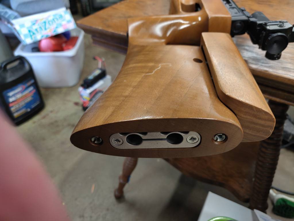

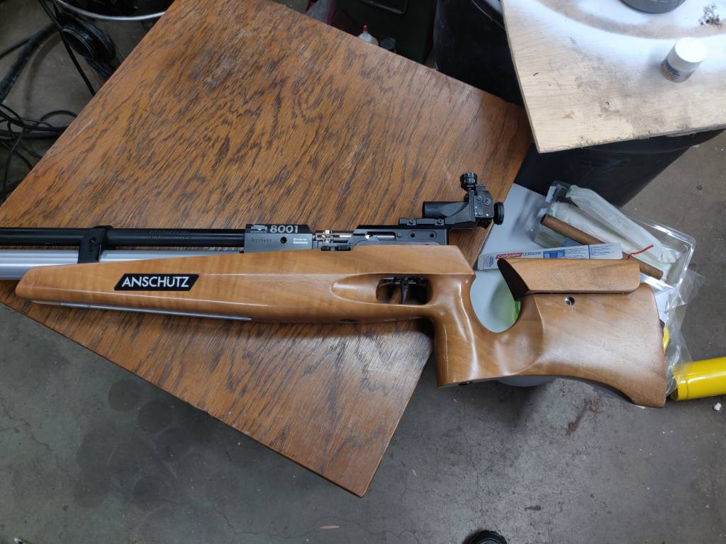

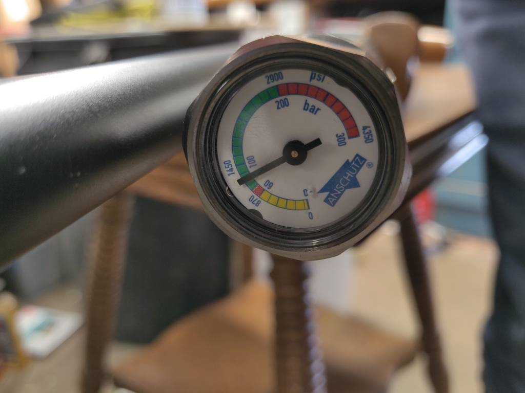

Update: I'm back in the States and I finally got to see what I bought. Overall in very good condition, but no buttplate and no fill adapter. Some odd loss of anodizing on the receiver, but I can live with it. The cylinder was holding a charge and I sent one pellet through it, just to make sure it works. Seems to be a good score, now I have to buy, or make an adapter and see if I can snag a used buttplate assembly on the cheap.
My guess is it was probably a club or CMP rifle. Hence the missing bits. If anyone has the parts laying around gathering dust, contact me by PM and see if we can work something out. The stock has lots of light handling dents, but reasonably nice grain, so I may go with a gentle refinish and slightly darker, I'm not a fan of blonde wood. I have to pull the action so I can give it a thorough cleaning and I'll decide what to do with it then.
