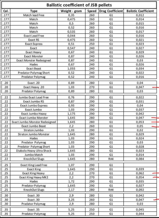

What makes them so good is the highest BC in pellet world at the moment, BC of 0.053 is over 50% higher than the BC of 0.33 for 34 grain 25 heavy, or about 25% better than 44 grain 30 cal pellet BC of 0.042. Another way to put it is the .22 MRD has 50% less wind drift compare to 34 grain heavy and 25% less wind drift compare 44 grain 30 cal pellet, impressive!
I've shared it before but here's it is again.....
Red hash denotes the highest BCs.
The 34grain .25 is heavier than what qball reported above.
This was shared by JSB on either Facebook or Instagram roughly two years ago.
You really wanna have your mind blown? Look at the BCs for the .20 Heavy vs the .30!!! And I've tested and confirmed that high BC of the .20 Heavy. It's good!!!
The only ones I can disagree with from personal BC collections are that the .177/10.34s can be a bit better than the chart shows, and I've never gotten a BC as high as they report for the .22/18.13s.
But back to Centercut's point of this topic, the .22/MRD is GOOD, GOOD, GOOD at long range accuracy. Perhaps the best current long range pellet. Why? I dunno, but it is. (Or at least can be with good batches).
I have to disagree with that. The .25 Heavy 34 grain has a slightly better BC than the .22 Monster RDs…

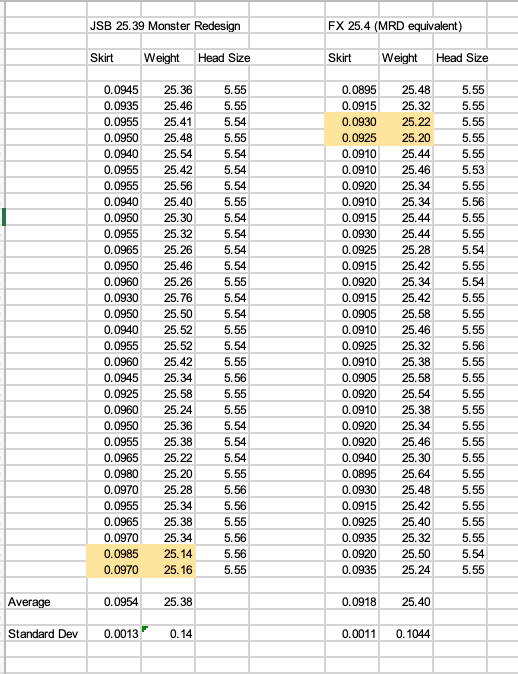

Having said all that, I recently sorted two batches of pellets. A group of JSB MRD 25.4 and a group of the FX equivalent. Granted, it was a small sample of 30 specimens each but there is definitely enough deviation to makes a difference. I measured skirt depth, weight, and head size. My results are below:
I can't imagine why on earth someone would not sort their pellets before a major competition if for nothing else the mental boost of knowing that you have put the work in.
I don't reload but my son does and he shoots long range powder burners. Every component gets inspected, weighed, measured to the ten thousanth, etc. I asked him why he obsessed so much over things that can't possibly matter? I thought he was going to call the people who wear white coats and carry straight jackets on me!
What tool did you use to get these detailed numbers? Just a good set of calipers?
