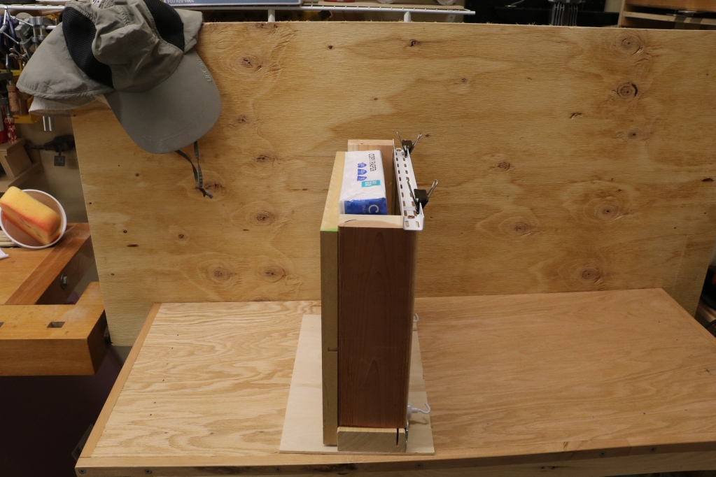

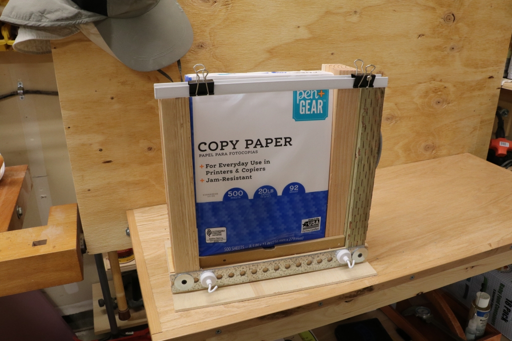

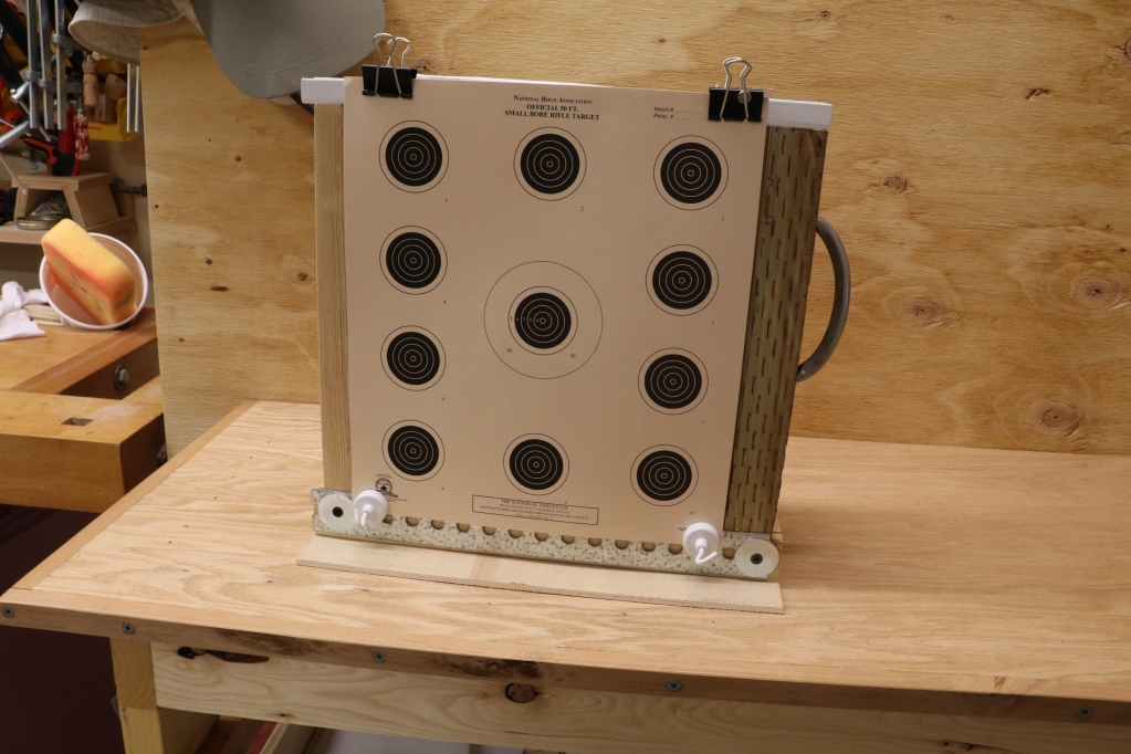

Here is the first idea. The target box is built to hold a 12 x 10.5 target; thus, the 2x4 inserted at the side of the ream of copy paper. If building a box to hold an 8.5 x 11 target the additional 2x4 strip isn't needed. The metal strips at the top and bottom are to hold the target. The clips on the top are on a strip of U shaped metal used for shelving. At the bottom is a straight flat piece of metal and the two white objects with hooks are magnets that hold the target on the bottom. The size of the box allows a ream of cheap copy paper to be placed into the box. The metal strip at the top is low enough to stop the copy paper from falling forward. There is a 1/4 piece of plywood on the bottom to help hold the box upright.
This is the box with a target attached. The handle helps in carrying the target box around.
This is the side of the box. You can see the ream of paper sticks above the sides and the front rail with the clips.

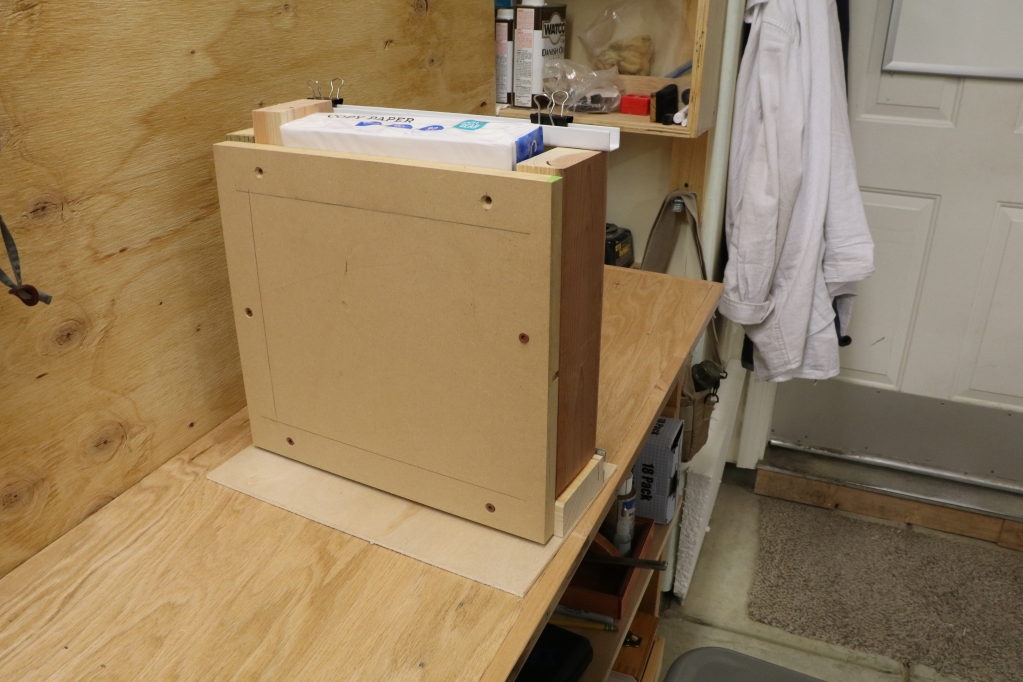

Here is the back of the box.

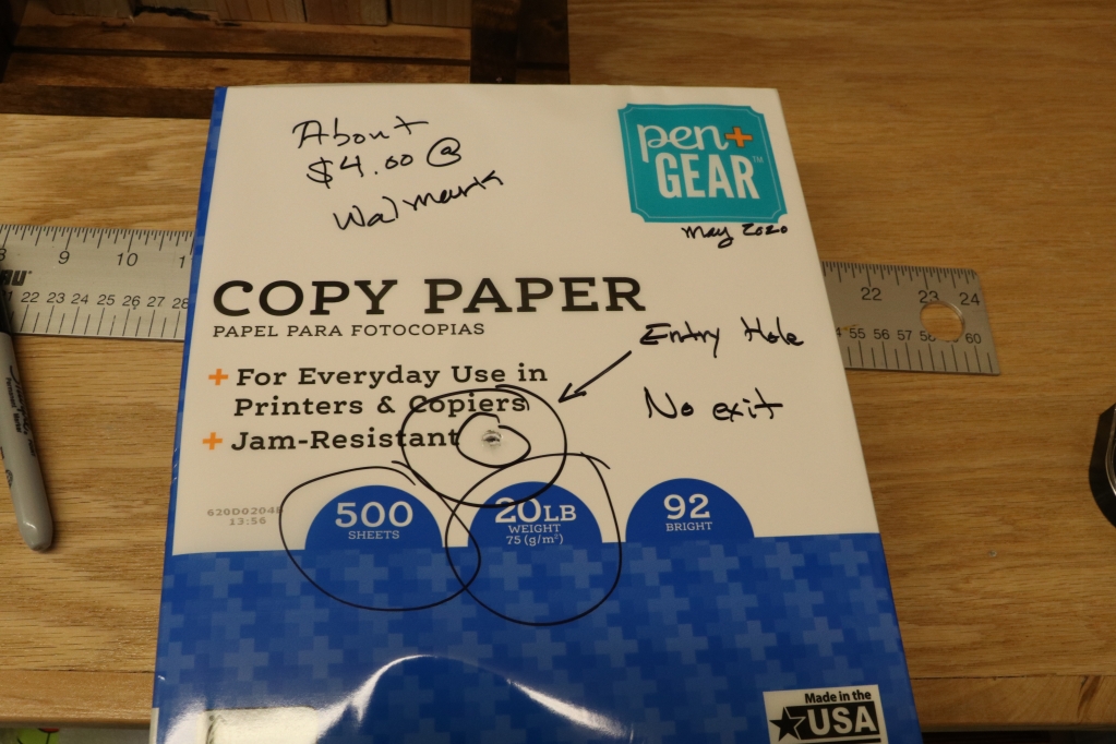

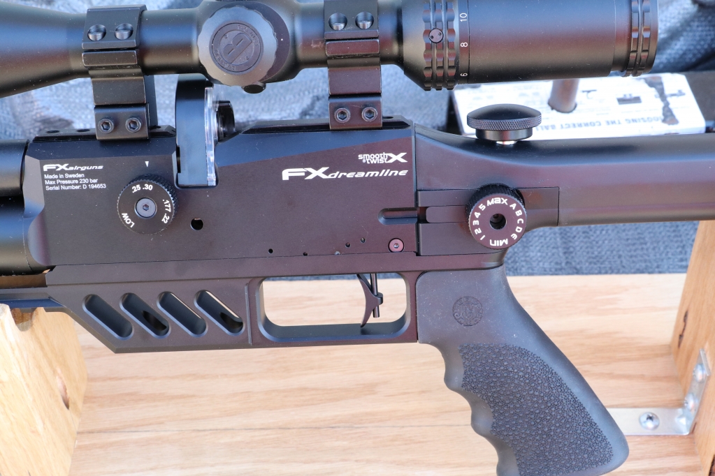

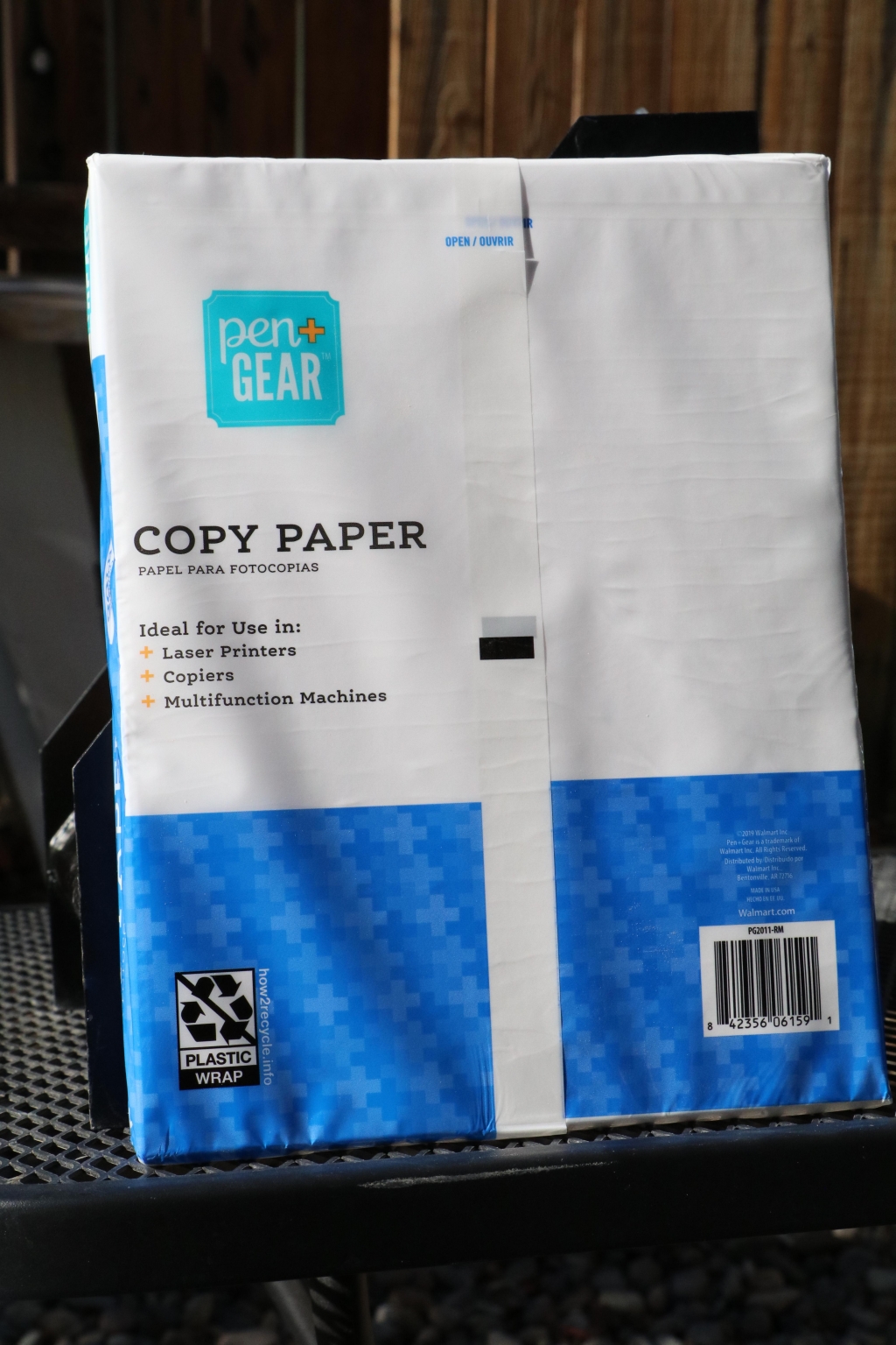

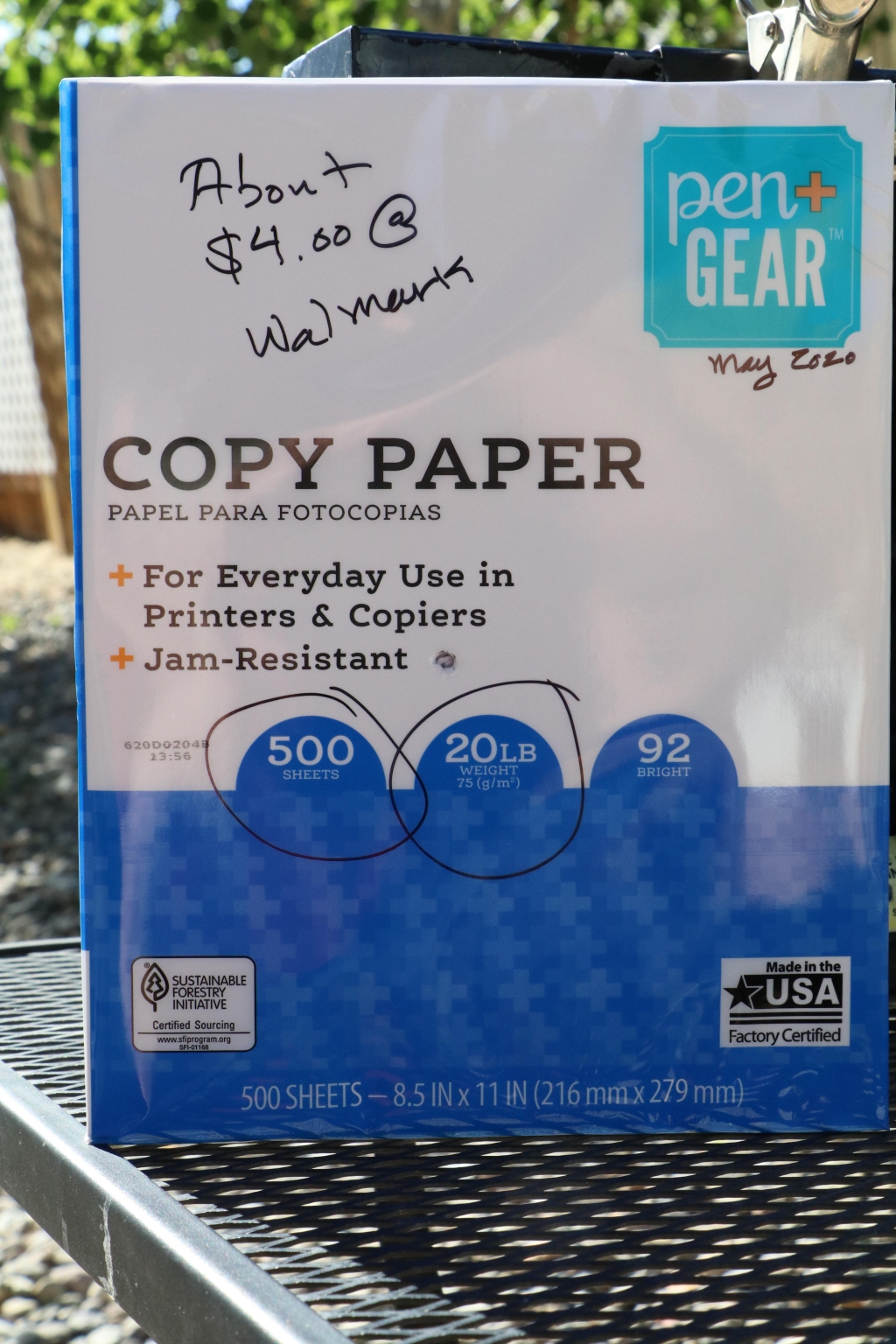

NOW for the test. Will a ream of paper, still contained within the original package, stop a .25 caliber pellet fired 12 inches from the ream - point blank range - from an FX Dreamline just aired up and set to highest power on its adjustments. The answer is YES. The ream of paper stops the pellet. NO sign of an exit. The pellet was a JSB Match King Heavy .25/ 33.95 grains. Photos show the test.
This is close up of the paper. The cheapest I could find at Walmart. About $4.00. 500 sheets, 20 pound paper. The pellet hole is just to the right of the words Jam-Resistant.
Here is the back of the ream. No exit hole. The paper easily stopped the pellet.

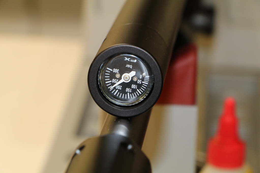

Showing the FX cylinder charge before the shot into the paper,
The second photo shows the adjustment settings on the FX. Full power everywhere.

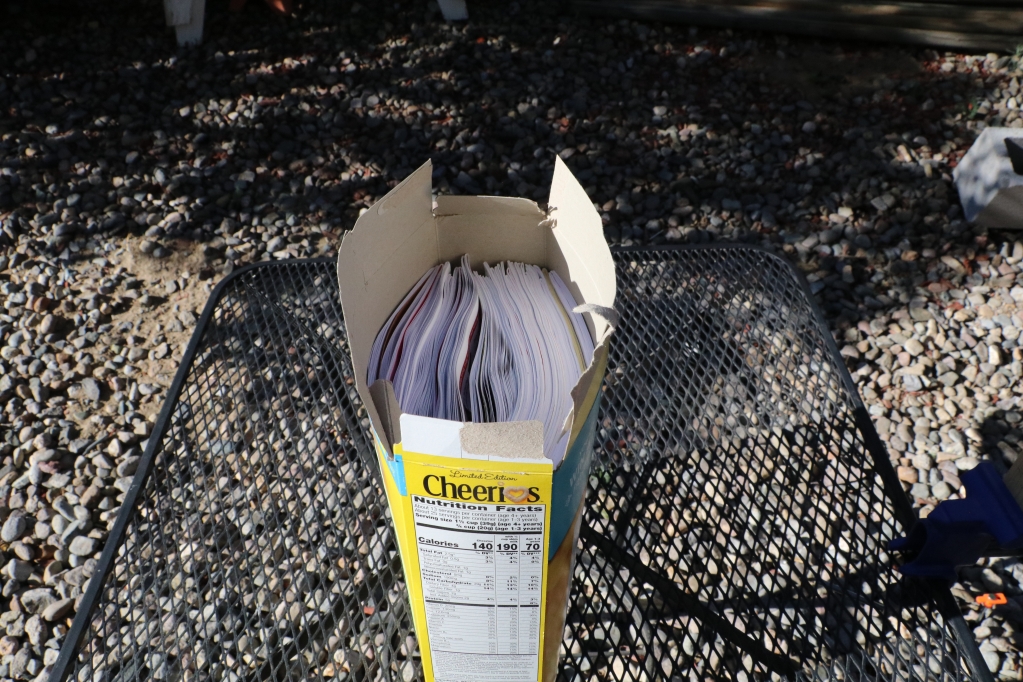

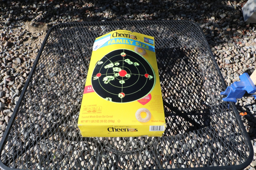

I did the same test on a Cheerios box stuffed with Magazines: PLEASE NOTE: THE CHEERIOS BOX TARGET ALSO FAILED FROM THE SAME PROBLEM DESCRIBED ABOVE. THE MAGAZINES STARTED TO BULGE OUT AND DESTROY THE INTEGRITY OF THE STACK. I BELIEVE THE PELLETS WILL SOON PENETRATE THE CHEERIOS BOX AND MAGAZINE ASSEMBLY.
Same results. The .25 pellet launched at point blank range from the FX on full power and full charge did not exit the Cheerios box. The large box easily took the magazines. So, with a spare Cheerios box you have a target that can take a .25 pellet, JSB Match King Heavy 33.95g from 12 inches away.We have a good backstop and all of it recycled materials. Wrong.

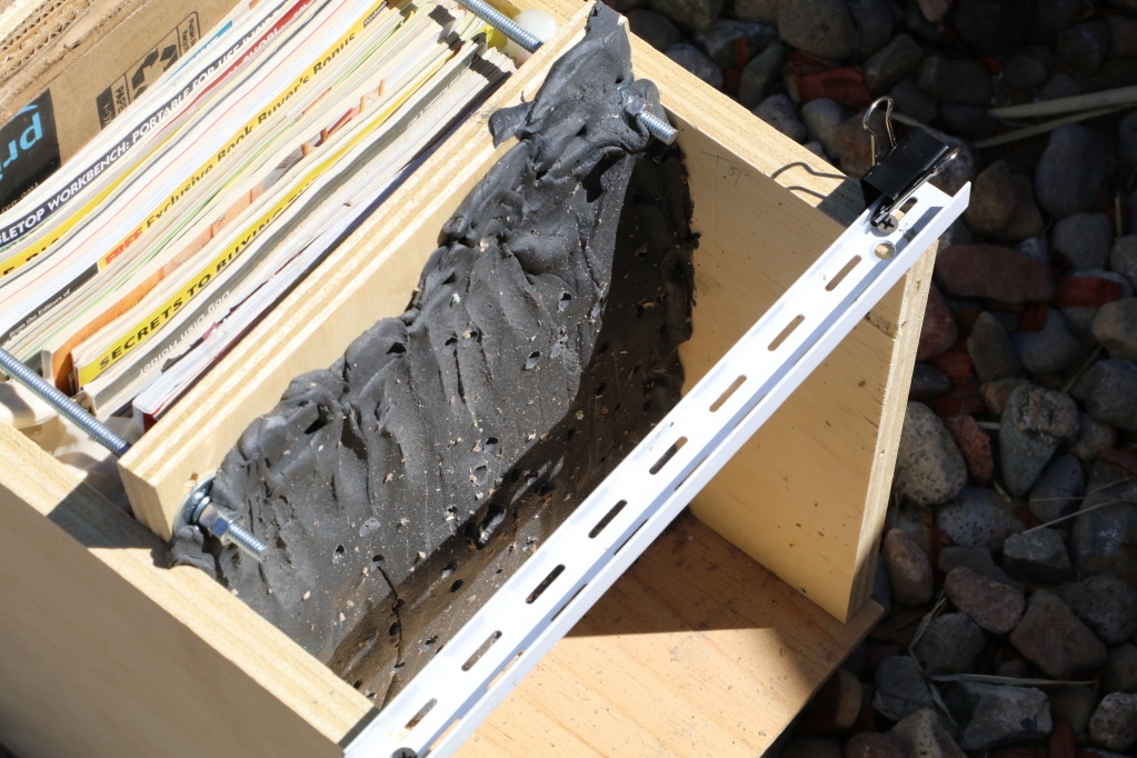

On my previous pellet box made from plywood and wing nuts and long all-thread bolt thread material, I found the plywood at the front was being shot out. I added duct seal to the front. It makes the pellet box very quiet, and should preserve my plywood front. My point blank tests on old magazines started with this box.To think I didn't have to build anything, just stuff a Cheerios box with my left over magazines, makes me feel a bit dumb. I now feel even dumber. But, the plywood and squeezed magazines have stopped pellets stone cold and makes an unbeatable backstop. Much too early to tell. I don't own a caliber larger than .25, but I'll bet it would stop a .30 caliber at point blank range, perhaps even larger. But how many times?

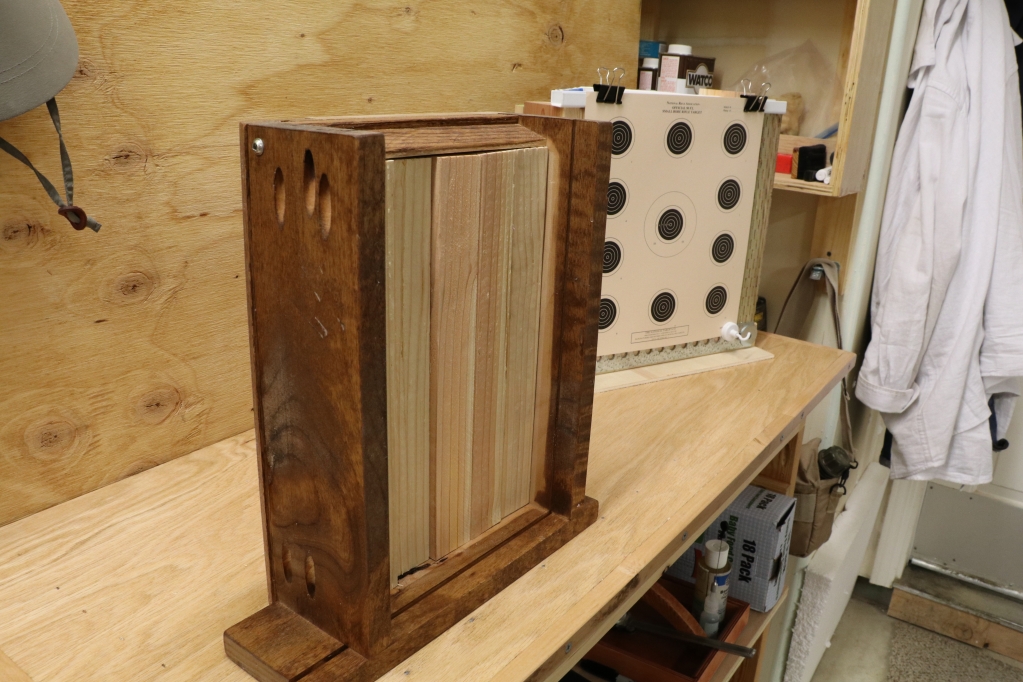

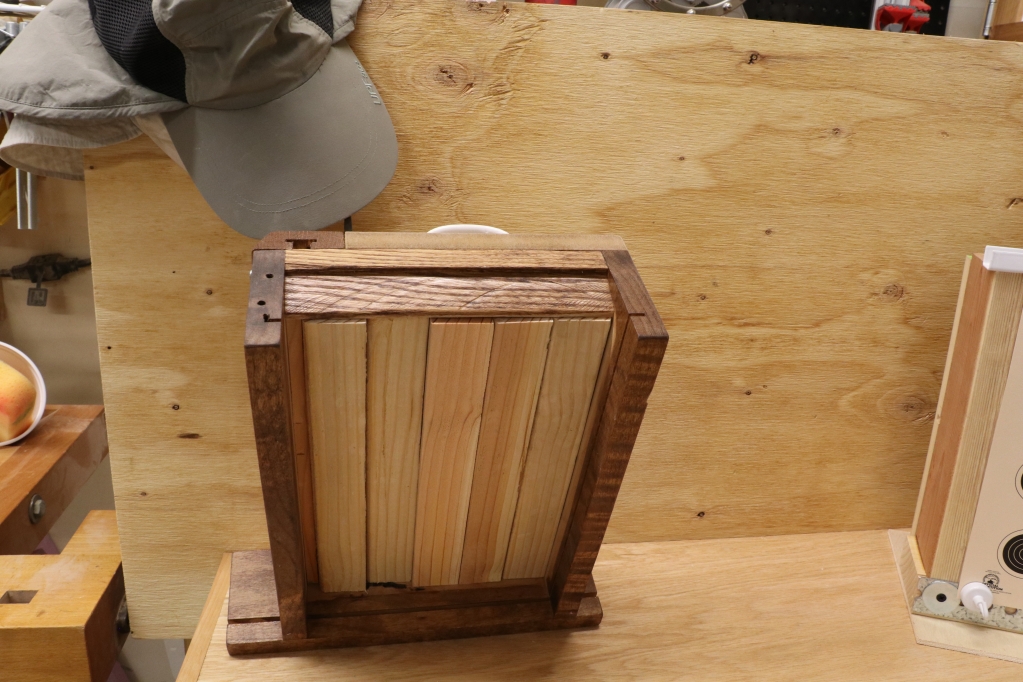

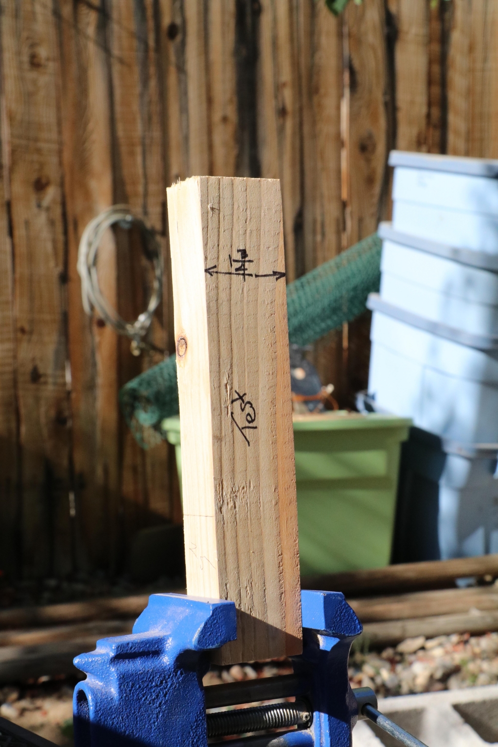

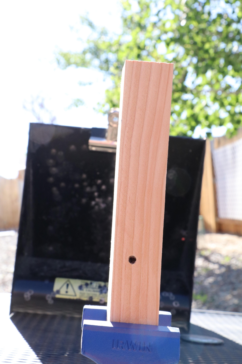

Here is my test of a .25 being shot into the side of a 2x4 which has been cut down to one and three quarter inches . The wood stopped the pellet without a problem. No exit. This test allowed me to build another target box made from scrap 2x4s cut to fit into a box made to hold 8.5 x 11 targets printed from my computer. I use a lot of these targets. The slot to the front is for the target to slide into. The wood is scrap, so a lot of the holes on the box are irrelevant. Now my feeling is this idea is also a failure. Best to use duct seal over the wooden or metal back. Duct seal could be applied over the wood I have added to the box.

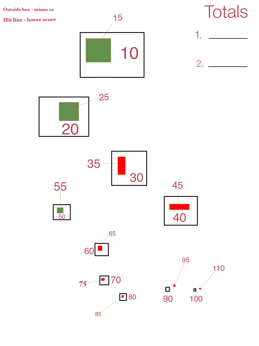

Here is a target game from my tiny brain you might like. It should print on an 8.5 x 11 sheet of paper. It's ten shots. Work down from the top. Hit the line and the shot is "in" for the higher score. Totally miss and its minus ten. One shot per target. Ignore the writing on the target. I still need to fix that. Have fun. Shoot straight, shoot safely.

FINAL FOR MAY 31,2020: BOTH THESE IDEAS FAILED BECAUSE OF THE BULGING PROBLEM. I AM SORRY FOR THE FAILED EXPERIMENT. I DO NOT KNOW WHAT WILL HAPPEN WITH THE 2X4s. While they may not bulge they will probably splinter away to nothing under constant bombardment from the pellets. I DO NOT RECOMMEND BUILDING THE BOX WITH THE 2X4s for a backstop in the box. Just use duct seal or a similar material.
