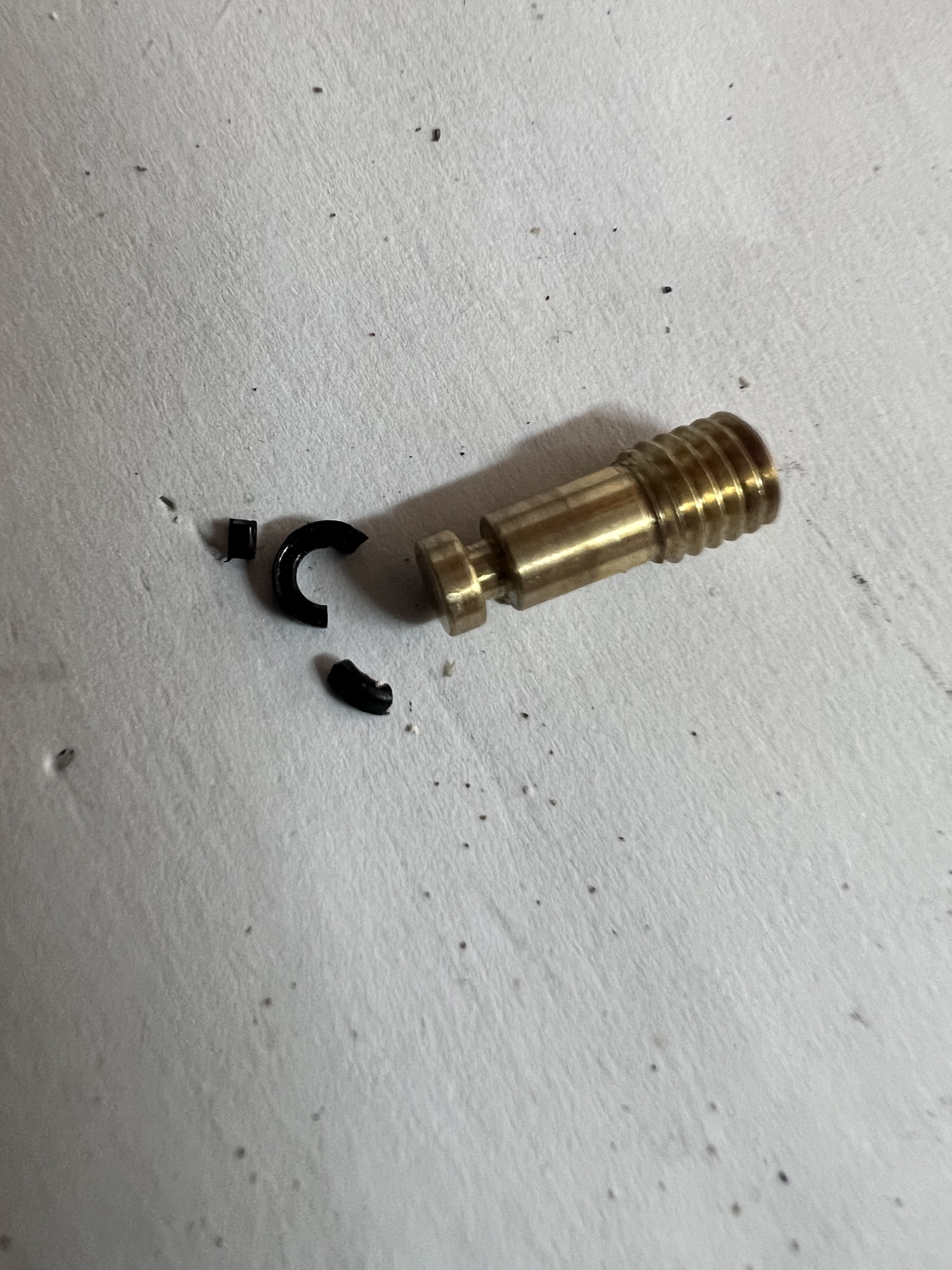

yes but its not rubber, its some kind of plastic. I watched one of Earnest Rowe's videos and he said that he has had to replace a few of them and they are not rubber, they are some kind of hard plastic. I have a couple on order from FX they should arrive this week. I removed my old plastic o-ring this morning and it broke into several pieces. When I removed the plug, the head of it was flush with the block. My M3 has the same set-up and it is flush with the block. Ive attached a pict.

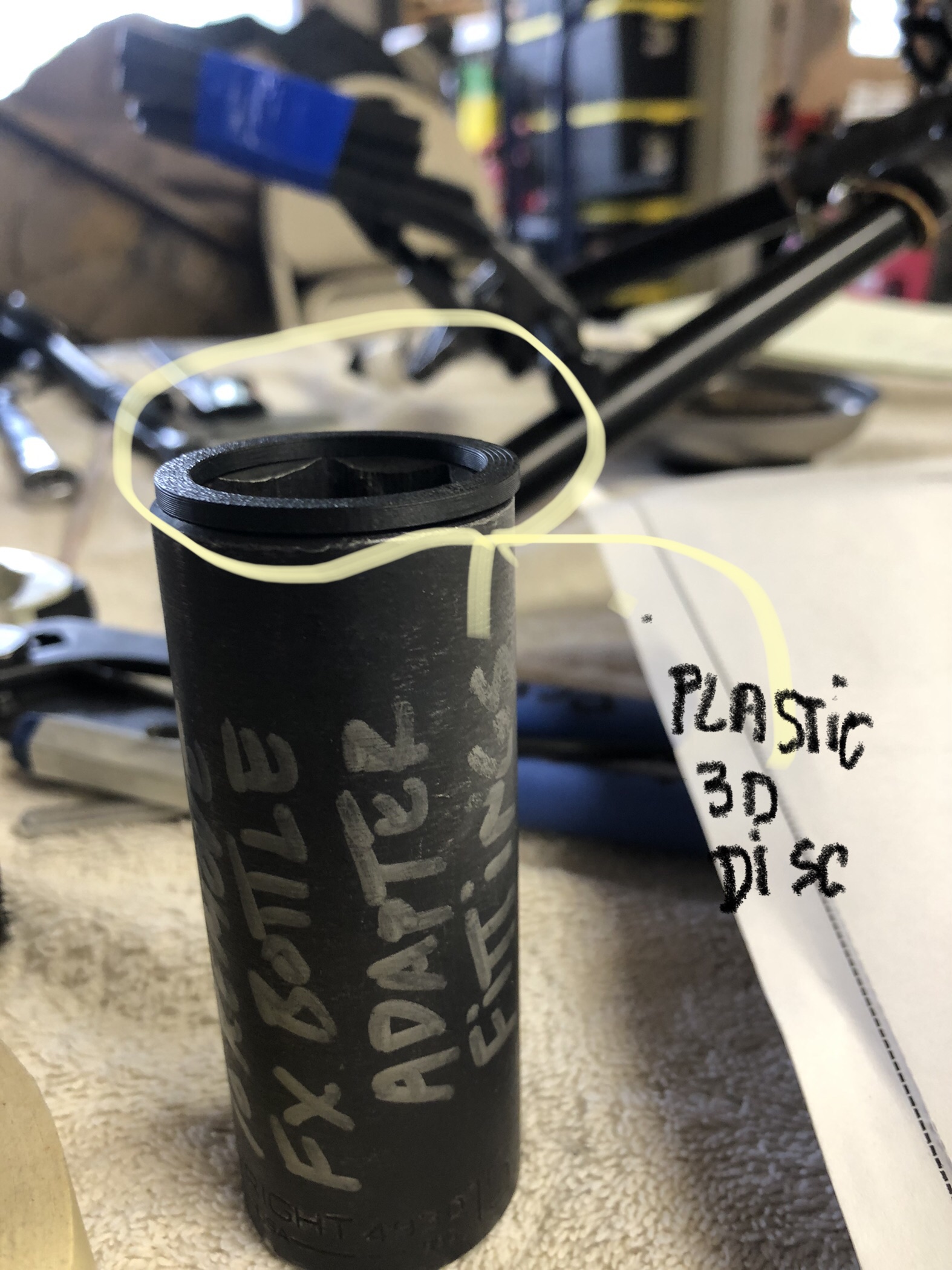

On the bottle adapter, I use a 1/2” drive deep well 15/16 socket, but before even attempting that I drew up a sketch and had my 3D buddy make me a protective washer so the edge of the socket didn’t marr up the trigger block. Mine came off easily, just a quick tap on the ratchet handle with a rubber mallet broke it loose. I didn’t even have the trigger block clamped onto a vise; just had it laying sideways on a picnic table workbench.
