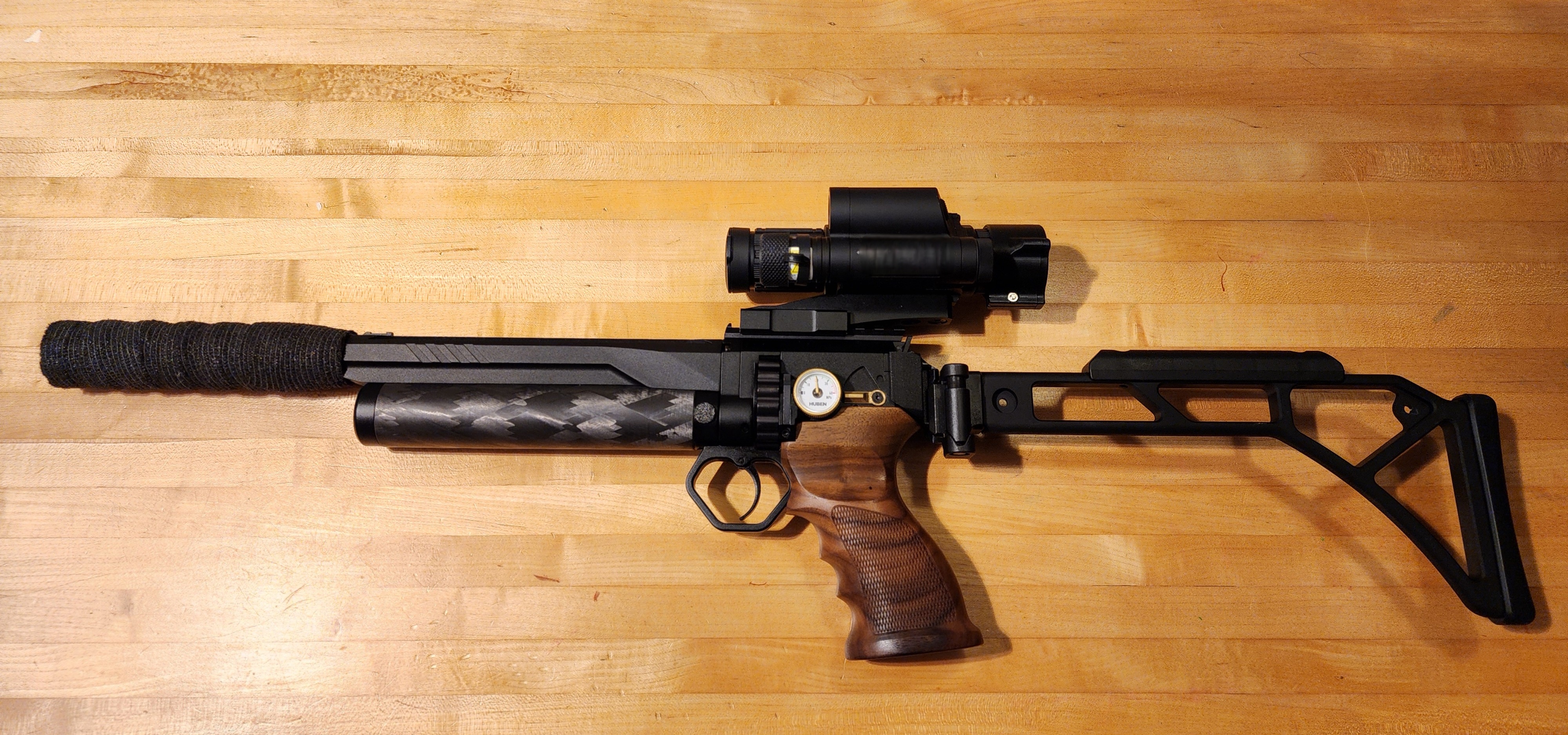

Got my GK1 and been having a lot of fun with it.
I have the SLX 3x mounted on the dovetail with the longest cantilever mount it comes with which is just not enough with its 2ish inch eye relief.
Unfrozen my v3 gk1 does not have the forward screw, which prevents me from mounting the currently available top pic rails, so I have a v1 rmr mount + rmr to pic rail adapter to bring it further back.
I’m currently limited to a 305ish bar fill but I have a pump on order to top it off to 350.

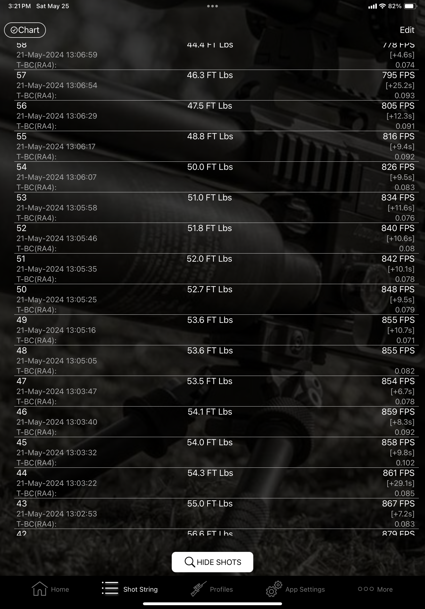

I have found ~56/55FPE on the first shot to be a nice sweet spot for getting through a whole mag without too much drop and a very consistent string of 10ish shots or so.
Here is a shot 17 shot string with Zan 33gr .253 slugs.

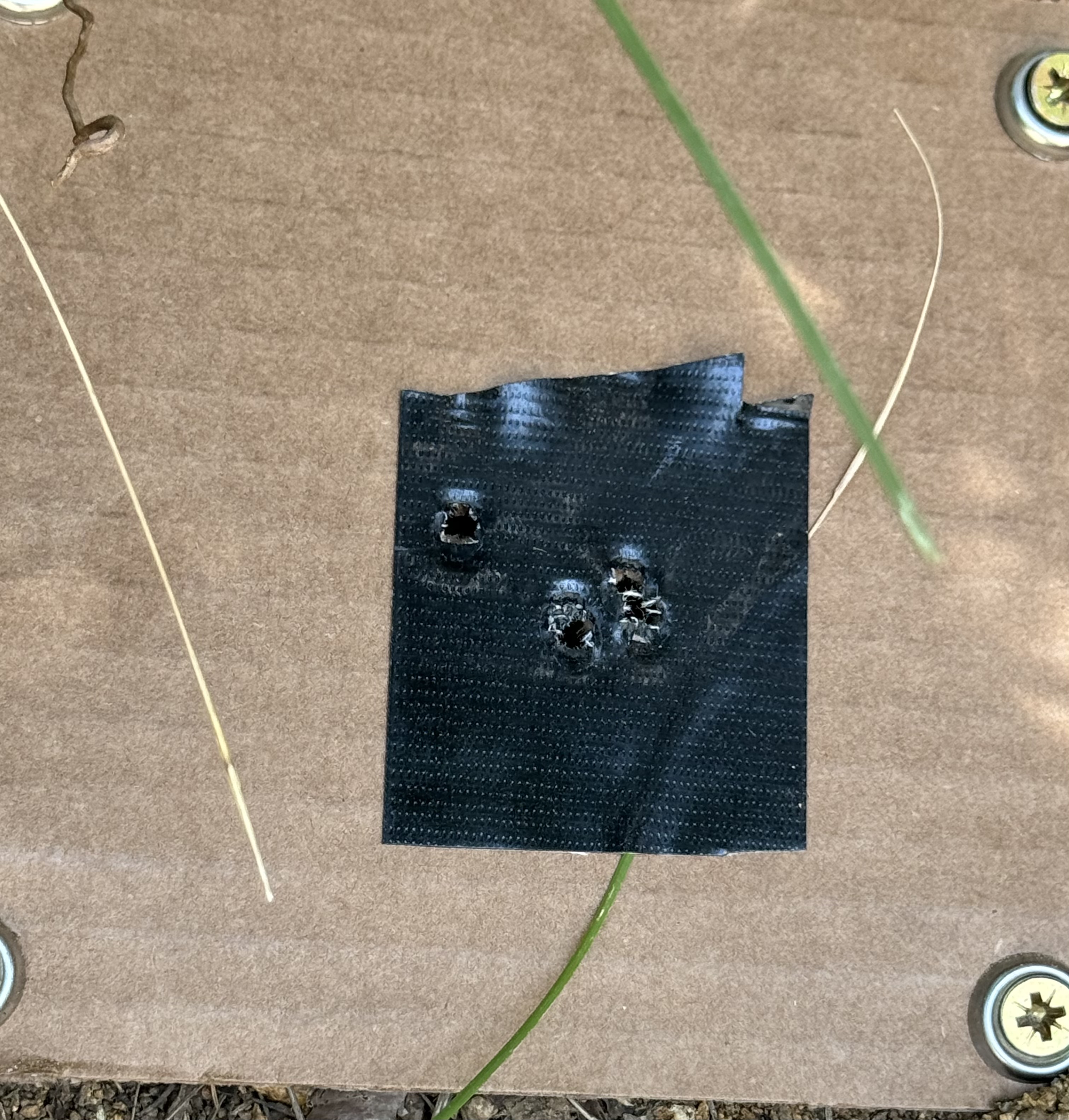

Here is a 6 shot string at 18 yards with the zan slugs starting at a a 300bar fill:

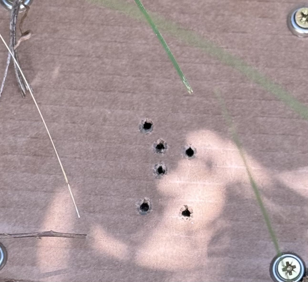

Here is a 6 shot group starting at 300bar fill with the pellets.

They have an R4 BC ~.088 with the first shot at 860ish fps and the 17th shot at 815ish fps when starting with a 350bar fill.

If you are looking to tune your .25 GK1 for maximum performance out of a single magazine with a full 350bar fill, 32gr to 36gr is a very good sweet spot for your ammo.
38gr or higher shoot well, but the velocity will be too low imo, with first shot at 825 fps or lower.
