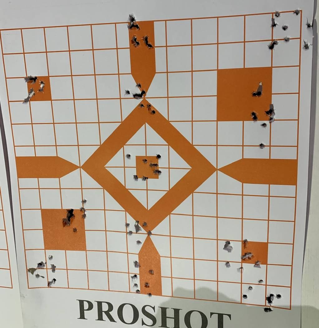

So here are 12x9 shot groups from 245 bar to 140bar, barrel just patched wormed, 94 bar reg, valve at about 2.5 lines and hammer preload at 18.3
I shake because I am old, I think the inconsistency is the shooter, groups start at bottom right, as usually, indoor range at 100 yards, target grid is 1 square foot.
I should be happy with just 5 shot groupings, but indoors it might be considered cheating, so 1 out of 12 moa groups! It’s not easy and it doesn’t happen every day, but it does keep me coming back!
