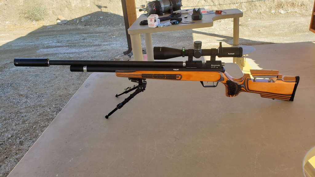

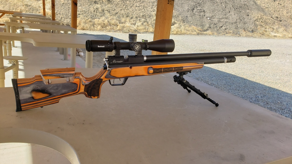

First shots today!
The only OEM parts here are the breech, air tube and trigger...
  • 26" TJ Barrel 1/14 twist from mountain air customs
  • carbon fiber shroud from Neil Clauge
  • Donny FL Sumo
  • Huma regulator (large plenum version)
  • Cothran Valve
  • Boyd's pro Varmint laminate stock
  • Bushnell Forge 3 - 18 X 50 scope
  • Huma replacement fill port with gage
My goal with this build is to shoot heavier slugs (50 + grains). I'd like to get them in the 900fps range for long distance shooting (no practical reason. I'm just having fun)

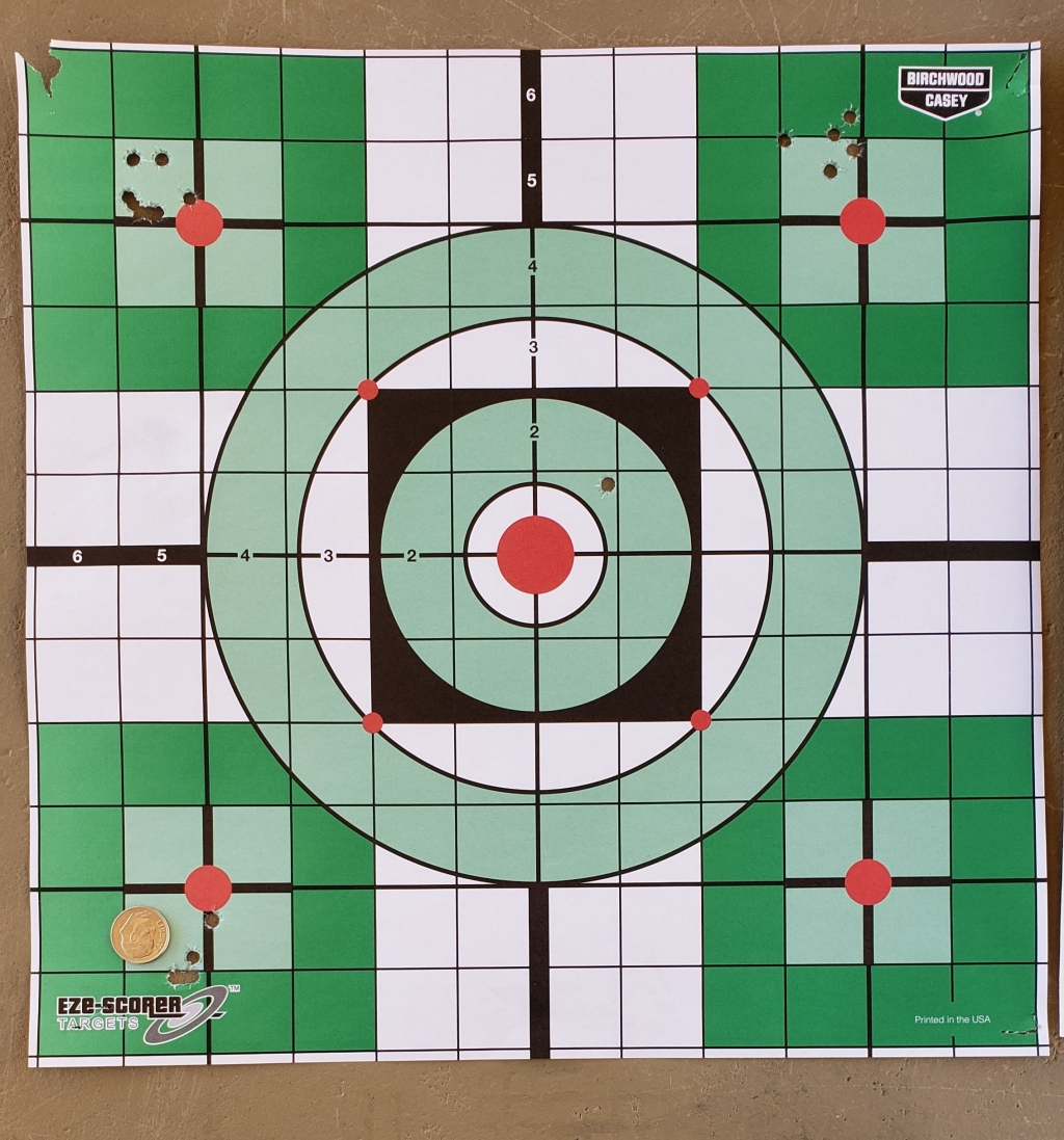

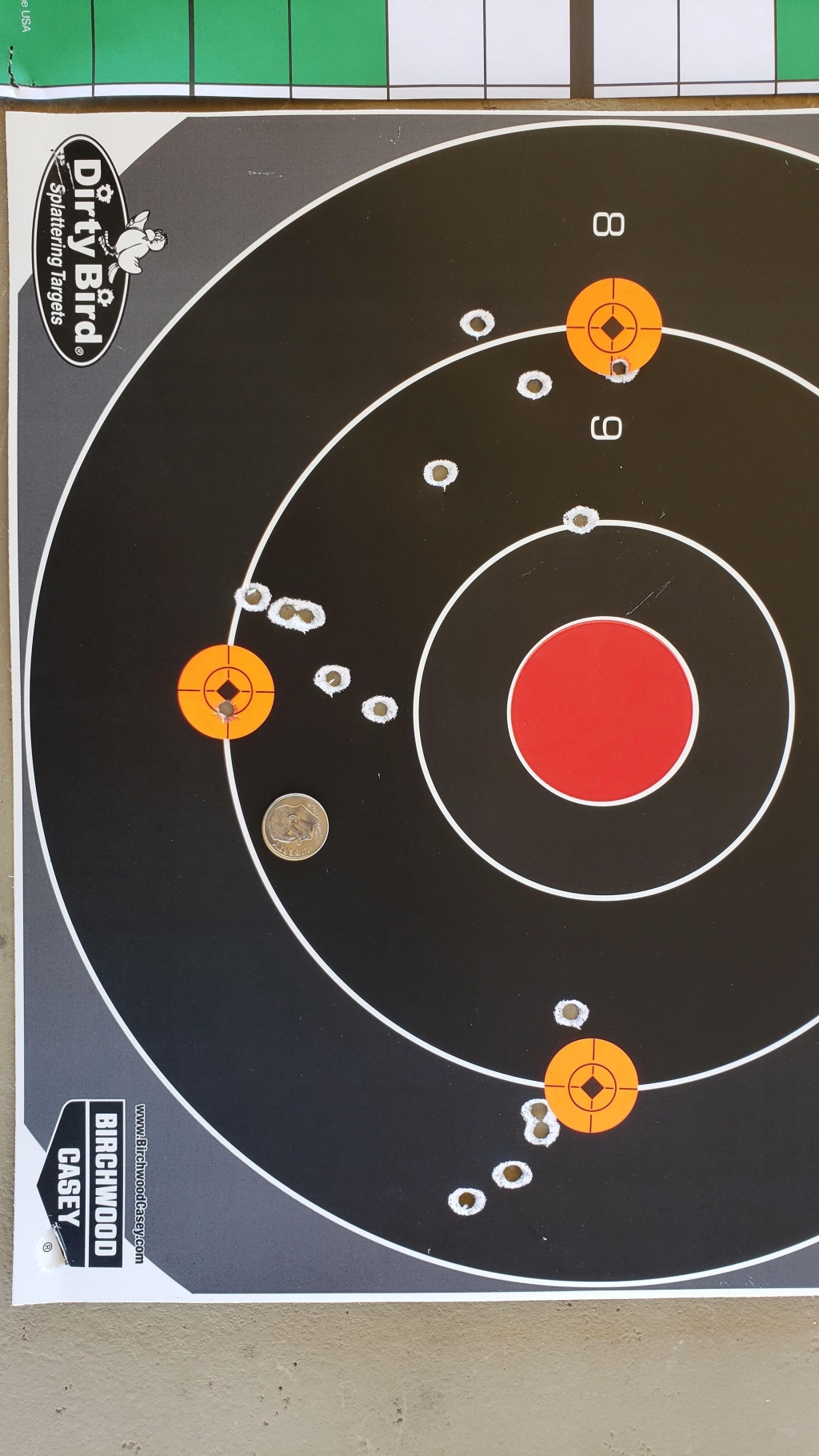

I took my first shots today. Below I'll post some 50 and 100 yard groups; so far the accuracy is promising, but I'll need to do more to get the power and efficiency to where I'd like. The 52grn boat-tails are running right at 800 FPS. Reg is set to 150 bar and I have drilled the transfer ports to .187. Using the stock hammer and spring, with my own free flight device the velocity stays the same no matter how much preload I put on the spring. I've got a hill airgun hammer that's a little lighter weight and I've purchased a TSS from a forum member which might give me a little more adjustment capability. The problem is in order to get the power I'm shooting for I think I'll need to open up the transfer port even further. I'm Using a Teflon tube (bought from Tim hill) that set up fits perfectly into the existing transfer port design and gives the largest diameter I can get given the amount of room available. Does anyone have tricks or advice on how to open up the marauder ports even further?
50 YDS
100 YDS

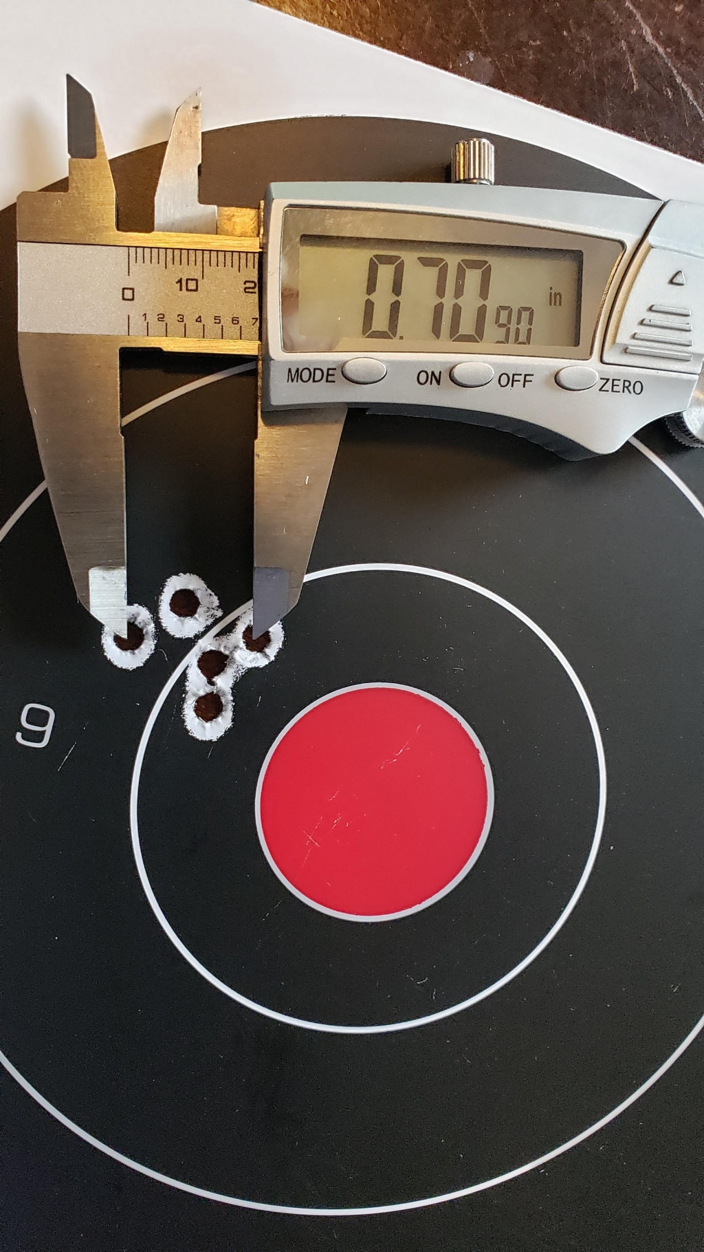

It's been a while but making some progress.... shot this group today at 100 yards with the Nielsen 52 grain boat tails. I've been testing a lot of pellets and most fall into 1.5" to 2.5" groups at 100 but the boat tails are the most consistent.
