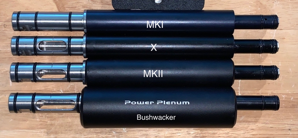

I have successfully installed an early sample of the Power Plenum kit on my Impact MKI and have been testing it in the last couple of days, just registered on AGN to answer some of the questions and share some experiences :)
First of all the upgrade kit is compatible with all generations of the Impact and does not require any additional parts for installation, all the necessary parts are included in the kit.
Here's an image of the new Power Plenum and valve housing compared to the older models, like with the latest MKII housing the valve seat is now fixed.
