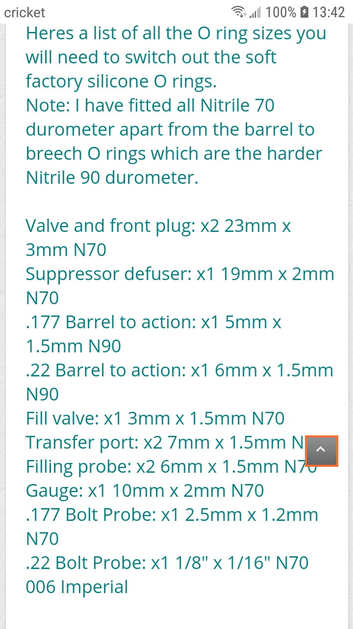

I'm in the process of adding a regulator to my Kral puncher breaker, tracking says it will be here 12/31... First step is ordering the regulator. I ordered a Huma from here. It takes about 2 weeks coming from the Netherlands .
https://www.huma-air.com/Kral-Arms-Puncher-Breaker-regulator
Next use the oring list below and order all the orings needed. I use the oringstore.
https://www.theoringstore.com/store/
Then watch Troy's disassembly video and follow the instructions, going as far as removing the valve.
https://youtu.be/5s-0c50sn5E
Follow the instructions for installing regulator, then put your gun back together making sure to use a good silicone grease for the orings.
If your gun has never been disassembled you may need a heat gun for the threadlock Kral uses on the air cylinder.
