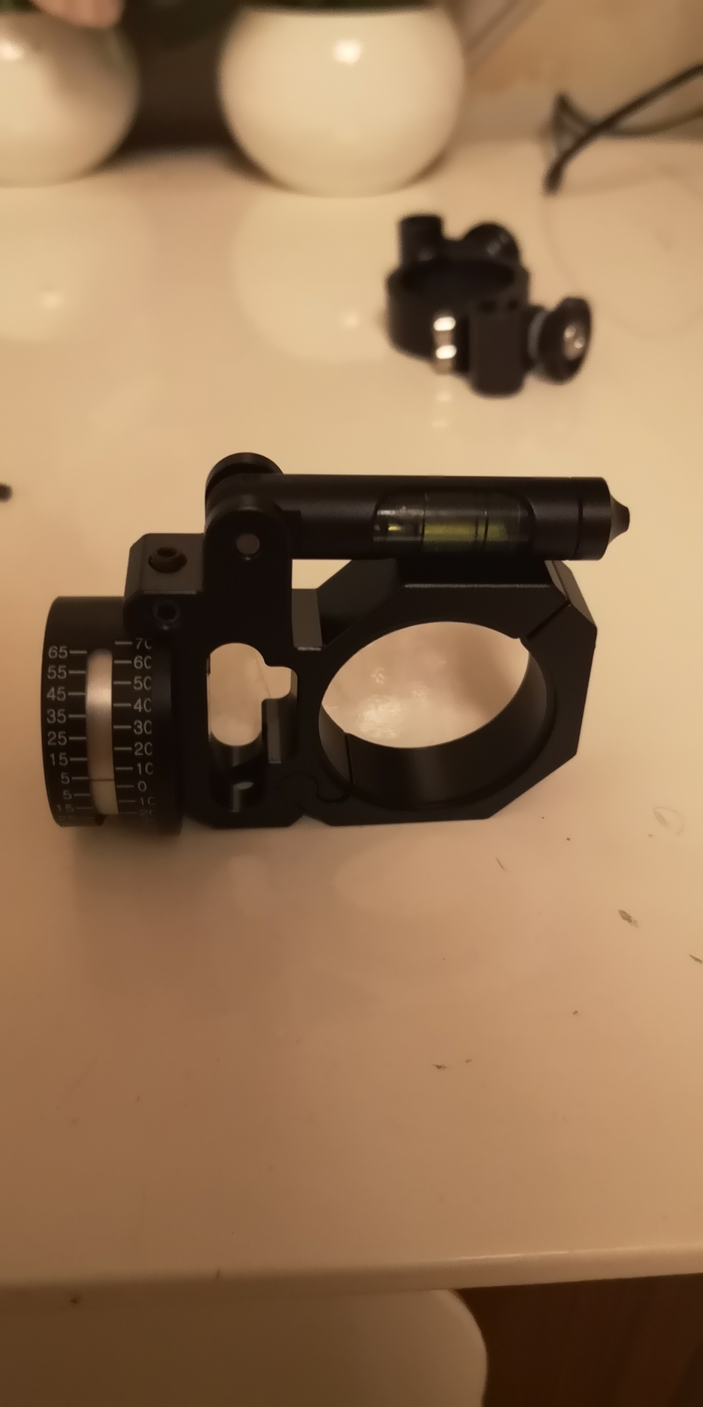

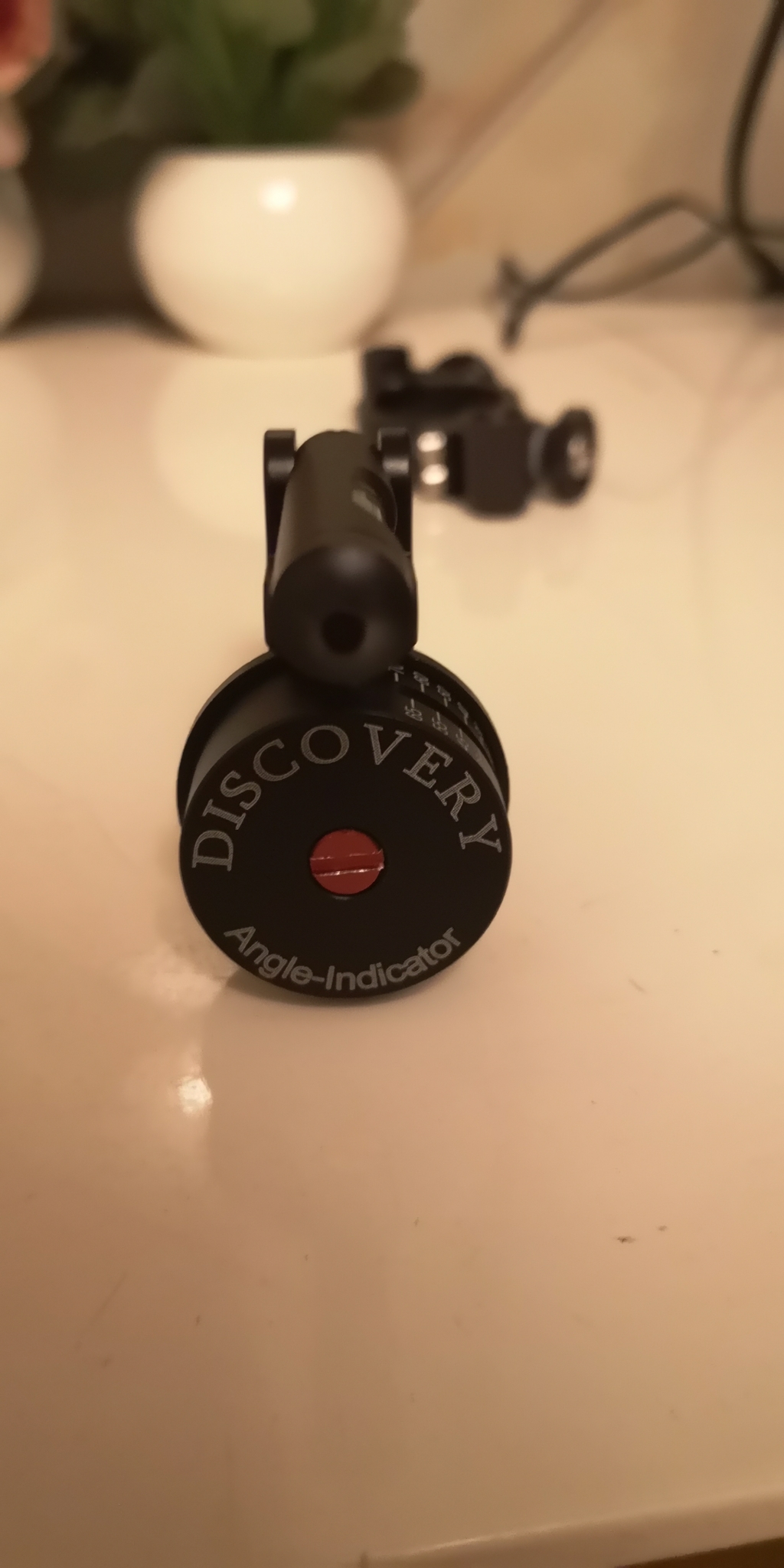

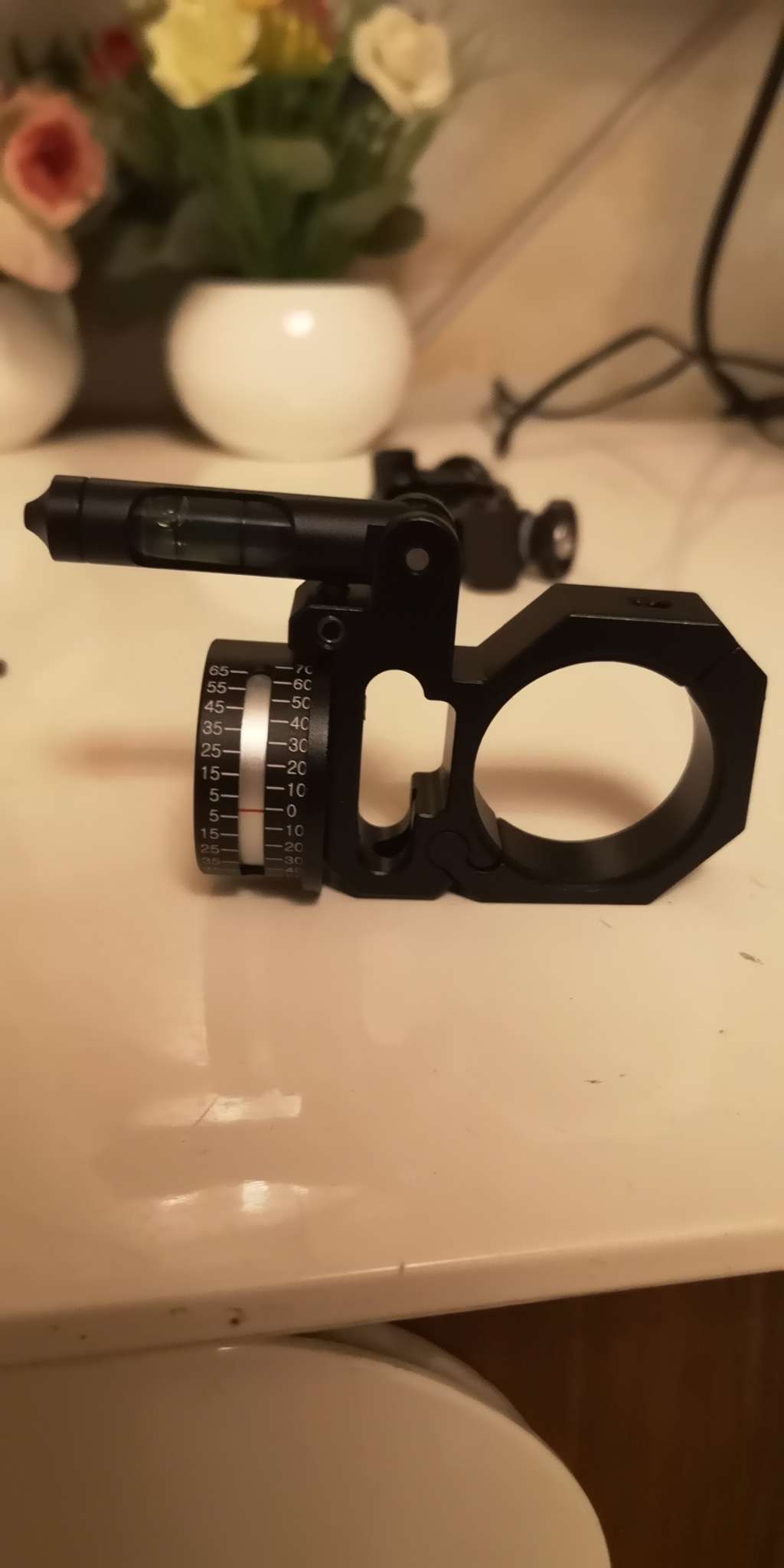

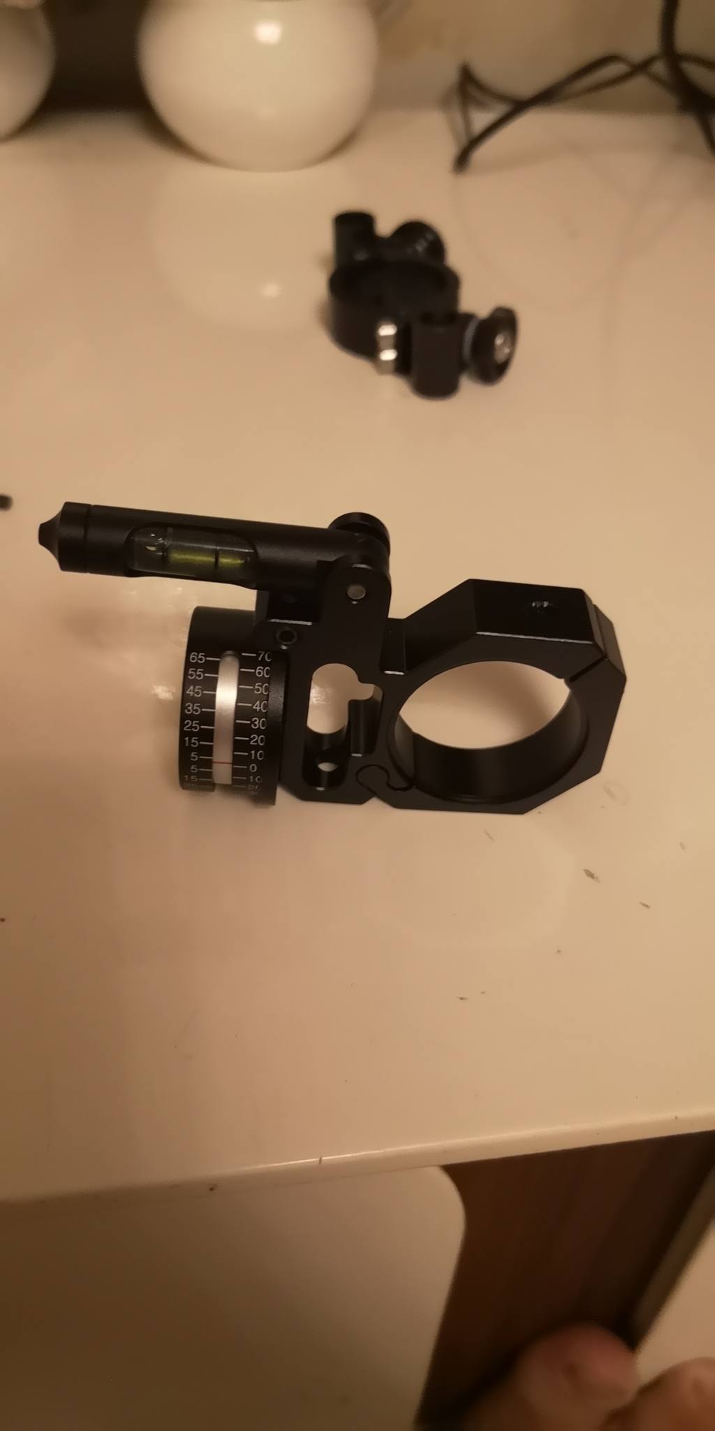

I found a very fun thing, angle + level. Only 15USD is needed in China

I have the same one, different name, and I found that I could not see the level half of the time because it was too dark. I unscrewed the tip, took the bubble level out and drilled and Dremelled out a matching hole on the front of the view window. Now light comes through making it really easy to check your cant. Just a thought, fwiw
Nice simple idea. I don't use levels regularly these days because it has gotten hard to see them clearly but I did have a similar unit mounted on a long range CF rifle several years back. They can be helpful if one takes the time to learn to use it.
