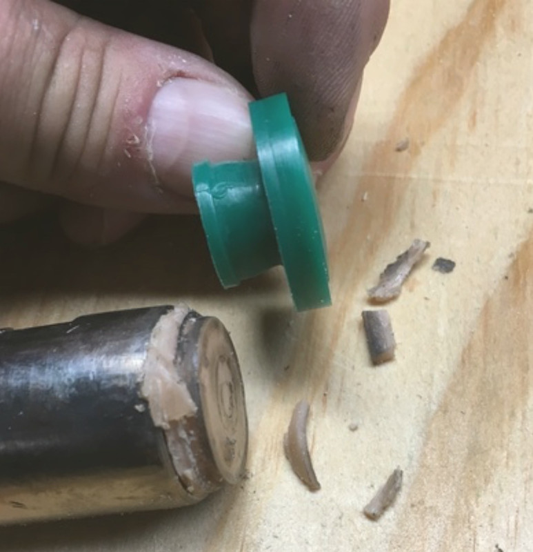

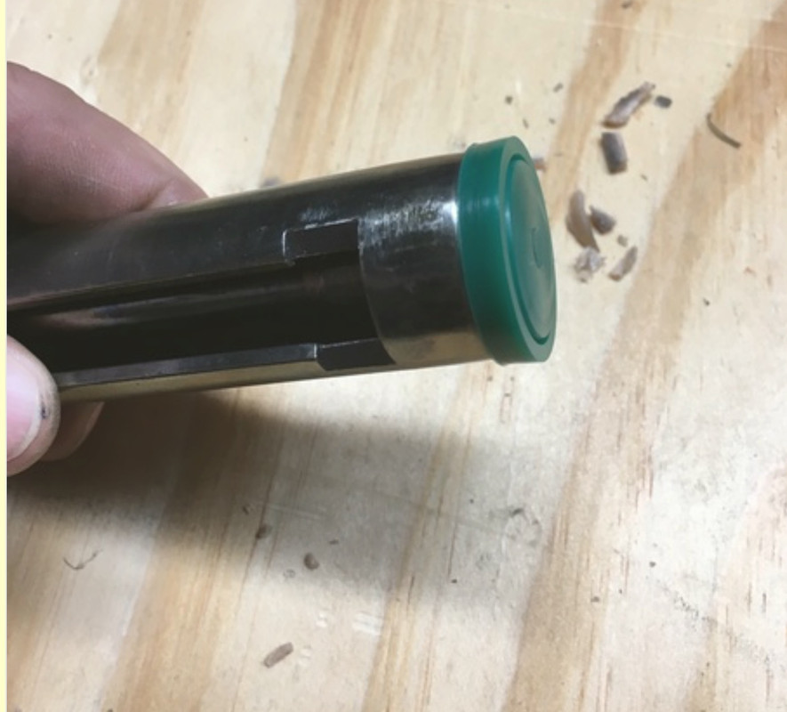

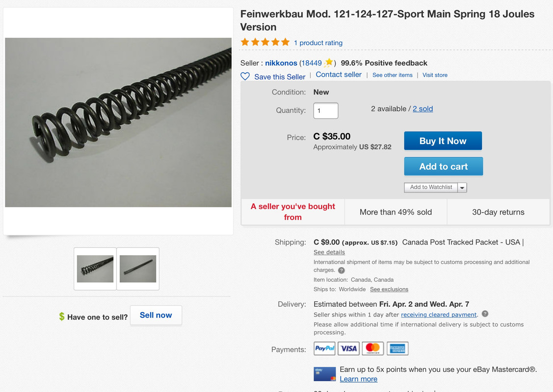

Thanks guys. The green seal came from a reputable place, like Pyramyd Air, etc, the spring was a brand new 18-Joule model from Nikko's in Canada, and looked almost identical to the original spring. The seal was tight at first and I carefully reduced the diameter on my lathe to where I felt it was a perfect fit. Then a light lube only on new spring and rearward of seal face. I confess it was my first tune, and maybe I didnt take enough off the seal? The rifle is smooth as hell, just can't get her past 630 fps with an 8 gr pellet.

That seal m is the same as mine. When I had my barrel off to replace the pivot bolt I could shine a light down the transfer port and see my seal is green. It's true most 124's hover in the 12 ft lbs range. Light pellets tend to produce the higher energy figure. With the JSB's mine is in the 11.8-11.9 range. Will easily do 12 with light pellets. Some special tuned 124's can hit 13 ft lbs. I'm thinking your spring and/or the breech seal is the problem.
