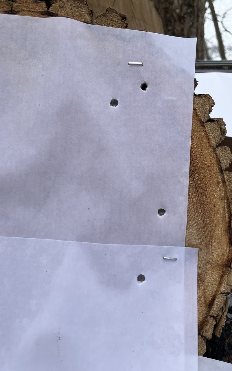

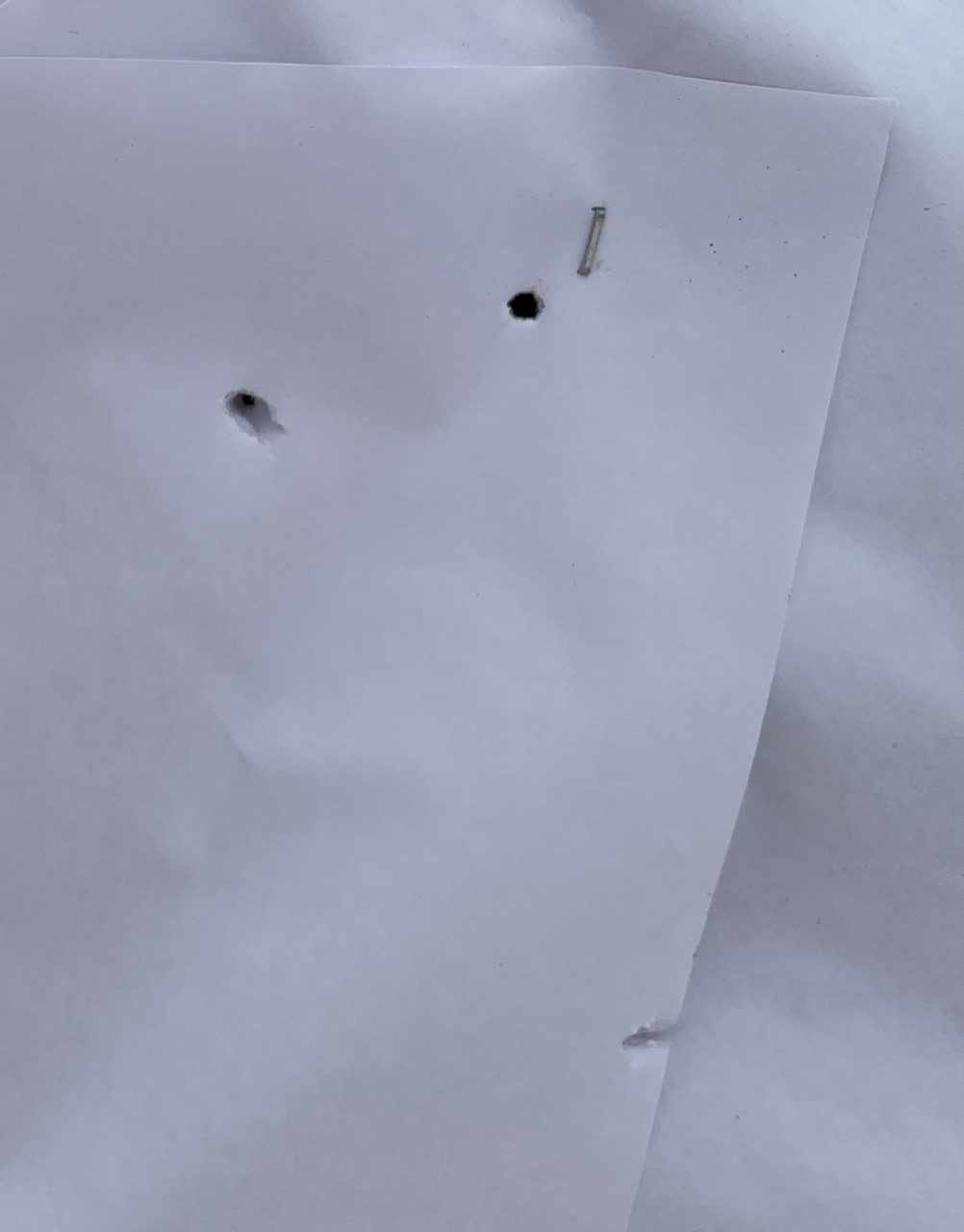

Bummer! Sounds like the barrel is tapped out oUt onĀ Twist rate! I had same experience asĀ @steve123 with the 29 grain, if the wind change a little the groups open up at 300yard, of course the 34.9 grain does the same thing but not quite as bad.Ā
Either way Iā€™mĀ a gluten for punishment, Iā€™m goingĀ back to 27.5 grain .22 slugs(slightly lower BC than the 29 grain .25)Ā at 300 yards so a MOA group at 300 wouldĀ take a miracle. šŸ˜…

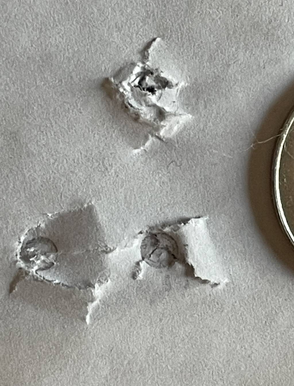

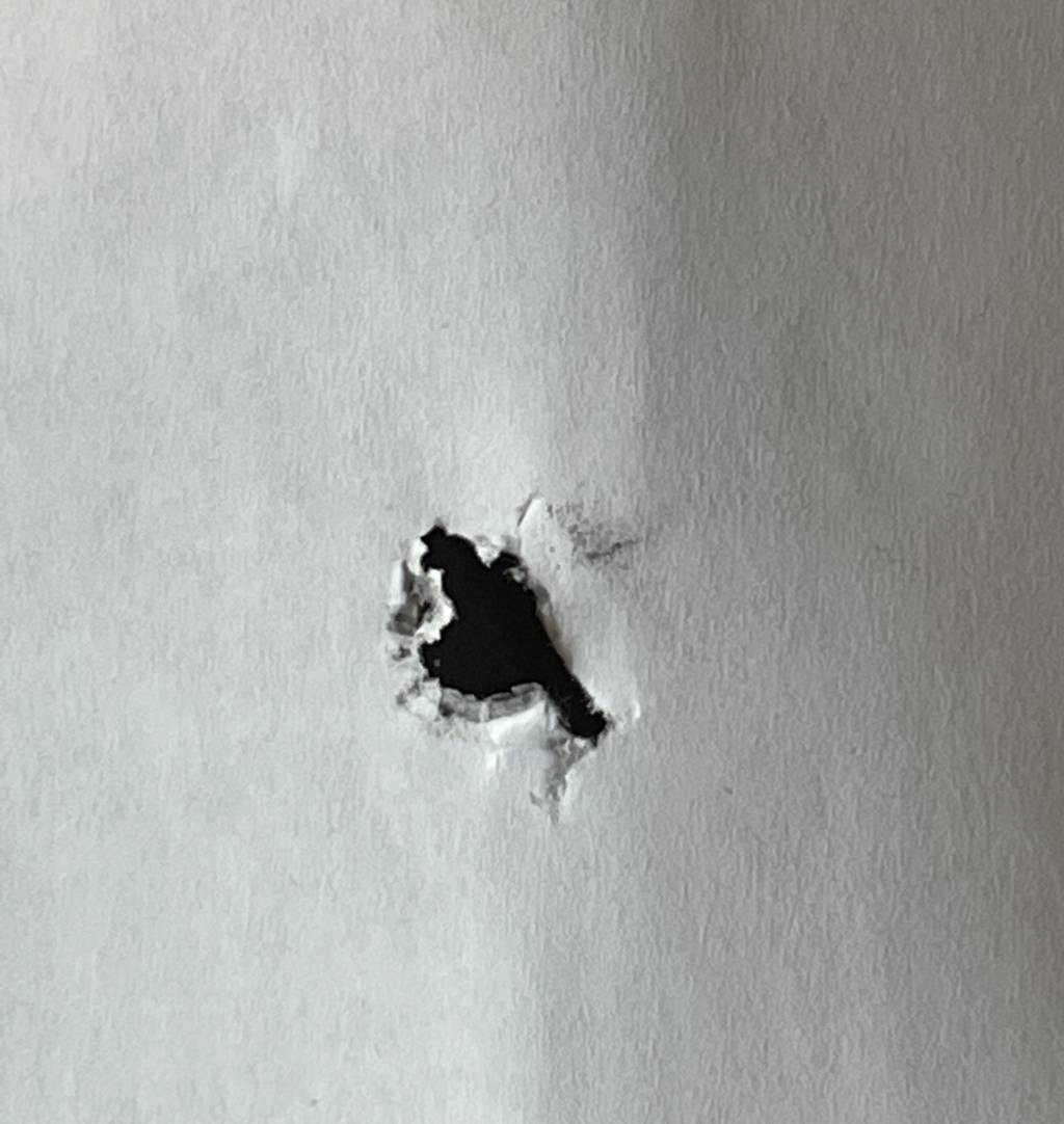

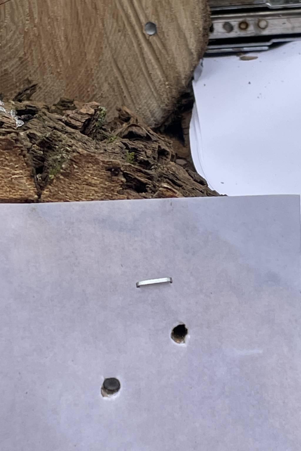

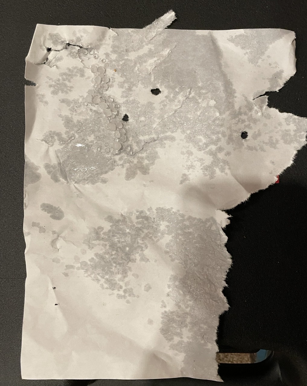

Again, going back to your comments. I took another look at the 300 yardĀ groups.
Look at the impression on the paper. Thatā€™s the hollow point diameter. The point hit and pushed its way through. Obviously there was no log immediately behind the paper.
Apparently you find this interesting, when thereā€™s no chipmunks to shoot. Hope youā€™re doing well.

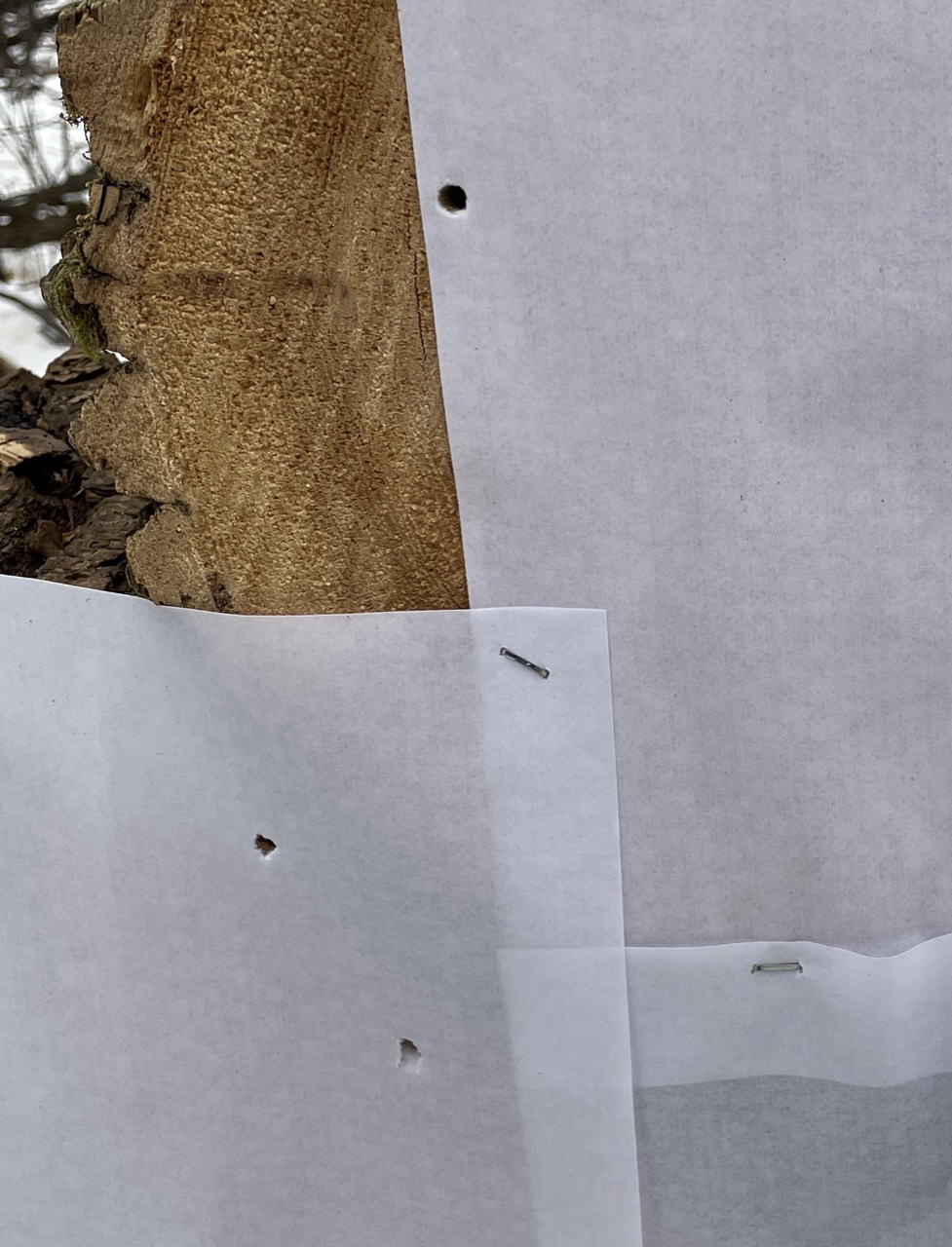

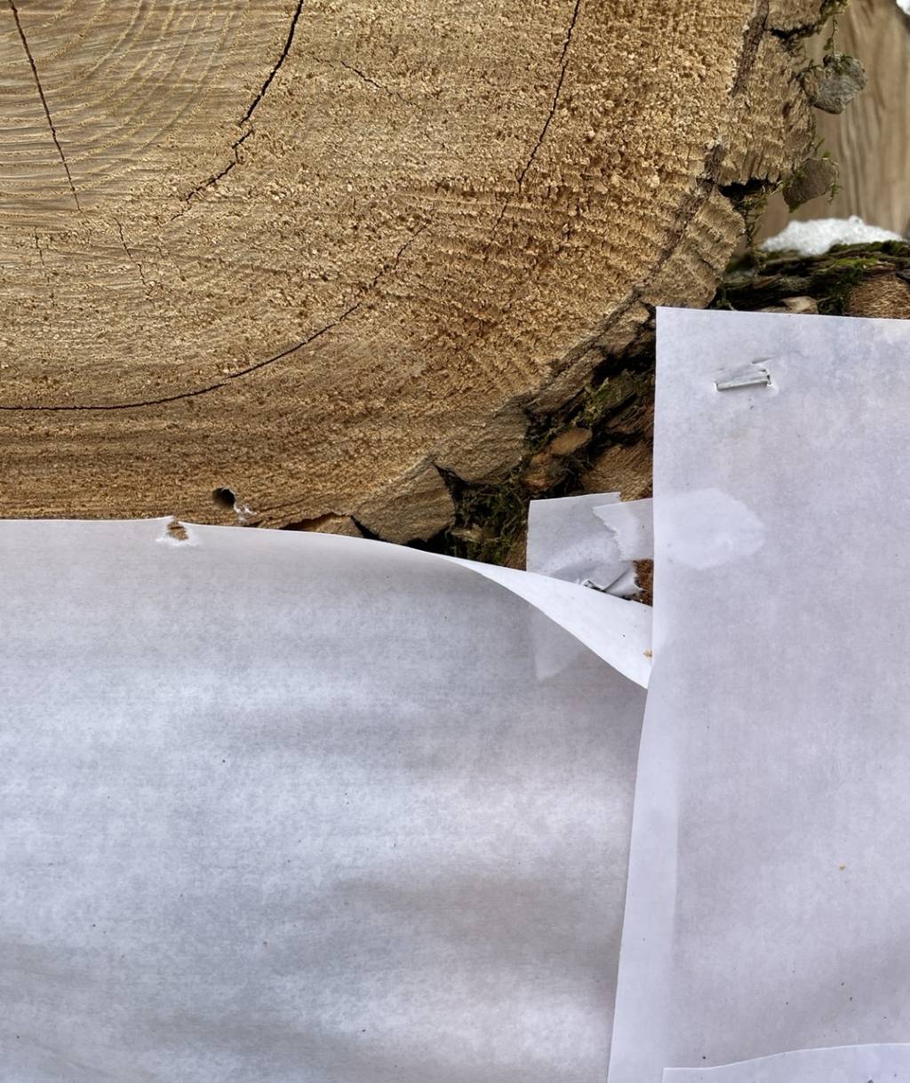

I left the pictures full-size.
mike

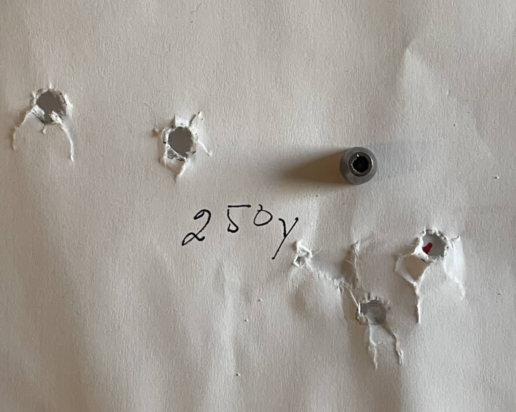

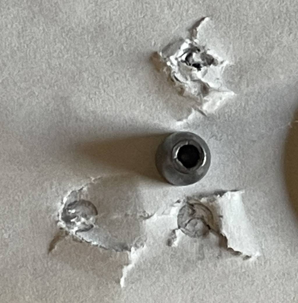

Adding a 250 yard close up below
The picture below, two slugs hit right on top of each other. You can see the impact from the piece that sheared off on the upper right. This was at 300. Still plenty of energy.
Ouch! LOL!

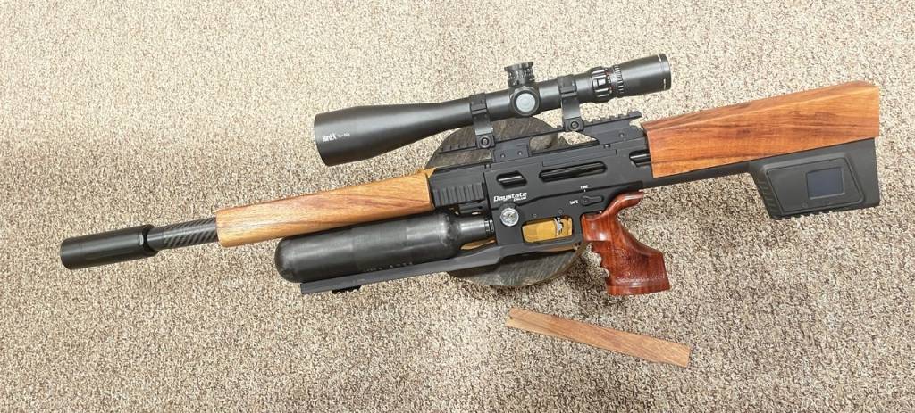

Hereā€™s a picture with the new scope installed, just ignore the wood, Iā€™m just fooling around.

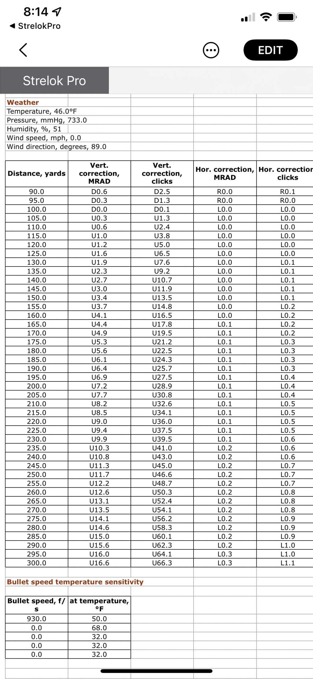

Mike, what if I told you there is a magical way to get on paper on the first shot.............
1f440.svg
LOL! I've been trying to get Mike to use strelock pro without success for a while now. Granted he wasn't able to convince me to get a Delta Wolf either. Hahahaha
@qball Aww man. I thought you were gonna share some sort of secret sacredĀ VoltigeurĀ technique or something.Ā
@Flintsack Why theĀ aversion to useĀ Strelok?
Ha! Too funny. Shambozzie has been trying to convince me to get Strelok for months! Iā€™m way too resistant to new technology because itā€™s intimidating to anĀ old guy with no computer background, or skills. Iā€™m still struggling with plascam and Iā€™ve had it for years lol. Shambozzie finally asked me for the information needed to set up my Rapid .20 and I sent it to him (bore to crosshair measurements and pellet weight etc.)
He figured it out on Strelok and when I tried it out it was right on! Now I can see how magic it really is and I know Iā€™ll be needing to use it. So much time and ammunition saved by math and computer!
Iā€™d be happy to give my information to someone if they could plug it in the street lock for me. Iā€™m 3.5ā€Ā inches above the center of the bore at šŸ‘ piece.Ā
Dead on at 100 yards. 29 grainĀ 25 caliber slug at 930 ft./s.Ā

3.5 inch seems awfully high. Can you measure from top of the objective bell to either top or bottom of the barrel? Then measure the diameter of the barrel and the bell. I can send you the dope/drop table once you get that part measured.Ā
