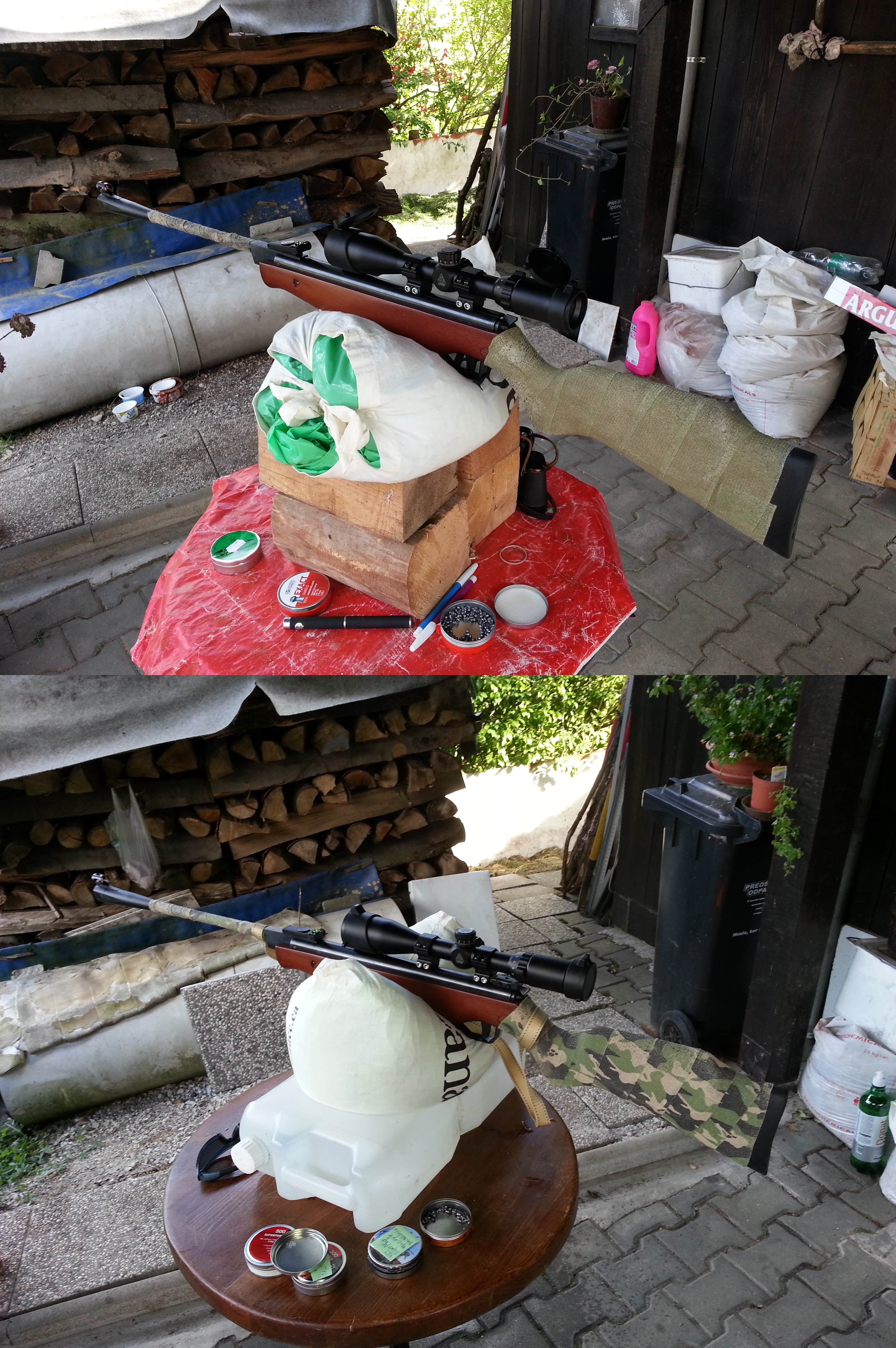

Here are some pictures of this rifle of mine, that I once had and loved so true:
The rifle up above on this last one is a heavily customized Slavia 631, with the model 634's cylinder/receiver and internal components.

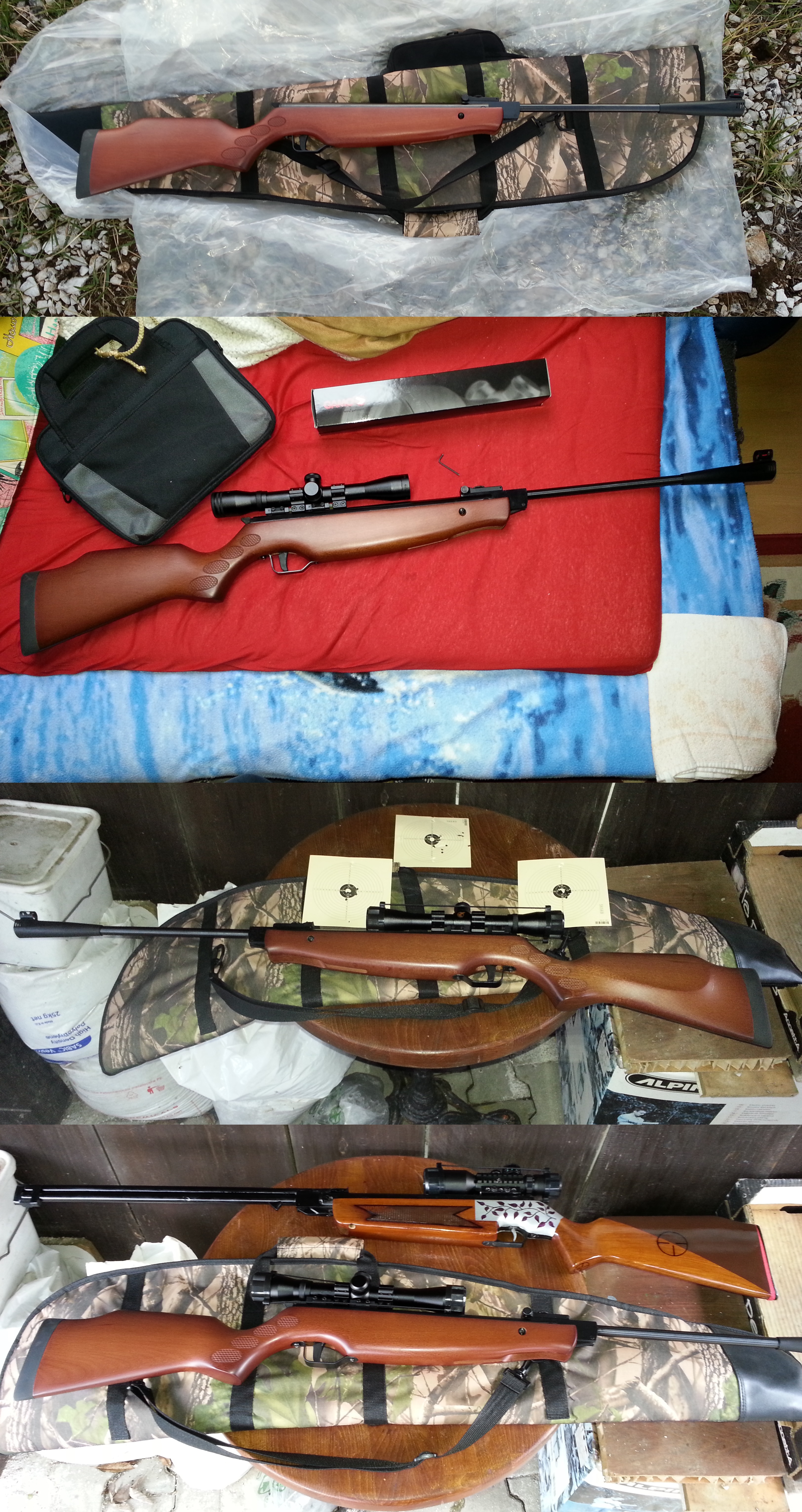

The general overview of the gun:

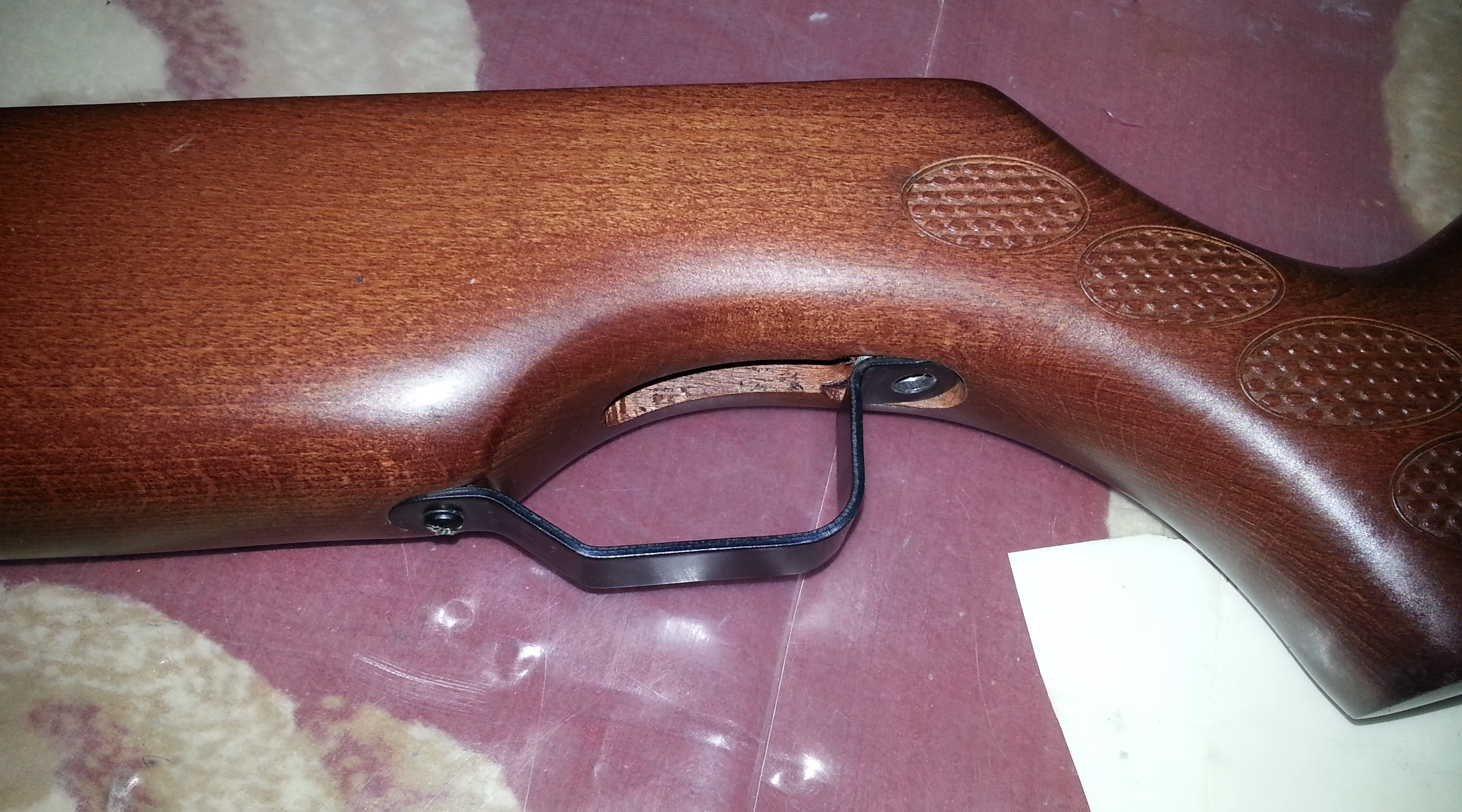

When I first took the gun out of the box, I immediately noticed the nice, bulky, traditional wooden stock that lacked any chequering or serrations forward
of the grip area whatsoever. At the grip area, the stock had four circularly patterned chequered embossements or otherwise panels, from which the stock
narrowed down and then opened up towards the cheekrest, which was nothing fancy, a straight cheekpiece that followed along the downside taper of the
rear end of the stock to the buttpiece, which was apparently made from some kind of dark-grey coloured, hard rubber, which was poorly refined and was
already falling apart in some areas when I took the gun out of the box (Note that the gun was bought new and unused!);
The overall finish on the gun was pretty smooth, save for a couple of areas on the cylinder, which had rough burrs and some scratches that the tooling left behind, but other than that, the blued finish looked quite fine, without any significantly visible tooling marks. One of the things, that I kind of overlooked, but quickly came to realize would become a problem, was the lack of a recoil-stop pin hole, which was absent from the dovetail rail. When I went to try the gun out, I mounted a Gamo 4x32 WR scope with two-piece mounts on the gun and sighted it in, but after a while I wasn't able to hit my targets any longer... And that's when I noticed that the scope had crept back a fair amount and almost sank - it didn't, but if it had, it would be due to the rear mount losing contact with the rail entirely. So then, I took the scope off and only used iron sights for a while, until I figured out, that I needed a one-piece mount and so, I ordered one and then the problem went away. I was very happy to be able to scope up the gun again

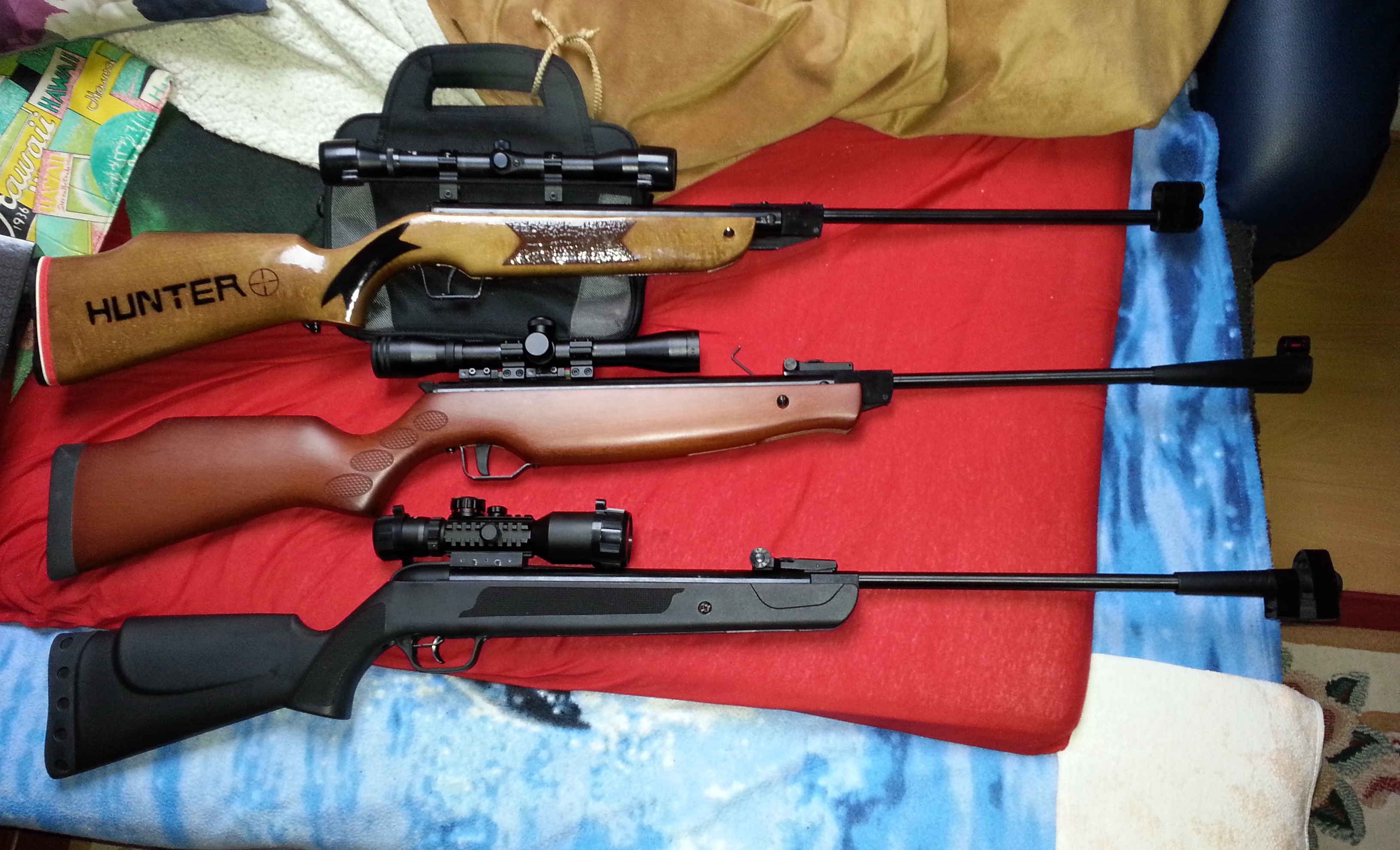

From top to bottom, the guns portrayed on this image are the following: Cometa 200 (with Frankonia Jagd 4x28mm), Cometa 300, Kandar LB 600 (w/Illum 6x40mm w/illum. reticle)

I hope you can see the washers under the trigger guard plate, those were a must in my case:
As you can also see from the image above, the varnish is rather soft and fragile in certain areas on the stock and has by the time I was done with the rifle,
also worn away or otherwise imprinted into the wood.
