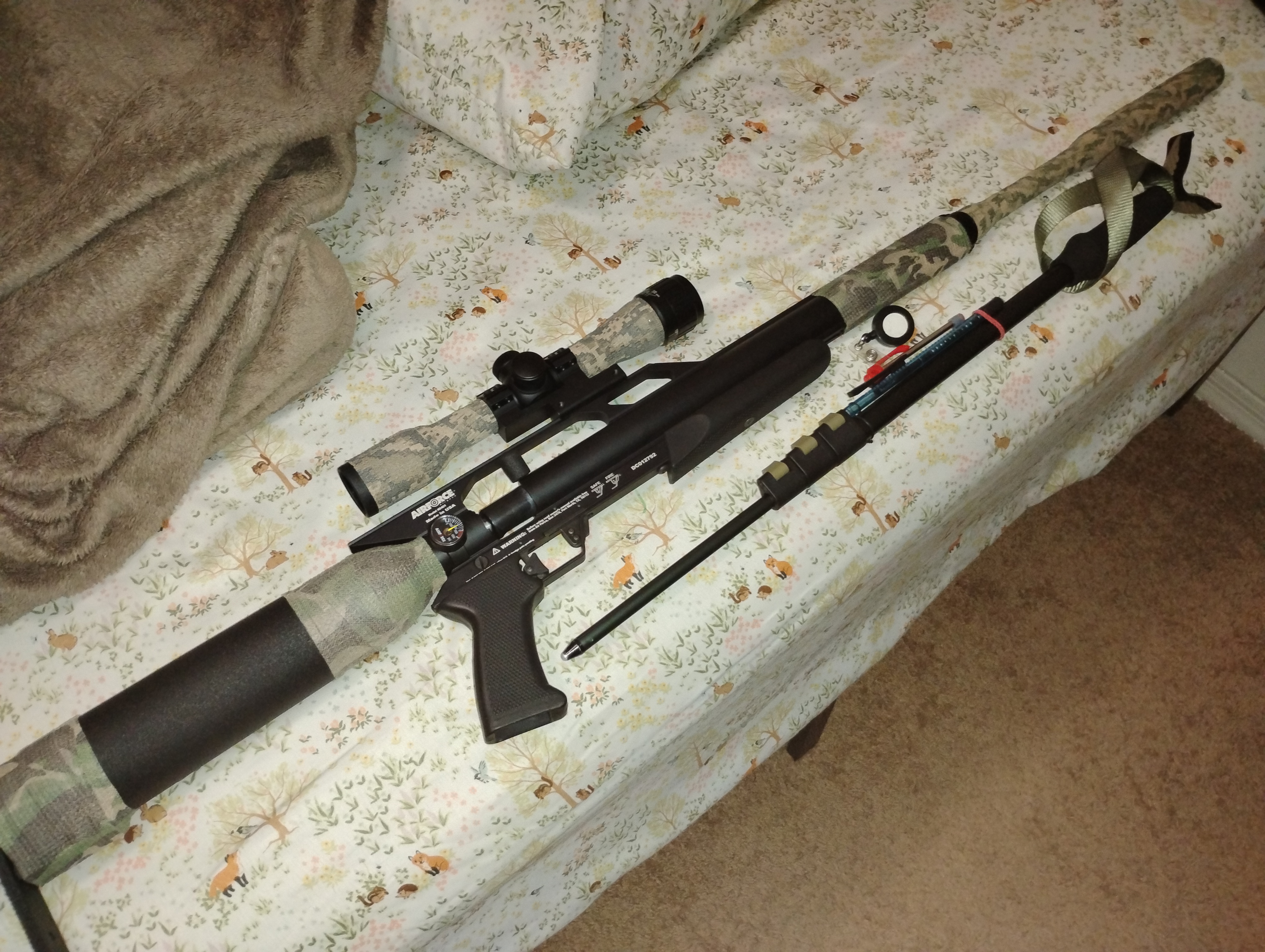

Since there isn’t much data available about the Condor .177 on the internet, here are some specs I gathered tonight after my first shooting session, for anyone interested:
I’m using a .123 top hat, not the .166.
At 2600 psi, with power wheel set to 3-1, using Crosman Hollow Point 7.9 gr pellets, I got velocities from 1080 to 1099 fps. With the power wheel set to 1-6, I got 1033–1037 fps, so I’m currently using PW 1-6 to test for accuracy.
At 22 yards, within the 2600–2500 psi range, the pellet trajectory was very poor and I couldn’t zero the scope. Once the pressure dropped to around 2500–2300 psi, accuracy improved and I was able to zero the scope. The group size was around 1 inch vertically.
When the pressure dropped further to around 2250–2000 psi, the gun shot noticeably harder and much louder — both the gun’s report and the sound of the pellet hitting the target. I was able to shoot Crosman HP 7.9 gr pellets into the same hole at 22 yards using just a monopod in a kneeling position.

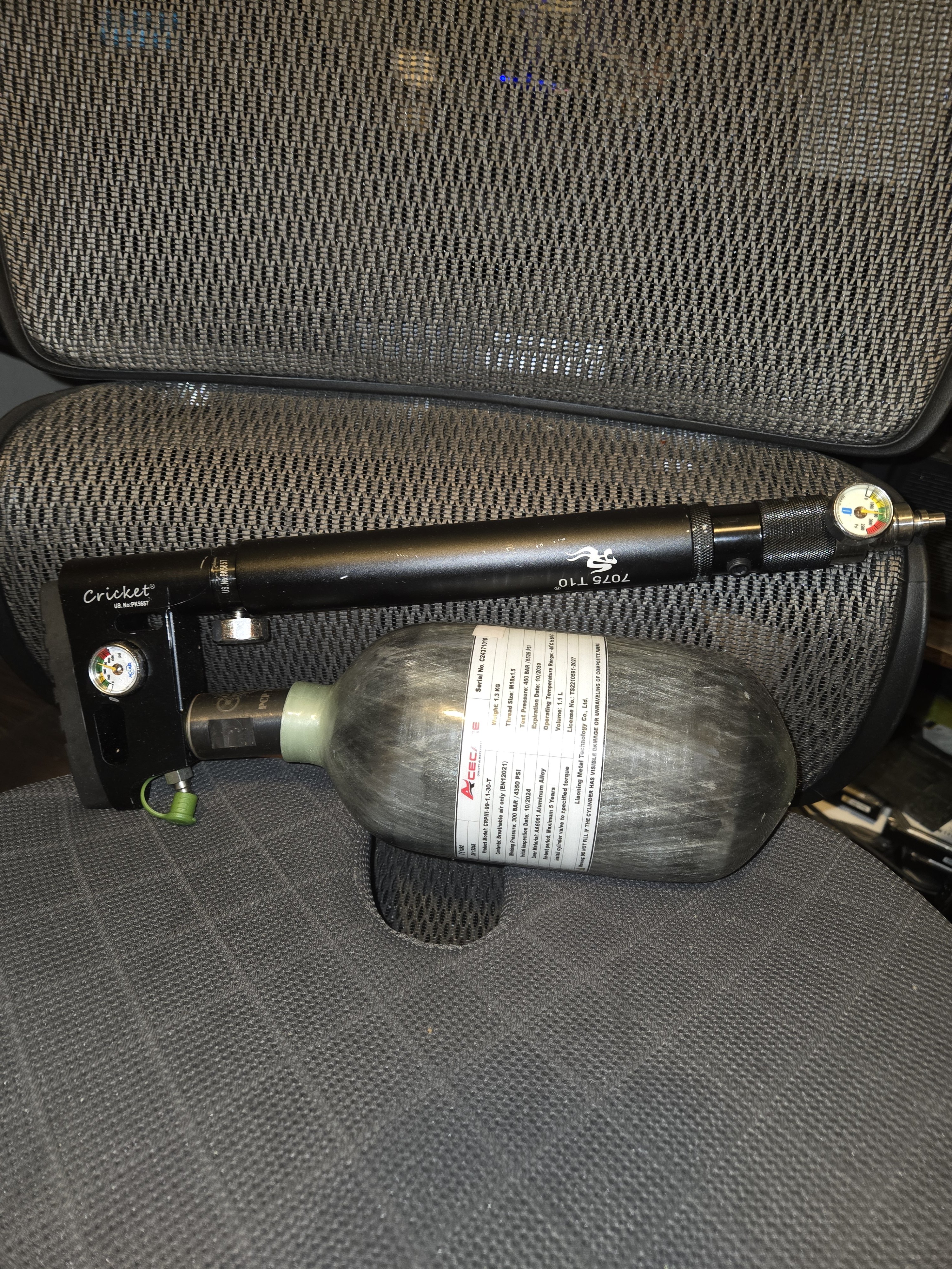

It’s accurate at 2300 psi and can easily be refilled using a PCP hand pump.
