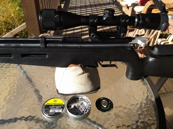

Okay. I bought a nice used Crosman Challenger air rifle to convert to 12 foot pounds. The problem is it is so stinking accurate and so much fun to shoot that I'm worried about converting it to 12 foot pounds. Has anyone done this and regretted it afterwards. I would love to shoot this gun in Hunter field Target but I'm afraid I'm going to lose what is so incredible about this gun. Shot three paintballs in a row at 25 yards and then put five shots under a dime at 30 yards without a single flyer. Are these just as accurate at 12 foot pounds as they are at 540 feet per second? Need advice. Am I going to ruin a good thing?
Please advise.
