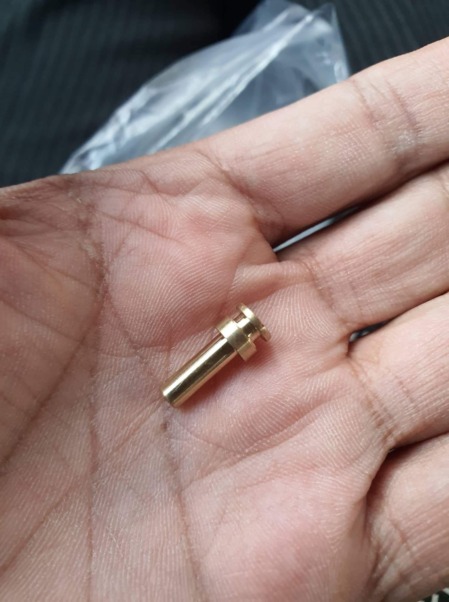

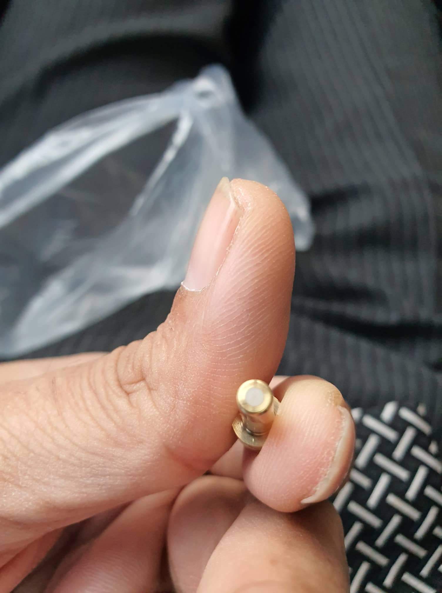

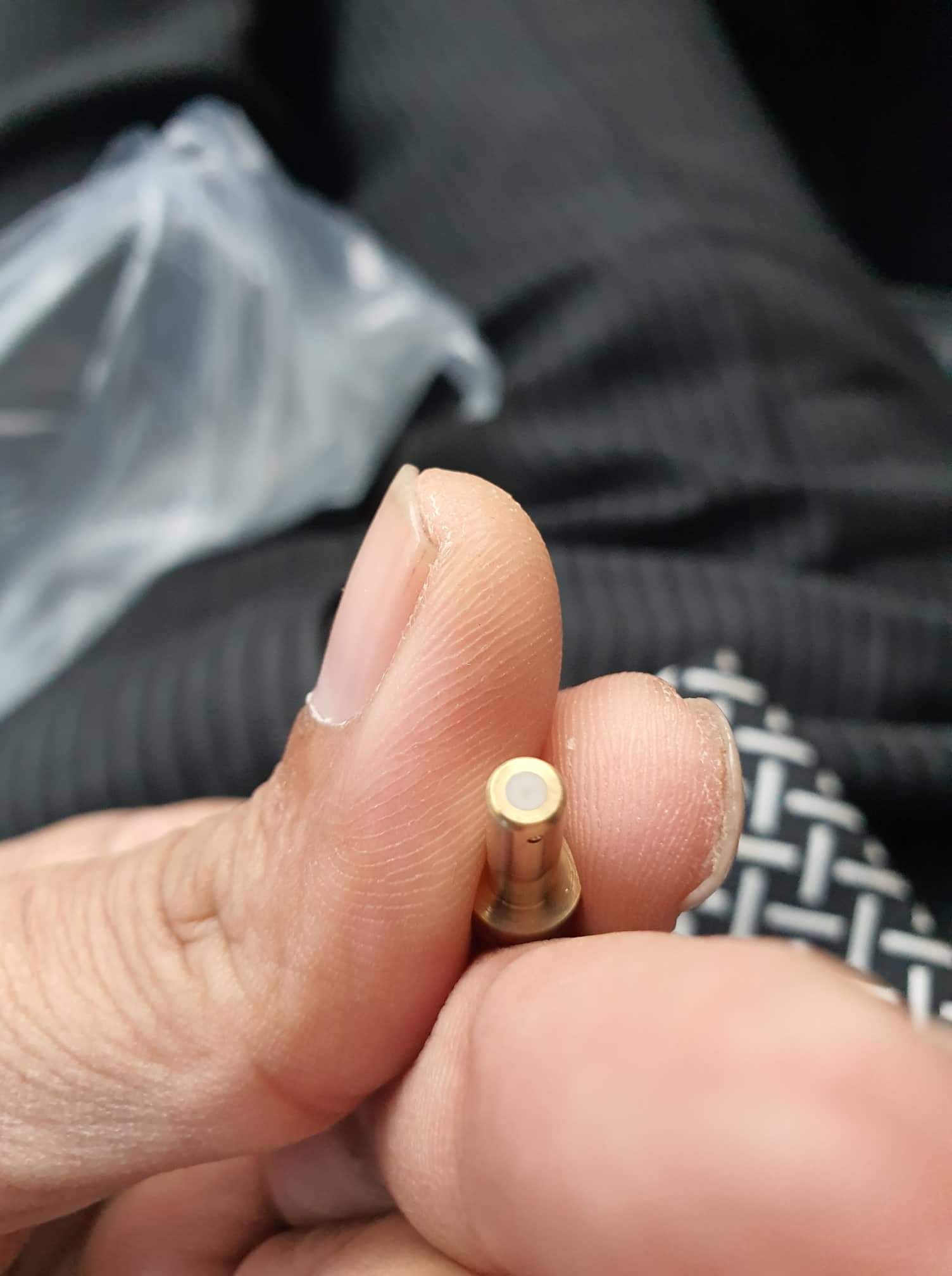

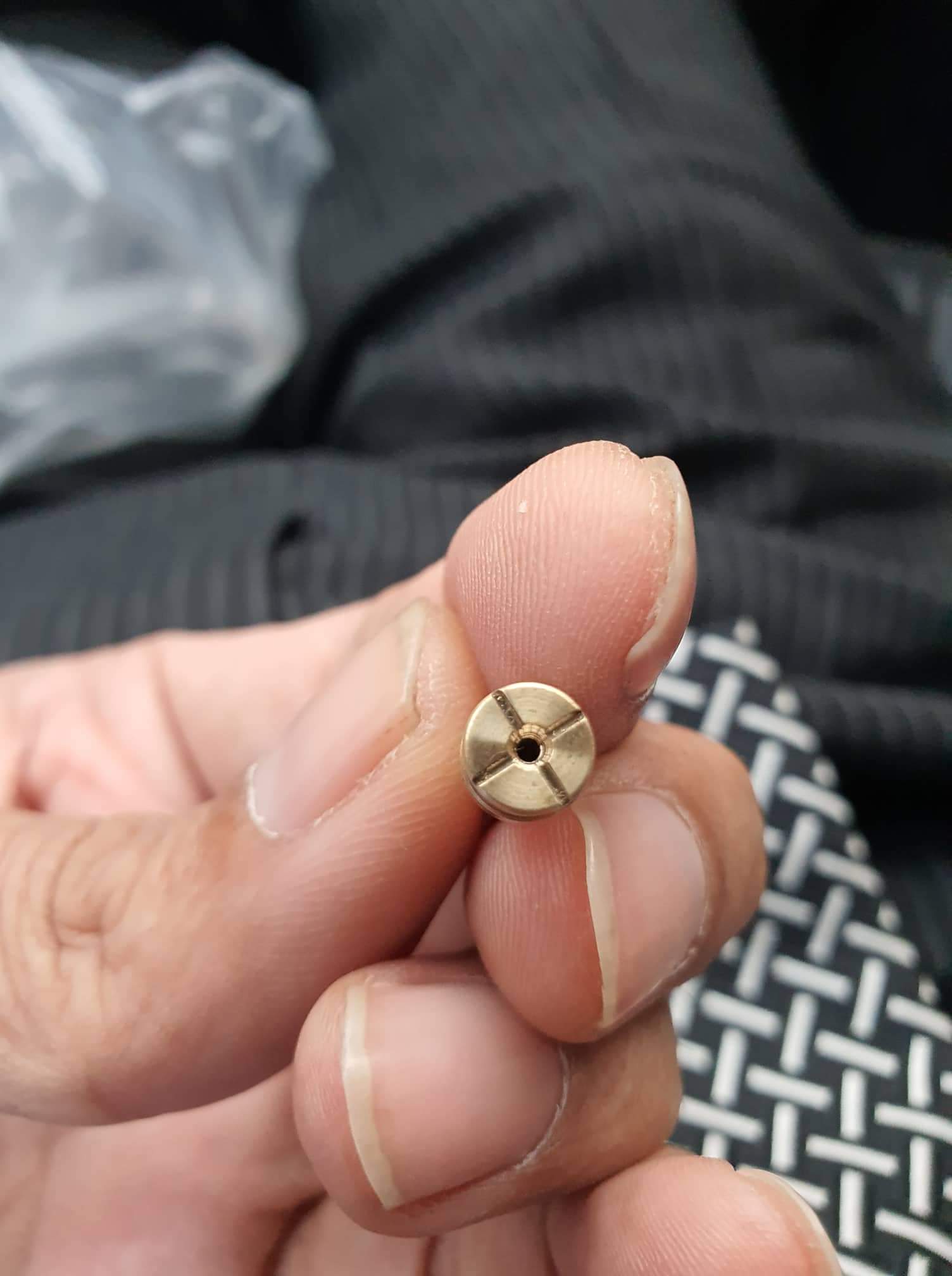

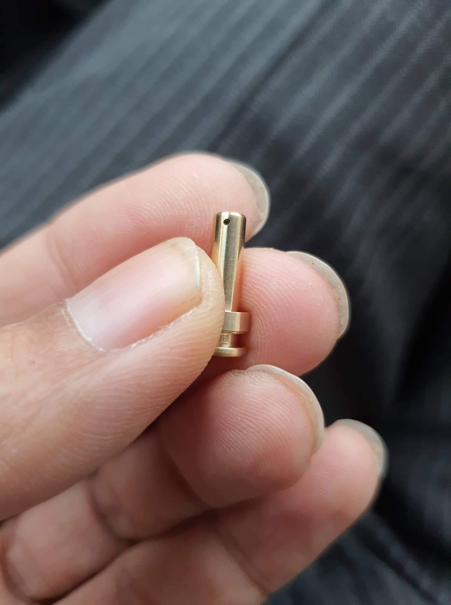

Well rebuilding M3 amp regs for a friend and swapping out to the power block was able to pop out the derlin and turned down some peek and put it in the end using a small hammer still have to finish it with 1500 grit wet dry yet
That's a nice upgrade worth doing for those with the tools and skills. For what it's worth, I like to carry the finish out to at least 3000 grit unless the orifice cone is fairly sharp, otherwise it will take somewhere between a long time and forever to break in and stop creeping.
Thanks for the tip I'll have to get some more sand paper
I don't know what you want a drawing of I just used a dental pick to pop out the derlin on the rear of the reg piston turned some peek I had down to just over the size of the hole and pounded it in with a small hammer and started sanding it down I left it way long so i could tap it into place
Thanks for your reply, did not realise it was that simple 😀
So far I took them back apart since I got tipped to hit them with 3000 grit they were just sanded with 1500 grit and where holding air I didn't test them for creep before that I went to my local hardware store this morning and they only had 2500 grit nothing finer than that so I resanded them with that today and been watching them for about an hour and don't seem to be creeping but can't tell real well with analog gauge hopefully there good now
