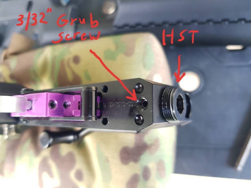

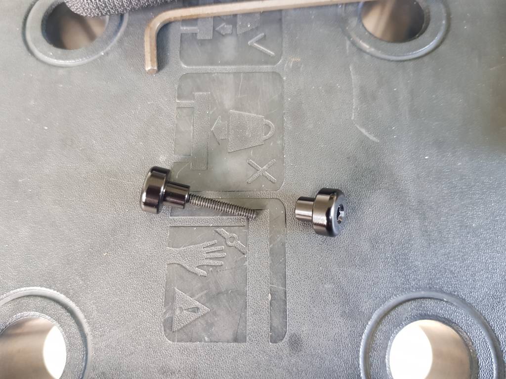

To get to the HST, you need to remove 4 screws/bolts.
1. Start by removing the 2 screws on the bottom of the picatinny rail with a 1/8" alan hex key and remove the whole pic rail.

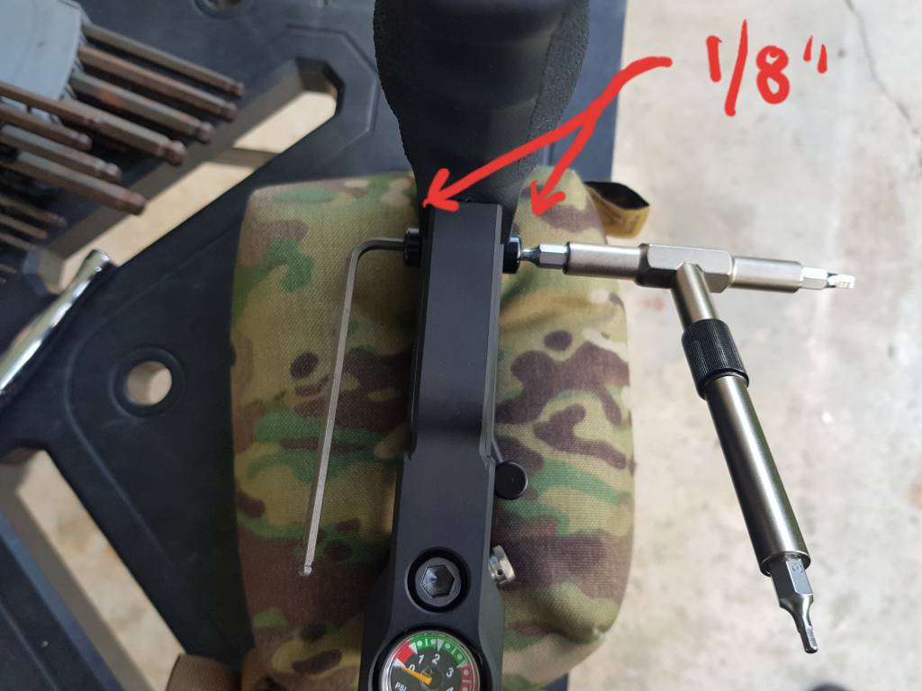

2. Remove the ambidextrous safety with 2 1/8" hex keys.

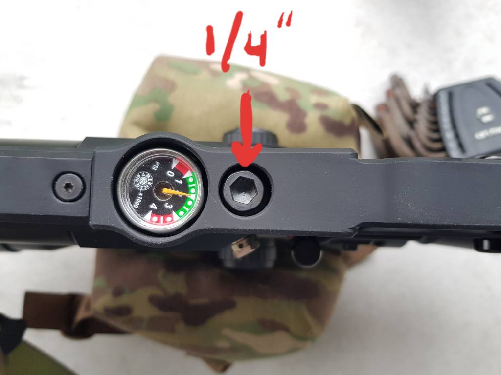

3. Remove the 1/4" main bolt from the lower receiver. The lower receiver with attached buttstock can now be removed to get access to the HST.
4. Loosen the grub screw that secures the HST on the upper receiver. I believe it's also a 3/32" hex key.
You can now adjust the HST with a 3/8" hex key I believe. Clockwise (CW) to increase FPS and counterclockwise (CCW) to decrease FPS. I usually adjust mine in 1/4" increments at a time. Don't forget to tighten the grub screw when you're done. Hope this helps.
