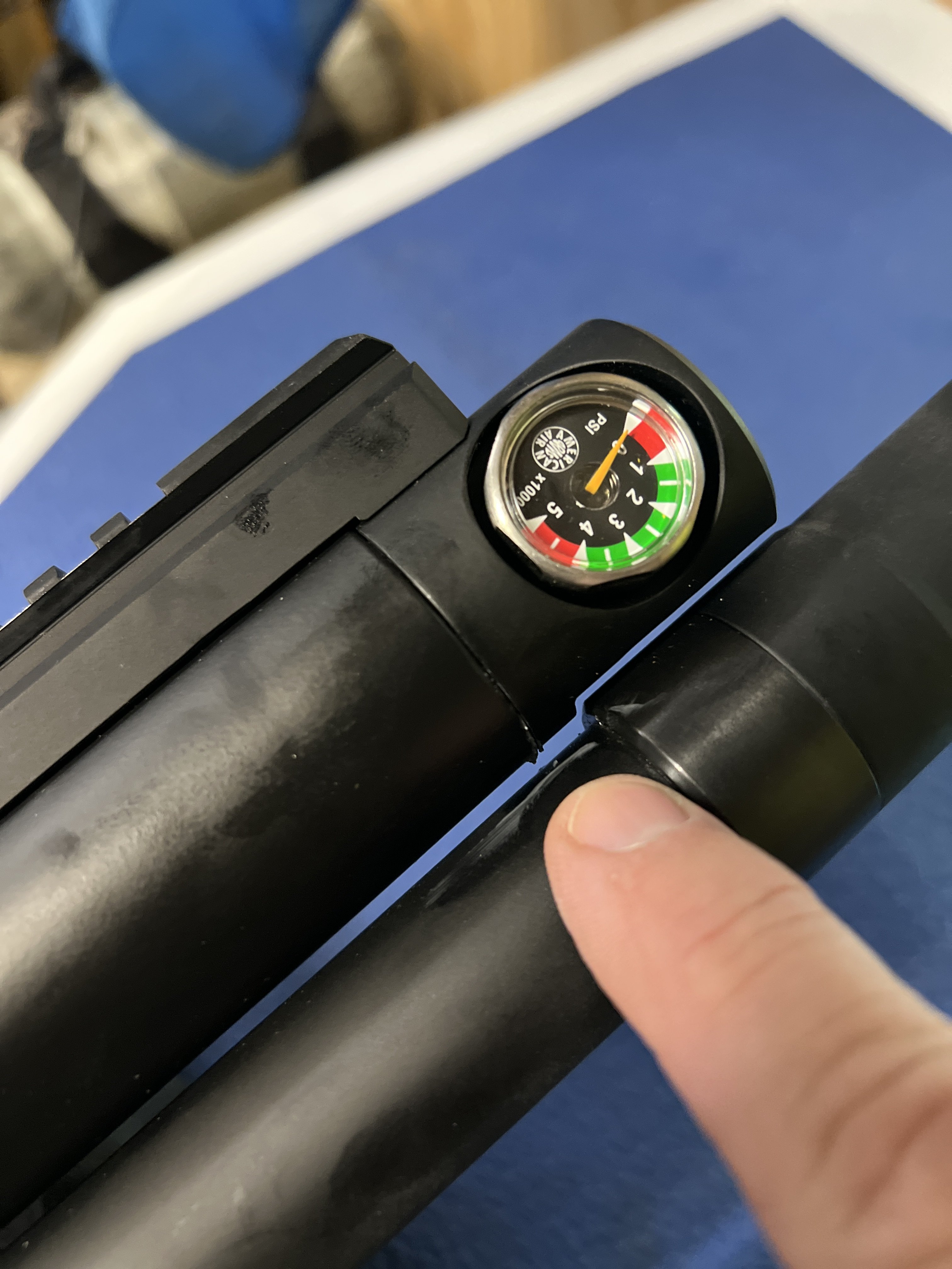

Other then bench shooting to zero my Evol it hasn’t seen or cycled many pellets. I took it out last night to deal with a coyote and discovered it had lost all its air - I keep it charged to 2300 psi to be ready for predators. The leak is near the fill port but seems to be coming from the manometer at the air tube. How do I proceed to repair? Obviously it’s degassed - the picture shows where the leak is coming from:
Ideally - there would be a maintenance video somewhere on YouTube but no such luck. Probably need one or two Orings but I gotta know specifics.

The reason I asked if you have the barrel removal tool is because it just makes it easier to remove the air cylinder or gauge block where your leak is coming from. Just by looking at your pic, I can tell that the o-ring is extruded and it looks like it's coming out of the seam.
First off, degass the air cylinder by loosening the burst disk on the receiver first just to make sure.
To remove the gauge block, you need to unscrew the lower picatinny rail first. You could also just remove the lower receiver with the picatinny rail attached.
You then need to unscrew the male foster with an allen hex key and possibly remove the gauge/manometer at the front of the air cylinder. The reason is because when you twist off the front gauge block, the barrel will get in the way.
To remove the pressure gauge, you can purchase the Gauge Removal Tool at AoA. If you don't want to go that route, use an adjustable crescent wrench or box wrench that fits to remove the gauge. Just be aware that you risk marring the finish around it.
Then twist off the gauge block assembly and replace the o-ring. The size is -122 Viton, 90 durometer. I would also replace the o-ring on the regulator. It's the same size and material.
