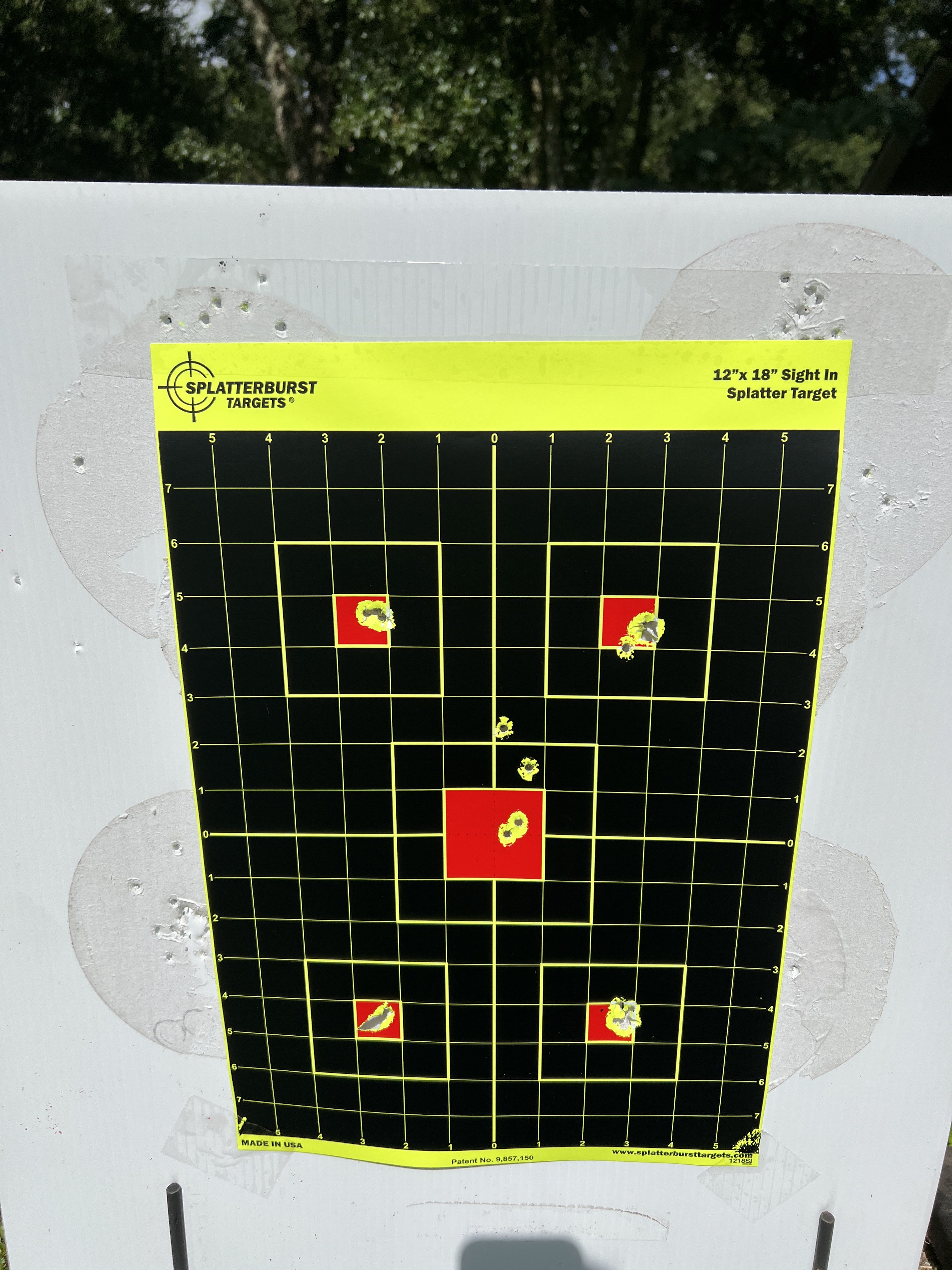

If weather cooperates I’m going to check three configurations for sound variation and POI issues- If I’m hunting with my Evol I will have the OEM moderator on the gun as durability is the main goal. However, if I’m in my backyard and on a bench - I’m all about the most quiet configuration I can create.
Good weather light wind ! From a bench- I set my Evol.30 up and the center box of target is my site in verification and adjustments at 50 yards. Upper left was Evol OEM moderator, upper right my Donny Fl with no extension, Lower left my huggett with extension and lower right my Donny Fl with extension. As for acoustic impressions my subjective opinion is the Donnyfl with extension was quietest to my ears shooting from inside my shooters box followed by the Huggett with extension. In the field I would just use the OEM configuration. No appreciable POI changes.

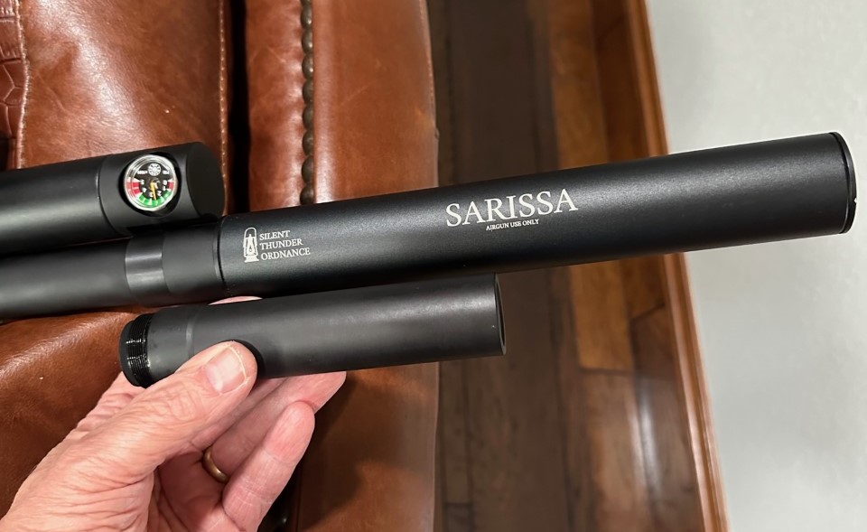

I wanted to document what I discovered with my .30 cal Paradigm and post it in this thread for posterity. This was the thread that got me interested in another moderator for my Evol because I wanted to be able to shoot it in my backyard.
OK, so got the Paradigm sighted in today at 30 yds. Stacks 50 grain FX pellets. The ARKEN EPL4 6-24x50 was made for this rifle. Now the really good news for which I was hoping . . . My DonnyFL 1/2 inch adapter came in today, so I was able to put the Sarissa .30 cal moderator on it. It is whisper quiet. . .Quieter than my BSA R10SE in .177 and equal to my FX Crown in .25. Definitely backyard friendly. If I go to the field to hunt, I can always switch back to the stock moderator.
