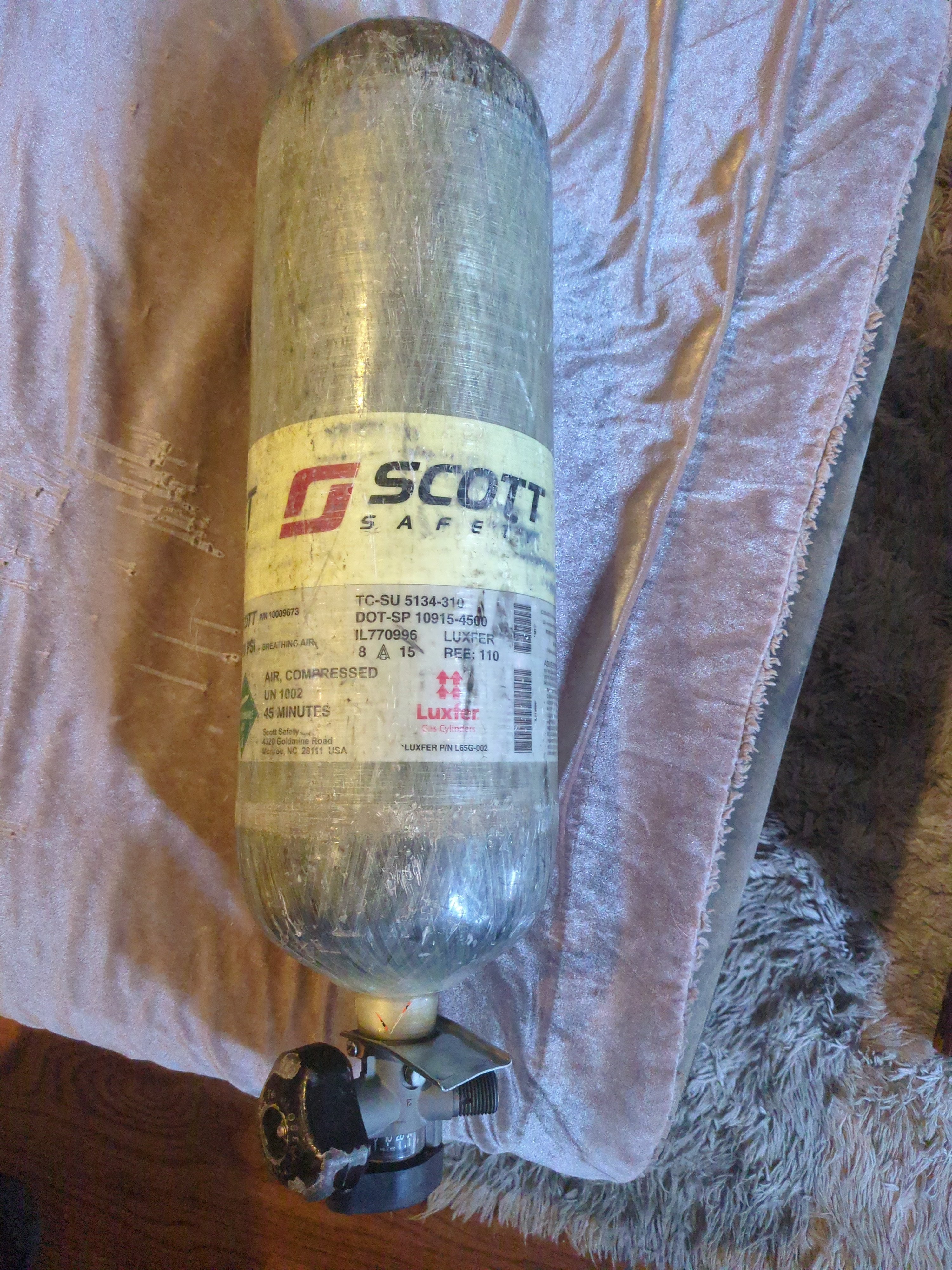

I picked up a Scott 45m 4500 PSI SCBA tank from a local fire department. It is currently certified but expiring in the next month or so.
I'm looking for an adapter to convert it so I can fill my PCP Kalibur Cricket gun. I have a cheapie compressor. Does anyone know if the Amazon Fill Station Kit, PCP SCBA Fill Station Refill with 60cm Microbore Hose 0-4500PSI Charging Connector Adapter Air Rifle kit any good? I don't want this exploding in my face. Not many options and this a long with other options from eBay all look the same..
Link to refill kit on Amazon
The Amazon unit on this Scott was garbage. I had to replace the bottle end of the station with legit parts to make it not leak, as well as the guage..
I appreciate the feedback. By looking at the parts in the pics I suspect the same I wonder how accurate that gauge is going to be and if it's going to leak.. I have a cheap china Yong Heng compressor and very familiar with leaks. It doesn't look like are many options. It's either cheap at under $50 or really expensive around $300.

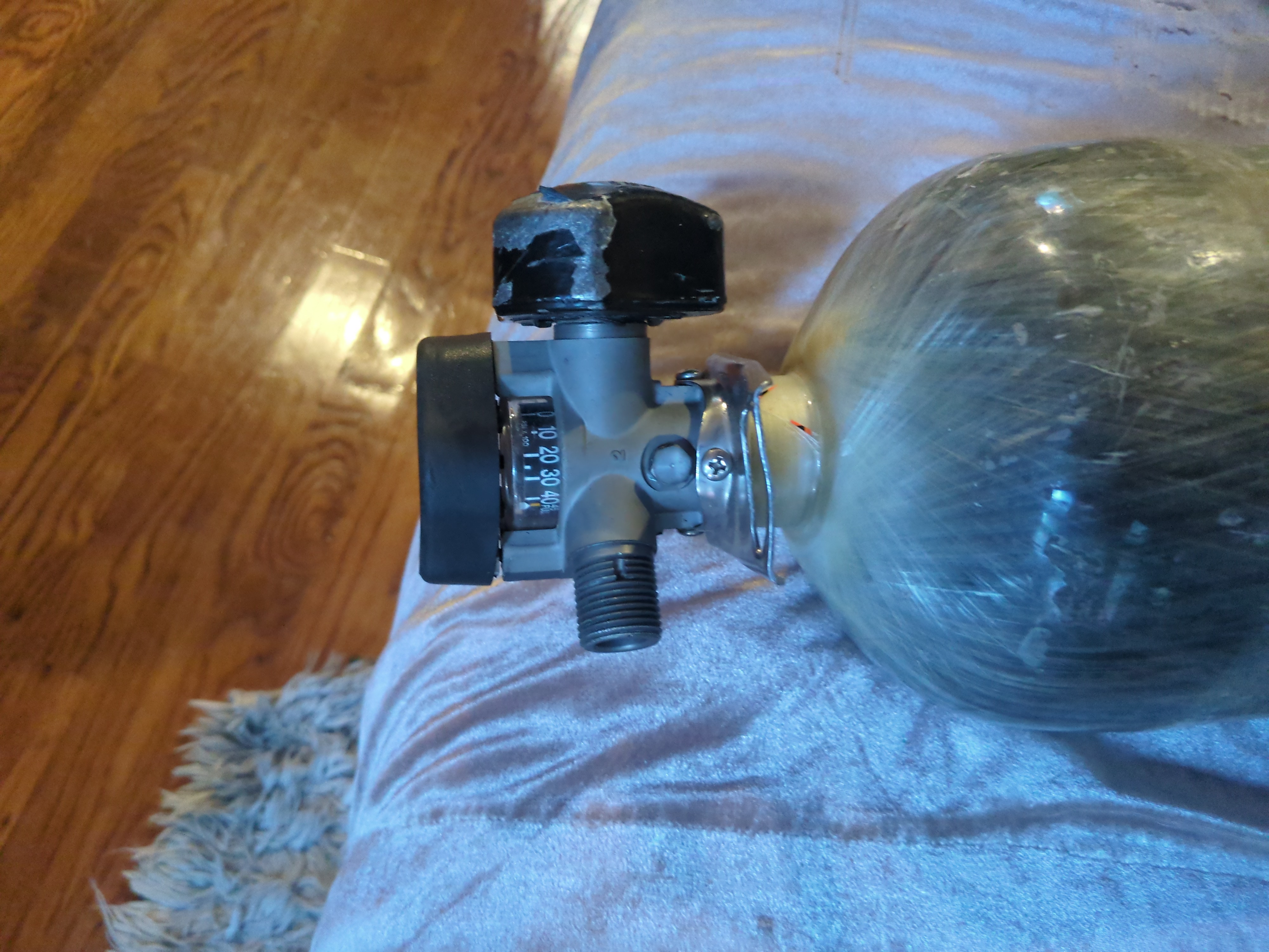

My Scott 45 minute SCBA tank:
Tank thread CGA347 (if same as Scott) ¾-16. Valve outlet for CGA347 probe and nut 7/8-14 TPI.
