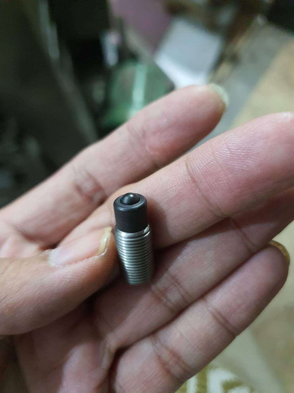

      I did some more testing today. I had the air pressure of only 225 vars in my scuba so the bottle filled upto 225 bars
      Starting 225 bars
      Ending 145 bars
      Pressure consumed 80 bars
      Pellets weight 33.95 grain
      Caliber .25
      Average Velocity 904fps
      Total regulated shors 75
      Energy per shot 61 ftlb
      bottle size 480cc
      Spread single digit
      Efficiency factor calculated is around 8.39
      This time I didn't shot below the reg pressure as the fps started to drop after going below the reg pressure.
      Here I discuss the reasons.
      I have installed a valve travel restrictor that I was not using in my previous results.
      I installed a rubber ball on the face of the valve travel restrictor to function on the pattern of FX impact valve adjuster.
      Now I increased around 15 fps with hst and then started restricting the valve opening travel by gradually adjusting this mechanism.
      Finally I achieved 900 fps.
      Then I refilled the gun to 225 bars again and did a complete string.
      This time due to valve restrictor the spread was tighter than previous testing but at the same time the fps came down just as the gun came off reg.
      I understand that the reason of decreasing of fps in the valve restrictor setup is that when the gun went off reg, as per phenomenon of unregulated guns, it should continue to give a few more good shots or a spike but for that purpose the valve needed to be opened for a bit more travel after coming off reg.
      Since I had restricted the valve travel, I could not get the benefit of unregulated air and the gun started dropping fps suddenly.
      I hope that my current test will also give reply some of the previous questions of the members.
      I post the pic of valve restrictor with soft rubber ball on its face.
      Umair Bhaur

        You are very right. In fact difficult to go through all that hassle of making complete kits and there may come some complaints and to satisfy all the users may be a headache for me.
        I send some parts sometimes to interested users.
        I understand that whatever I have posted on forums and my YouTube videos any interested person can do all this with the help of a good machinist.
        Bhaur
