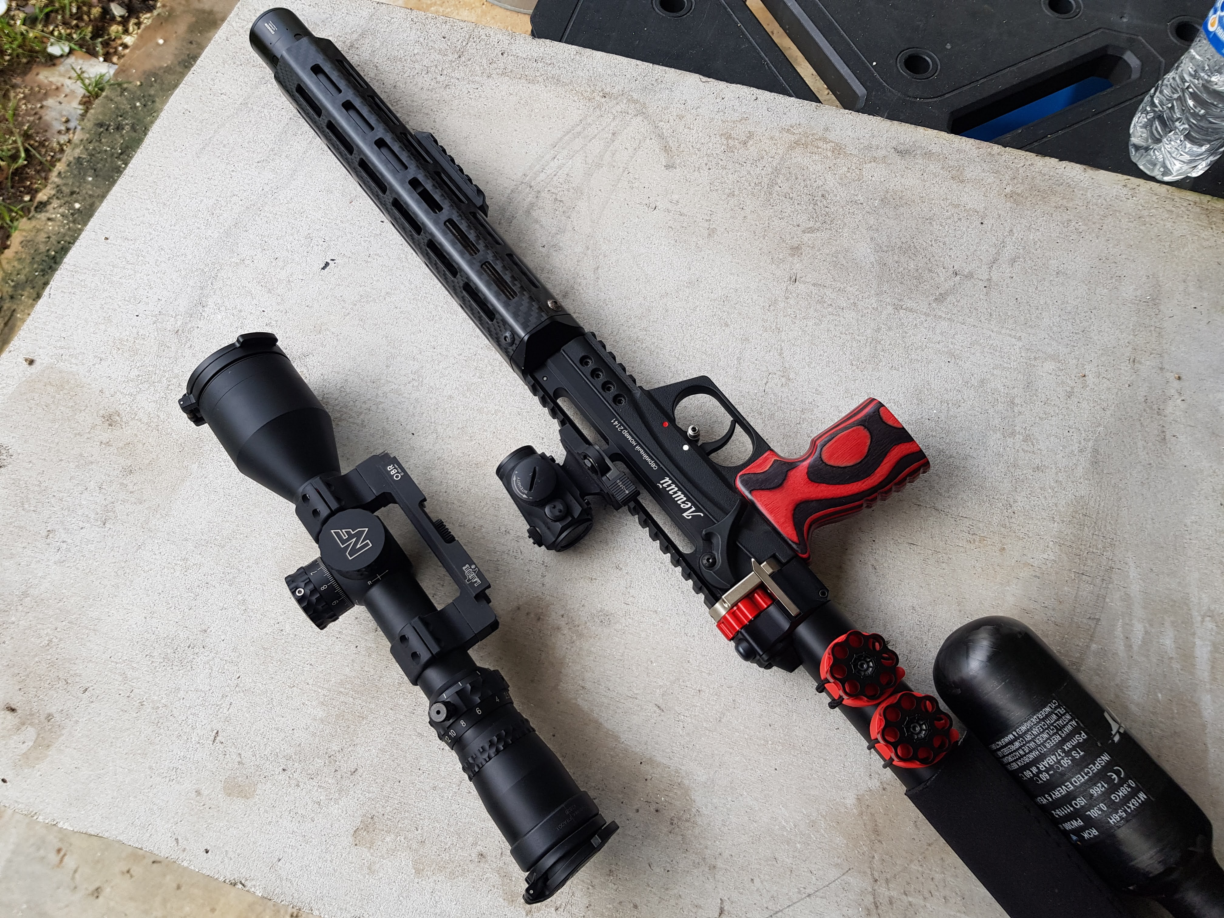

I went hunting the other day, and I saw the perfect squirrel around 75 yards away, so I thought this would be a no brainer shot with my FX Maverick VP .30cal and my ATN X-Sight 5 5-25x LRF Scope. My groups with the FX Hybrid slugs at 100 yards are just over an inch, so I was not too concerned about my ability to take this shot, so I took my time and let the slug fly for a certain heart/lung shot that I'm so fond of.
To my surprise, I was not awarded with the thwack I've heard countless times before, and the squirrel seemed not the least bothered by my attempt to take his life in exchange for a place on my dinner table. So, now I'm second guessing myself. There is a slight breeze from east to west, so I decided to hold for wind 3 mil, and to my surprize and disgust, a brach just to the left of the squirrel's head exploded into splinters! That's it, I'm calling it for the day, as something is clearly wrong with my setup, but what was it?
  • Did my new DonnyFL QD mount fail me in some way?
  • Did I accidentally bump the barrel while I was maneuvering through the woods?
  • Did my ATN Scope go belly up and not hold zero because of another bug I've uncovered?
ATN X-Sight 5 on the Maverick, with the X-Sight 4 and THOR 4 scopes in the foreground, all wearing ATN QD mounts.
After loading up the video of the shot in my video editing software, I conformed the 120fps footage to 24fps, and then added additional slo-mo effects to get this shot as slow as possible. Again, I am completely dumbfounded! How is it possible that I'm so far off on the horizontal (just under 5 inches by the looks of it), but my Ballistic Calculator has got the much harder horizontal axis exactly where it should be?
And then it hit me like a ton of bricks! I was awakened a few weeks ago with something walking on my roof in the middle of the night. Thinking this was either the Delta Force rappleing in because the country needs my help, or it was another pesky raccoon! With the sure money on a raccoon, I swapped out my ATN X-Sight 5 scope for my THOR 4 thermal scope on my Maverick. With no sight of a trash panda, I swapped the X-Sight 5 back in, and went to bed.
I am now convinced that the ATN QD mounts claim for return to zero are exaggerated, or are they really? What is considered proper performance for a QD mount that is true return to zero rated?

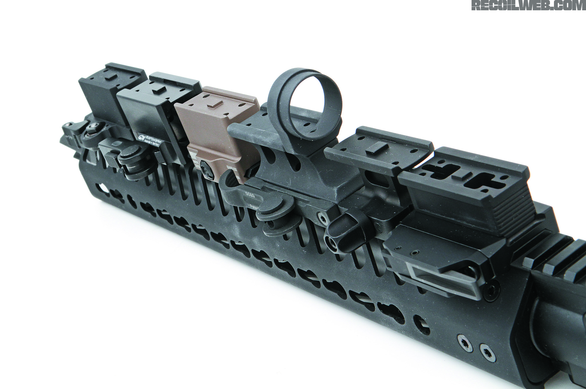

Can I expect 1/4 MOA repeatability at 100 yards with one of these pricy return to zero QD mounts like the Scalarworks or LaRue mounts below? Has anyone been able to achieve the repeatability levels I'm after with a QD mounted scope?

Or am I chasing a unicorn, and the only way to repeatably hit a 50 cent piece at 100 yards after detaching and reattaching my scopes with QD mounts is to do a zero afterwards?

I have used the LaRue mount you show above with very good results on my Thomas FT rifle. I have removed and remounted the scope over 10 times with no change in zero. I tried cheaper models before using the LaRue mount and found I always needed to rezero the scope at least a few clicks; sometimes a lot of clicks.
The trick to making it work in my opinion is having a high quality base with precise machining, following the LaRue mount directions for adjusting the levers and ensuring both mounting bolts are reset to the previous tension per the markings on the bolt heads. Ever other screw/bolt on the mount/base must also be tight. I use a torque wrench, write down the settings and check them every few months to make sure nothing has changed over time.
I have not done the swap in the middle of the night with the type of optics you are using nor tried to hit a 50 cent piece at 100 yards after making the swap. I have done the swap right before a local field target match and cleared the course without making an adjustment to my zero. It works for me using my equipment.

I have several LaRue mounts which have always worked for me. I have the exact OBR mount that you posted mounted on my Leshiy 2 in .30cal. I'm a little shocked how much the price went up on that LaRue mount compared to when I bought mine. I switch between an Aimpoint T1 and my NF NX8 F1 2.5-20X50. The farthest I checked for return to Zero is 75 yards and it's dead-on. For return to zero, it's best to check on a windless day, make sure you have a solid barrel, good quality scope, no reg creep.

a lot may depend on the rail you mount it on. can you wiggle the mount on the rail before it is tightened down?
the best rtz on a qd mount i have used is the bobro engineering mount.
i have one on my scar 20s (but a dual level model, not the one in the article linked below).
they have a patented design...
if you have a wiggle, it might help to push the mount forward and against the fixed side of the mount each time you mount it.
