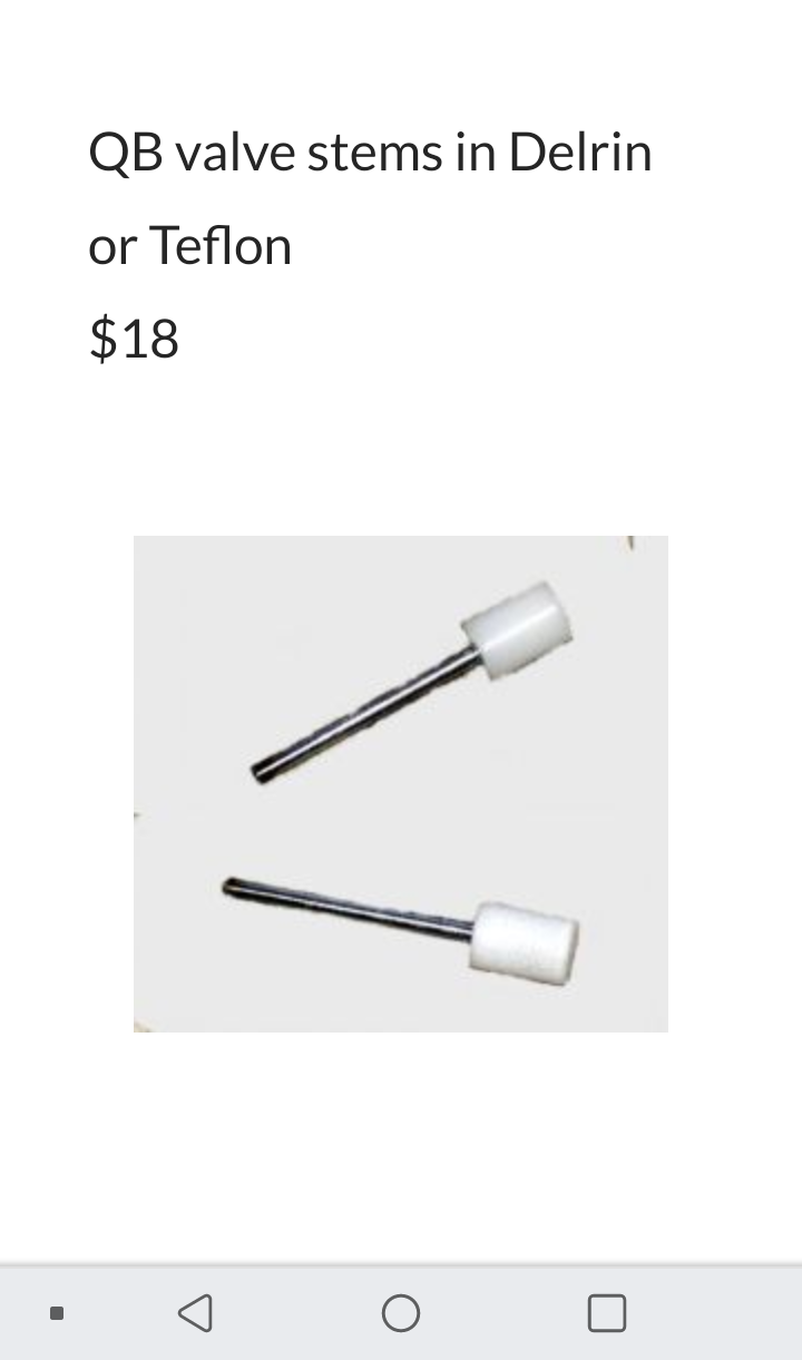

thammer - you know if the QB78 Poppet is a direct fit for the Avenger and ATI Nova Liberty and Freedom and Seneca Aspen and which is better Delrin or Teflon poppet material?
QB78 valve stem is the same Diameter but a little too long. Uses what looks like the same soft material as the ATI/AV guns anyway so no improvement.
Delrin is a little harder than teflon so should work a little better.
This is the reason for asking so all it needs is to shorten the stem?
It's to help Avenger Gen1 owners and Nova Liberty and Freedom and Seneca Aspen owners as well.

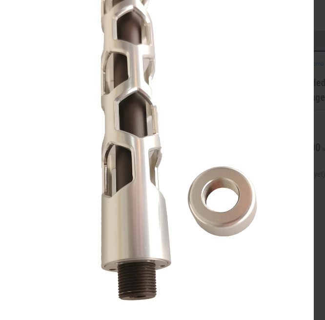

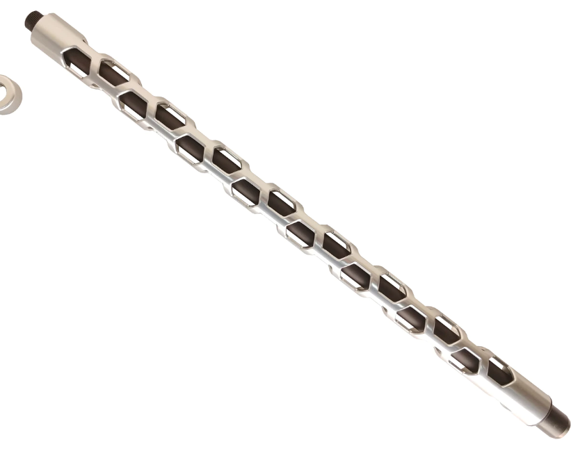

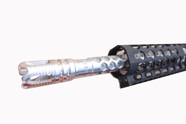

What about a honeycomb-style sleeve?
