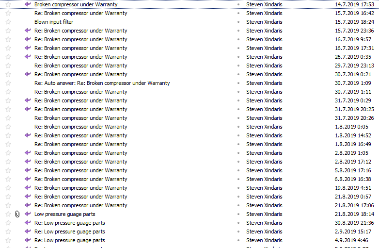

The answer in points to what Xindaris claims:
1)Xindaris claims that we do not accept the warranty and that it is only 1 year for the USA.
This is nonsense and Xindaris is a proof that we hold a 2-year warranty for customers in the USA, as we sent him a replacement filter free of charge under warranty 20 months after purchase. We refused to send further parts when it turned out that the defects were not caused naturally.
The only thing we wrote to him in the email is literally this:
“but after almost 2 years of operation, expect a free service for 2 unique defects simply can not. In the US, the standard warranty is 1 year. We in Europe must give 2 years by law, although this is a problem with such products.
I'm not trying to get out of our responsibilities, but I'm based on our long-term data, and these things are extremely unique, which corresponds to using a booster differently than any other user. “
Maybe he misunderstood due to our worse English, but we don't say that we give a 1-year warranty for customers outside Europe. We point out that if he bought oure booster or other brand booster from a local or online store based in the US, he would get only 1 year of warranty and not 2 years as he received from us during the purchase on our e-shop.
We have not restricted his warranty rights in any way, we only decided for other parts damages that they do not go under the warranty because they did not occur naturally.

I read Altros"s reply. They left out a few things. 1. I offered to send the unit back on my own dime for them to inspect and repair. They refused saying they would have to pay duty on it and the shipping back. 2. They say that the inlet pressure was too much. My setup had 2 regulators on the feed air line. The one at the tank was set at 145 psi and the second at 140 psi. I doubt that either was that far off. 3. It took my unit about 8 to 9 hours to fill an 88 cu. ft. tank from empty from the day it was new. That is how I came up with the 10 cu.ft an hour. 4. The plastic comment was in reference to the end plates on each end of the barrel. To me that should not be the material to use on a high pressure pump. You can agree with what I said about my experience or not but I have no reason to go after Altros other than how they handled my warranty claim. If people want to buy their product that is their choice. They can read everybody's experiences and decide for themselves if that is what they want to spend their money on.
We did not reject the possibility of sending the unit back for repair, we just wrote that it is complicated and expensive. This is a simple fact. But we never wrote: We refuse to send the unit back. The exact wording of part of my email is :
Sending a booster outside the EU is a probelamtic, because we have already stopped our goods at customs and wanted to clear it. The cost of processing the paper is $ 45, provided they do not charge duty.
The price of one-way transportation is $ 120. Goods must use the same package and package design (original foam on both sides), otherwise there is a good chance of destroying it on the way.
Nowhere is it written that it is not possible send booster back to repair, but obviously it is very costly and the total price (transport there and back) does not have much logic compared to the total price of the booster and the possibility of self-repair which have so far been managed by all users themselves. For these reasons, we give our customer very above-standard technical support. You also received this support without writing anything good about us, only slander. When solving your problem, which was 3 super unique defects that appeared at same time, we give you almost 30 emails with advice and instructions for repair.
Your slander, we can't call it otherwise, because it wasn't information for users, but an attempt to damage our brand, which you wrote here only because we refused to fix something for free that obviously could not have arisen naturally, or the probability was like that a meteorite hits me right now.
This was our only "transgression" against you. The booster served you for almost two years and the frequency of filling the bottles was not small compared to a normal airgun user. We provided you with full customer service, which took several hours of my time to write the answers. We sent you the first part for free and in return, we got slander on the forum that Xindaris was writing at the same time as we were still writing him advice on how to fix the booster.
We are no longer going to comment on this matter, nor would we have addressed it at all if Xindaris had not tried to write slander in every thread about our booster. If he made this one thread where everyone could read his (one-sided) opinion, it would be solved. But he had to escalate to this level.
