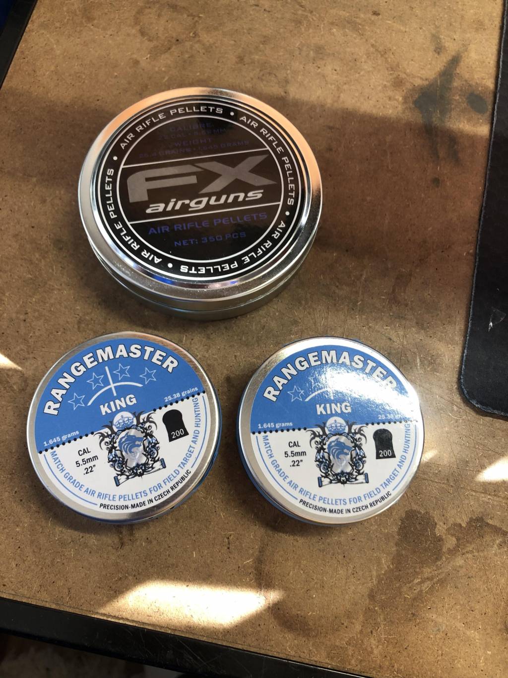

THE FX 25 GR ARE GREAT PELLETS PLUS THEY ARE 350CT TINS LITTLE MORE EXPENSIVE BUT WORTH IT PELLETS ARE VERY WELL MADE MY RTI COMPACT LOVES THEM, TESTED FEW AT 930 TODAY REALLY NICE COMPACT RTI ALSO WITH POWER PLENUM AT 160 ON THE REG TEMPS ARE 13 DEGREES HERE SO WAS A FAST TEST SURE IT WILL THROW THEM 960-970 EASY AT 180 REG PRESURE REALLY IMPRESSED WITH A 400MM POWERHOUSE
DAYSTATE RANGEMASTER KING HAS THE 25.38GR ALSO
