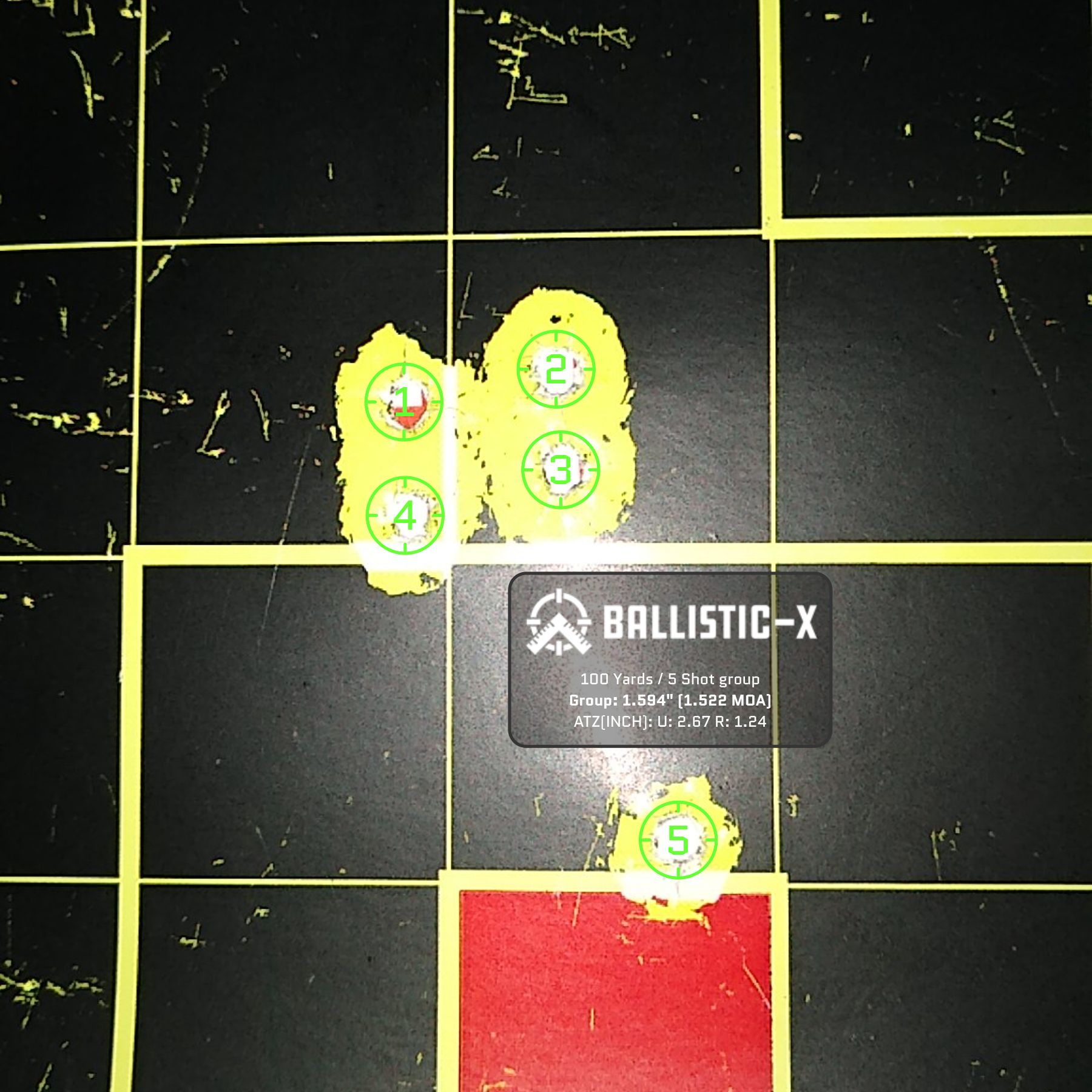

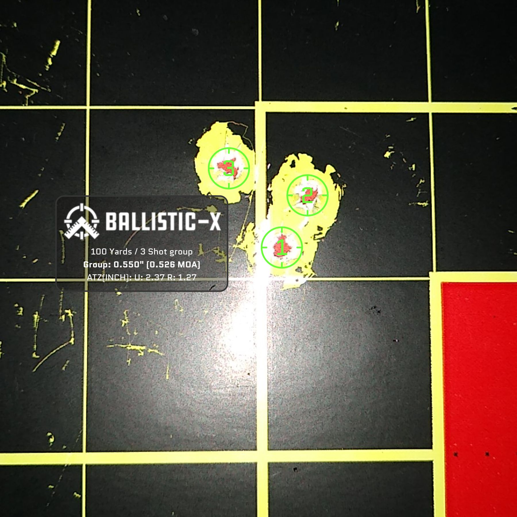

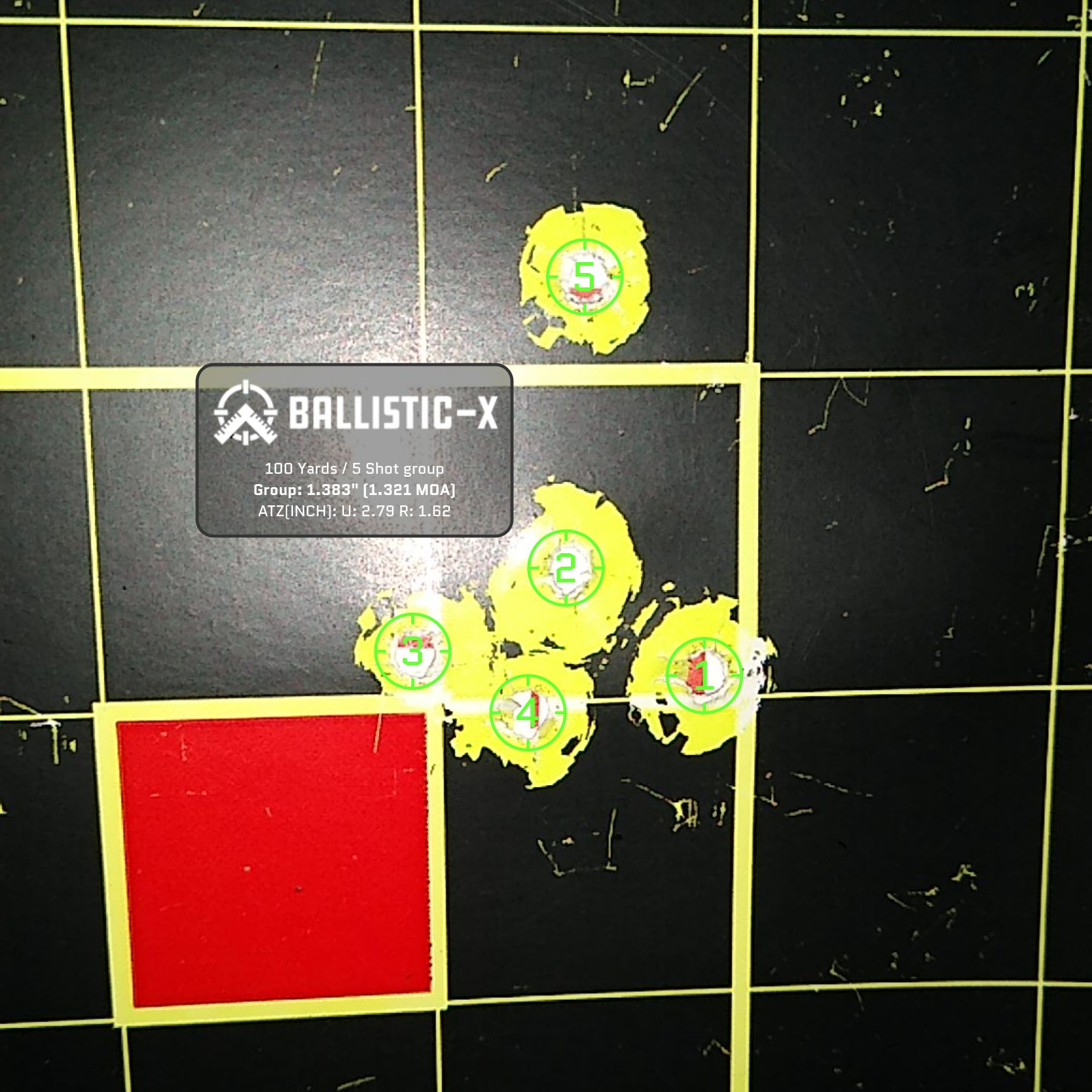

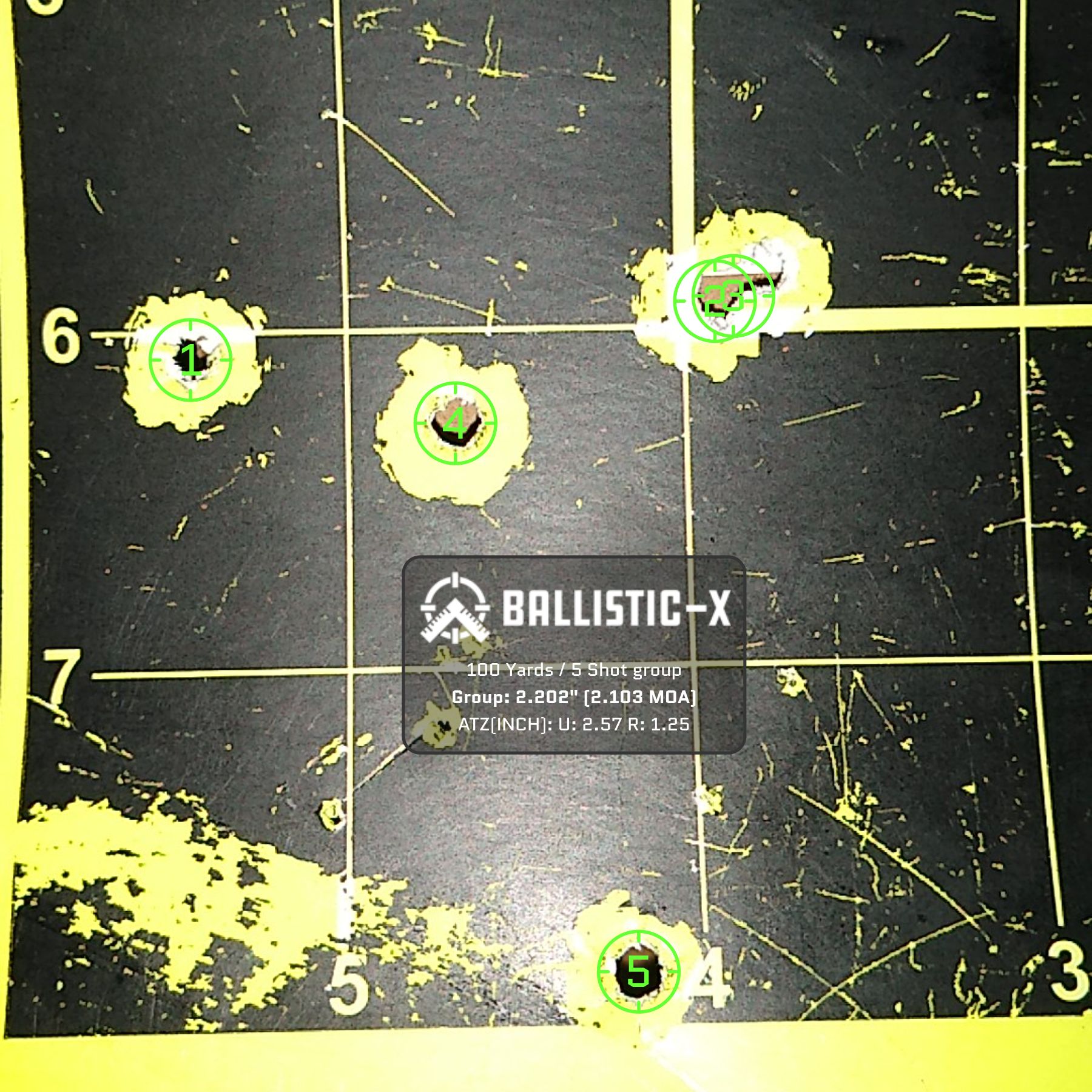

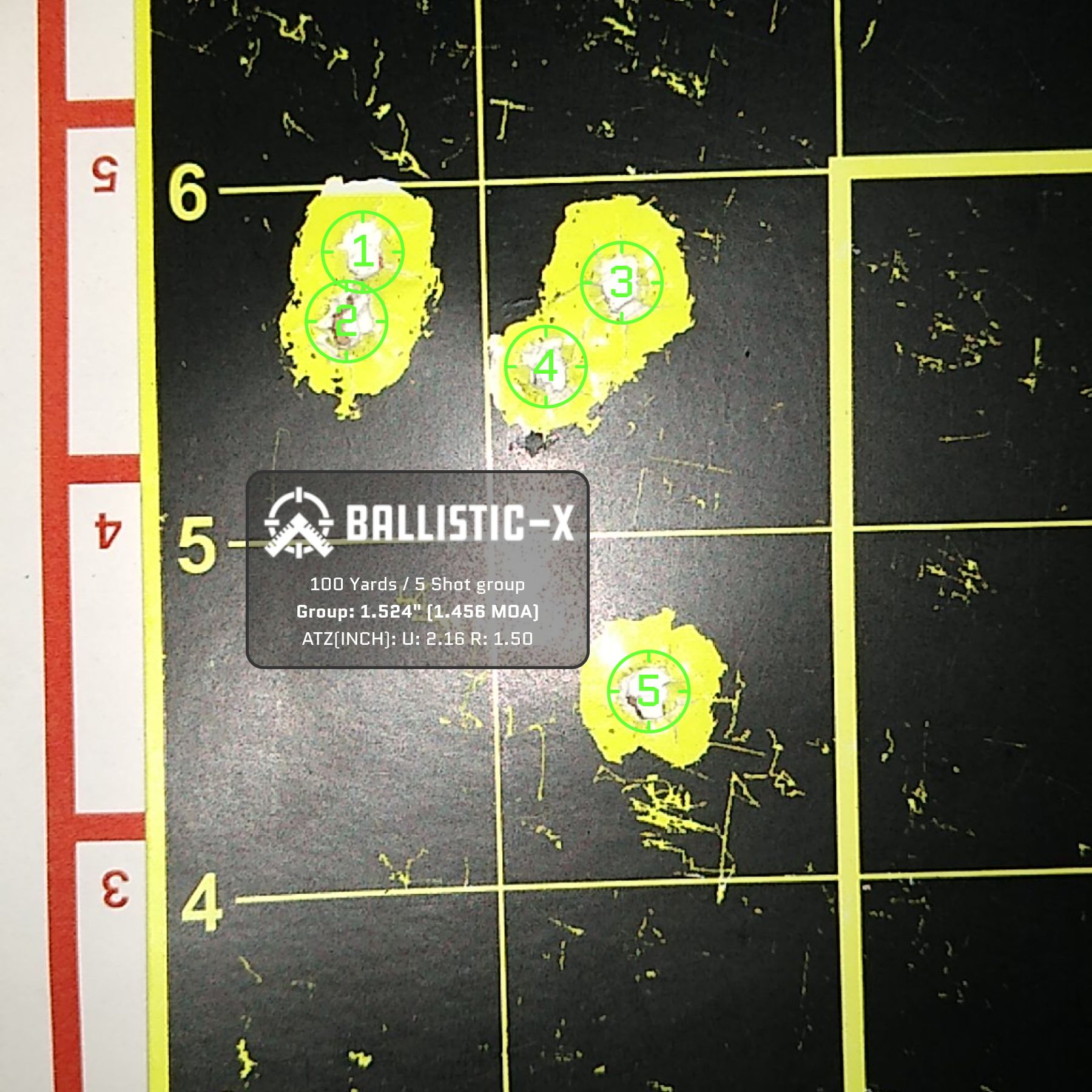

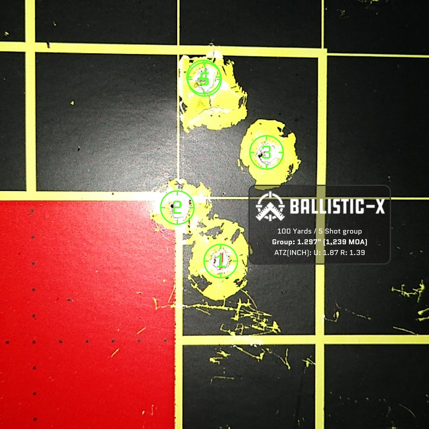

Here is some more groups testing at 100 yds in a 20 plus mph wind! The gun and setup is a fx impact m3 with the 800mm tensioned barrel and the altaros atp smooth 50gr at 886 fps (thanks centercut for the fps tip). Every group is 5 shot except for the first.

Here is some more groups testing at 100 yds in a 20 plus mph wind! The gun and setup is a fx impact m3 with the 800mm tensioned barrel and the altaros atp smooth 50gr at 886 fps (thanks centercut for the fps tip). Every group is 5 shot except for the first.View attachment 425672View attachment 425673View attachment 425674View attachment 425675View attachment 425676View attachment 425677
The 2 videos are just showing how wicked the wind was that day.
That is truly amazing to me, especially after seeing/hearing the wind in your video. I know my 25g MRD pellets can’t do this! At 100y! 😀 Ha ha…..but, seriously good groups. Just shows how the slugs do a great job with wind.
