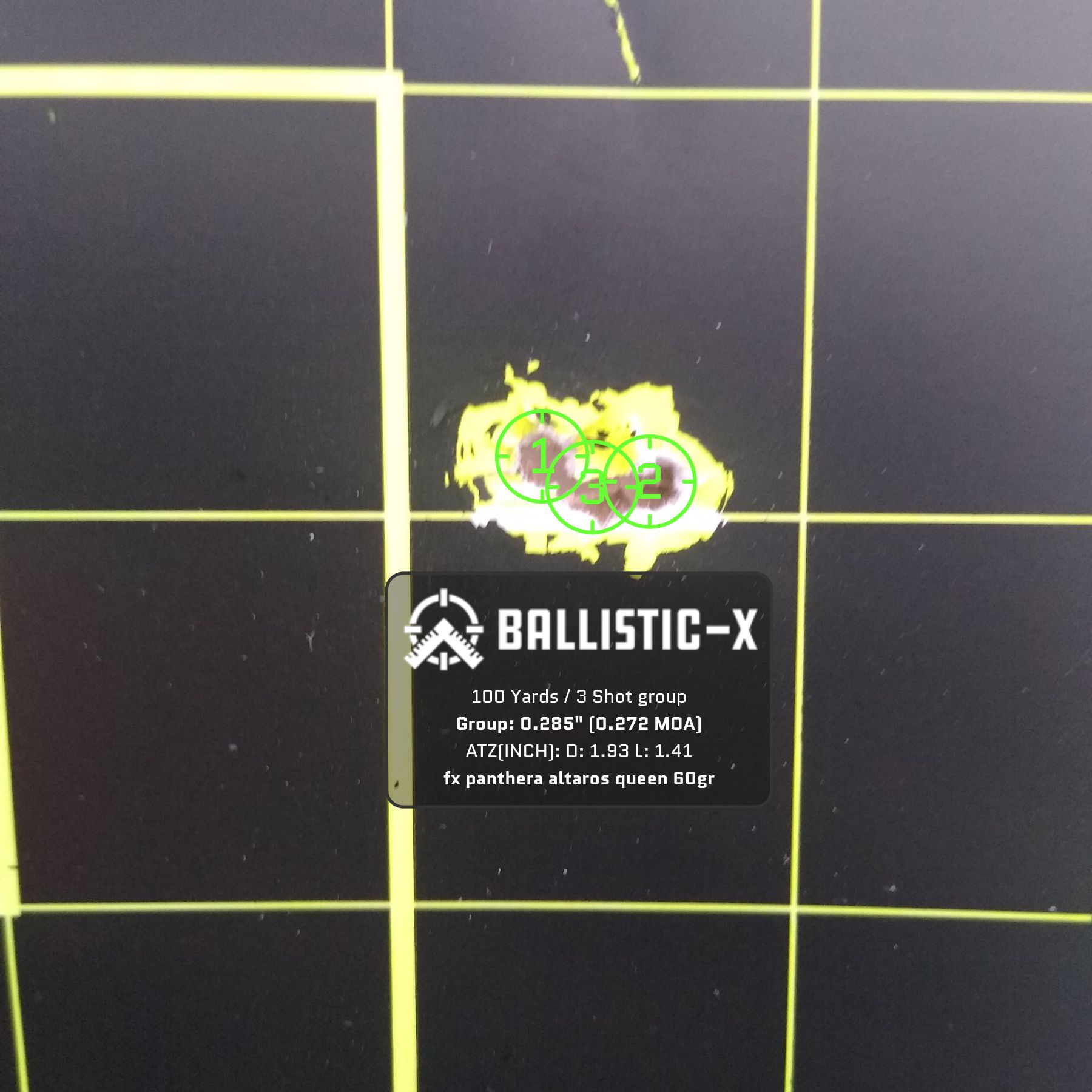

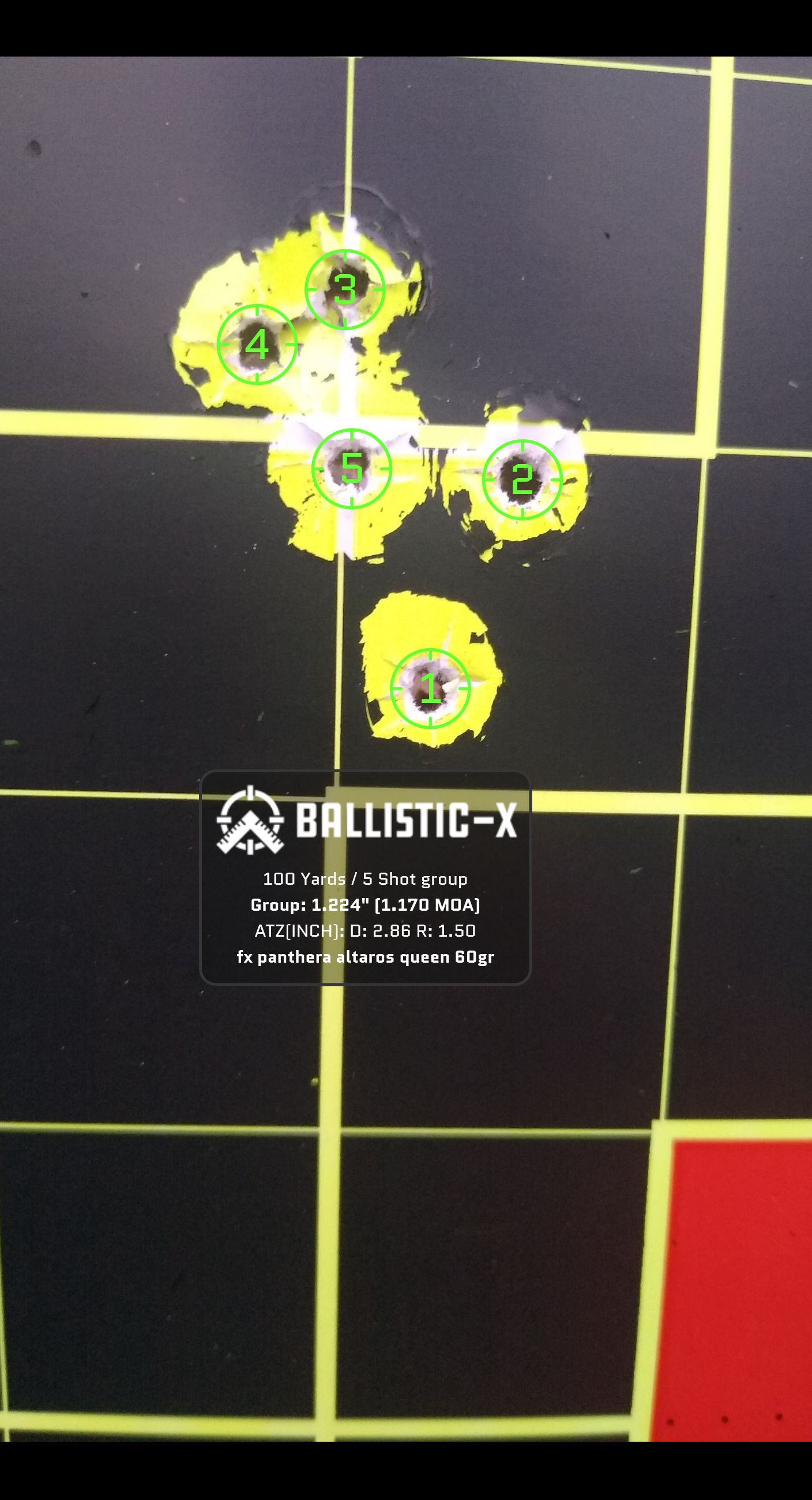

Here's a few more groups from today fx panthera 700mm with the altaros queen 60gr these slugs are unbelievable View attachment 412973View attachment 412974

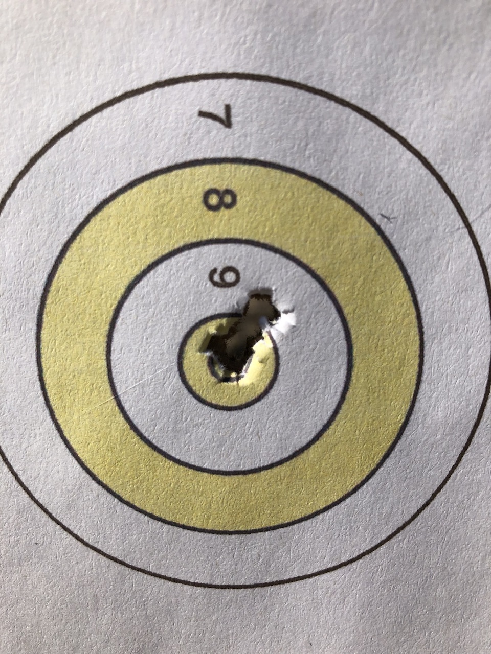

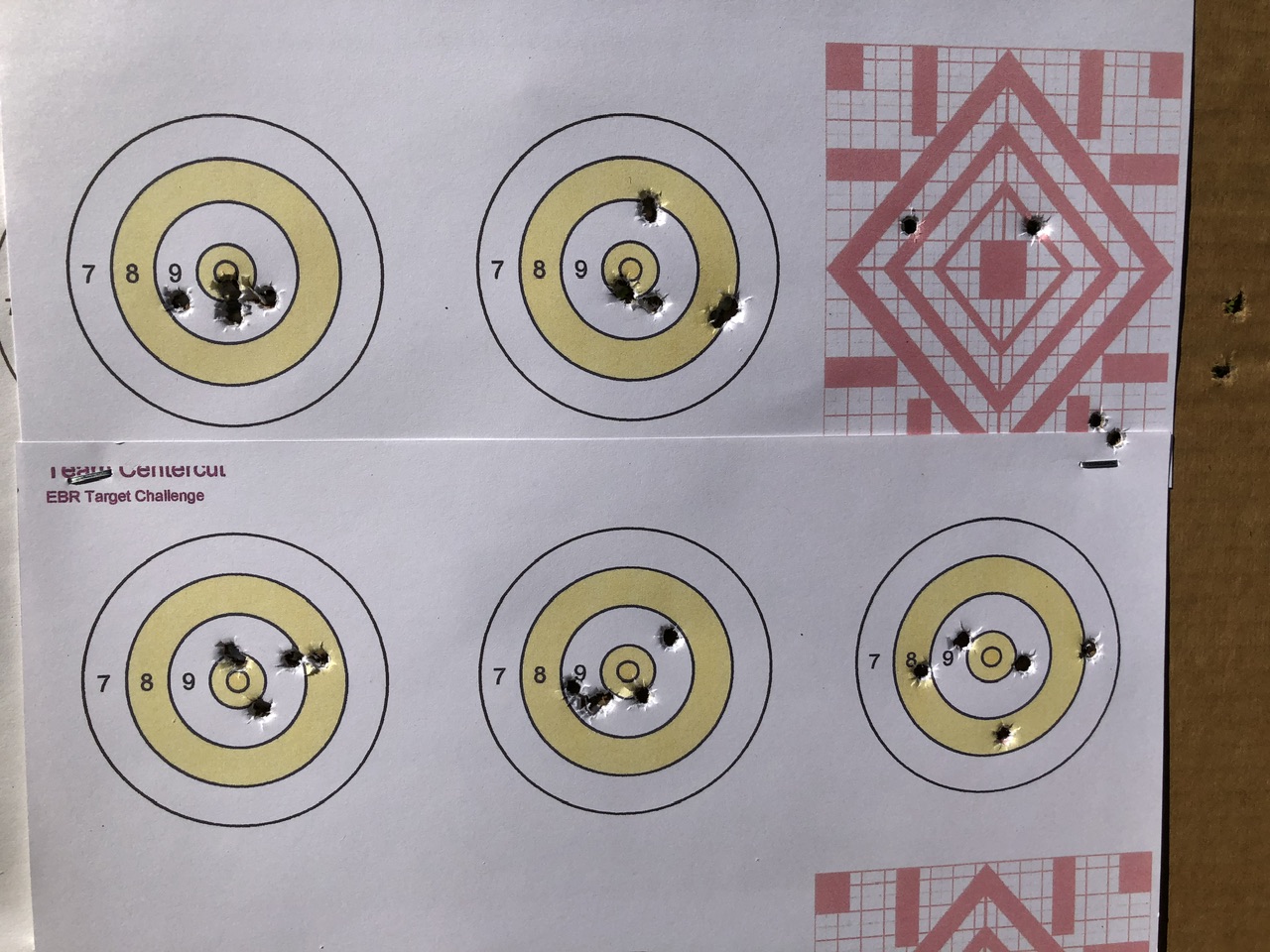

And for those that still cling to the fallacy that Slugs can’t be as accurate as pellets at shorter ranges, I present:
Exhibit 1, 6 shots at 50 yards.
Exhibit 2: 6 shots at 100 yards
And exhibit 3, EBR card in swirly winds at 100 yards, scored as 235 ish

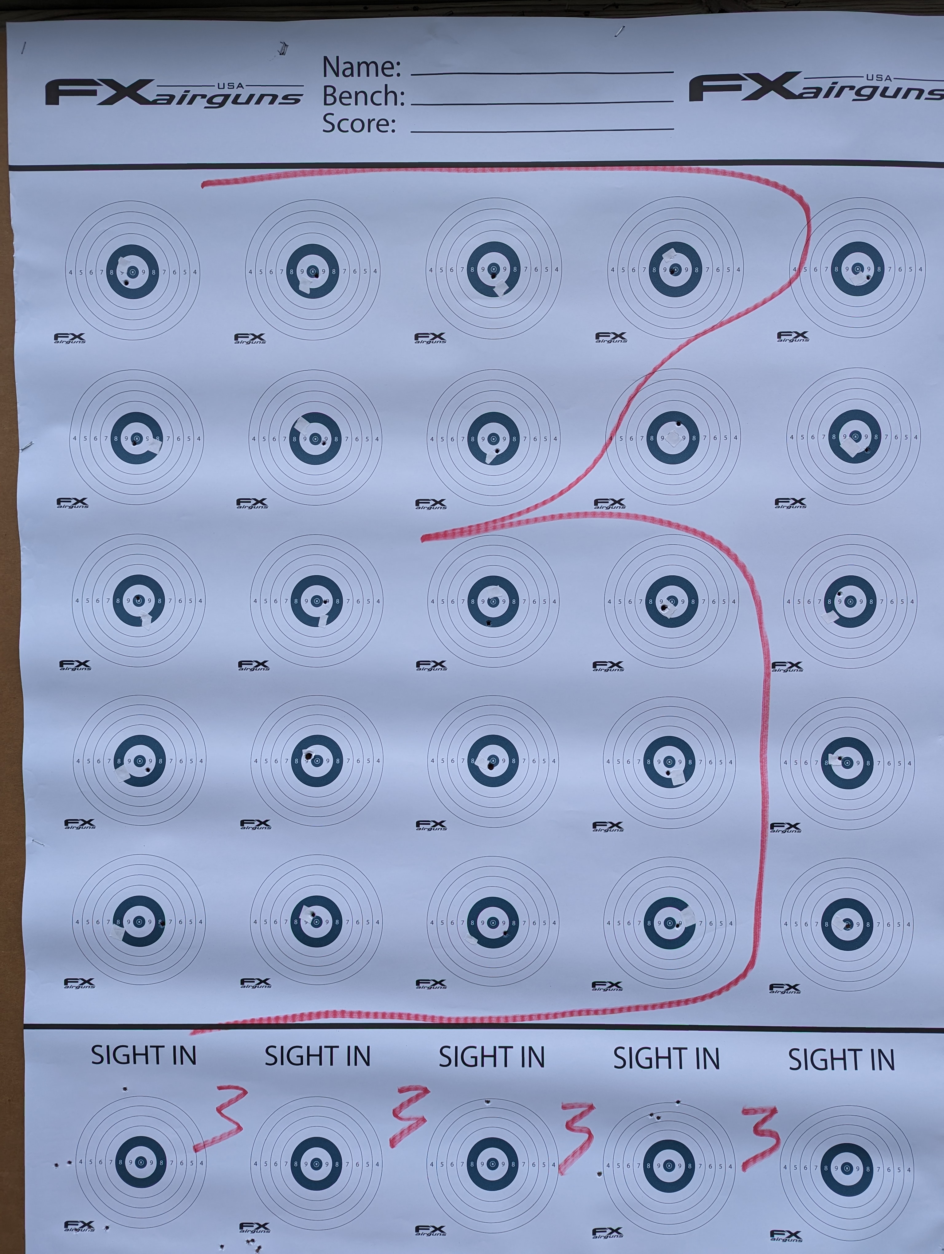

I've been extremely happy with the .22 40gr kings. I shoot them for NRL22 and at the Trenier 100yd benchrest competitions (also shoot pellets). We can shoot pellets or slugs there, and we're starting to break the groups apart for a bit more fairness, but we don't have quite enough people to have full divisions.
This is my winning card from the last match of the season, a 235 8X in significant swirly wind.
After the match we shot a few groups and I had a 1/2in 5 shot group, so yeah, they do well in the wind too. All shot out of my 600mm Panthera at about 915.

I was looking at your sighters and the red #3’s (??); and I was curious as to where you were holding to hit so many 9’s and 10’s.
I never aim at the rings on sighters. Part is ability to see hits, and part is more places to shoot since we shoot each card up to 3 times. I think on that card I was shooting sighters at the 9 and 12 o'clock positions.
The crazy part is I don't recall holding a lot for wind. I've got a MIL scope on that gun, and it was maybe a few tenths? I might have been holding dead on for a good part of that card too. Those slugs are just so good in the wind.
