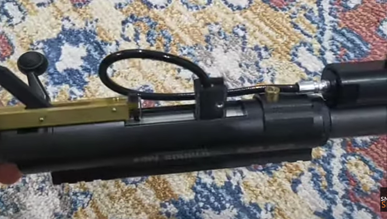

No the M24 have a cosmetic shroud / maybe for some moderation, but it are not able to hold high pressure.
You can see the small below barrel reservoir here, in the M24 hidden by the stock.
screenshot_20220901-183230-2-png.286823
I like to see a fatter shroud on the M24 maybe 45 - 50 mm, but then able to hold high pressure, it should give a considerable volume lift, even if you have to make the reservoir wall thick to be able to stand up to a high pressure.

Air is around the barrel just like in M24.. its M24 with alu chassis and mag fed.. bolt is plenum and it is fed from airchamber (one around barrel) with hose inside chassis/stock.

Due to the fact that the functional part of the rifle is generally the same as the M24 (certain improvements), it is not necessary to develop anything new or there will be a problem when introducing serial production. On the other hand, we are dealing with serial delivery of the stock, and I don't think the rifle will be on the market before mid-2023.
stock: it is a combination of CNC machined parts and aluminum castings, for PCP the stiffness of the stock (chassis) is more than sufficient even for this performance. Fully adjustable design.
The design is a modernized version of the M24 in the US Army, that's why the same name was chosen for the PCP version as well:
Magazine is not exactly where you all think it is, but wait a moment for its location.
The current version was 6 shots, but it shouldn't be a problem to make a larger 10 shot, for PRS type competitions.
The size of the airtube is, with today's power of airgun, an outmoded parameter. I still maintain that 10 shots is more than enough and then they shoot anyway with a connection to a large bottle, as can be seen with other YouTubers. It's just more convenient.
