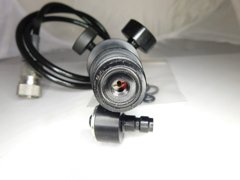

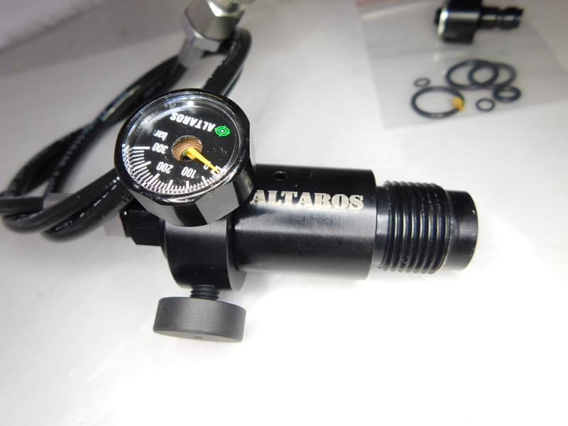

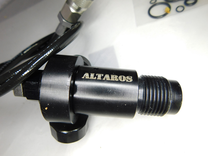

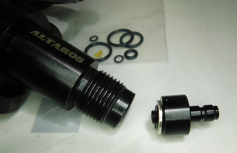

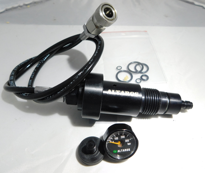

Got my latest Altaros external regulator and thought someome might be keen.
Comes with the bleed screw (POM) and pressure gauge packeted seperately for safety reasons. And an aditional bag containing a complete set of O-rings.
The Pressure gauge is fittet with an O-ring at the bottom and only needs to be hand tight to hold 300bar~4500psi.
Fill whip is @76cm~30" microbore with high quality Foster female coupling.
The pressure regulator is Foster in and Foster out as supplied but the "in" fitting unscrews and the regulator mates with a SCUBA tank of all pressures.
As supplied the regulator is set at @140bar~2000psi (both of mine was at least!). @ ½ a turn in or out will give you @ 40bar~580psi of regulation. You do need to bleed the system and unscrew the regulator to make adjustments. But once it's set it's there forever.
The factory "only" states safe regulation between 100bar~1430psi and 210bar~3050psi but one of mine has chugged along for several hundreds of shots with my Texan tethered at a steady 250bar~3625psi with no issues. (quality?)
Oh and the ring with bleed screw and pressure gauge which shows regulated pressure (ie out) can be svivled when no pressure is present (3000 psi will lock up things tight)
I paid €130 but you lucky sods only have to pay $130 ;-)
