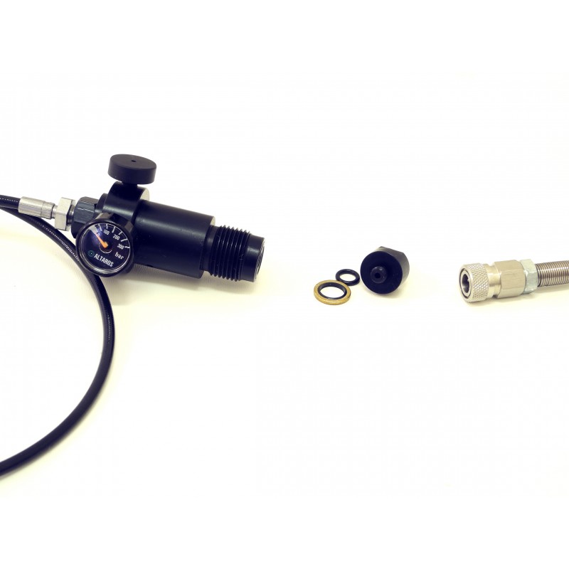

Trying to figure this email out.. Maybe you know.. There is 2 o rings and a dowty seal for the inline male adapter
Maybe the dowty is a 10 mm id
From Altaros:
Usit ring 10,7x16,7x1,5 between reduction and external regulator , there is also added ring 7x2 nbr 70
12x2 nbr 70 on bottom of external regulator
pic..
It is this part: there oi one that fits on the inside thread of the male adapter that fits inside the dowty seal..
