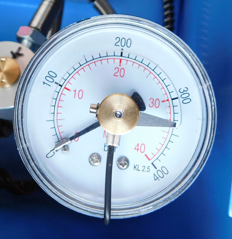

So i played with the B2B unit today and boosted a 15liter~0.529cft bottle from 200bar~3000psi to 250bar~3750psi.
I used a 12liter~0.423cft bottle at 200bar~3000psi as feed + 3hp compressor for work.
Took a mere 7 odd minutes to move 750liter~27.5cft of free air and set me back @ 65bar~950psi, and the compressor did'nt even go 50/50.
Oh and the B2B has a electric controlled set max. of some 330bar~4800psi so it will fill anything in the current PCP buisness to max!
For larger fills it can be run from either a netadapter or via a USB cable for full auto function and use the built in max. set feature.
In the rough field (with no electricity at all) there is a push button that will give two strokes of the booster for every push.

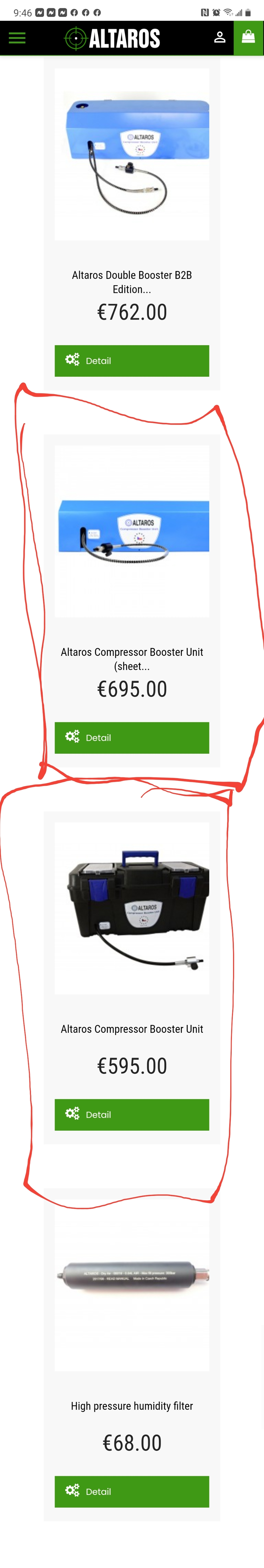

so which one is the normal booster I see the one for 595 and a plastic box and the one with the sheet metal box for 695.
Kit? I 'm trying to navigate the site but don't see a kit.
