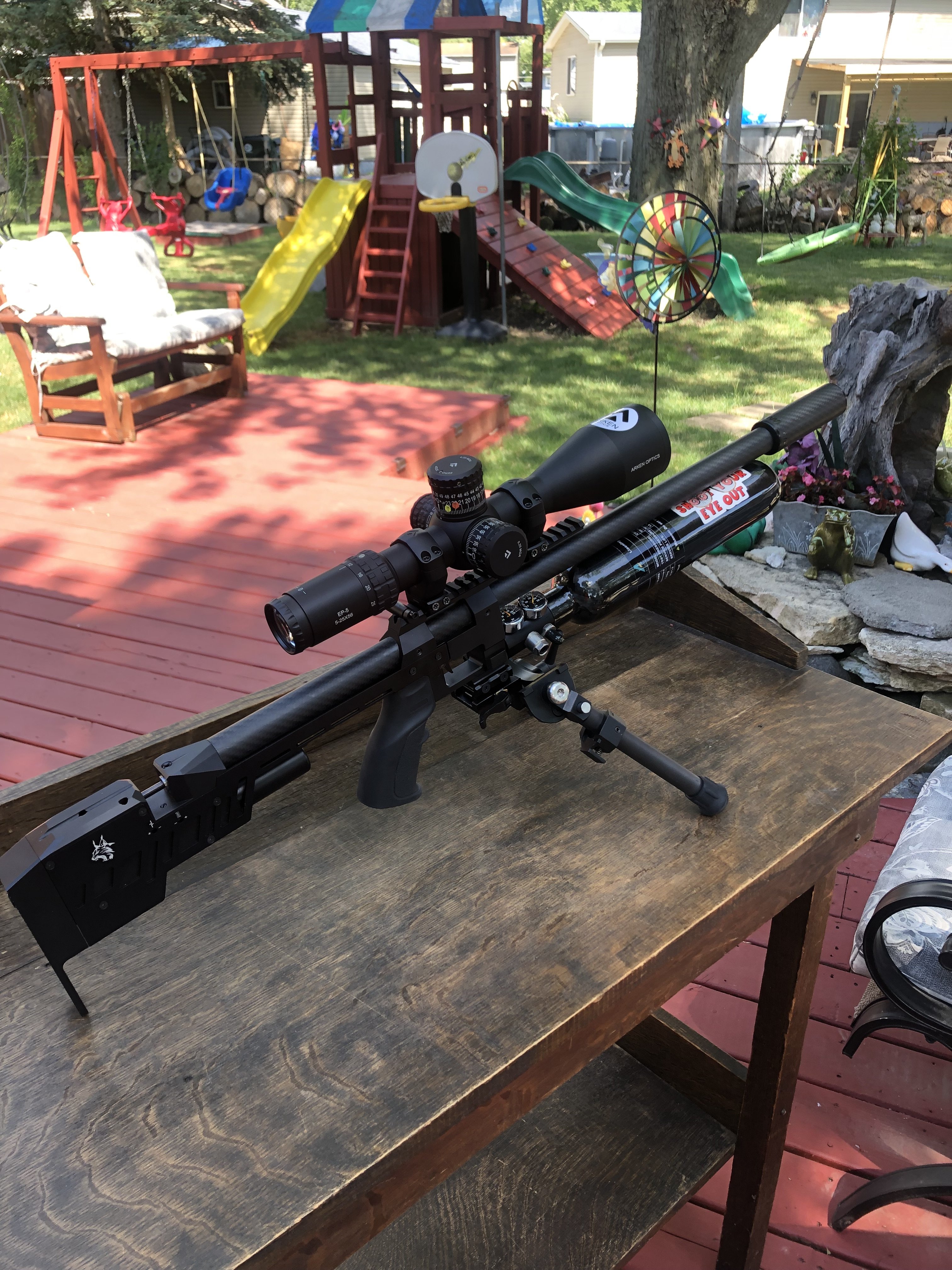

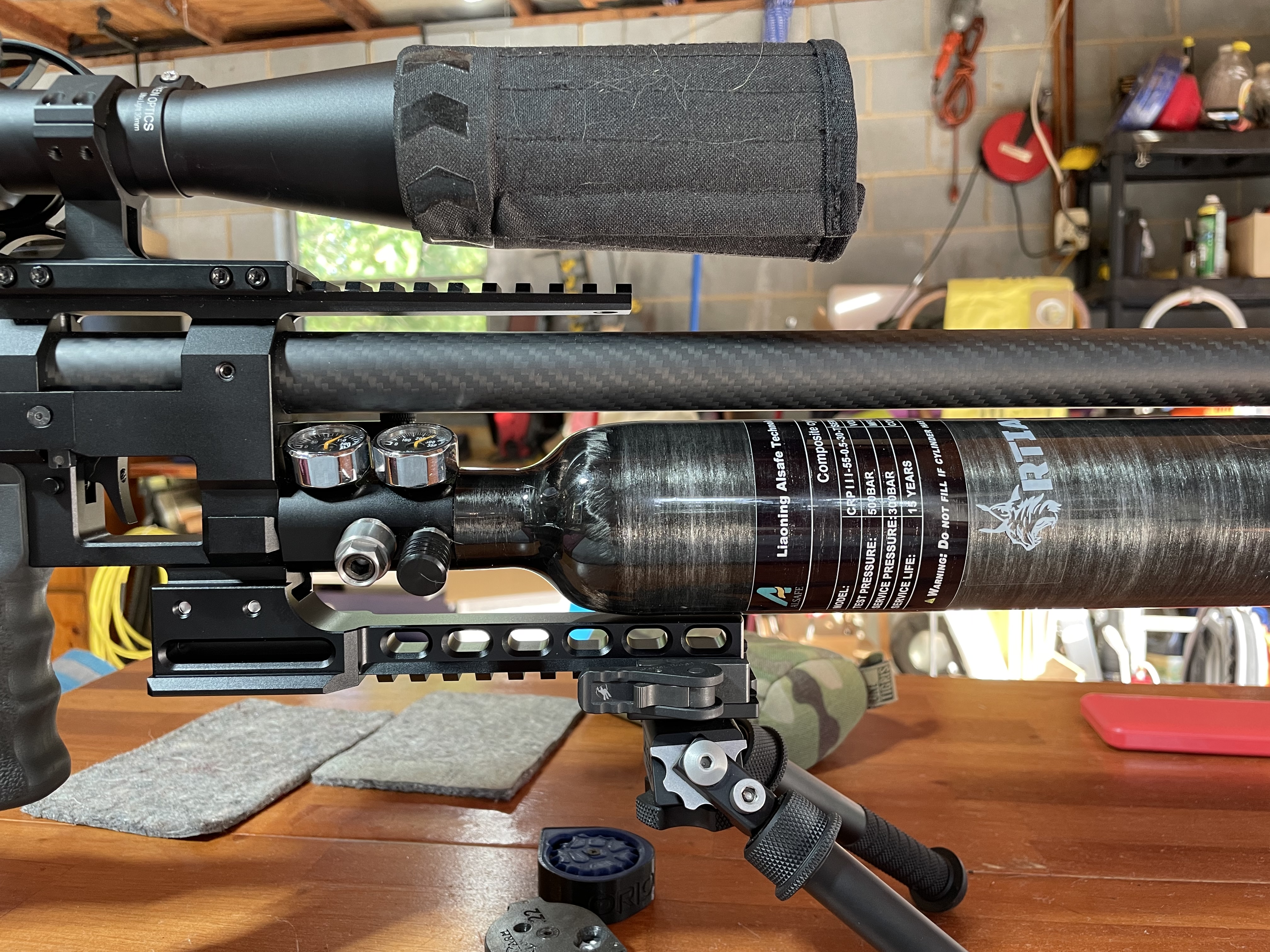

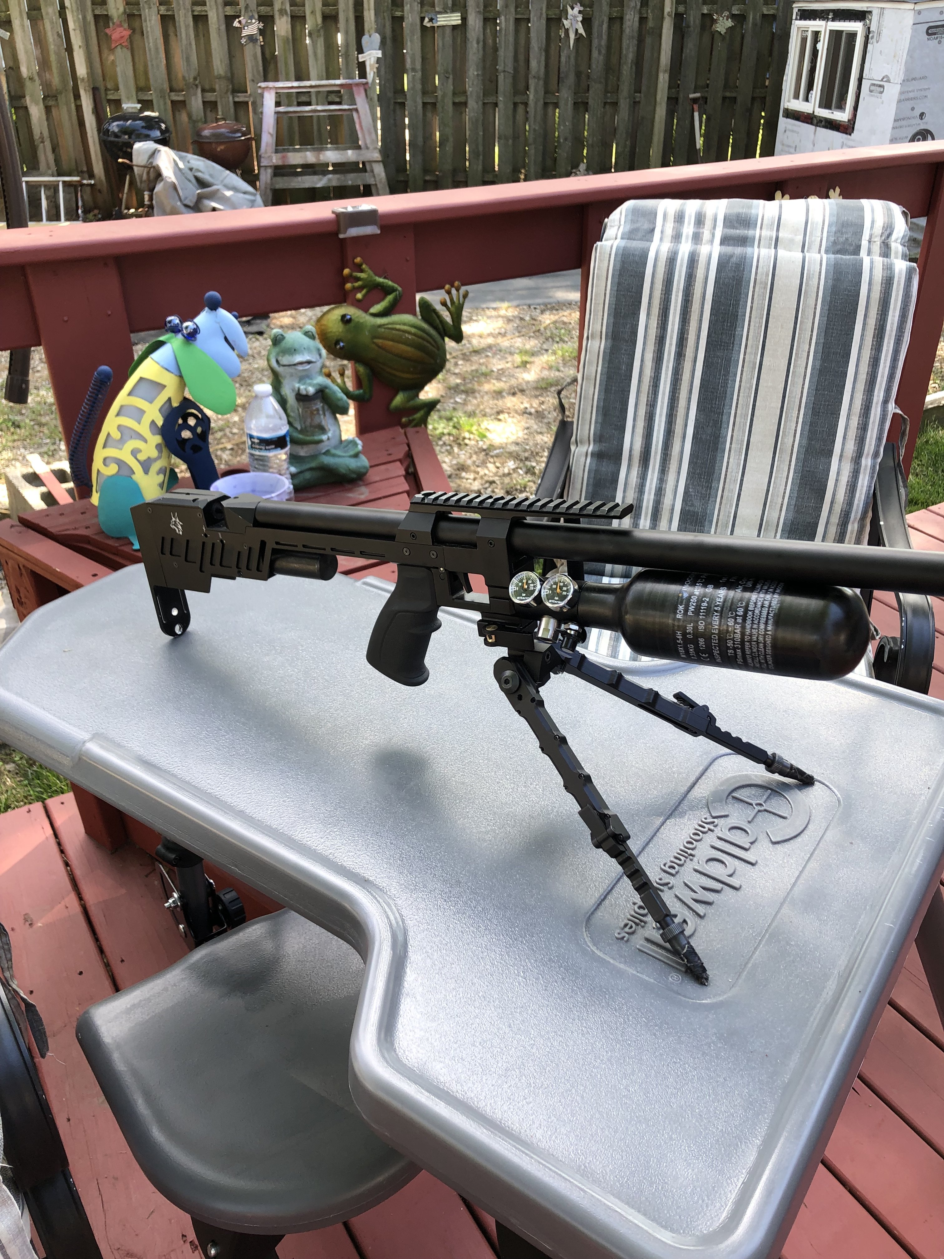

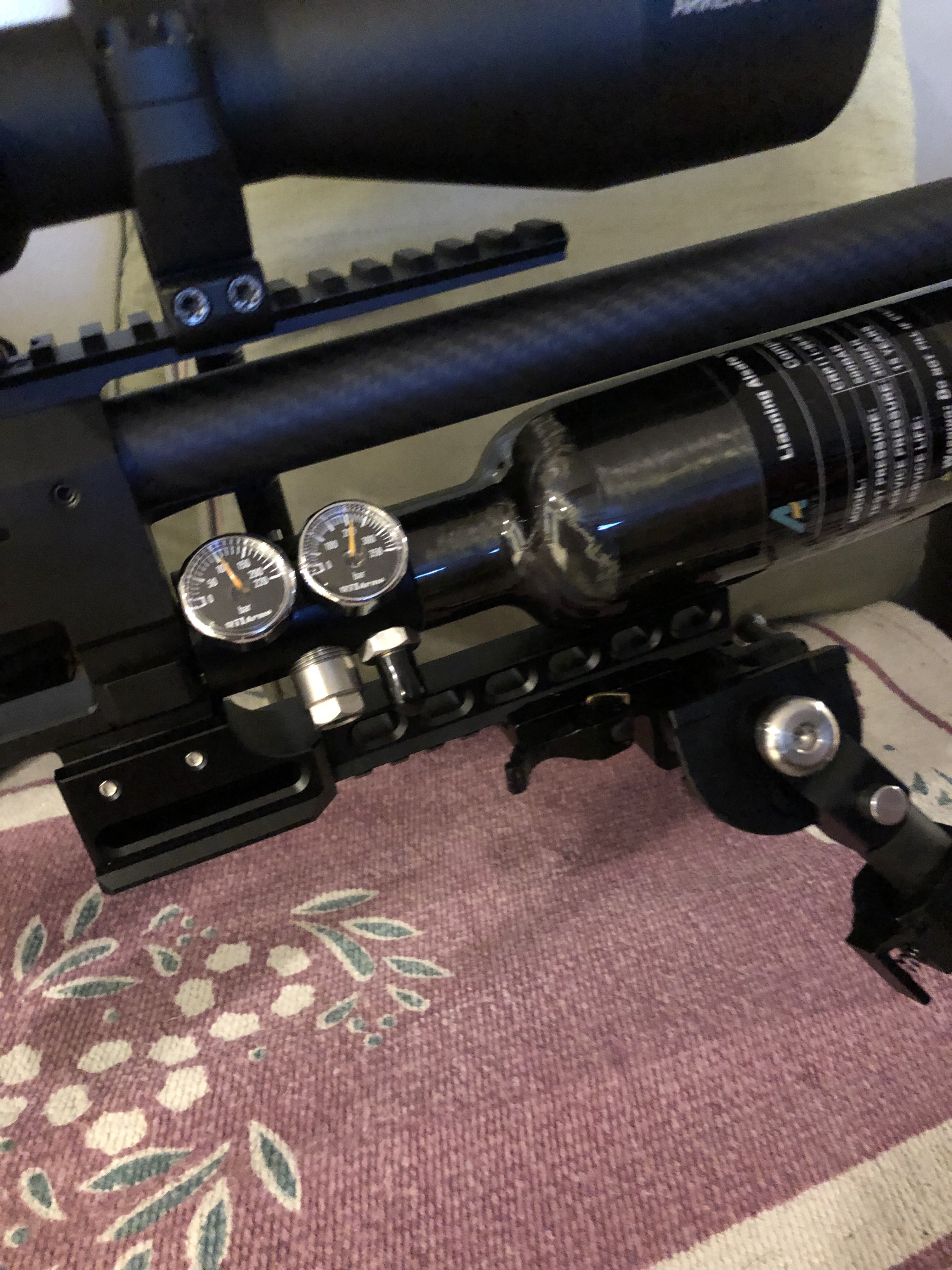

Matthias,

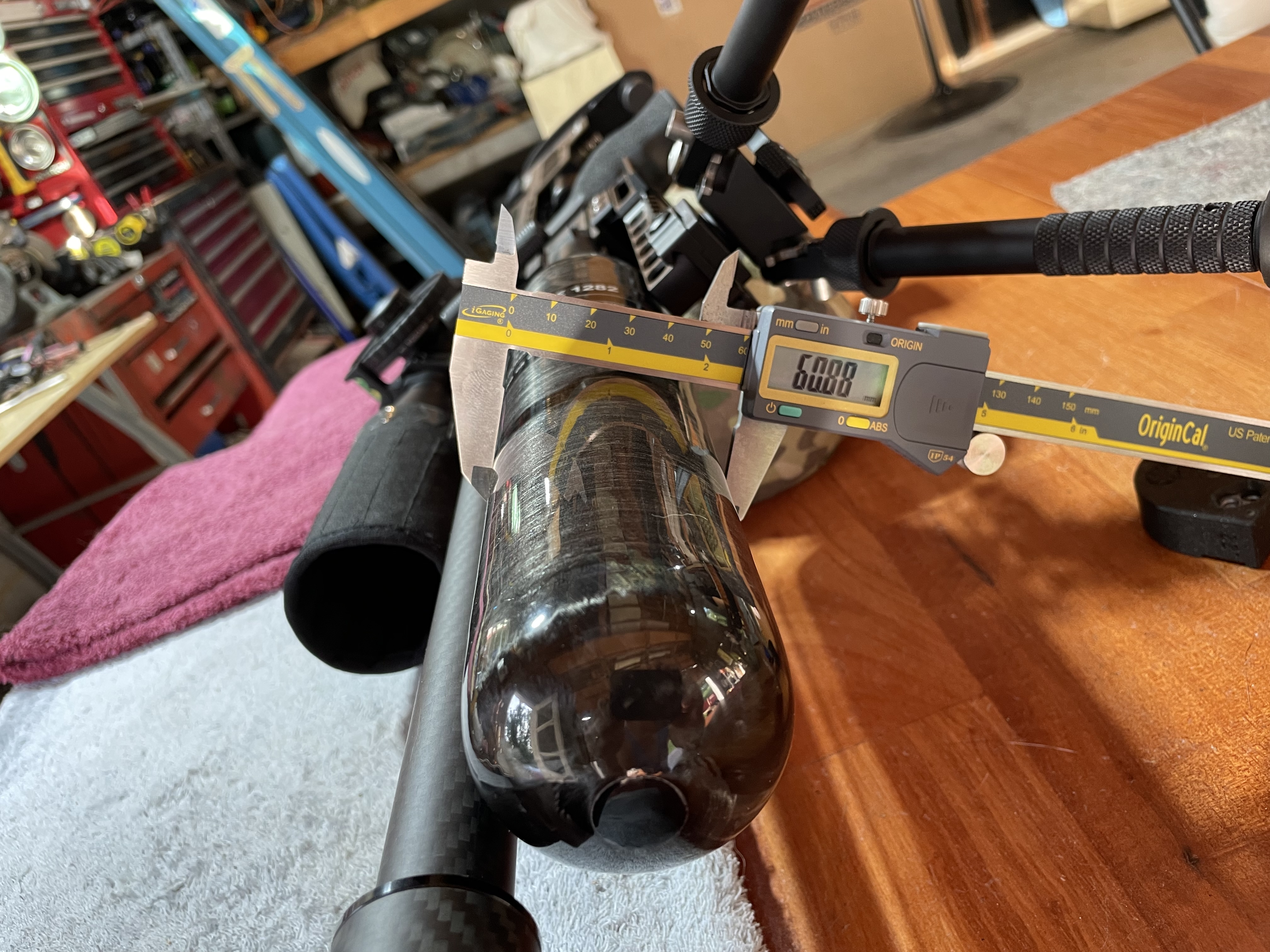

The bottles used by RTI are from Alsafe and nothing exclusive except Alsafe or RTI adds the RTI label. The 200cc bottles that are standard on the Compact are 54mm diameter. These can be had on the auction sites much cheaper. Assume you have a Prophet Standard? If you have specific questions let me know as I have a few different setups. I’ve been working with Prophets since they came out. I’d be happy to help get things set up correctly for what you want to do.

300 C FX WORKS AS DOES A 480 FX
