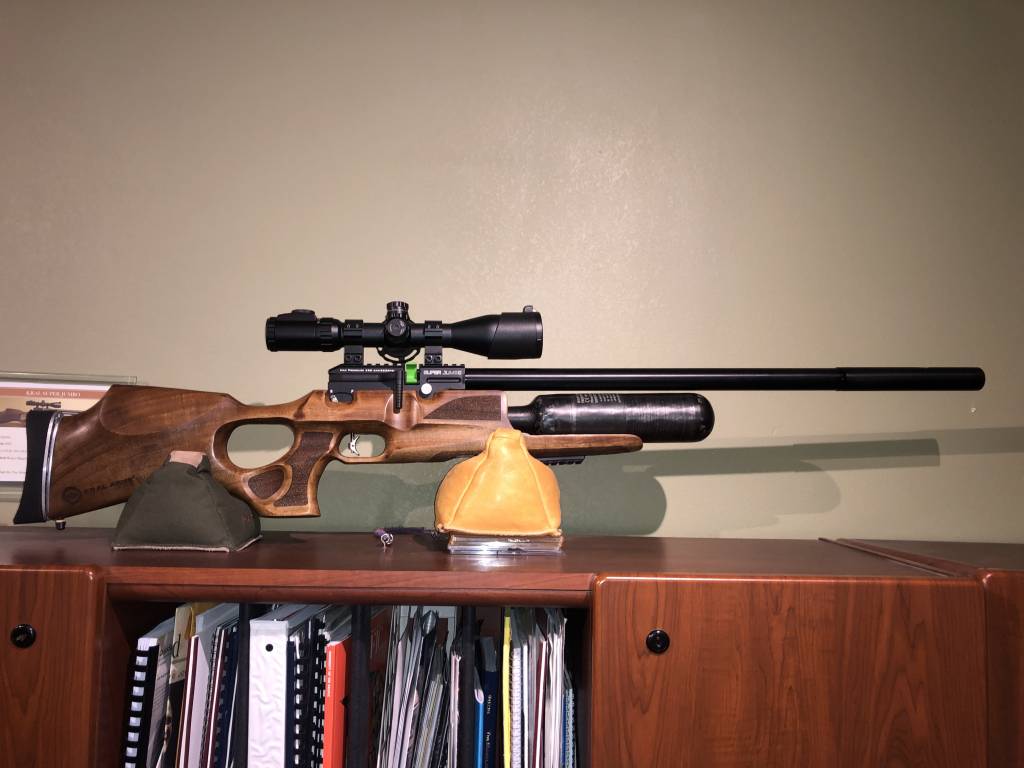

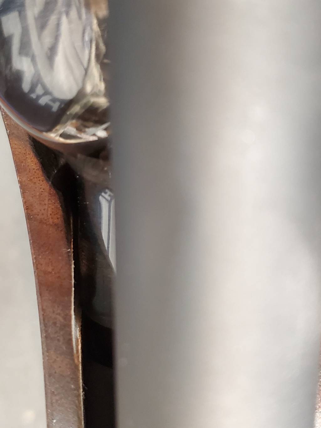

Tuning Alsafe 500cc CF tank perfect fit for Kratos.
I'm not sure why I went with this 500cc tank over a more common 580, but on the Kratos, to me, it really seems like about as perfect a fit as one is going to get swapping from the aluminum to CF. Not only will it reduce weight and increase shot count, but this specific bottle has a very short neck compared to 580 and 480, so i am getting a fit to the wood that I is pretty much perfect.
Before and after above.
In addition, the amount of wood removal was very light. much less than putting a 480 or 580 as this 500cc is almost as narrow as these new 700cc. The 580 and 480 are a good 1/4"-3/8 fatter.

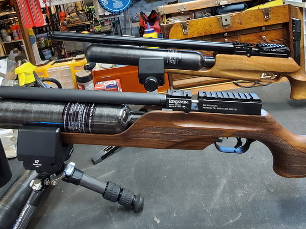

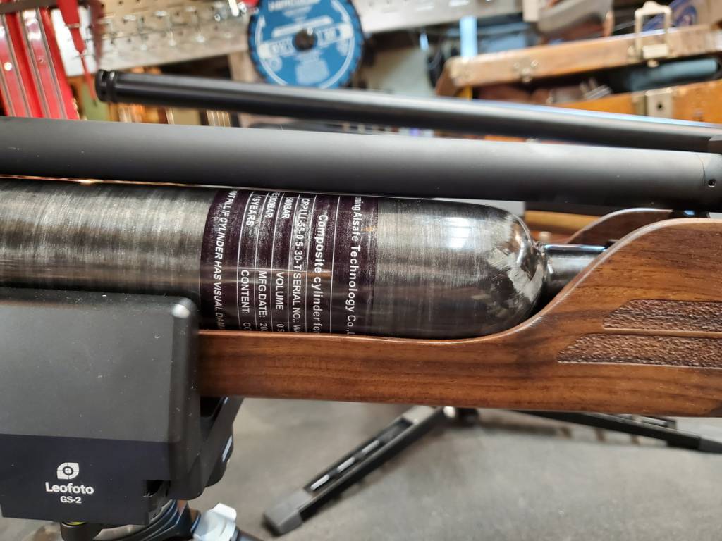

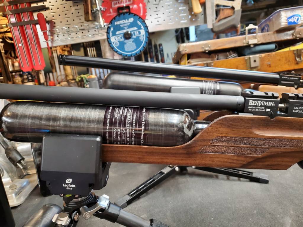

Compared to the very long neck on the 700cc on the Kral, which leaves a big space;
