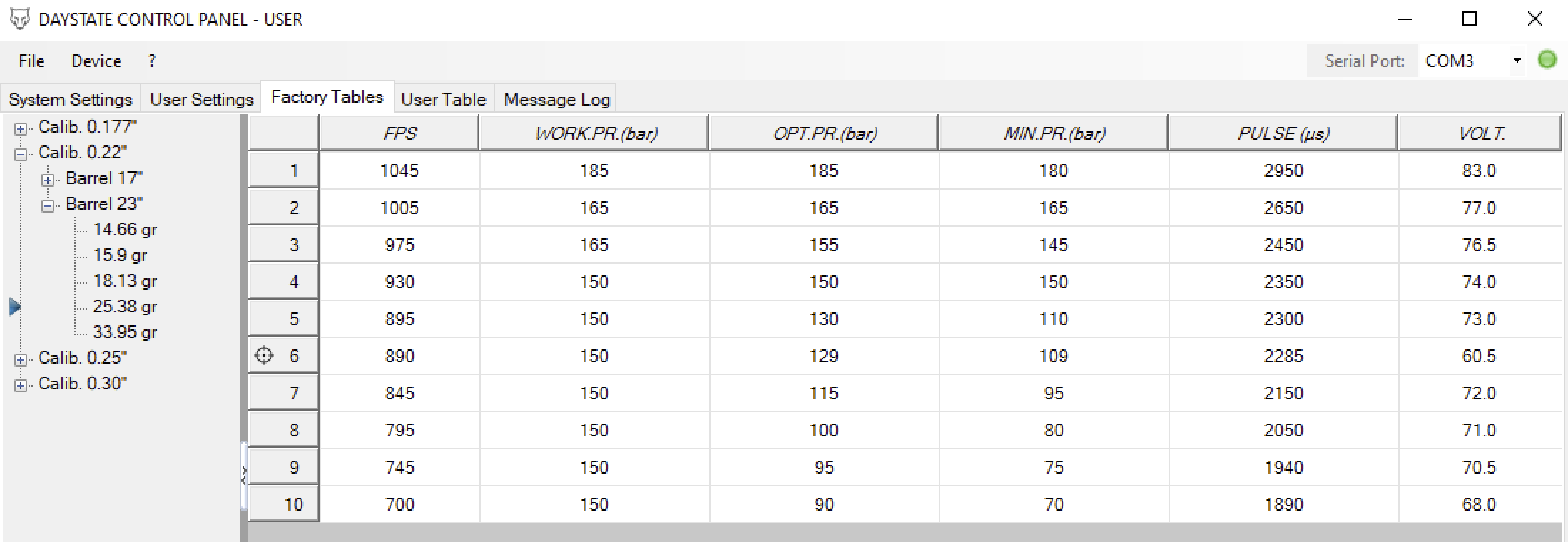

I have recently just received my Alpha Wolf and I an in the learning curve. The factory setting seems great for finding what pellet speed is good for accuracy but for daily use Advanced Setting seems the way to go. Mine is a 22 high power and I was hoping I could pick some brains out there for at least some good starting points. Im curious on your guns what your reg, dwell and voltages are for the Monsters and 18gr or if there is a table somewhere with this information. I’m aware my mileage may very as ever gun is a little different but a little head start could save me some head scratching and no doubt tons of pellet. Thanks Mike
I don't have experience with tuning the .22 barrel. Instead I think the captures from the Factory Settings in the Daystate Control Panel will be helpful to give you a starting point for advanced settings tuning.
