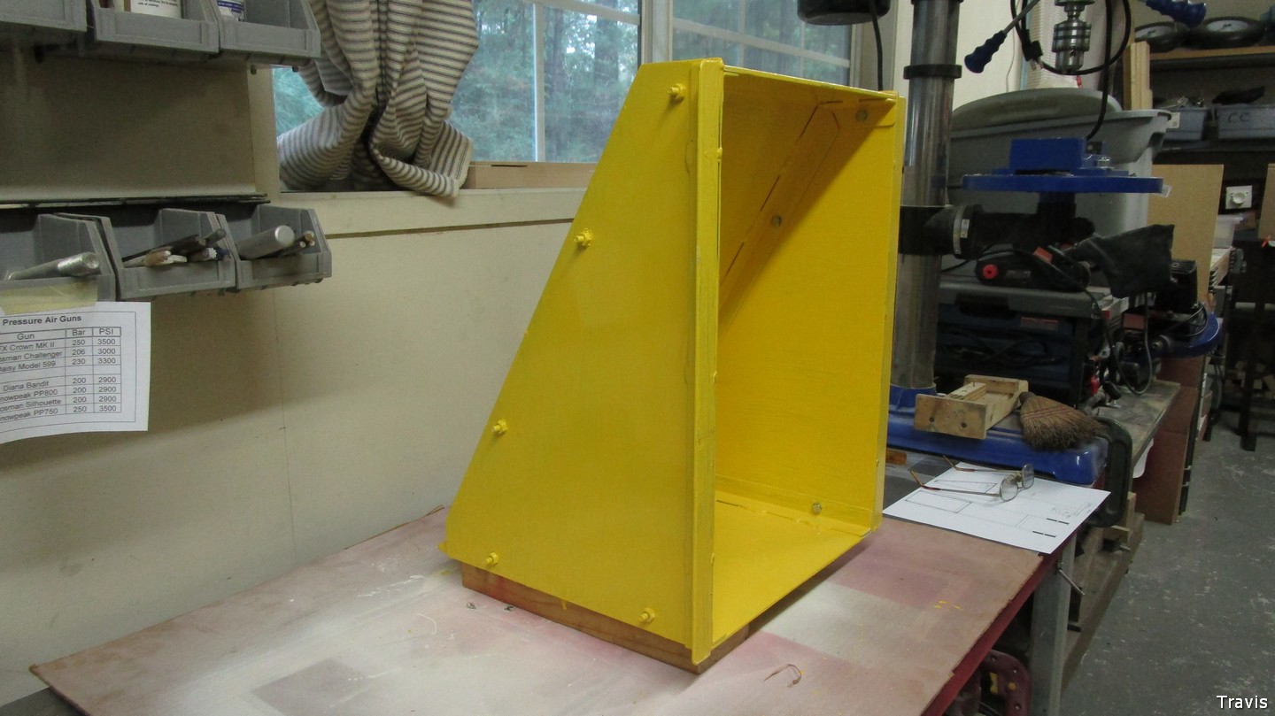

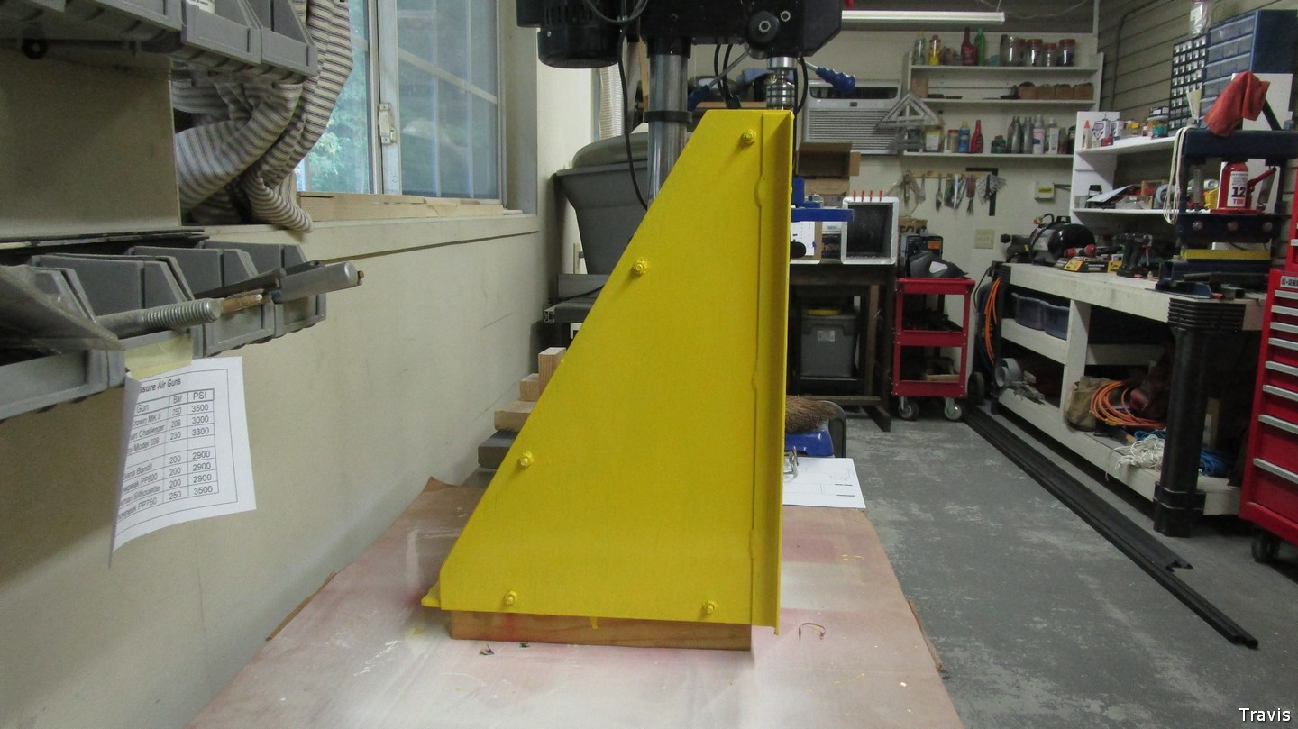

Hello everyone,
I have just completed building the Alpha Bullet ~ Pellet Trap, as I am calling it. After I had designed the Big Bang Pellet Trap a number of Forum members asked about making a larger and stronger Trap. Several weeks ago more members brought the topic up again and stated they would be interested in a Trap that would handle USARB and N50 size targets which are 11x17 inches. After talking with @Str8tshooter I called Pete ( @Pellet trap man ) and ask him if he would be interested in building some larger Traps if I came up with a new design and he said he would but it would be after the first of the year.

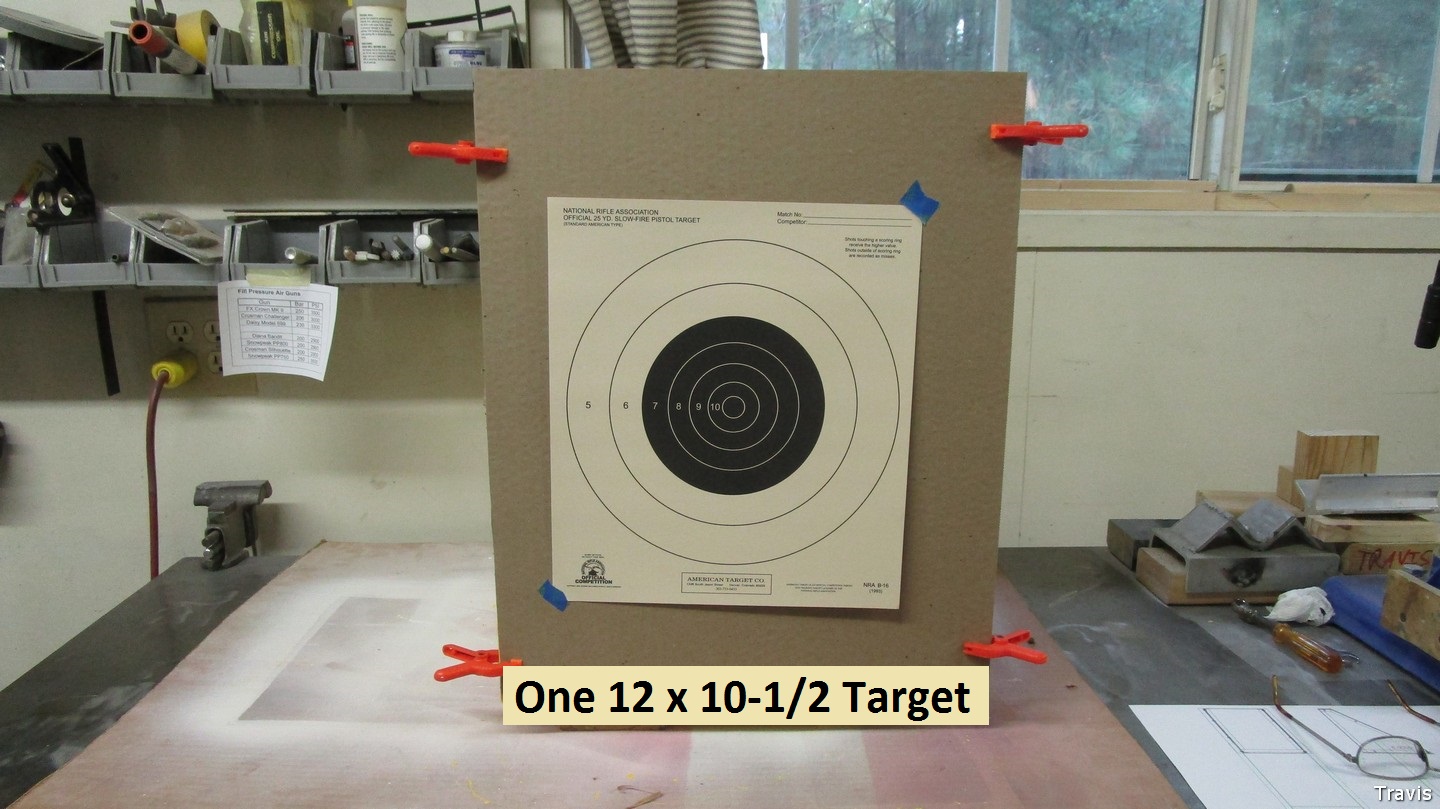

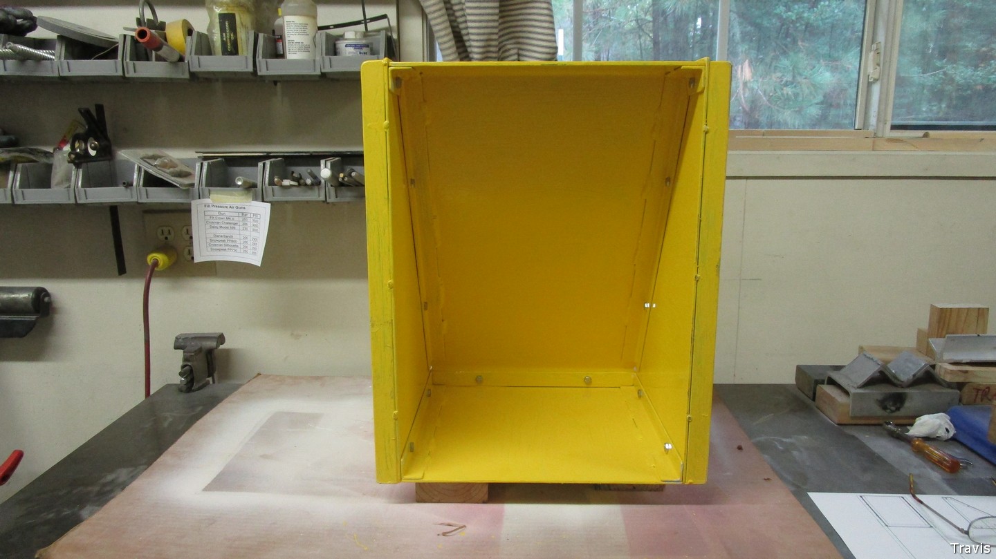

So I created this new design made out of all metal so that it could not only handle the larger pellets but also .22LR at 50-yards. Of course it can be shot at closer distance with Pellets. The basis that I used to establish the design parameters was a maximum of 107.5 FPE at the muzzel, using 1100 FPS with a 40gr projectile ( 22LR Standard rimfire bullet ). The frontal opening is 13" wide by 19" high which will accommodate any size target up to the 11 x 17 USARB / N50 or equal. I added 1-inch angle along each vertical side to allow the cardboard backing to be easily clamped in place to tape the Paper Target on. The Sides and Bottom material are .135" thick A36 and the Back is .1875" (3/16") thick A36 slopped at 60 degrees. I designed it so that it can be un-bolted / disassembled to reduce the overall size for shipping and reducing the cost to ship. Unassembled it will fit into a heavy duty cardboard shipping box 24x14x4.

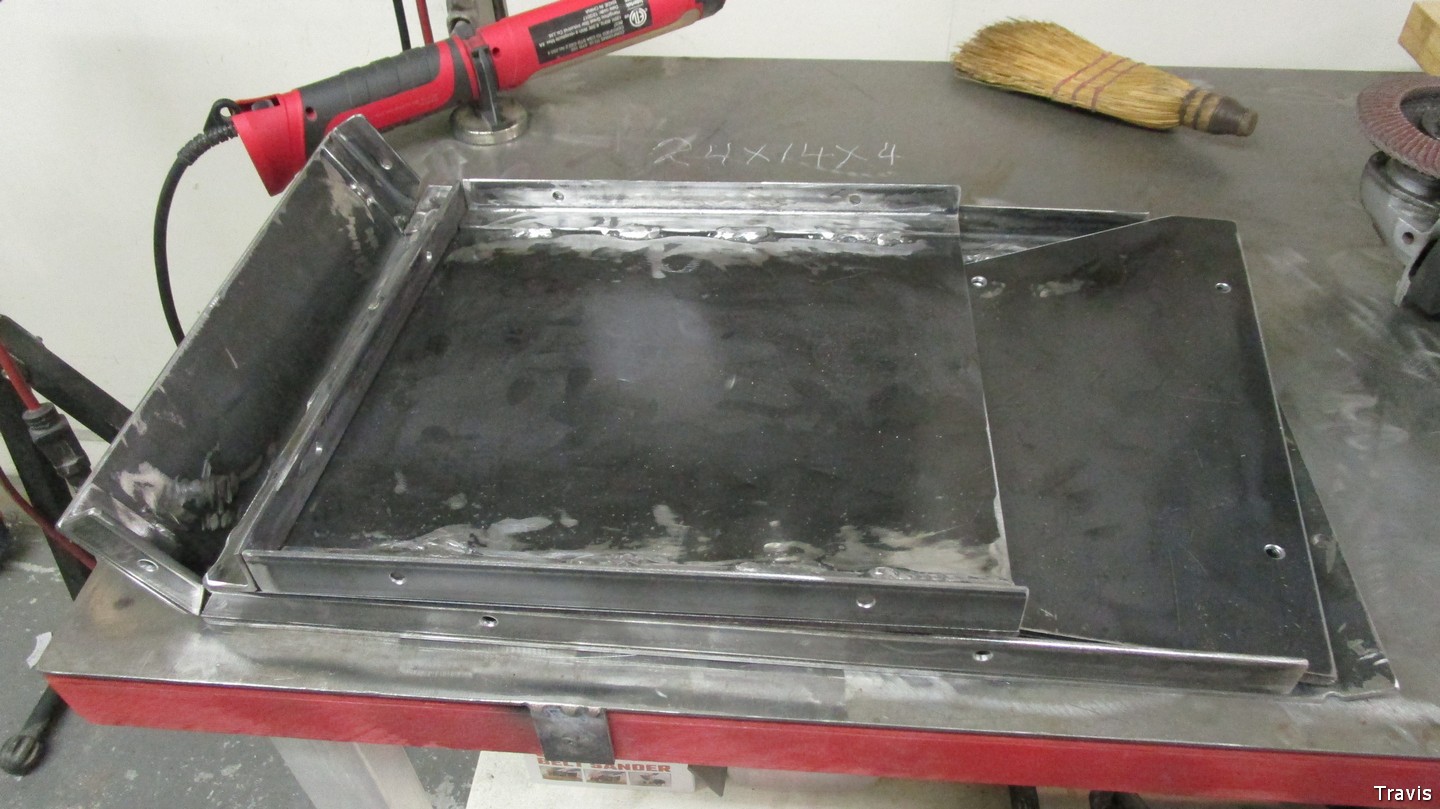

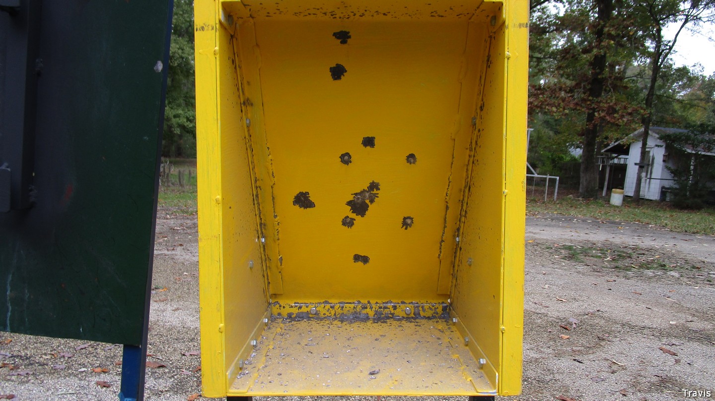

I was curious about the unit so I ordered the material to be laser cut and bent to shape per my drawings and spent several days welding, drilling holes and painting to get the first completed Alpha Bullet ~ Pellet Trap, see attached photos. Then I took it over to my friends farm, Delbert, where we set it up on a 50-yard range and shot it with my competition .22LR rifle using Standard 22LR (1070fps). We shot it mutable times and at the impact area it did remove some of the paint from the back plate, other than that it remains as “new”, the steel back plate smooth with no damage. This is one heavy duty beast and weighs in at 46+ pounds, ( less the frame with wheels ). I later shot it at 10-Meters with my .22 caliber Airacuda rifle with both 18.1 and 25.4gr pellets ( 41.2 fpe ) and obviously it didn’t do any damage at all. If you are shooting a .30 caliber, 50gr at 1,000fps that would be equivalent to a .22LR.
This turned out to be a lot of work but surely worth the effort.
ThomasT
ThomasT
