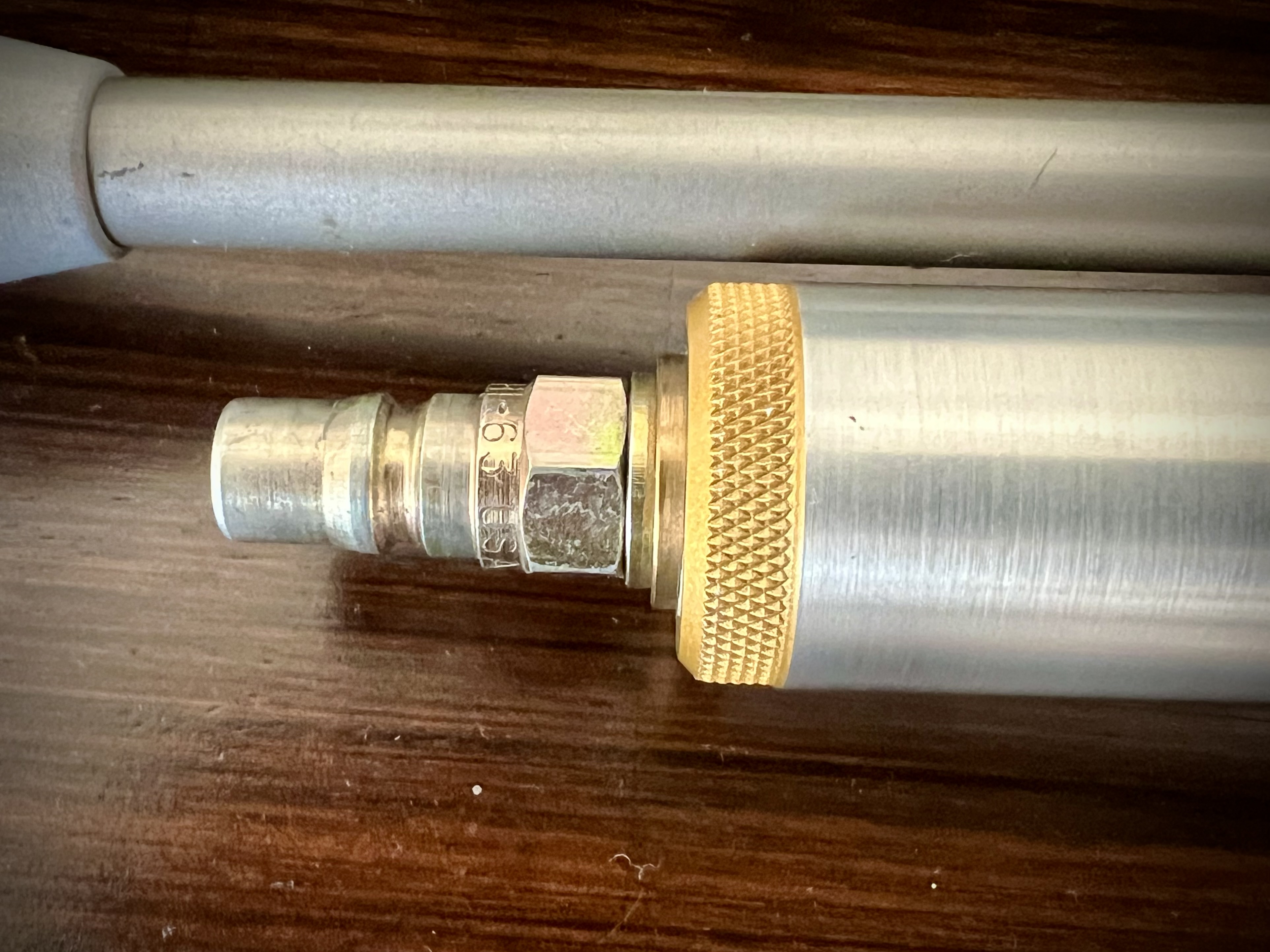

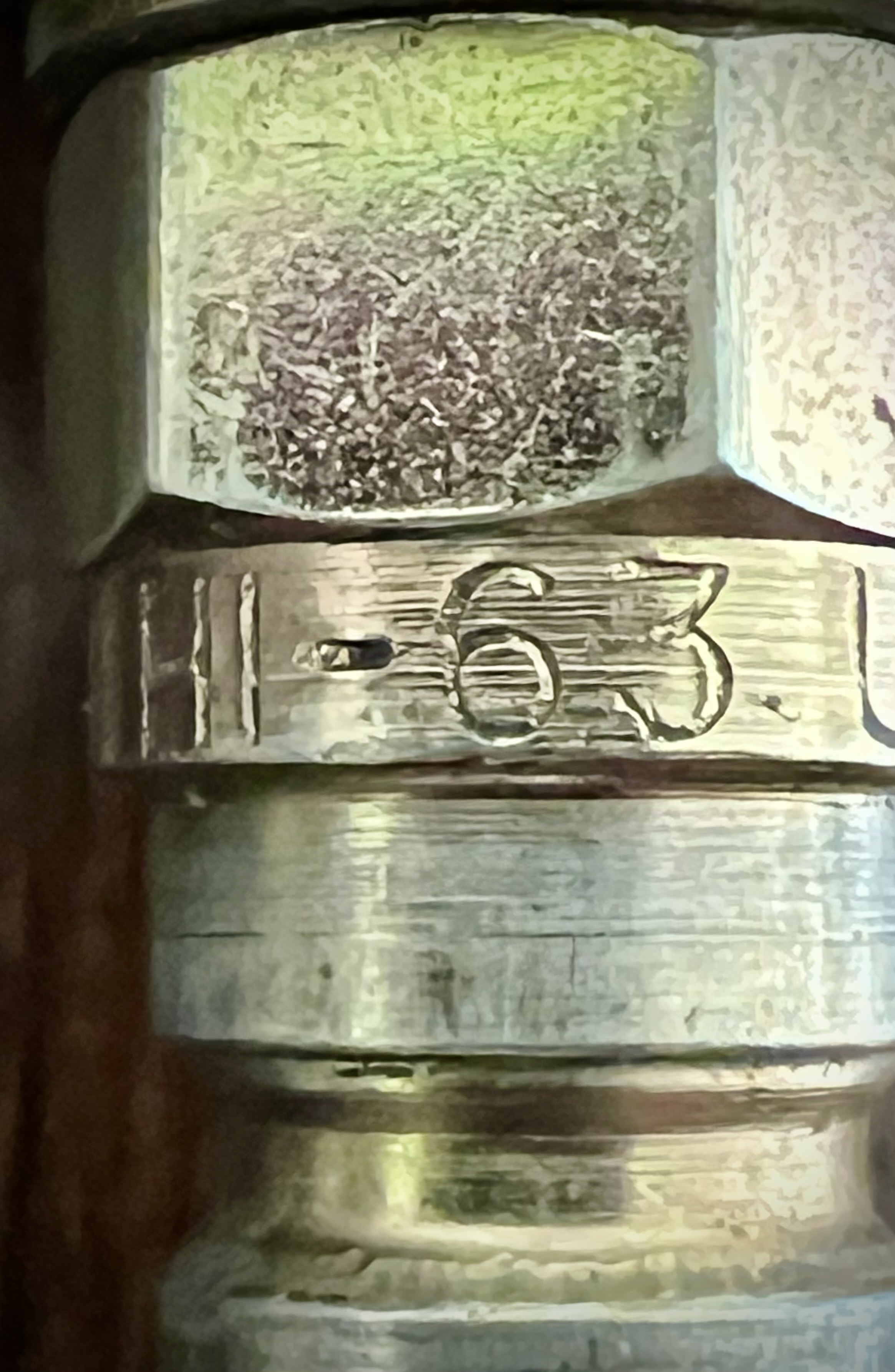

What fitting did you use for the quick connect?It is a Parker H1-63 hydraulic connector. You can get them from Amazon l, not sure about quality, granger etc. Just order new ones, they are cheap.

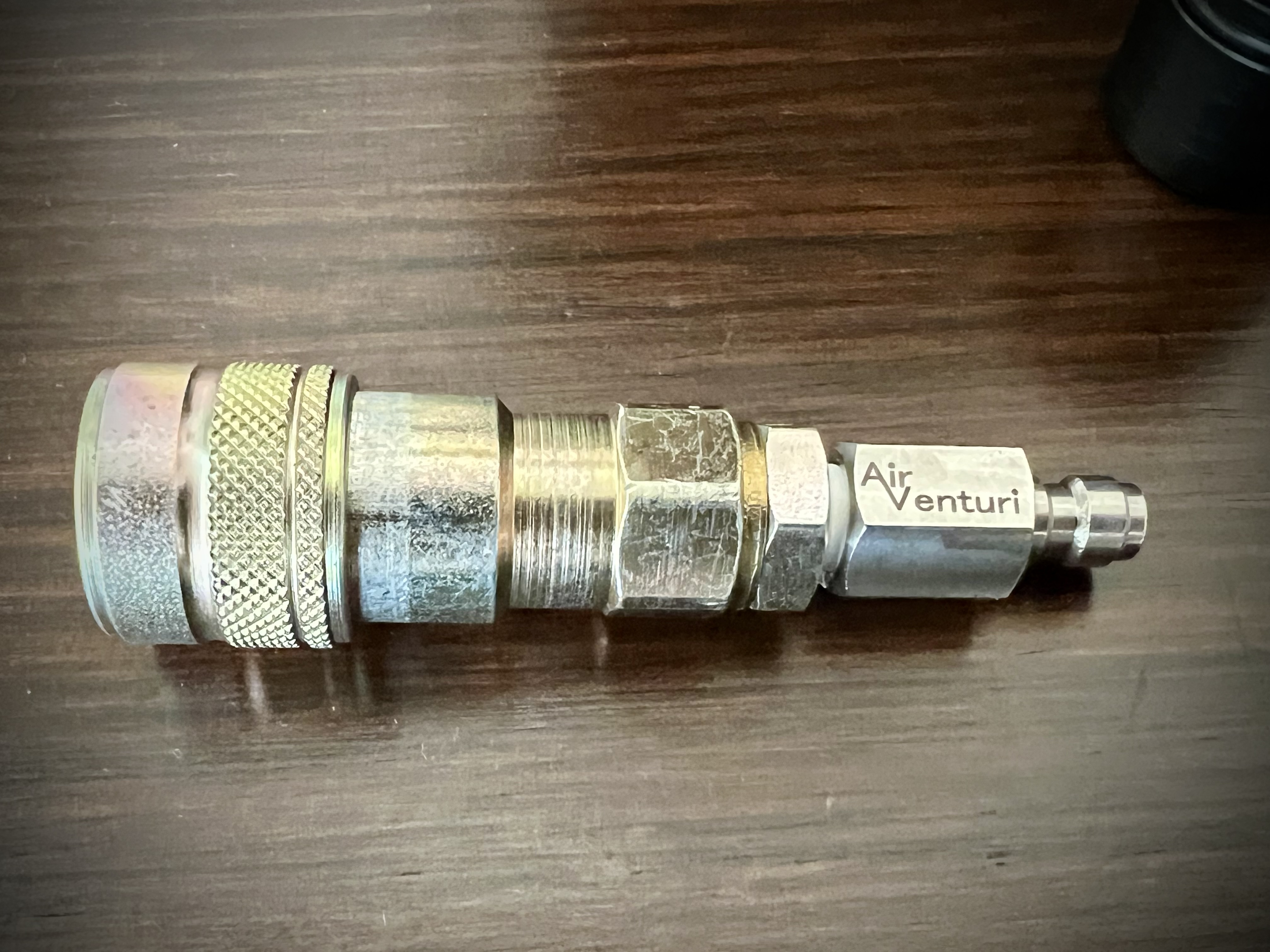

I have an AirVenturi quick connect on mine.
View attachment 568865View attachment 568864
From the parker to the foster fittingWhich part are you asking about? The male portion on the gun or the female that goes on the fill hose?
