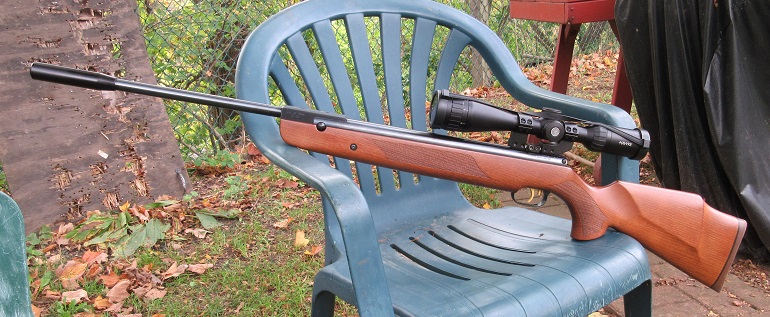

I got an older 20 caliber R9. It's got a Vortek kit in it it runs about 16.5 fpe with both FTTs and 13.73 Exacts. It shoots REAL nice I just finished redoing the stock. It's crazy accurate. First cold shot is dead on! I think its gonna be my new favorite.

I have an R9 .20, same rifle.

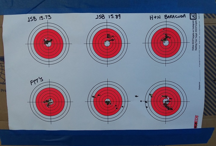

I have others but only shot those 4 over my chrony and for groups. FPS numbers I got for 10 shot averages for mine and my target groups at 25 yards. Take them with a grain of salt since your numbers may well vary. The bottom middle and right targets were me sighting in a new Hawke Airmax 4-12x40 scope.
H&N FTT 11.42: 753 10 shot avg, FPE 14.38, ES 9, SD 2
H&N Baracuda 13.58: 683 10 shot average, 14.07 FPE, ES 11, SD 4
JSB Exact 13.73: 682fps 10 shot avg, 14.18 FPE, ES 13, SD 4
JSB Heavy 15.89: 631 10 shot average, 14.05 FPE, ES 15, SD 4
I do have other .20 cal pellets, but after a quick look at a few places, I'm not seeing either the Benji Domes or Predator Polymags and not a clue honestly if they stopped making them or not. AoA at one time also carried some Daystate labeled pellets, but they're just relabeled H&N or JSB's. Not sure if they'll bring them back or not.
The Airmax was sighted in with the FTT's, the other 3 I just aimed dead center and shot to see how well they'd group. All 3 shot very well though and all it would take is a click here and there to totally dial in for any of them, and this is just me, the JSB Heavies might be a bit too heavy for the gun.

First of all, just WOW! on that stock. That is a fantastic looking rifle. Question about that muzzle device though. Is that a moderator or is it just a barrel weight more or less? Is it threaded on or is that a slip on?

It's just a muzzle weight. I believe it's blued steel. It's held on with two grub screws. I bought the gun from the original owner and the receipt shows the shop put it and the rear sight blanking plate on at time of purchase. Not sure who made them. They maybe Beeman??
Well it looks pretty great on there. I'll check around and see what I can find. Thank you for the info

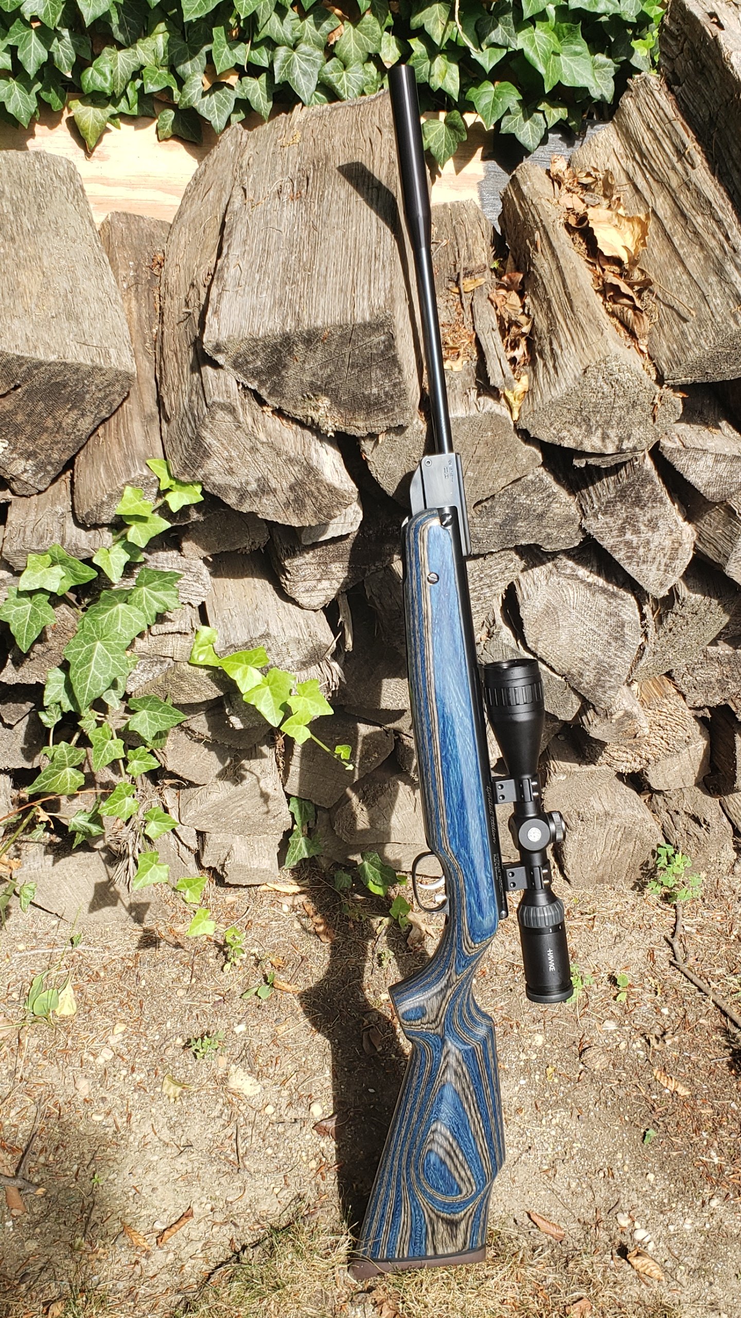

A custom stock now or later, there are a few places that will happily make you one, just be sitting when you see the prices...lol. For wood, Custom Stocks LTD in the UK is one and very well spoken of. There's also a gentleman in the UK that calls himself Daviesbuiltgunstocks who is fairly new but I've seen some of his work on a UK springer forum I belong to. He gets glowing reviews, will make them in wood or laminate and ships to the US.
I have an an aftermarket laminate stock on my HW95 that, should I want to, my R9 will drop straight into. It's a thumbhole which many don't like but I do...lol. Came from Craftsman Vit in the Ukraine. Everything on it was included in the price: adjustable butt pad, adjustable comb, allen wrench to do both with, shipping to the US, plus a custom made stock screw. It's also ambidexterous for the lefties out there although in my case, I had to teach myself to shoot left after doing a bunch of damage to my right shoulder that needed surgery, so I can shoot from either side.
