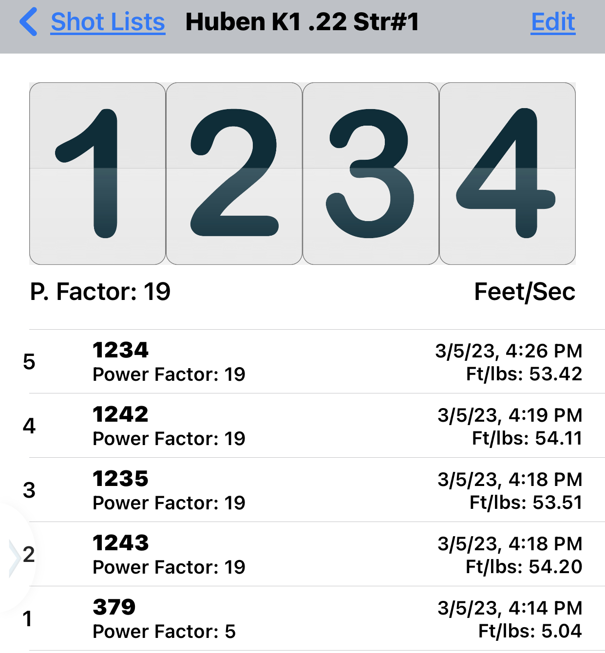

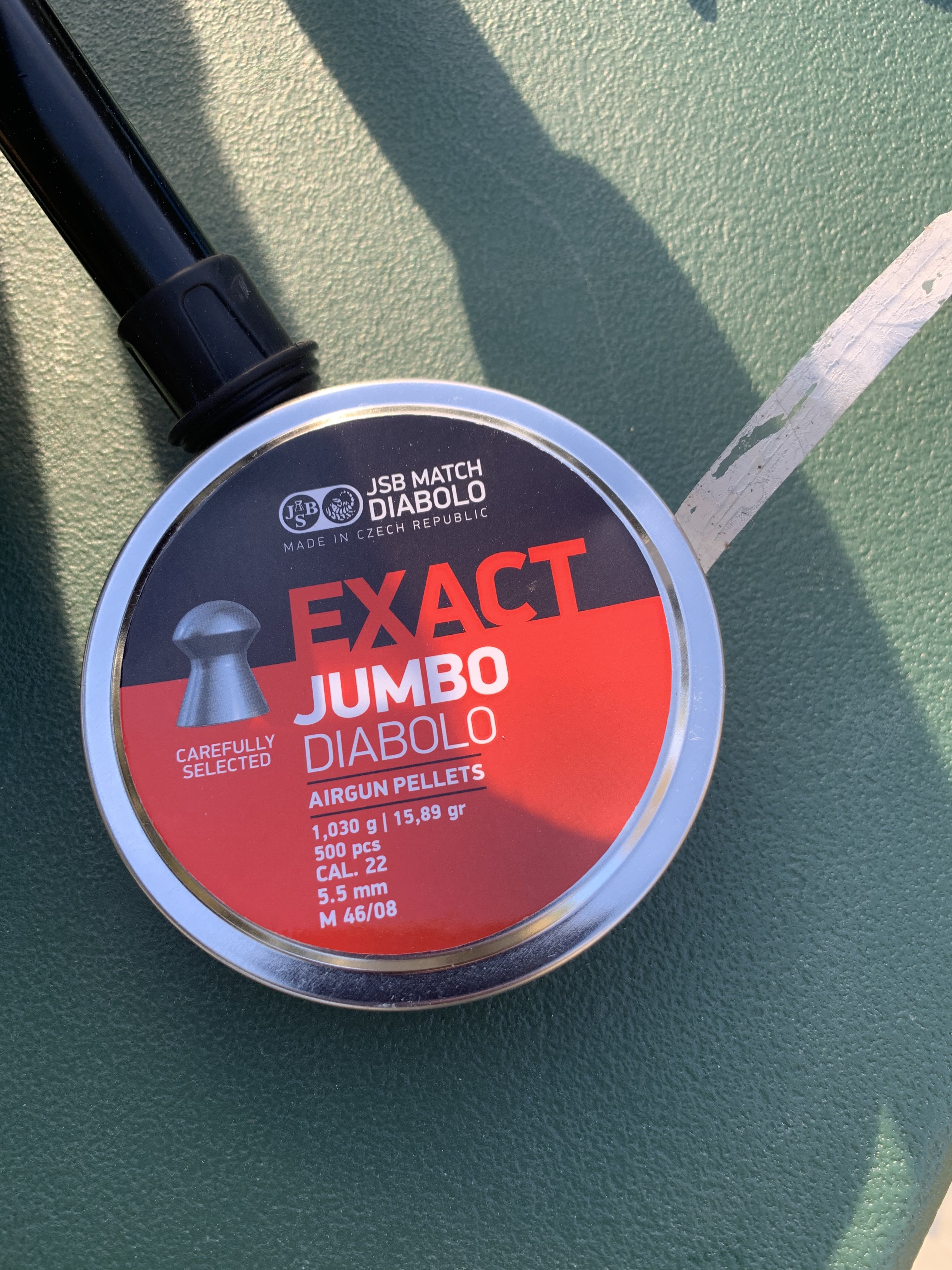

I also got some chronograph readings from the high and low end shooting JSB Jumbo 15.89 grain diabolo pellets.
5 fpe to 54 fpe with pellets!! And people wonder what the allure of airguns is. Look at the versatility here. This is accomplished solely by turning the power wheel. I didn’t touch the regulator setting.
What chrony do you use because I maxed my fx pocket chrony out and it wouldn't read.

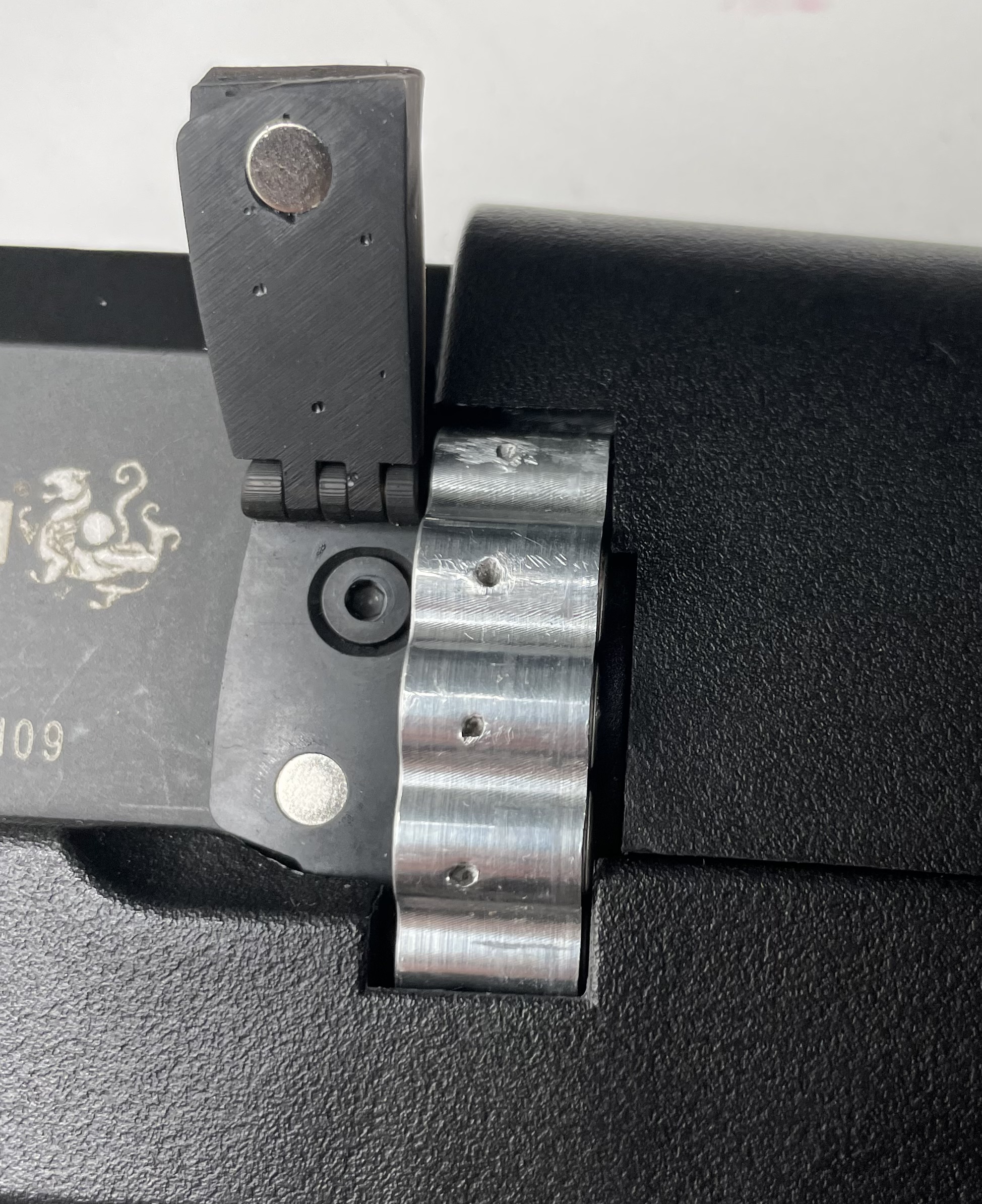

The new loading gate from the eBay seller came in today. Looks better than the other ones. Has a nice flowing curve shape. The tolerance for the gate is very tight. Tight enough where you don’t need magnets but they are included. It’s nice to have the magnets to feel that magnetic snap when you close the gate. Finish is not perfect but is good. Most importantly, the ABS has a good flex to it so it won’t snap like a cracker like the pla/petg 3d printed ones

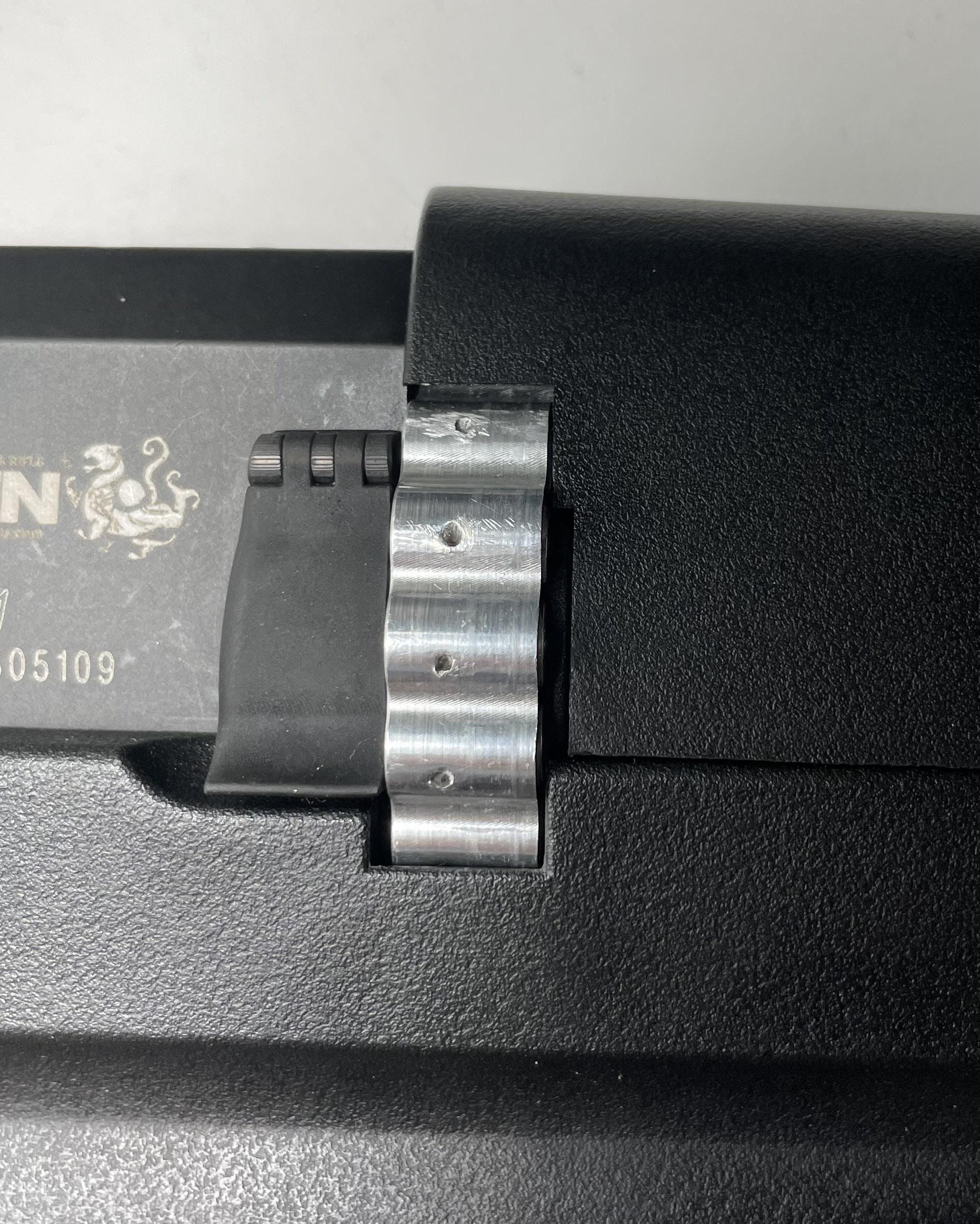

The new loading gate from the eBay seller came in today. Looks better than the other ones. Has a nice flowing curve shape. The tolerance for the gate is very tight. Tight enough where you don’t need magnets but they are included. It’s nice to have the magnets to feel that magnetic snap when you close the gate. Finish is not perfect but is good. Most importantly, the ABS has a good flex to it so it won’t snap like a cracker like the pla/petg 3d printed ones View attachment 339229View attachment 339230
@Legionaire That gate looks like it’s made of quality plastic. The hinges sort of look like 3D printed material. I like the magnet feature. I noticed divots and scratches on the magazine. It looks like someone took a rotary tool to it. What purpose do they serve?
He could’ve 3d printed it then sanded it to make it look like it was made in an injection mold. One things for sure is he used ABS.
The divots were done by Kelly. The chambers in the custom mag were .251 so he took a punch and made the divots so the .250 slugs would fit snug. Not a fan of the look of it on the mag but it works.

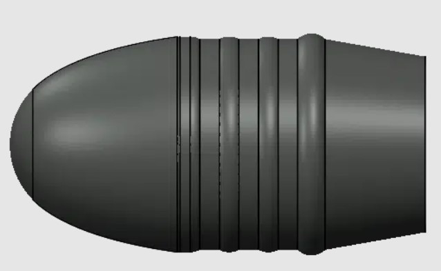

Huben used to sell ammo for it that looks like the one pictured below. I bought a mold from mpmolds but haven't cast any slugs yet to try them out. I know Altaros makes a similar slug but they don't ship to where I live so can't get them. Are you guys shooting slugs or pellets? What is your preferred ammo?
