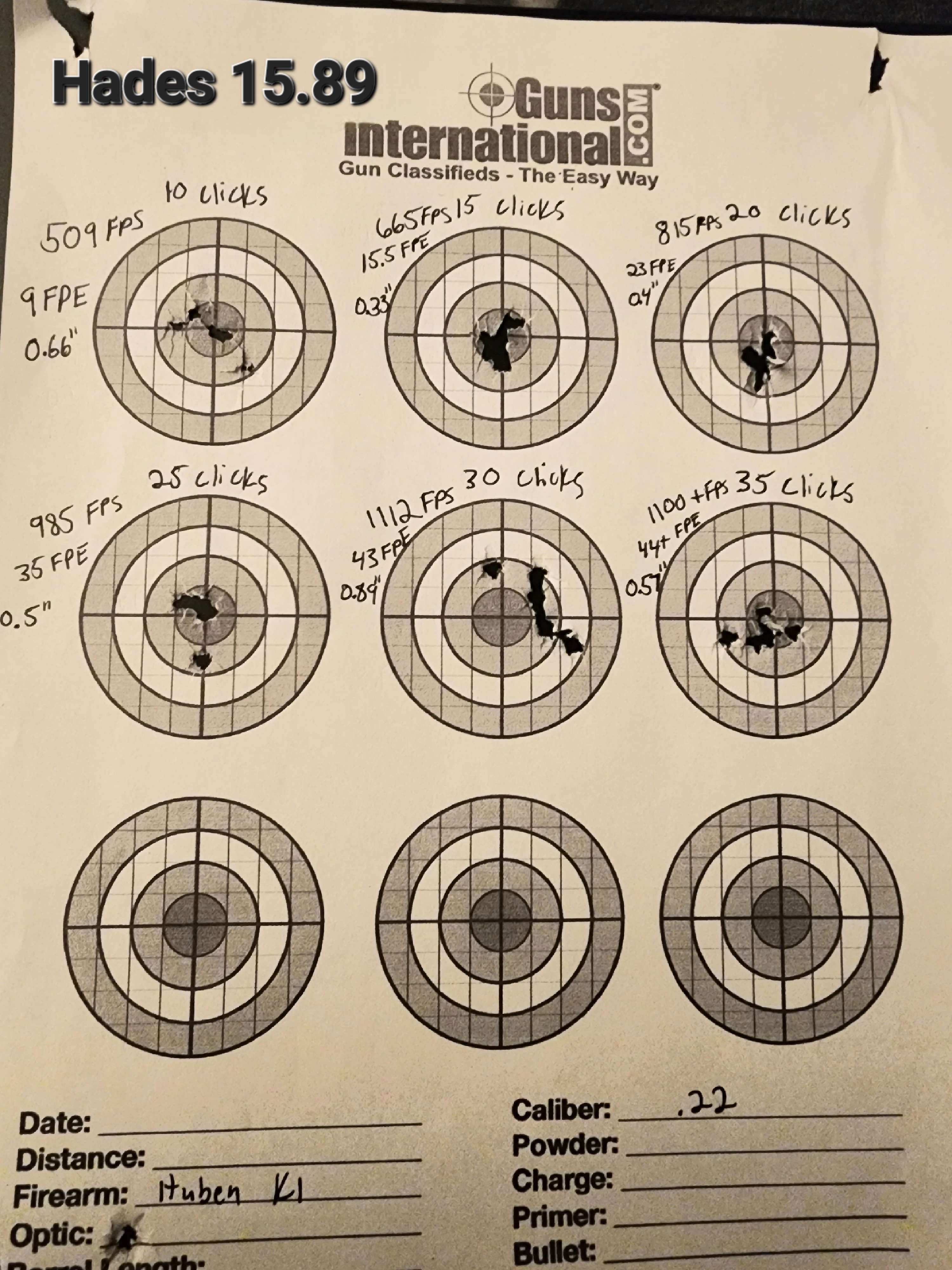

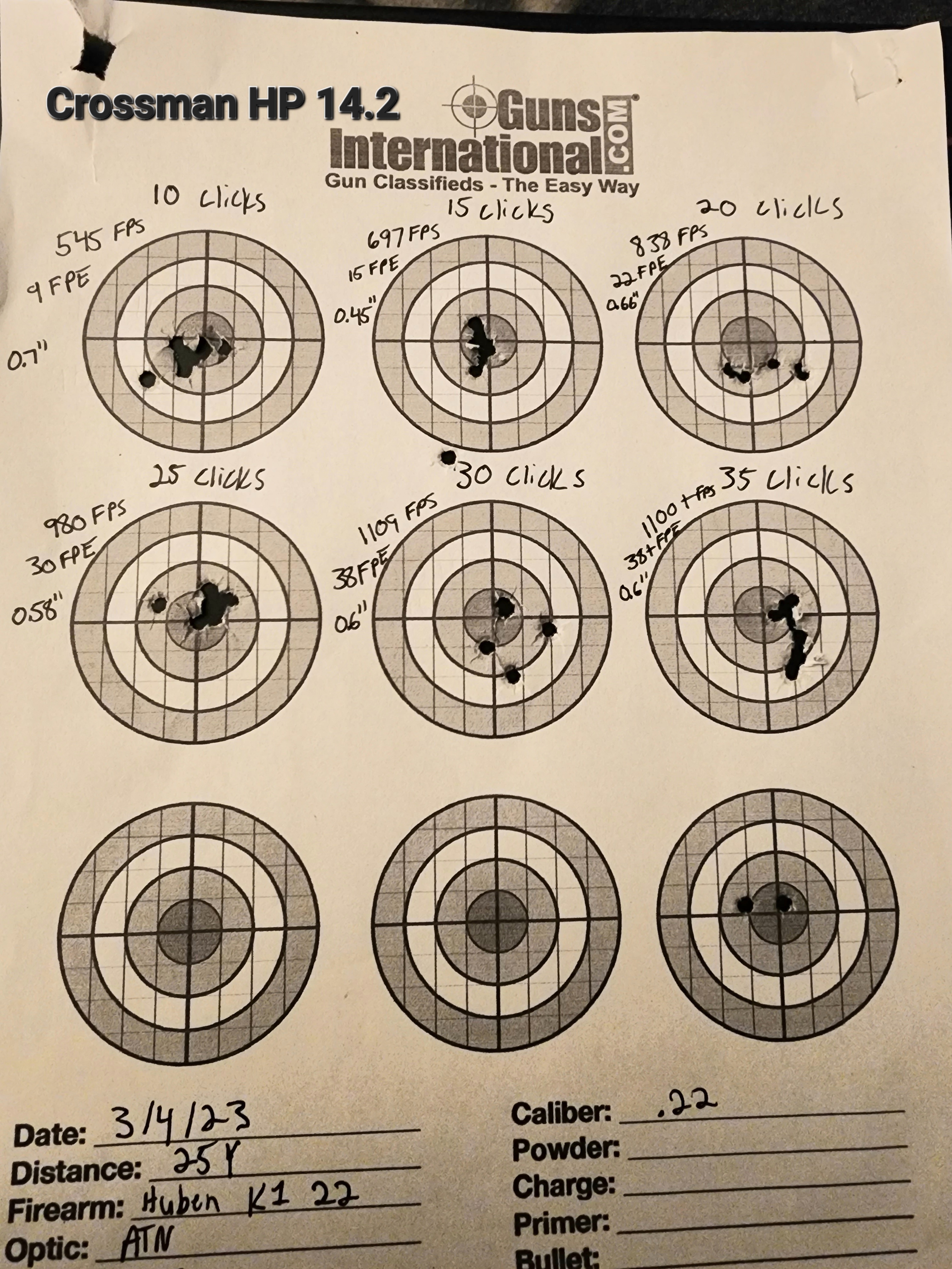

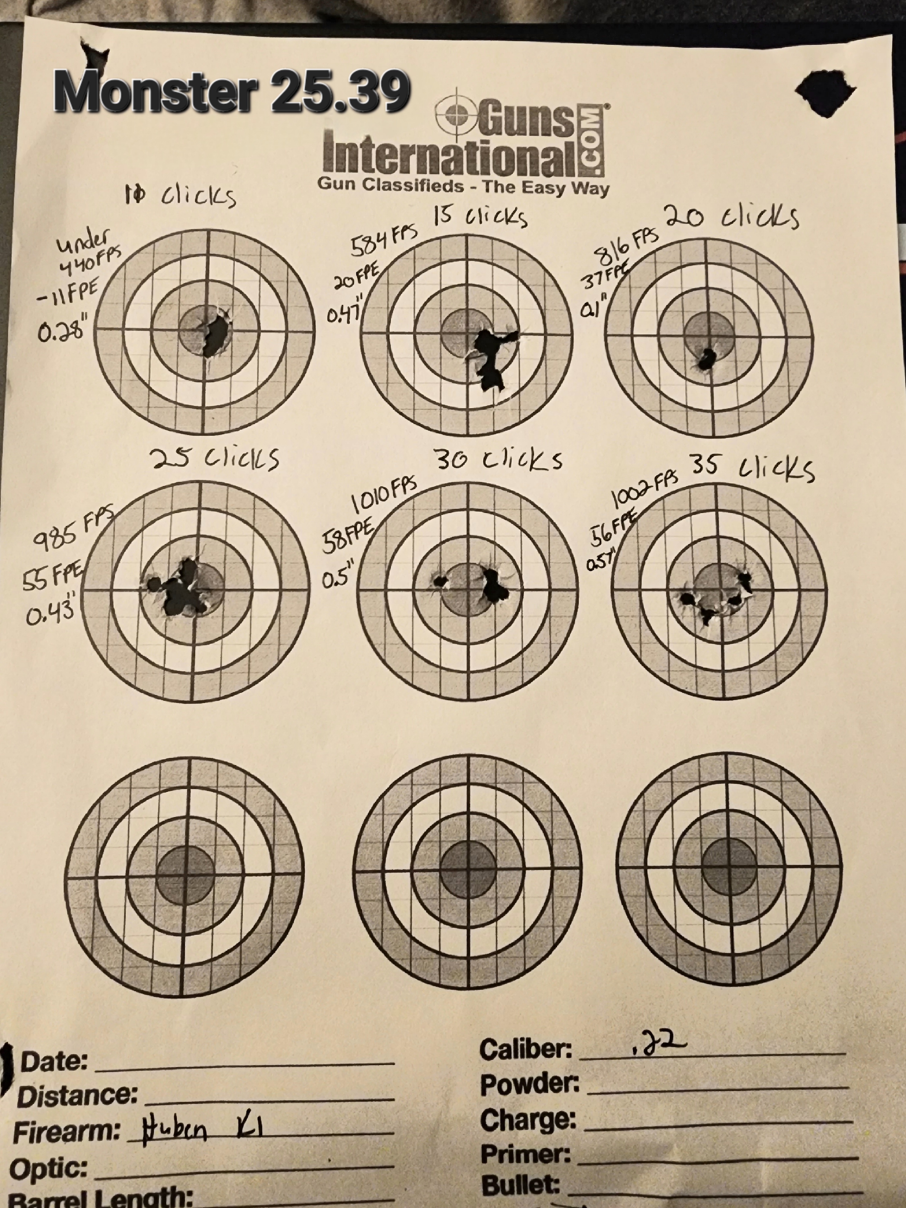

Took the .22 out today for some testing. Now I always use shoot and see targets and while they are fun I find they can show you a flase positive on accuracy. On this test this is just an initial speed/accuracy test at 25y and once I can find the sweet spot for each the monsters showed the best overall but the hades and crossman had some good potential as well as some of the 5 click groups had a large speed increase. Also 30-35 maxed out my fx pocket chrony so the fps isn't correct. This thing has crazy potential shooting a monster at 58fpe is nuts out of a .22 especially since it was just using the wheel. Currently the regulator is set at 14/15mpa. I tried the baracuda hunter extreme but they didnt show much potential.
