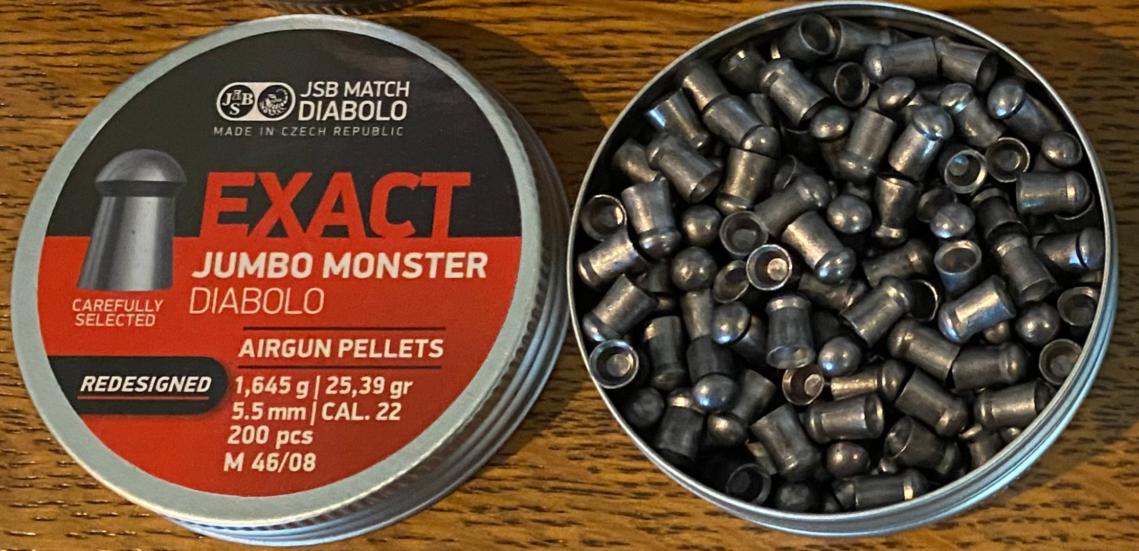

I have some very cool titanium bits on the way for the evol mini to test, then if they test well I will be getting them for my HPS. I did however get .217/.2175 slugs 17.5 to 24.8 grain to test in the hps , hopefully this evening.
None of the nsa slugs 17.5 to 24.8 in .217 or .2175 showed promise.
So the hps stays a pellet rifle shooting 25.39 monster redesigns which I'm not upset about at all

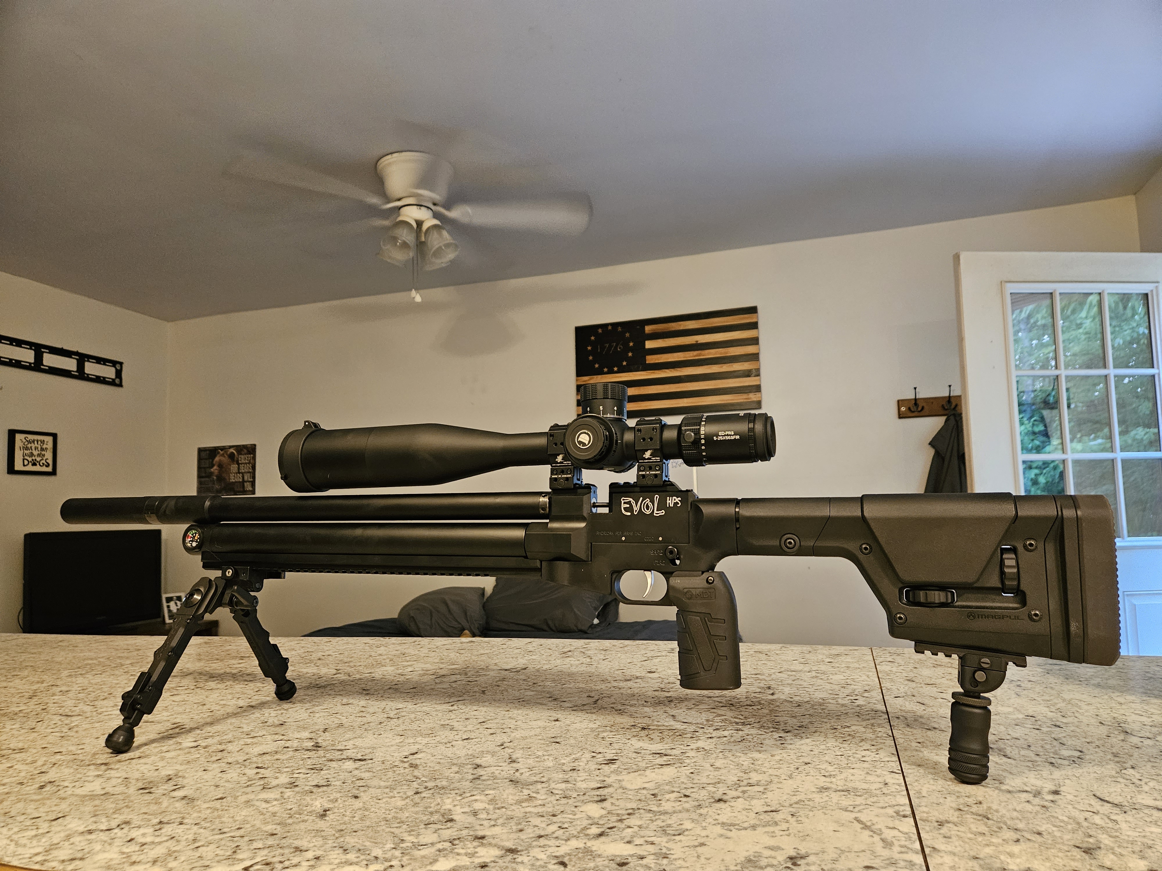

Oh it got a new grip and monopod today

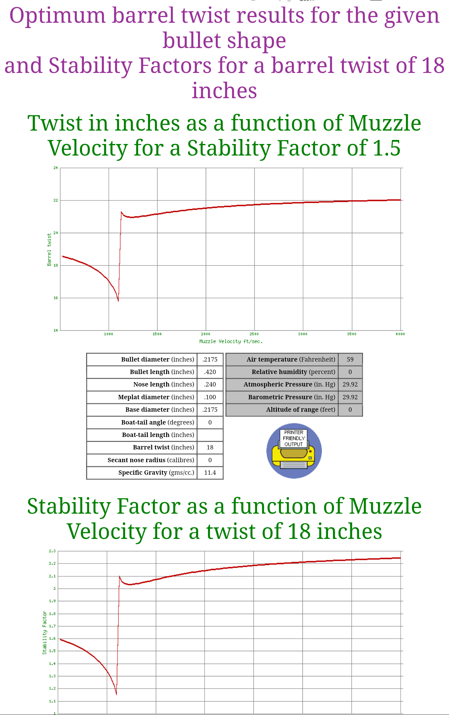

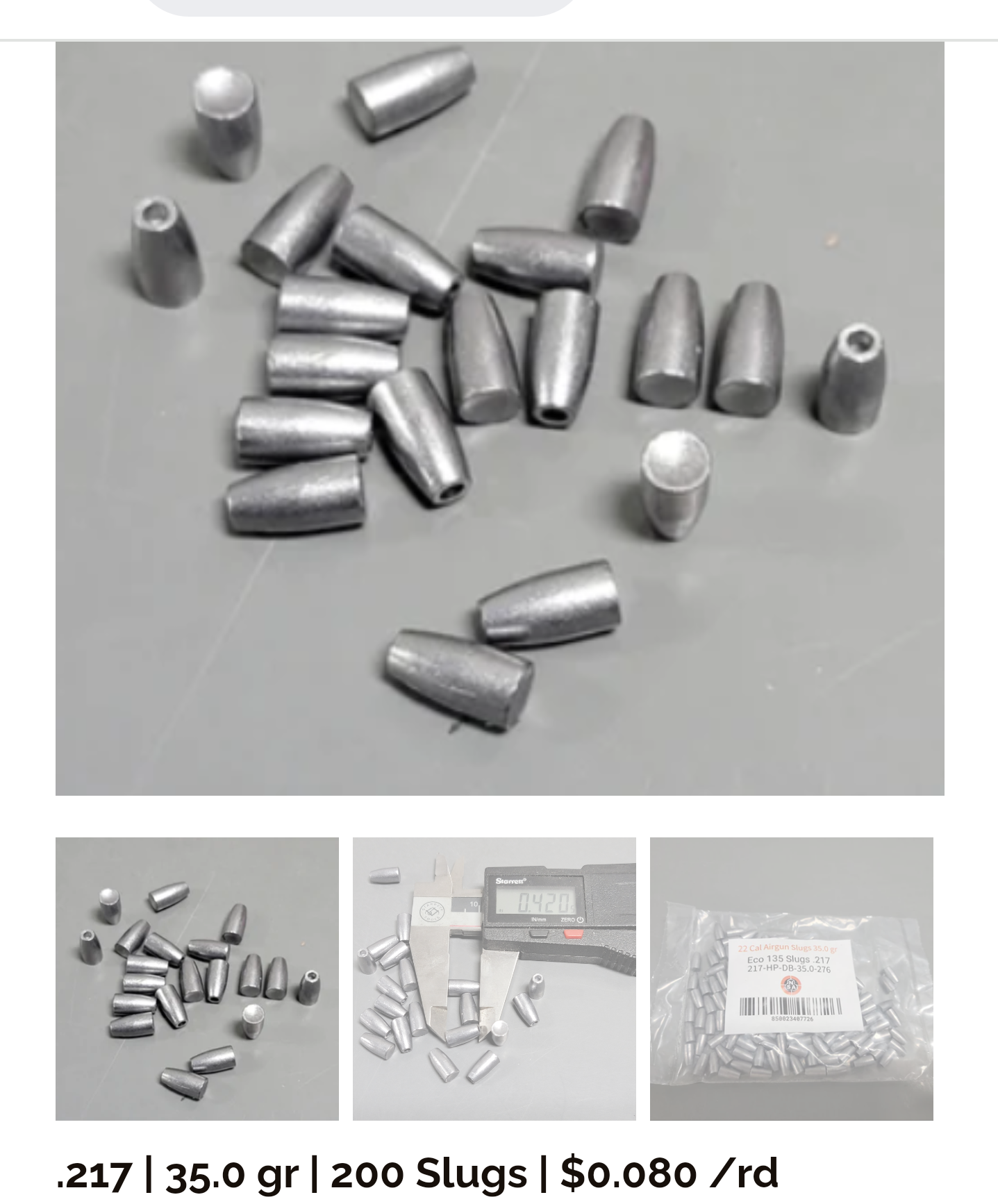

Try the NSA 35 grain slugs. The profile and weight of them with the Evol HPS 18:1 twist barrel should stabilize much better than those short light slugs. They have a long nose as relatively short shank compared to some of the next lighter slugs offered. The JSB MRD's stabilize well because they are long and heavy; just what that twist rate is calling for.
View attachment 360718View attachment 360719View attachment 360720
When I plug all that into the berger ballistics calculator it comes up with marginal stability. I tried from 920 fps to 1020fps and got roughly the same each time. Tom had told me the HPS barrel really liked the old 32 GR NSA ammo but theyve changed that round since and made it more rear heavy which it does not like I guess.
I see that a lot of the heavier NSA slug offerings are rear-heavy with a longer shank and short nose radius. This probably isn't allowing those slugs to remain stabilized over the apogee at longer distances with certain speeds and twist rates. It would be interesting to see if the old style of the 32 grain slug may have been the longer spitzer nose and proportionate short shank design.

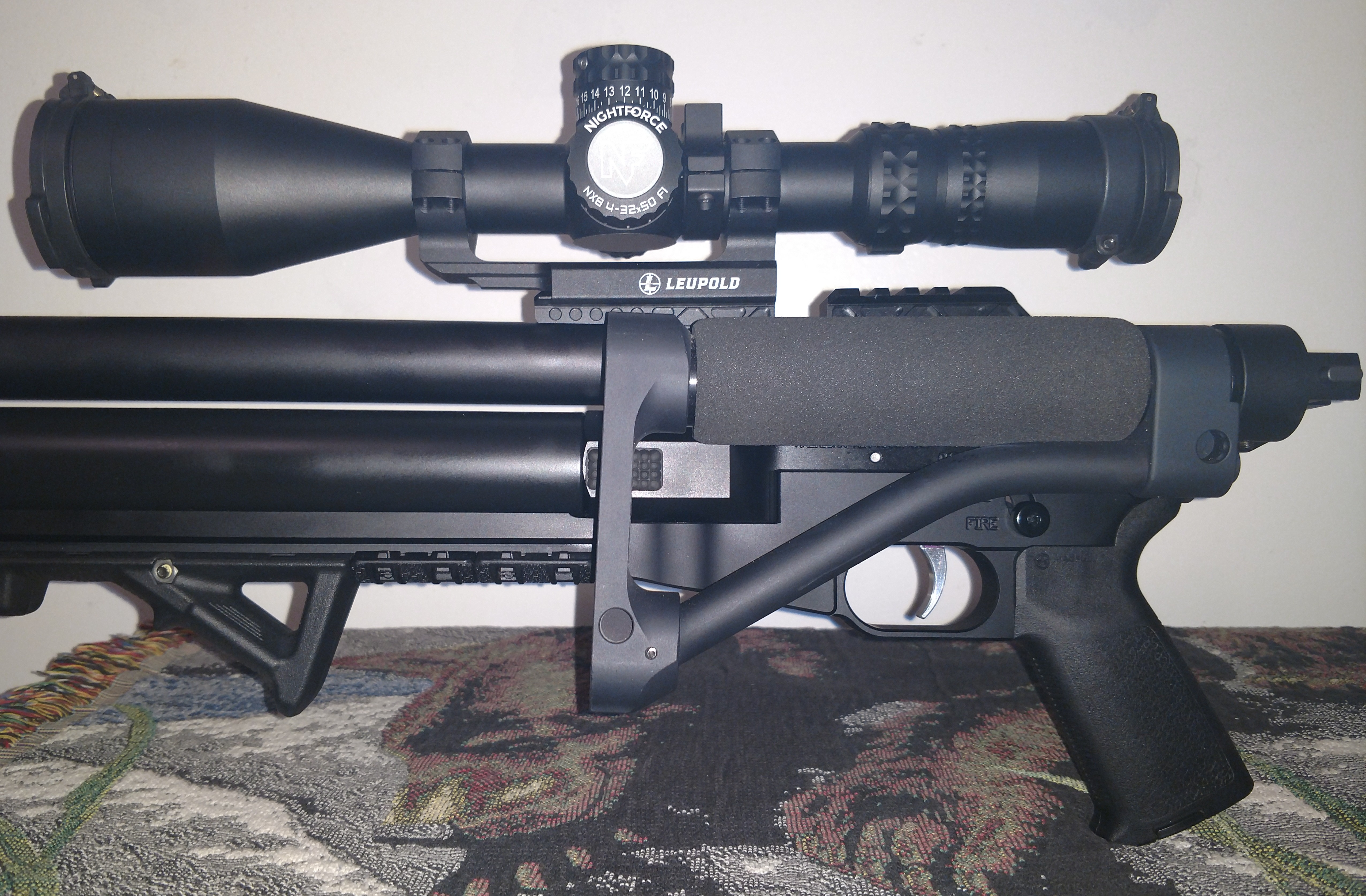

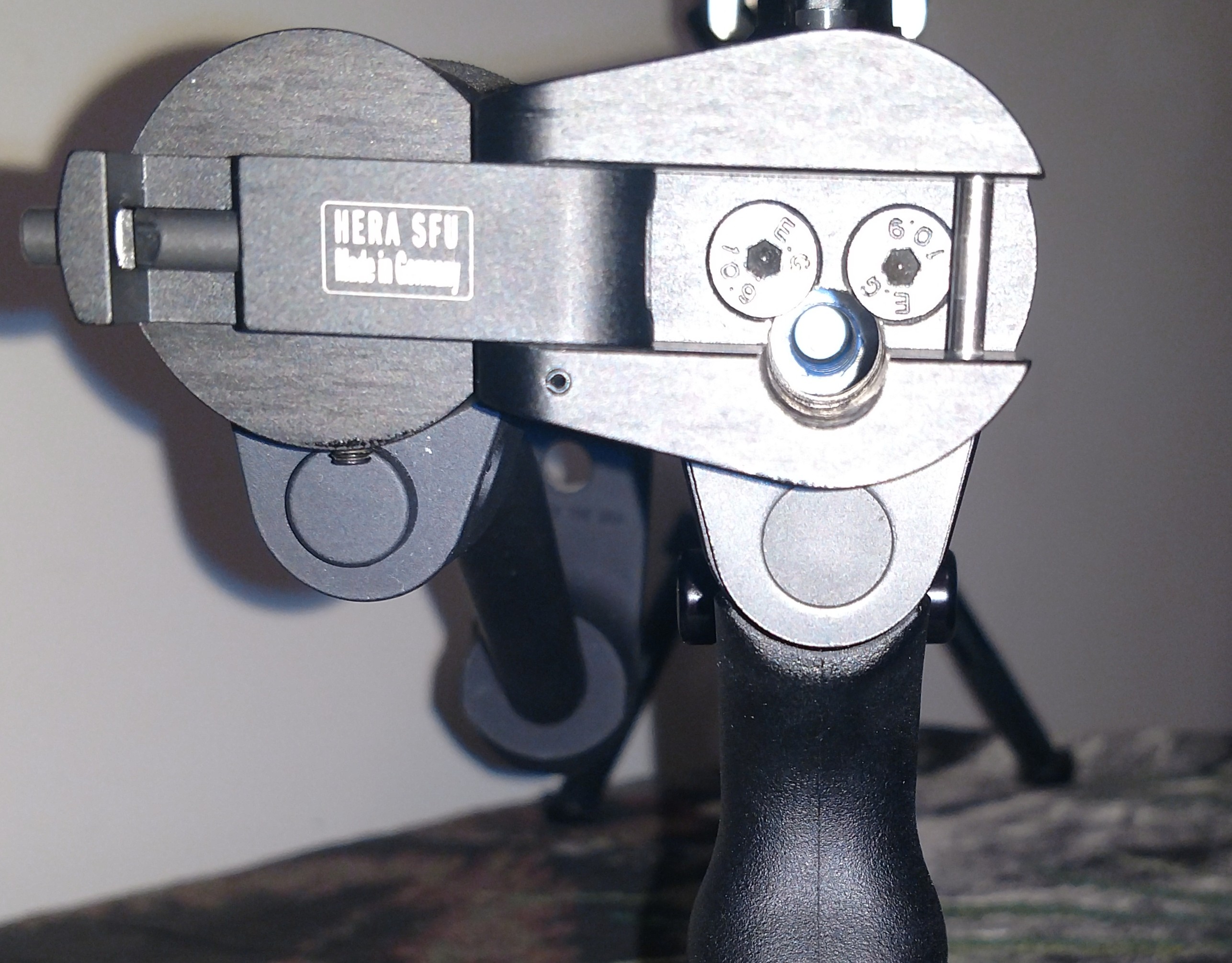

This has been asked of me several times, so for All Things EVOL... Here's the parts that I used to make a folder on my Evol 30: Hera Arms "Side Folding Unit", DoubleStar "ACE 7-1/4" skeleton stock with buffer tube", and a "mil spec AR15 latch plate" with the raised dimple. The plate with the dimple is required to mate the Evol chassis and keep the stock from spinning. To keep the length of pull short, at the common 14" length, any short butt stock around 7-8"" is ideal, whether it is solid or retractable. Most solid AR stocks are longer than this.
To ease tuning, I drilled out the center of the SFU parts to get to the hammer spring adjustment. There's other folding units that are hollow and may allow the 5/16" hex wrench to fit into there with some additional modifications. All folder's are said to rattle some, but this one is pretty tight and I did place a piece of rubber on the frame to avoid marring it up when folded.

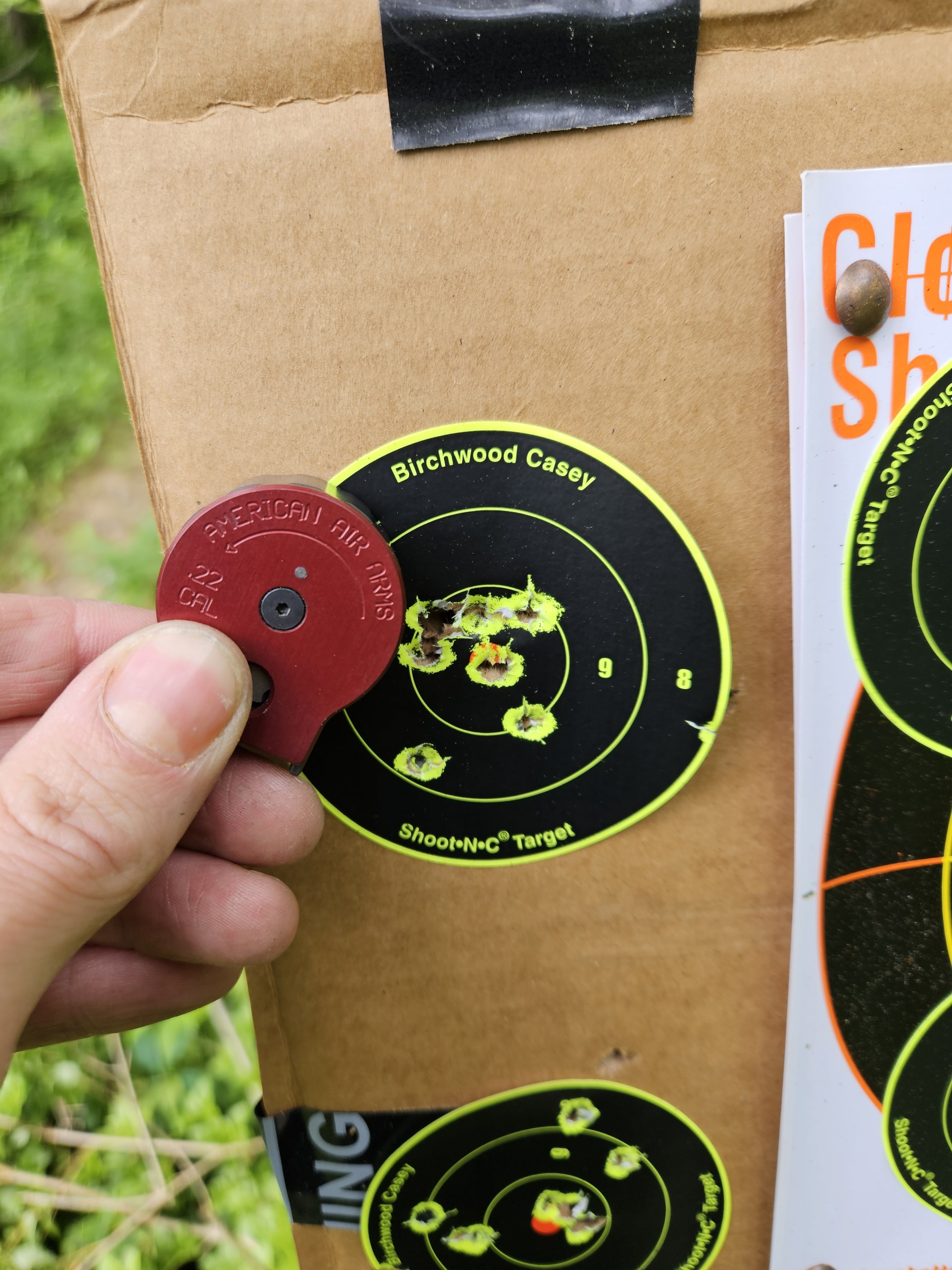

Well, it was kind of a bland, weird, odd weekend.

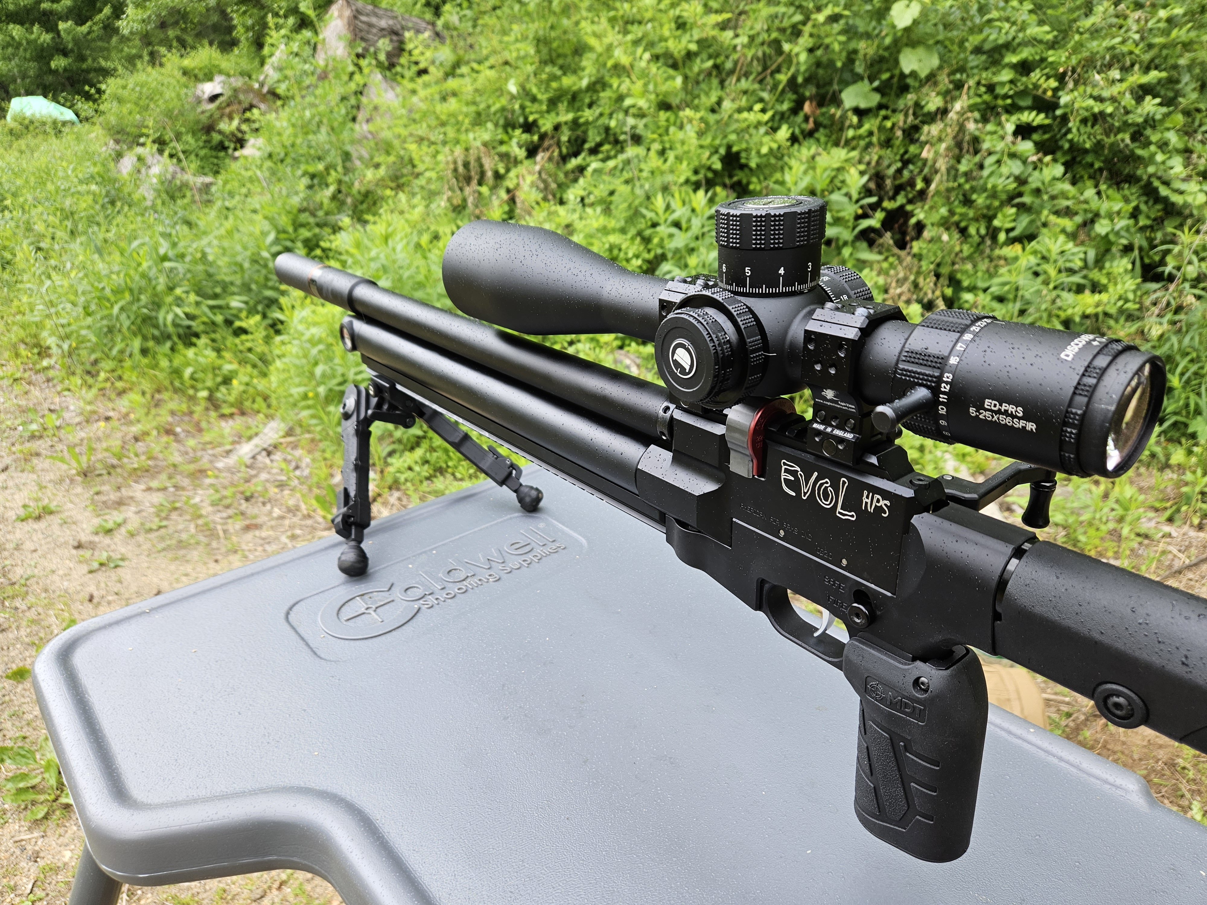

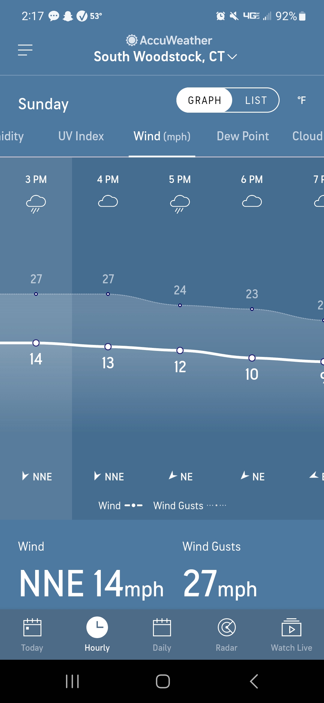

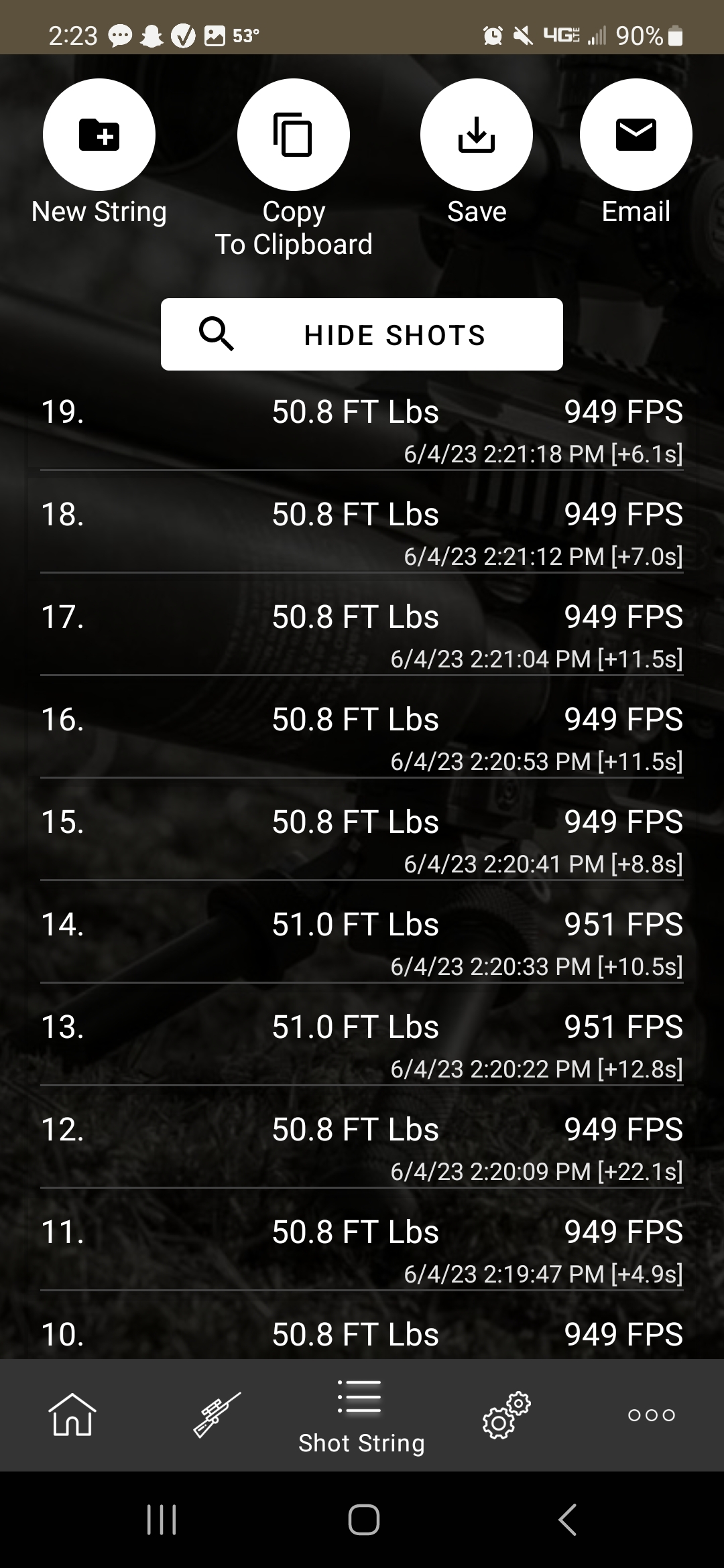

Decided to take the reg down 150 psi on the evol hps. As soon as I set up, it started drizzling, then the wind picked up. It's VERY windy today as you can see, constant 13ish mph with gusts up over 20 mph.
I shot some ok groupings for winds like this, all of a sudden I'm going to pack up.
I say one more mag kev, one more.
Slap the mag in. The wind died. 😍.

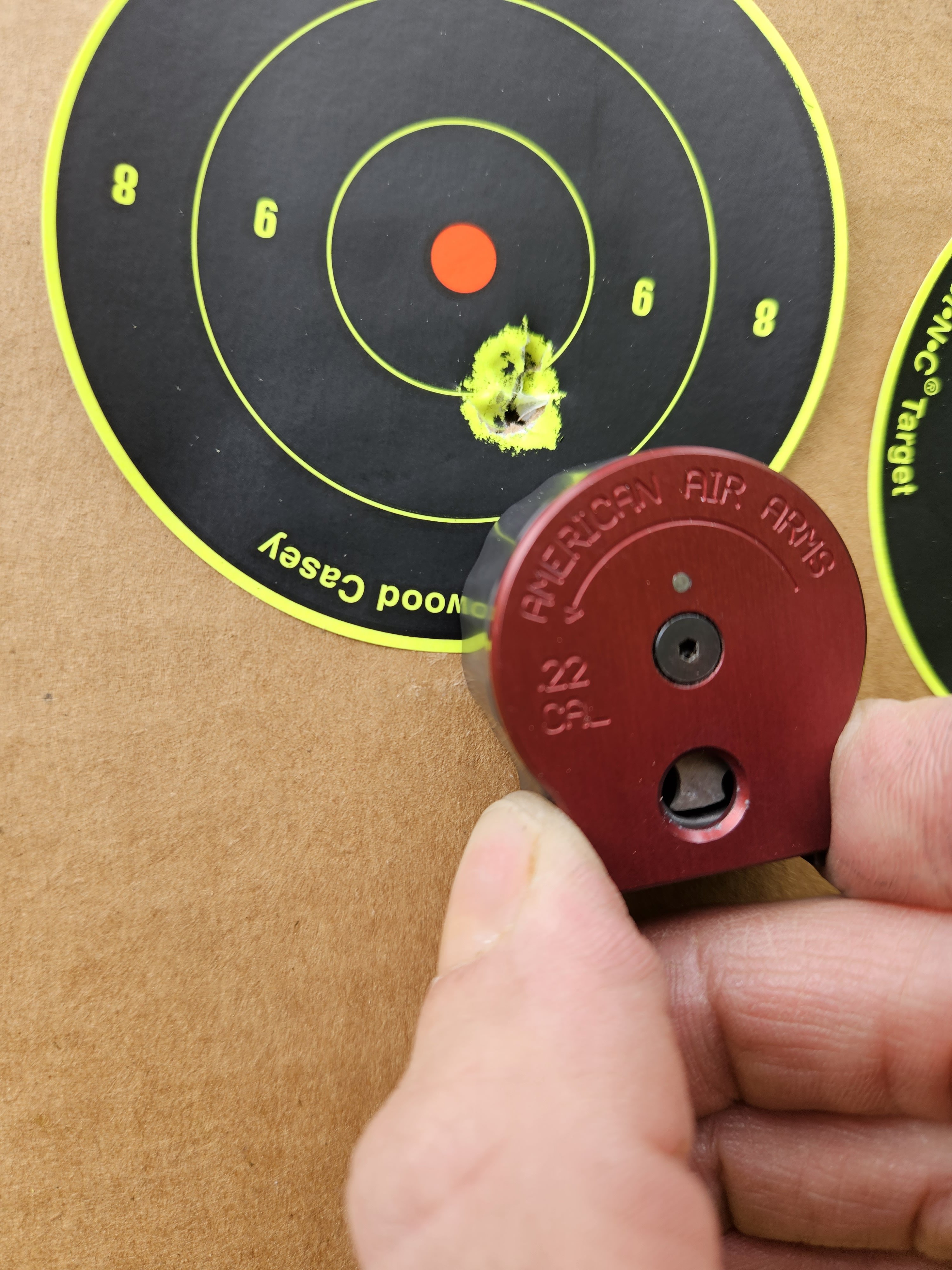

I shot 6 shots the first three I questioned if they were off paper, almost made a scope adjustment, said nah, let's shoot again, boom I saw the hole expand.
With that said I got to 6 shots and called it. Never in my life have I shot a group like that, I did not want to ruin it so I 🍒 p icked it.
Oh. This was at 100 yards.

I'll take it off your hands. it must be shooting very bad to only have 2 pellets out of 6 hit target. Im sure you cant wait to get rid of it so ill sacrifice for you.
