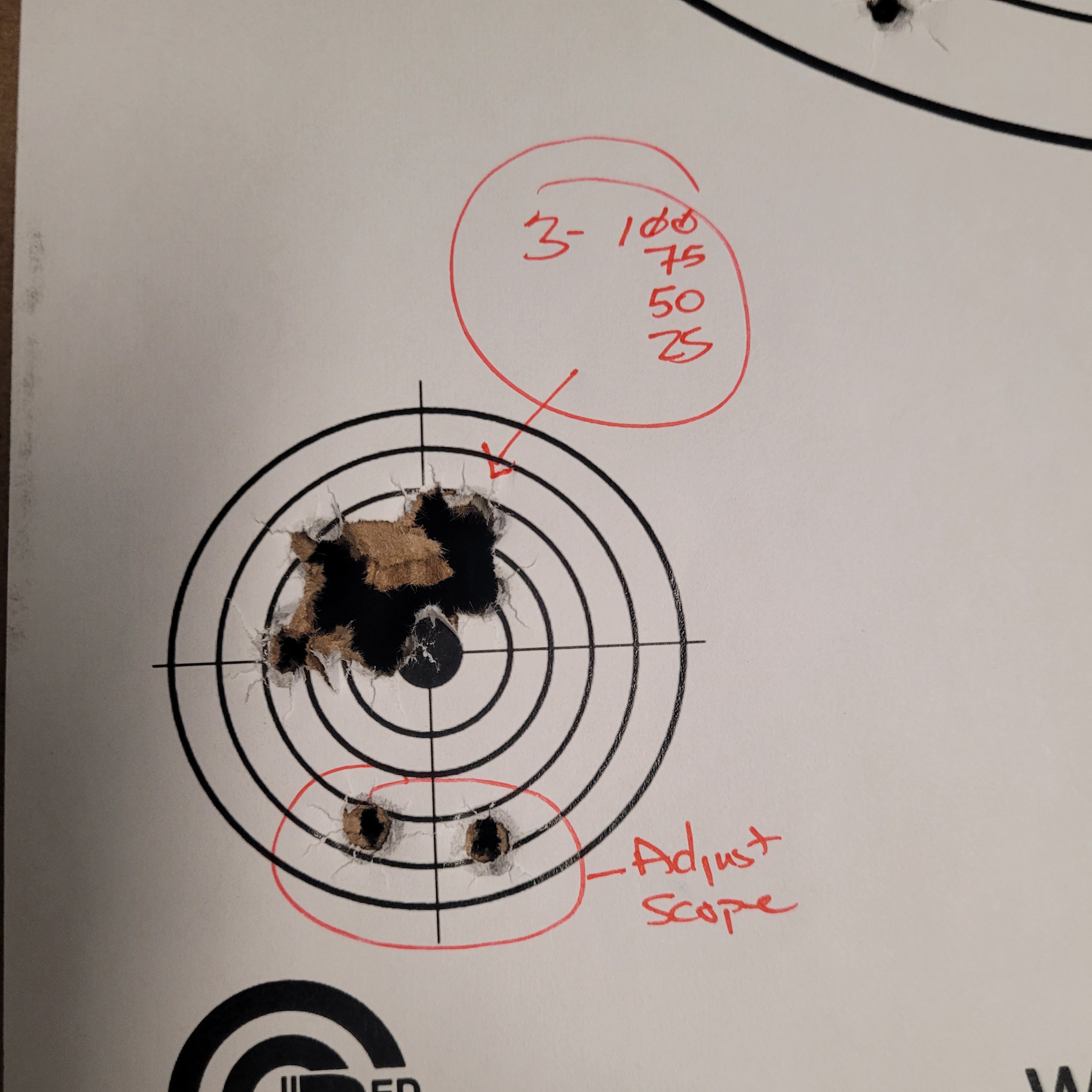

I just installed the medium sized plenum in my .30 Evol. I was trying to get 56 Zans and 68 grain NOE slugs shooting faster. I wanted the Zans around 900-920. They shoot VERY WELL at this velocity in my Skout epoch. I found I couldn’t get the Evol with its shorter barrel to do this semi economical. I have them at 875 average with 6fps ES and 2fps SD. Now I’m dealing with an extremely SLOW leak. I got all new O-rings from the O-ring store so I’m getting it done. It really likes the slugs cast from the NOE mould but it was at 700 FPS with the 68 grain slugs, this was prior to my install of the plenum. My reg setting is at 2300 PSI and I had to turn the hs in 2 turns. I got the gun used. It was shooting 44 grain hades at 880 at 2000 PSI reg setting and the slugs at 700 FPS. FWIW I have looked down the bores of lots of high end rifles, PB and AIR, the barrel of the AAA is like a mirror! It just goes to show why these are so inherently accurate and kudos to Tom and his crew out there!
Reactions: Airgun-hobbyist
Depending on the barrel leade you may not be able to get slugs to shoot well. I was talking to Tom and he mentioned that the leade is different on the barrels for slugs and pellets. He is coming out with a slug barrel as well, hoping to be within a month or so.
I guess I got lucky, so far at least. They shot extremely well at 700fps. Like all in the same hole at 60 yards. I sized them exactly .300 and were cast from pure lead and lightly lubed with balistol. I have to cast more and get time out on the range.
A slug barrel would be neat to try. The Skout didn’t like this slug, so I tried I’d in the Evol that day and for a second I thought it was bad, like only 1 of the first 3 shots hit the target, I walked down and they were a tight clover. More testing and more casting or vise versa, lol! Hopefully it will shoot good now I bumped it up a little.
Here’s the group 5 shots. I was aiming at the orange dot where I was shooting the GK1 .22 earlier.
I just got the medium plenum installed and replaced all the O-rings except inside the regulator. Adjusted the hammer spring and bumped up the pressure to 2300. Currently run 56 grain zans BR pellets at 877 average of 8 shots with extreme spread of 6fps standard deviation of 2fps. These pellets like to fly fast but I can’t get more out of the short barrel and have any sort of economy.
My Skout epoch has the long barrel so it’s like twice as long so I get a tad more velocity.
