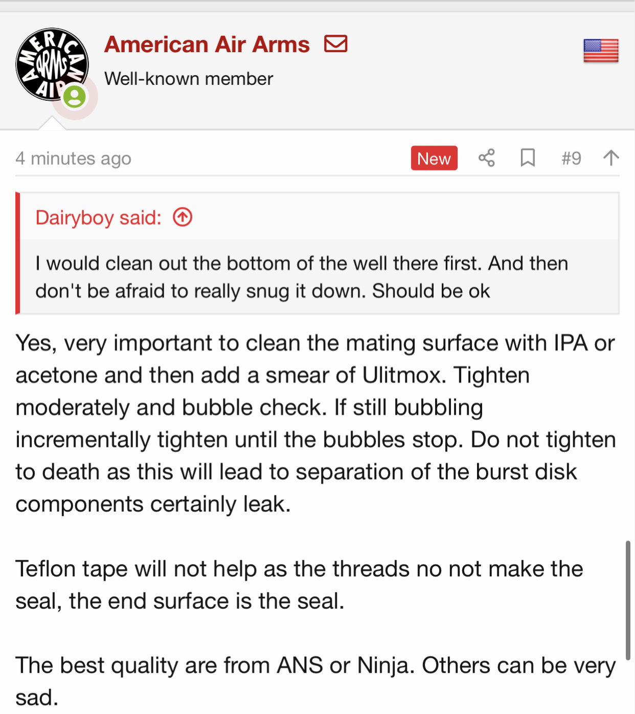

My EVOL doesn’t have a burst disc thank god.
Yes it does. They all do. It’s just under the stock instead of on the side.
Also, the burst disc seal doesn’t squash. It’s solid brass, and not only seals to the bottom of the well, but also seals against the burst disc behind it. That picture looks just fine.

Given the multitude of answers you are getting to fix the leaking problem, no doubt it can be. Keep in mind, what might look ok by one's standards may not be ok by another's. You decide what you want to do with the advice given based on your standards and skills.
Myself, before jamming that new and different style of burst disk into that hole and possibly making a different perminant groove in the aluminum (because the parts are obviously of different angles and sealing surfaces), I'd try fixing the issue of what started making it leak. Correcting the condition of bottom of that hole and also the original burst disk sealing surfaces should fix the issue, providing that the disks themselves aren't what's leaking. Also, it may save a bigger headache by simply buying the original off-the-shelf burst disk set-up instead of installing a generic one (that didn't seal when first installed).
The original should work with a little care taken. There's a whole bunch of us who have loosened and tightened them multiple times and not had an issue once cleaned and reinstalled.

@Airgun-hobbyist I would liked to have bought a replacement of the original because of they’re black like the gun and they’re what was already being used. I have no idea where to get them or who makes them.
Call Airguns of Arizona 480-461-1113 tomorrow morning and see if they are able to send you a replacement. They are really good folks there and also sell and work on the AAA Evol's when needed.
