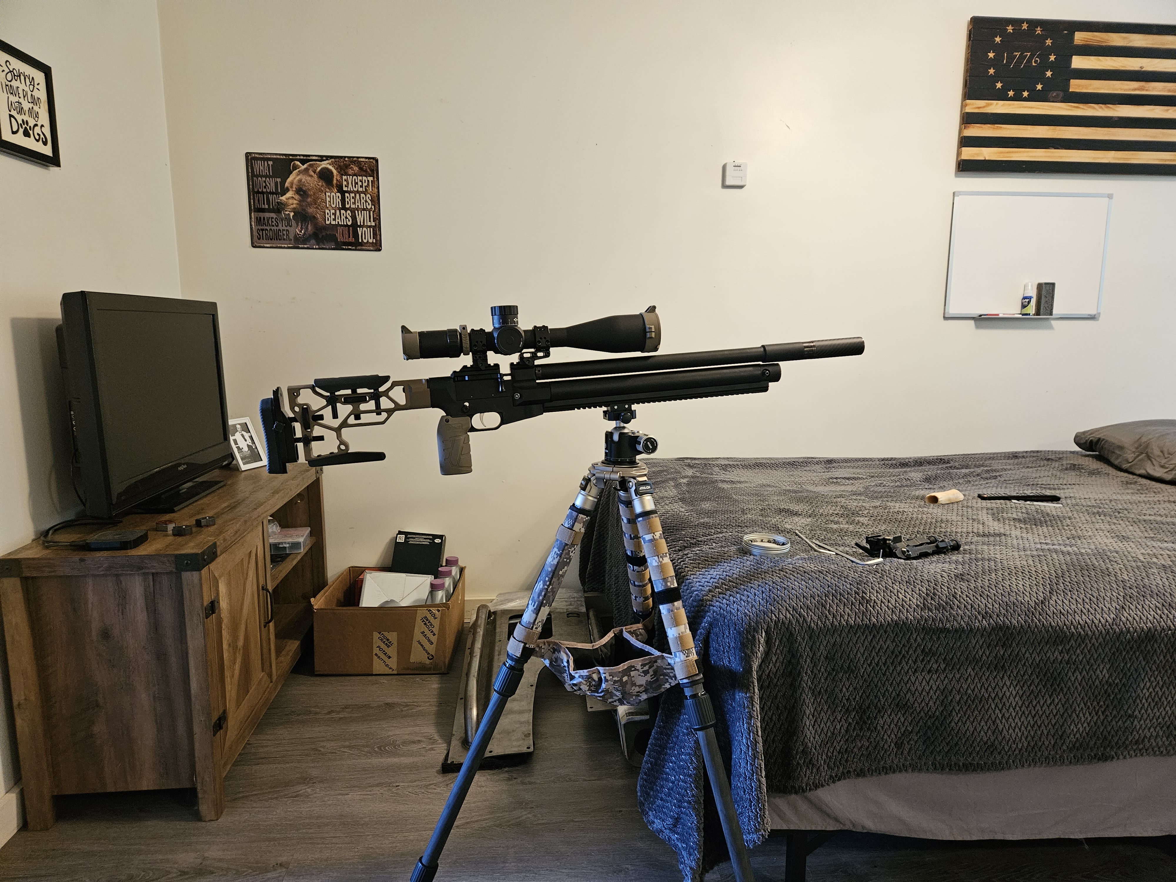

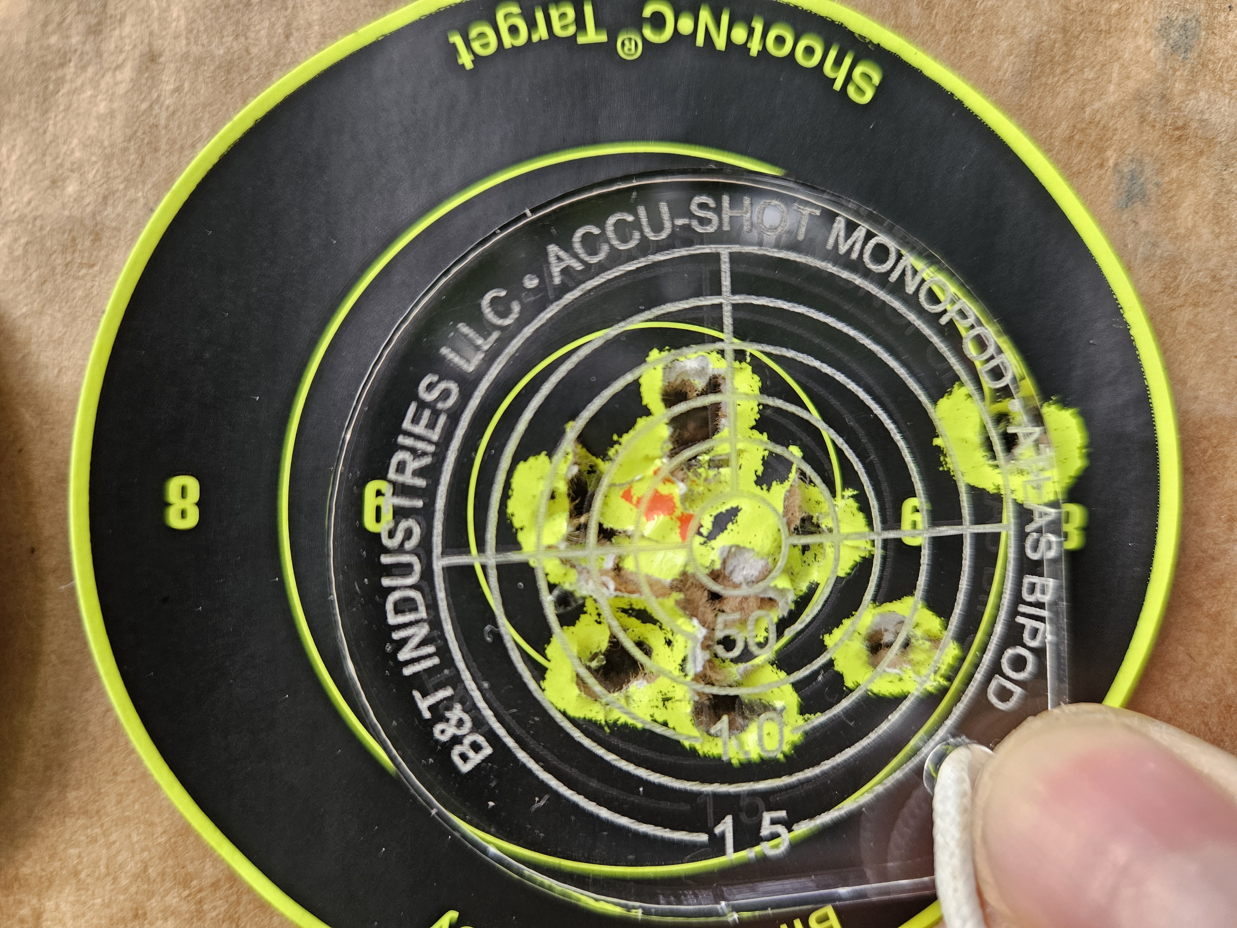

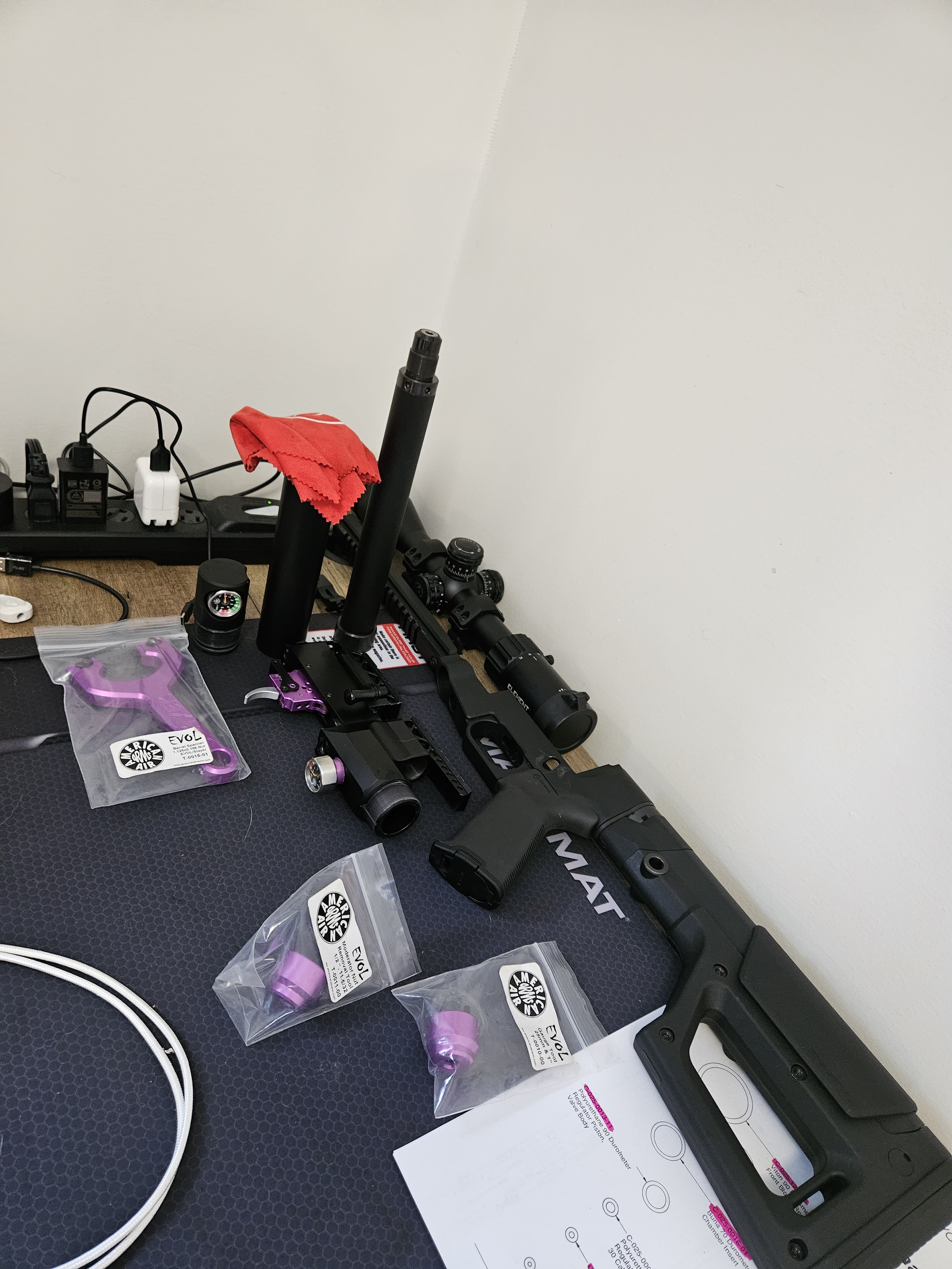

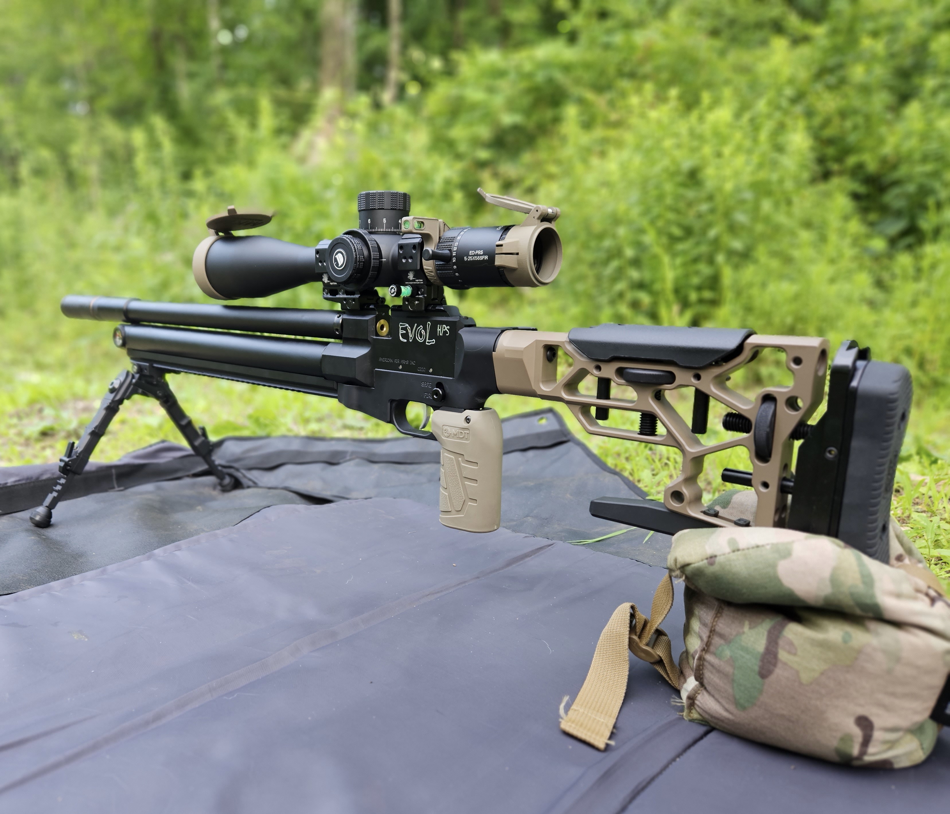

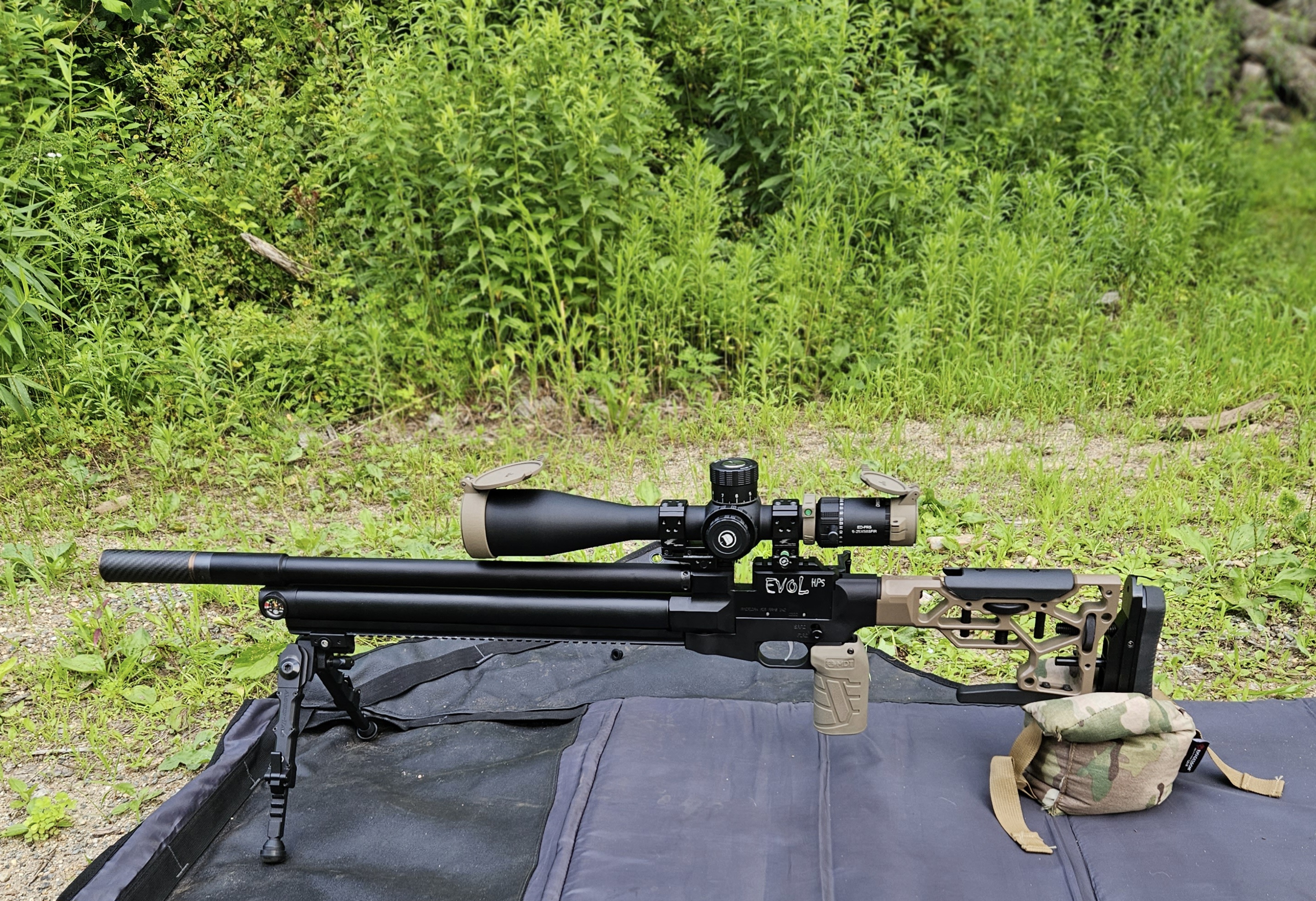

The HPS got its new stock today.
The MDT SRS short, perfect size for me, shoulders well, full adjustable and lighter than the PRS stock.

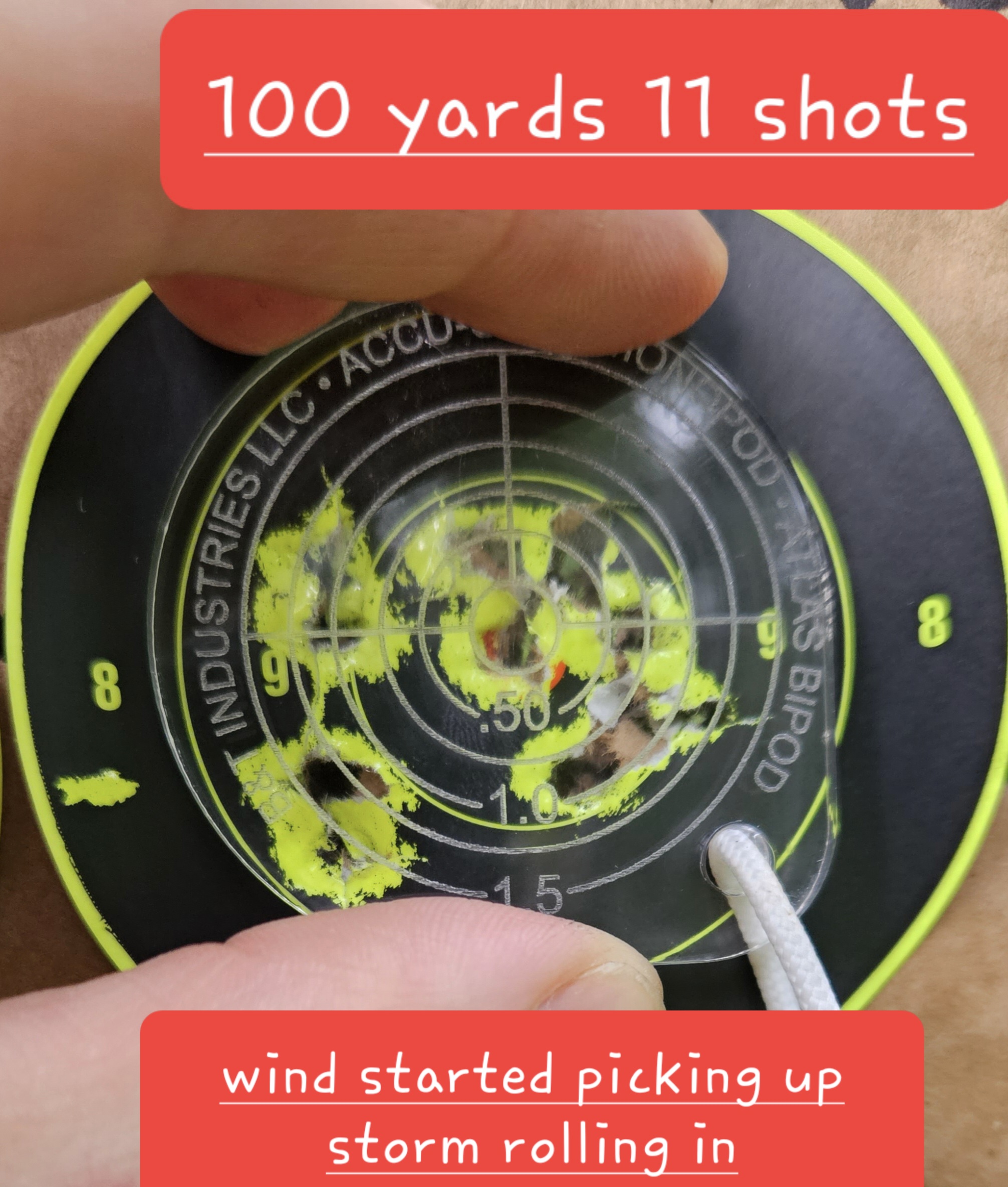

NOW onto bad news, you all warned me of the MRD woes, well I finally tore into my second tin and holy crap inconsistent should be their name, not monster redesigns. I was able to print 1 group that I'm discounting that flier due to the jsb monster inconsistent pellets...
Tempted to try a tin of JTS 25.4 version of the redesigns as I've heard they're without the fliers. Or detune to 18.13
That is 1 magazine 11 shots at 100 yards

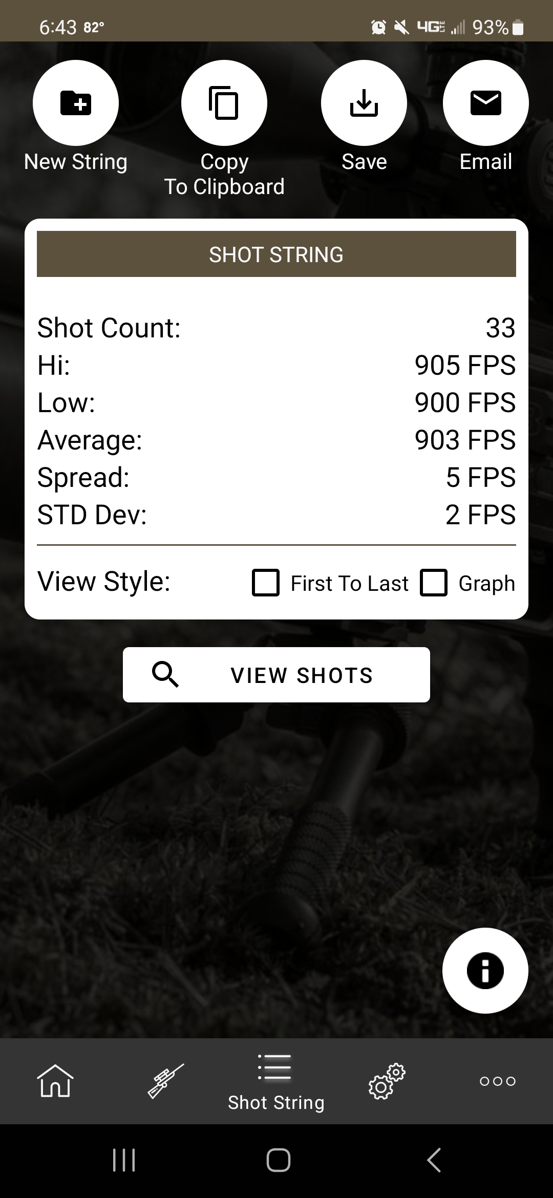

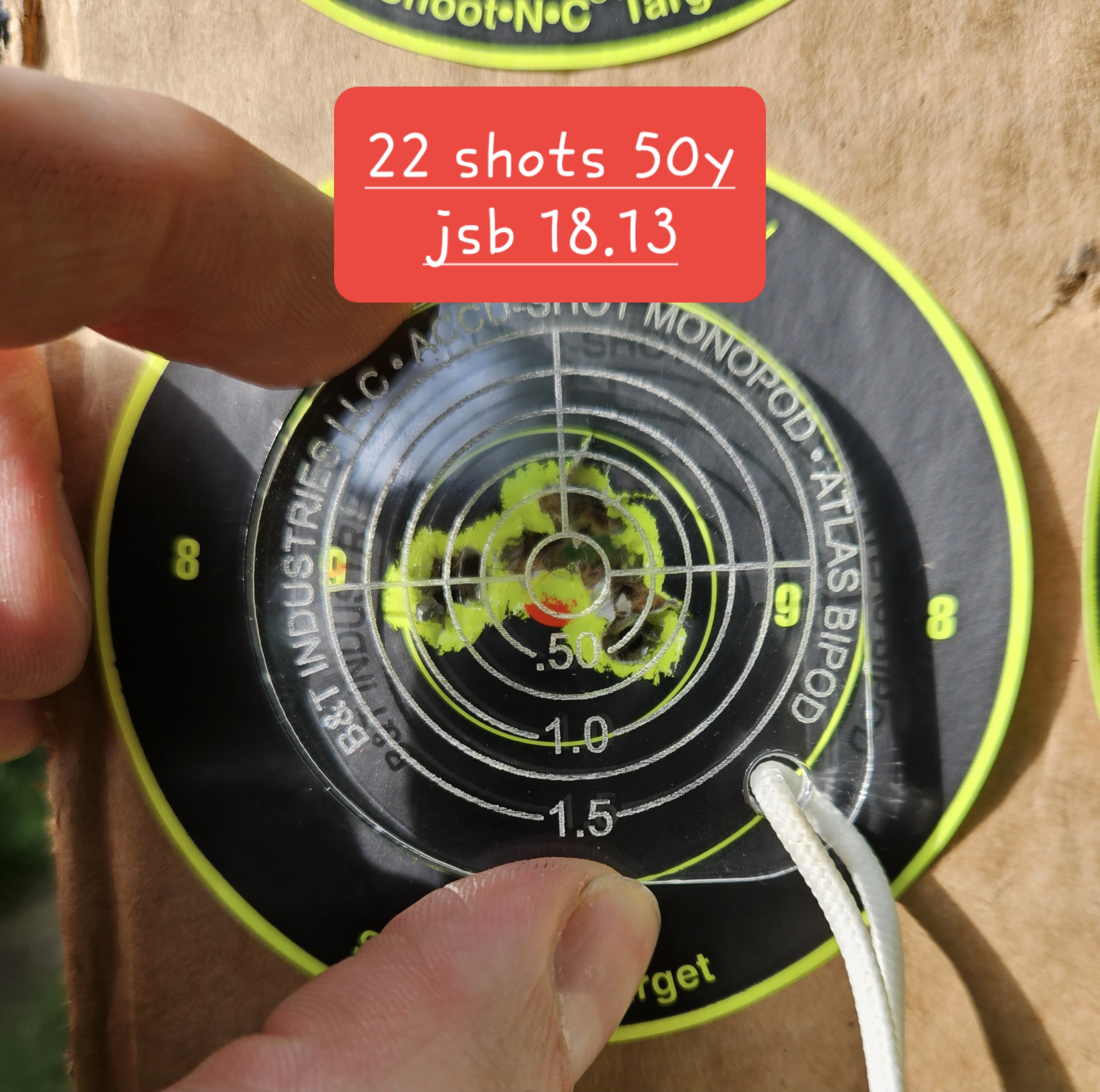

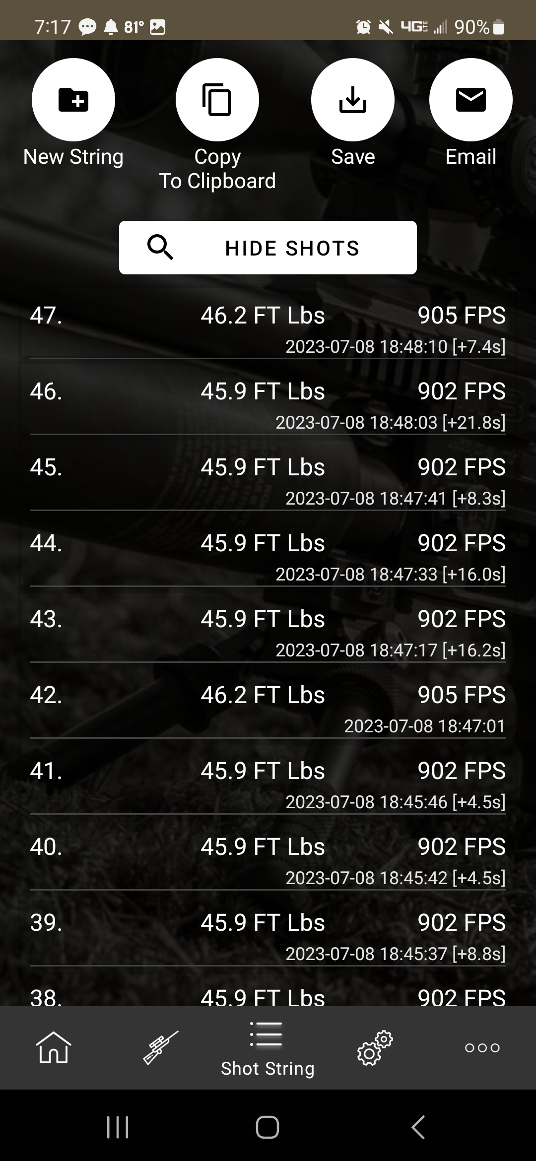

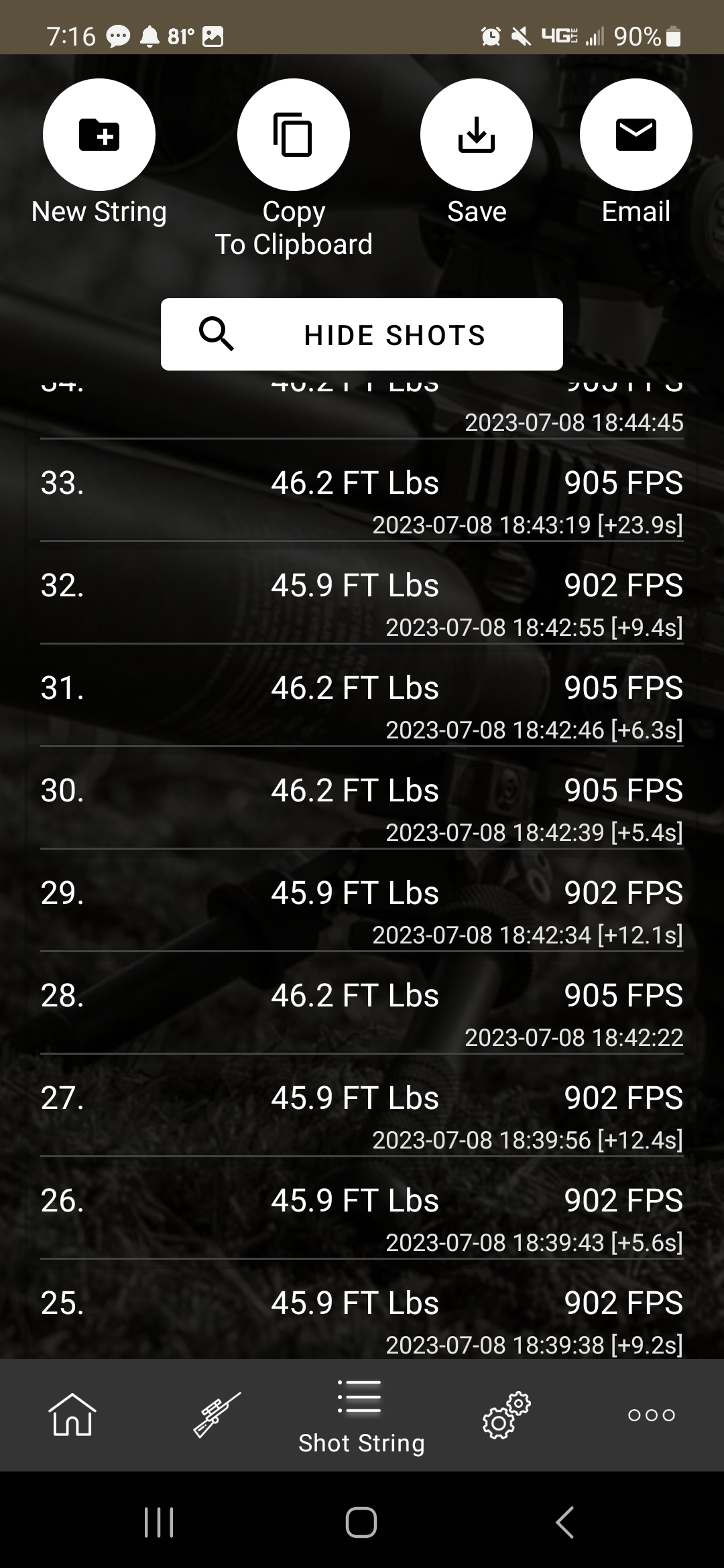

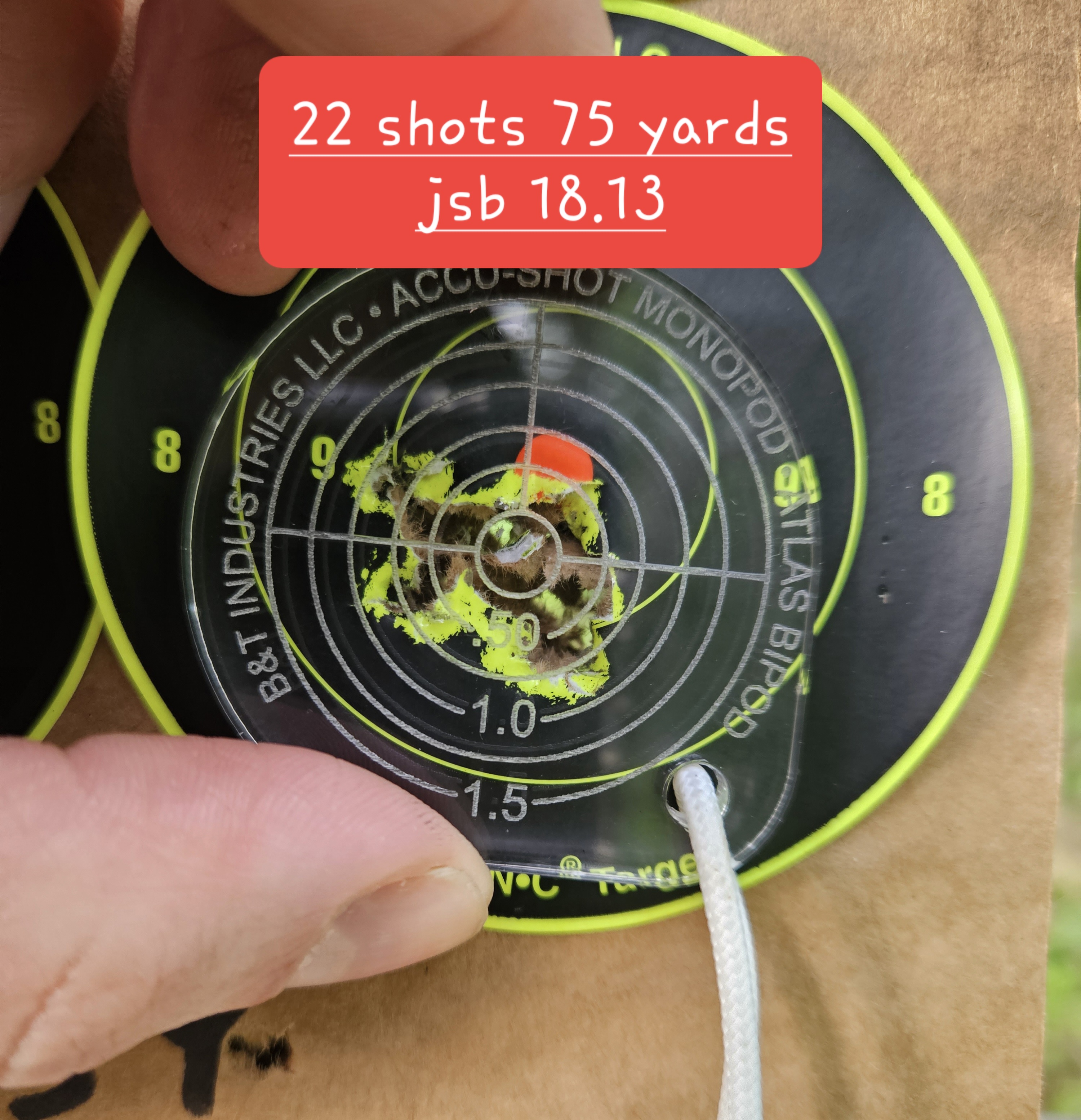

18.13 JSB tune.
The monster redesigns have too many inconsistencies so I broke the HPS down today and had a blast learning the rifle and tuning it.
There is NO EASIER rifle to work on, I thought I could not be in any more awe of @americanairarmsofficial products but here I am, more awed than yesterday.
Anyways , very pleased with the 18 grainers and still doing some fine tuning on scope placement / stock adjustments.
I'd say there's 22 dead animals at 75 yards all day

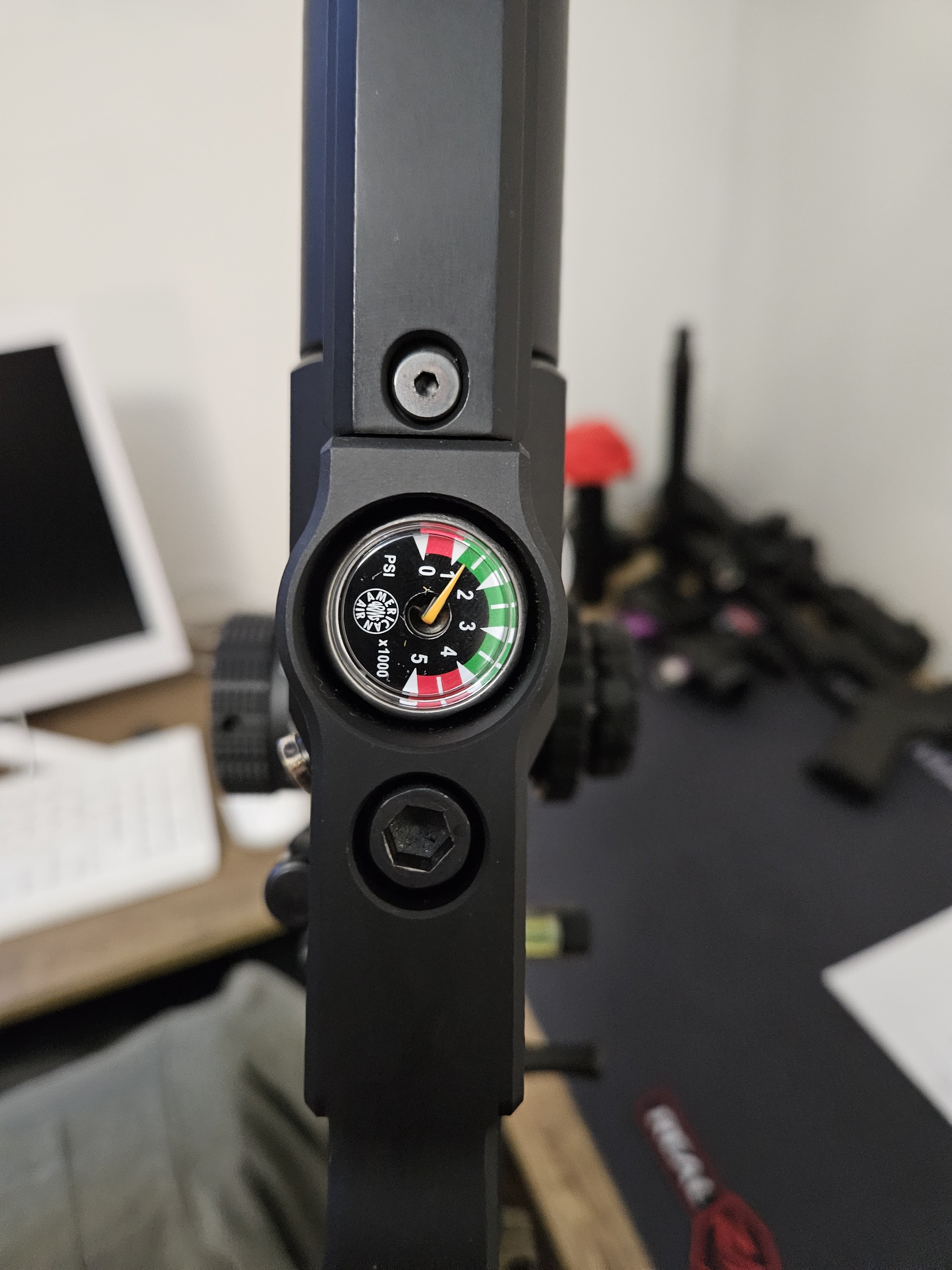

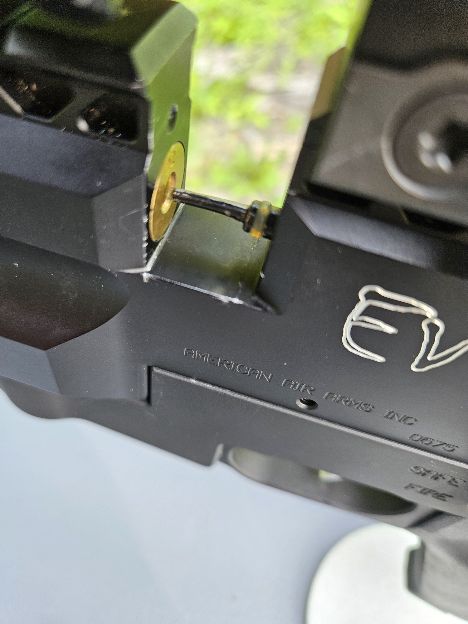

Anyways , there is a picture of the reg setting and also the HST screw is about 1/8 protruding from the action.
Yours may differ a little because my hps has a longer barrel at 21 inches than the rest of the current evols.
I would have kept shooting but downpours were coming.
