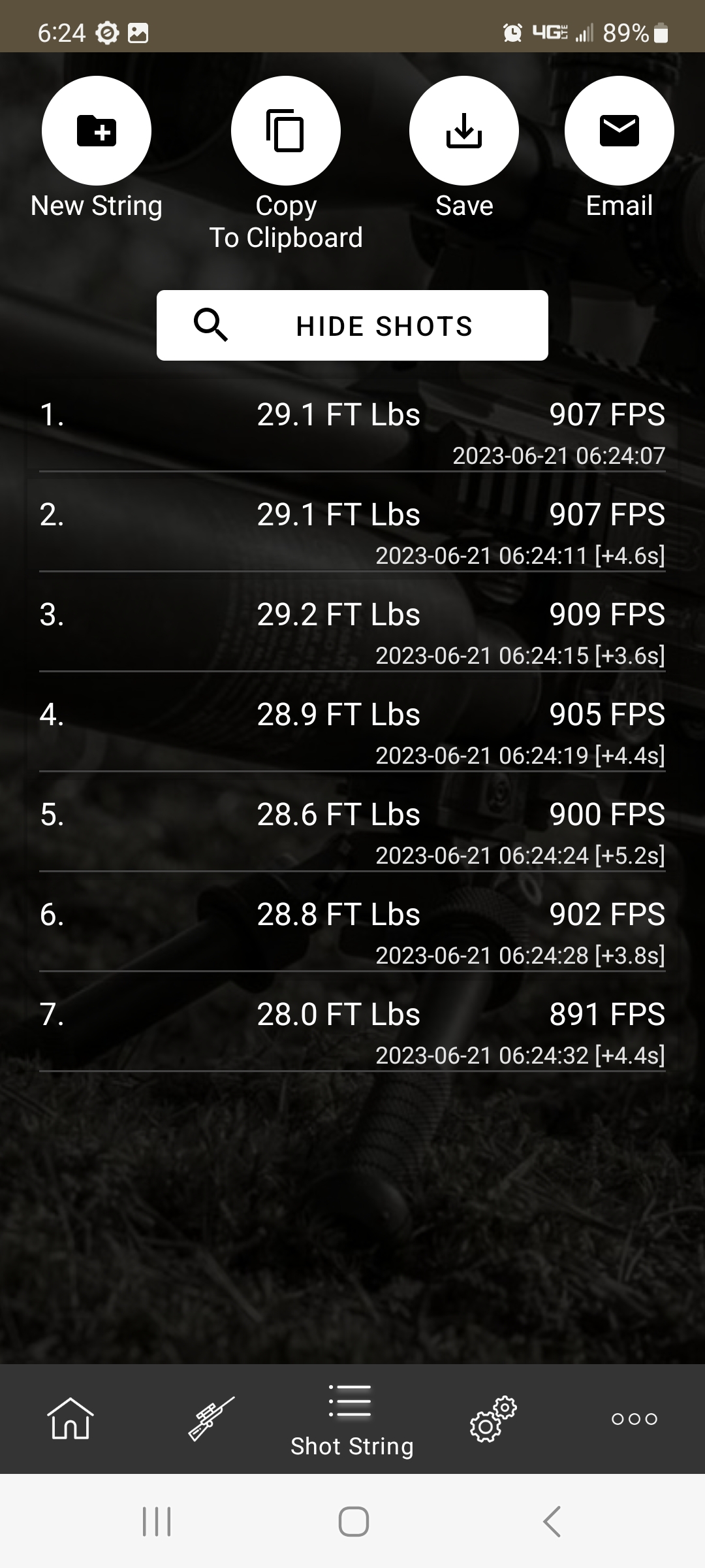

Got my mini tuned this morning after messing with it and finding out my chrono was trash. Anyways I was way off and knew it based on my holdovers. I thought I counted correctly but must have been 1 turn off. My reg came around 2250-2300psi based on where Derrick set it when it was his. He was shooting 18gr at 880fps then. I shoot 16gr and at this setting mine maxes at 937fps at this reg setting. Dropped it 30fps for a 97% of max tune where I like them. I still might go through the gun and drop reg pressure to around 2000-2100 and go with 880fps instead of the 905ish where I'm at. Very happy with it though back in action! Last shot fell off reg.

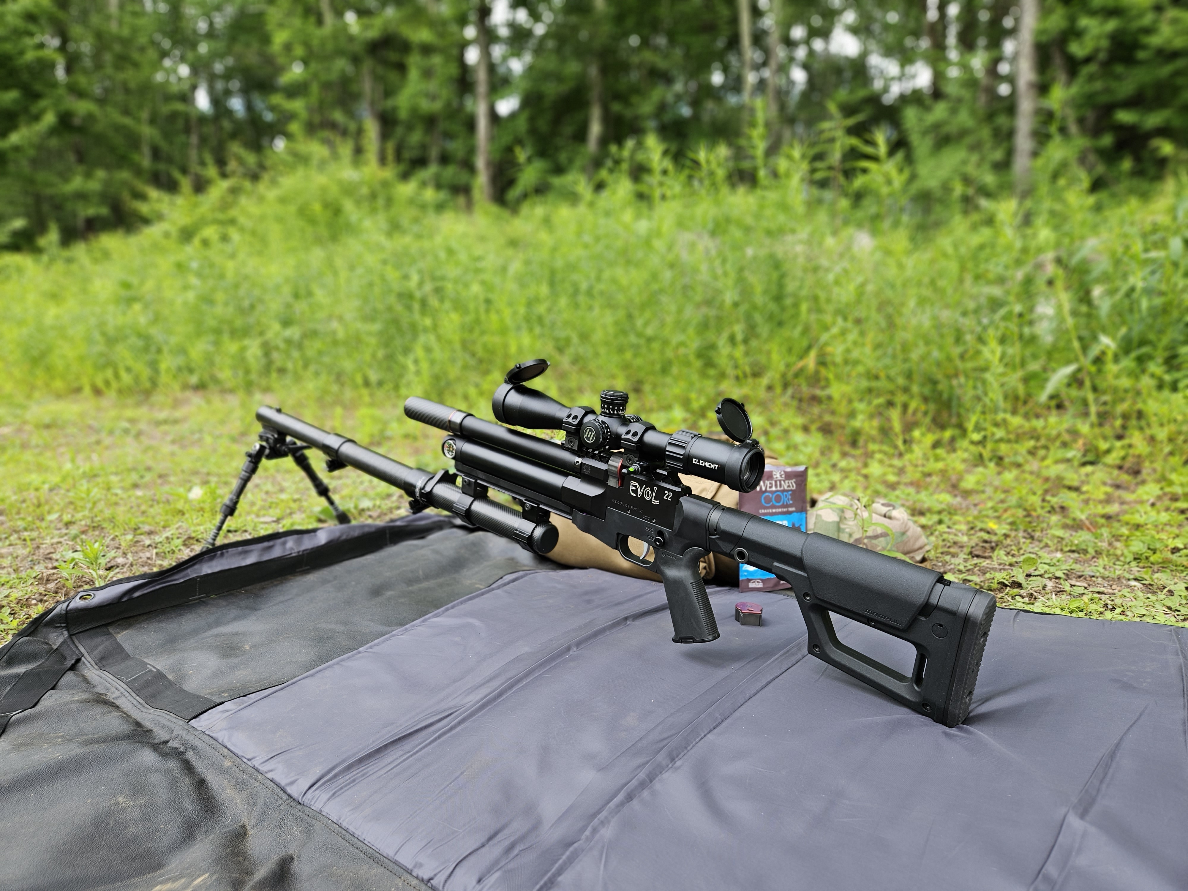

Finally my turn to join the AAA club! 😁
Been wanting an Evol since 2016.
Ordered and paid for the gun a couple of months ago, but shipping to me here in Norway was a real pita so it did not arrive until today.
Latest version Evol Mini .22. Came with a very nice bag - but I already had a backpack and some upgrades waiting for it. 😅 First 11 shots over the chrono looks very promising (JSB 18,1gr).

What folding hinge do you have on that MDT Stock? Does it lock up tight or do you feel any play?

What do you mean by side play? If you mean like has movement no its rock solid attached at the block and the front of the airtube
measure the total length of your adapter combined with the mdt carbine stock lite you have mounted there?
The stock is 325mm long with the adapter and LOP inserts. You can get make it 25mm shorter by removing the inserts. The adapter by itself adds 43mm length.
-PJ
It’s a MDT 2-way locking adapter, fixed to carbine interface. Absolutely rock solid with zero play.
Thanks a bunch for doing that man, greatly appreciated.
How are you liking that masterpiece of a rifle so far?
Reactions: Navnesen
Not had any chance to take it outside yet, just some shooting over the chrony indoors.
Beautifully built and excellent feel. So far I like it a lot!
