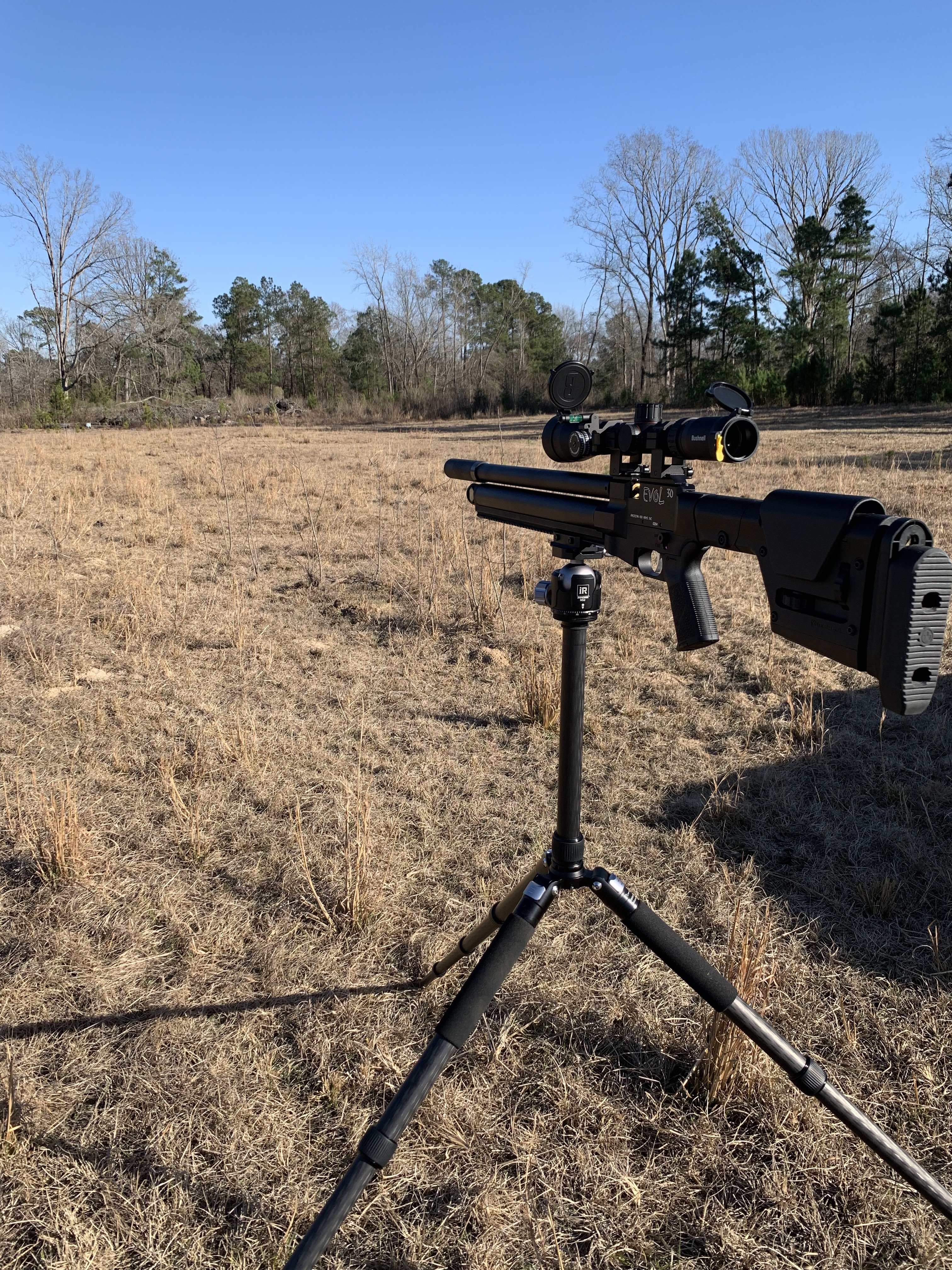

Here's my Evol .30 set up to shoot at 100 yards off of a tripod.
Evol .30 w:Bushnell Nitro 6-24x50mm SFP on Tripod 100 yd shoot.jpeg

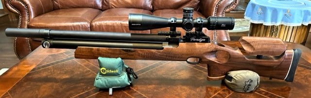

The EVOL Paradigm doesn't yet have a manual, so here is what Grady (customer rep at AAA) sent me:
From: American Air Arms
Sent: Wednesday, 19 April 2023 14:43
Subject: Evol Paradigm .30 owner’s manual
Hi Phil,
Thank you for contacting us and congratulations on your new purchase. I am happy to provide information about your rifle. The Paradigm is an EVOL action in a beautiful Steve Corcoran walnut stock. Below are some of the features of the Paradigm and general information:
A. Stock
•The gunstock is made by Steve Corcoran at Crosman Grips | Steve Corcoran Airgun Stocks and Grips | (scstocksandgrips.com) He uses beautiful walnut and adds details only seen in high end quality gunstocks.
•Vertical thumbhole. This allows consistent thumb placement.
•Adjustable rubber butt plate. This not only adjusts up and down but rotates on a vertical axis.
•M-LOK rail sits flush inside the stock preventing snags.
•The regulator gauge is recessed into the stock. This offers gauge protection and a snag free fore end.
•Adjustable comb.
•Thumbhole design is as inline as possible for quick offhand, off axis recoil mitigation, and improved cant control.
The gunstock fore end is flat. This provides stability on shooting bags and rests.
B. Please refer to the AAA website for EVOL .30 specifications and diagrams.
Manuals – American Air Arms
Here are three measurements that are specific to the Paradigm. The safety mechanism is also different than the EVOL TAC.
•The Paradigm is 41.5" in length
•It weighs ~7.8 pounds
The Paradigm has a 1:26 twist barrel.
C. Ammo selection --
•JSB 44 gr pellets
•FX Hybrid Slugs
54 grains and up will require tuning to achieve best results
You will have to experiment with different brands and weights. It's comparable to working up a load in firearms. People are shooting anything from ~44 grain to ~62 grain slugs with very different results.
D. Barrel cleaning procedure.
Make sure the gun is unloaded and there are no unfired rounds in the chamber!
Place the gun upside down with the muzzle on a slight down slope in a secure gun caddy. (The gun is cleaned upside down to prevent any solvents from running down the transfer port and washing out the grease in the valve)
Remove the Moderator, place the safety on safe and cock the lever to allow access to the breech.
Using a brass or bronze brush of the appropriate caliber, dip the brush in lead solvent (we use Shooter’s Choice) tap against the jar to remove excess solvent, and make 10 to 20 full strokes through the bore. Generally, this is all the brushing that is required unless your barrel is badly fouled.
Using a patch lightly dampened in solvent, run it through 4-5 full strokes.
Run a dry patch through 1 or 2 strokes to dry the bore.
Using a light, visually inspect the bore, if there are any spots of lead still attached to the bore repeat steps 4-6 again. (Attached lead will appear as dark patches usually at the land/groove intersections and are most prevalent at the muzzle end)
If you are going to use the gun after cleaning, you are finished. If you are going to store the gun, we recommend one or two strokes of a patch coated in gun oil to prevent possible corrosion.
E. How do I clear a double load?
The easiest method to clear a double load is to simply shoot it out into a safe backstop. If the bullets remain the barrel after attempting to shoot them out, you will need to tap them out with a wooden dowel.
THIS REQUIRES DEGASSING THE GUN
Grady, AAA Customer Service Rep.
