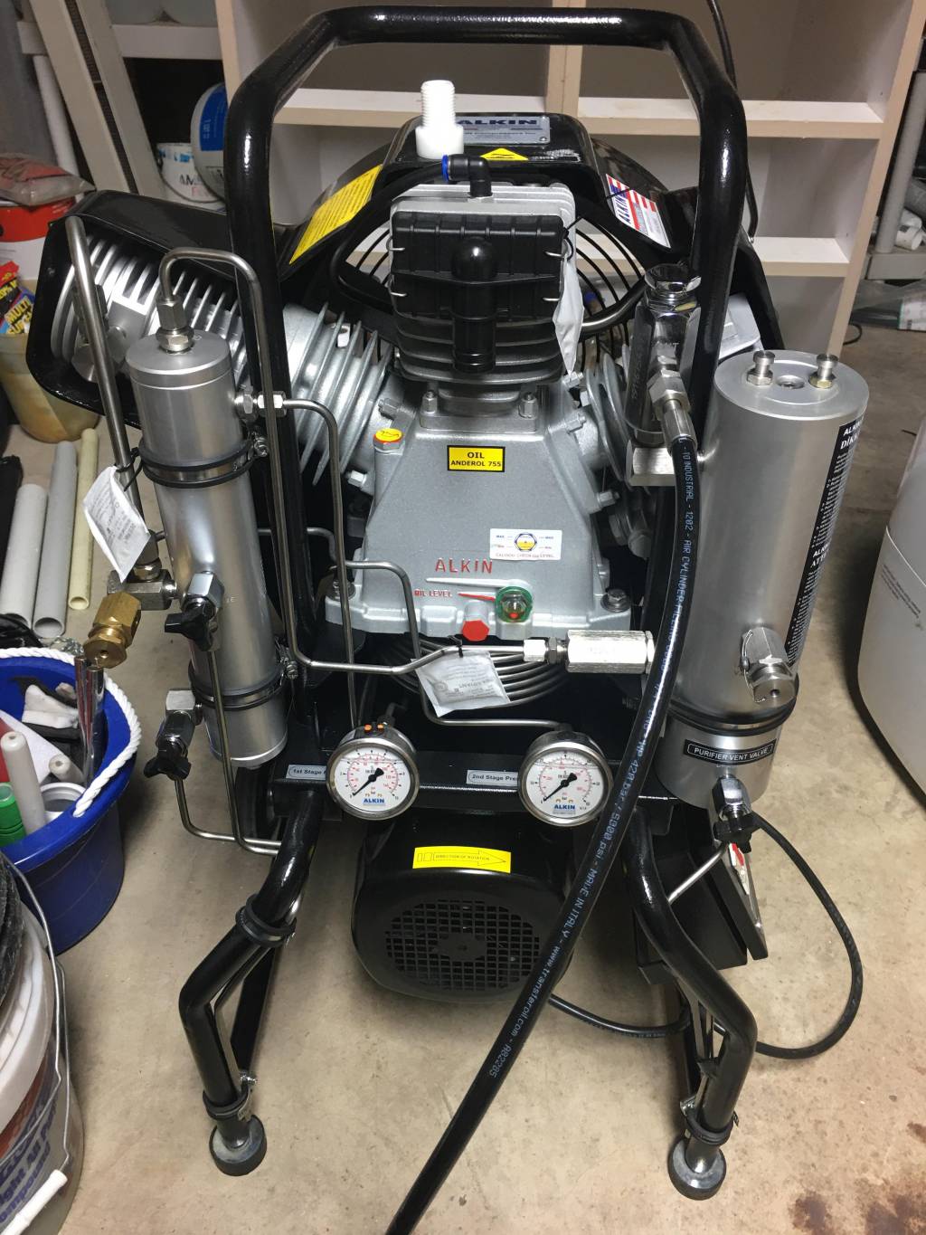

Hello guys I have decided to pull the trigger on a Alkin w31 auto single stage vertical.
I have a couple questions regarding configuration and any suggestions from other owners.
I am going to purchase the w31 with the auto features. I realize its not necessary however apparently the base model is back ordered for a few weeks and I dont care to wait.

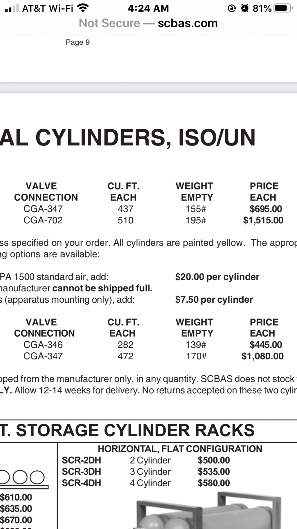

So I plan on the w31 with a 434cf 4500psi storage tank I plan to fill the storage tank via compressor to the 347 valve then from the valve out to the whip with inline valve and din300 to foster adapter and finally to tanks or directly to guns.
Any insight/recommendations on this plan I would like to do it once right and be done I have never owned a HPA compressor so.please enlighten me

Great choice on getting the big SCBA. The Alkins are designed to run 10 hours, 100% cycle duty. Meaning it can fill our little SCBA bottles but they're meant to be industrial dive shop, paintball, blow mold/PEET, etc. It'll probably outlive most owners.
Edit: A 434cft SCBA would take 124 minutes at 3.5cfm, so it's good you're getting the automatic features unless you want to stand there and drain your 2nd stage every 10 minutes.

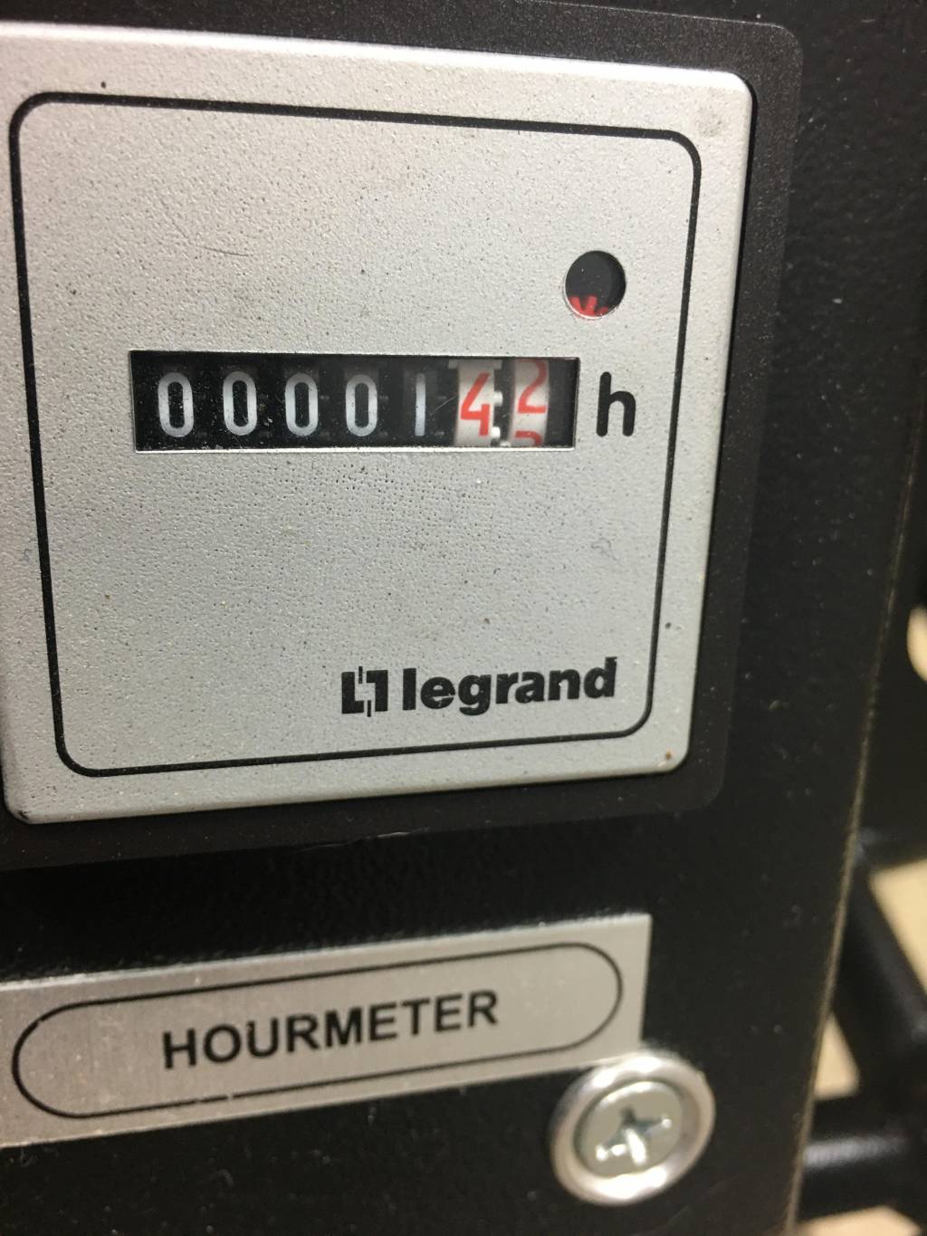

I don't even use this one. I'm selling all PCP's. The 1:42 break in time is from the factory.
