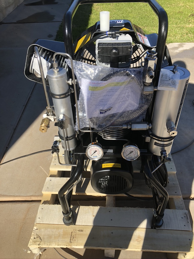

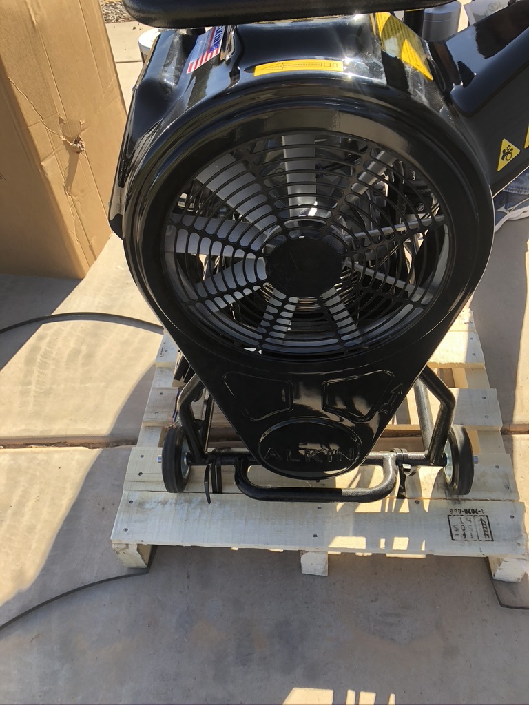

I decided to try an Alkin W31 compressor. I bought the compressor directly from Alkin US. The compressor has a two year warranty. But they are in NJ and I am in Az so I hope I the warranty will never be tried. Communication was good. David from Alkin was quick to answer e-mail, text or calls. I got the compressor delivered to my residence. Shipping was a week from Nj to AZ The compressor was packaged well. I have only used the compressor twice filling my Omega tank from 200 to 300 bar. It takes less than ten minutes to top off like that. The noise from my compressor is about the same as my 80 gallon shop compressor. So some may consider it too loud. I expected the level of noise so that is not an issue for me. You also need a 20 Amp. 220 circuit. The compressor seems well built. I am pleased with my buying experience and the compressor. I will include a few pictures of how it was packaged. The picture of instructions is just something I put together for my use.
